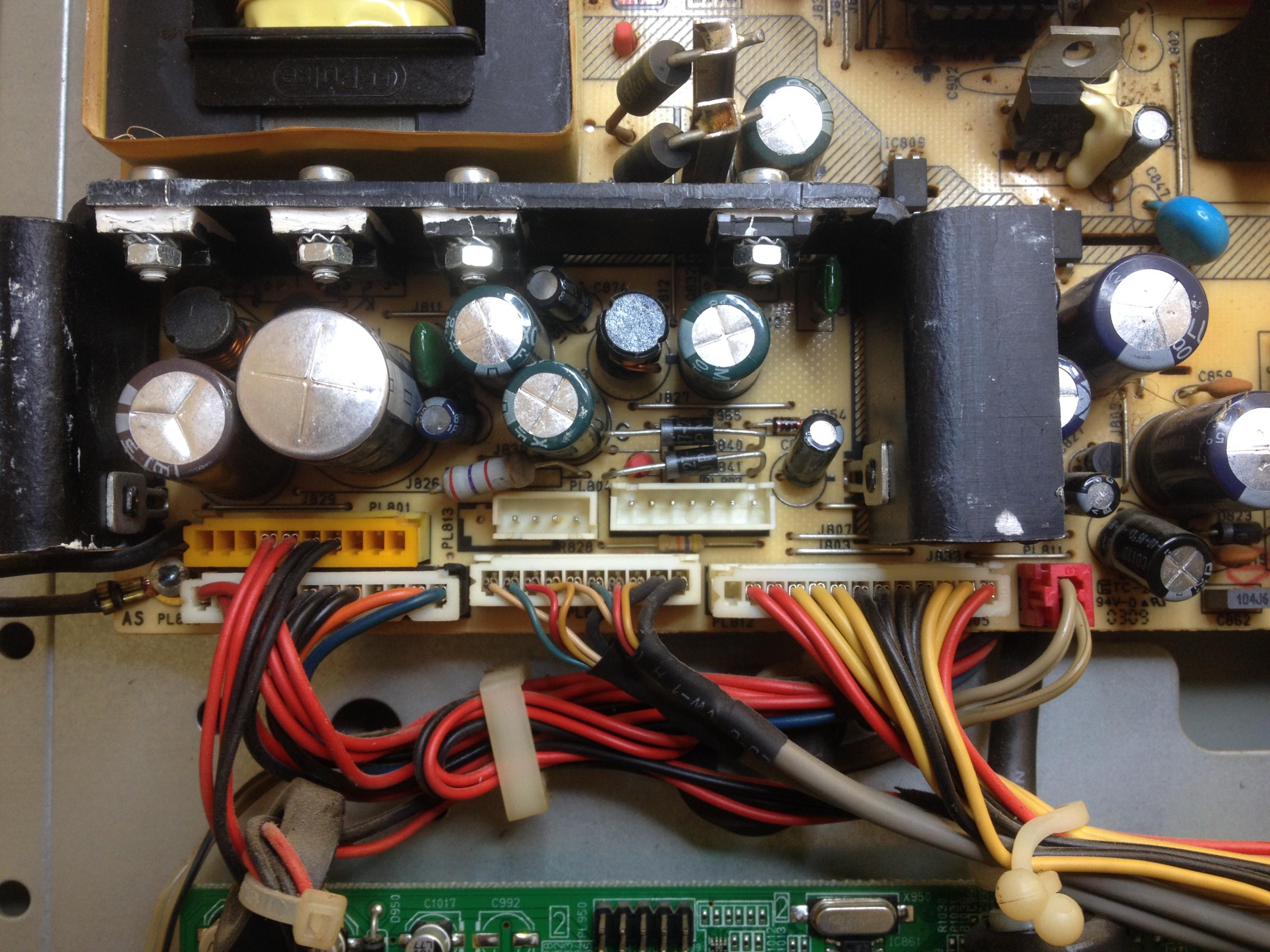

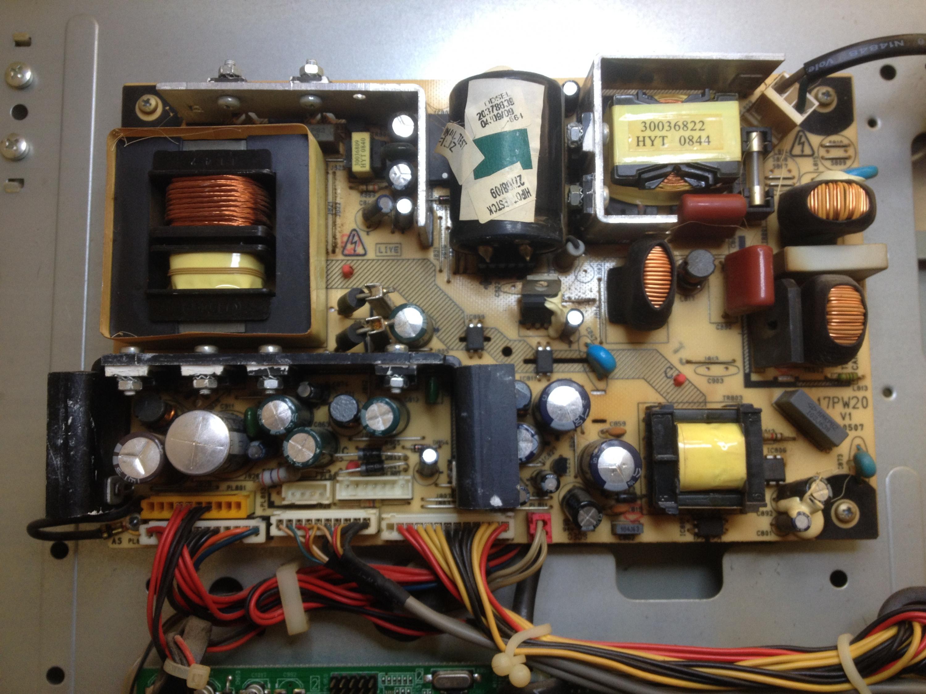

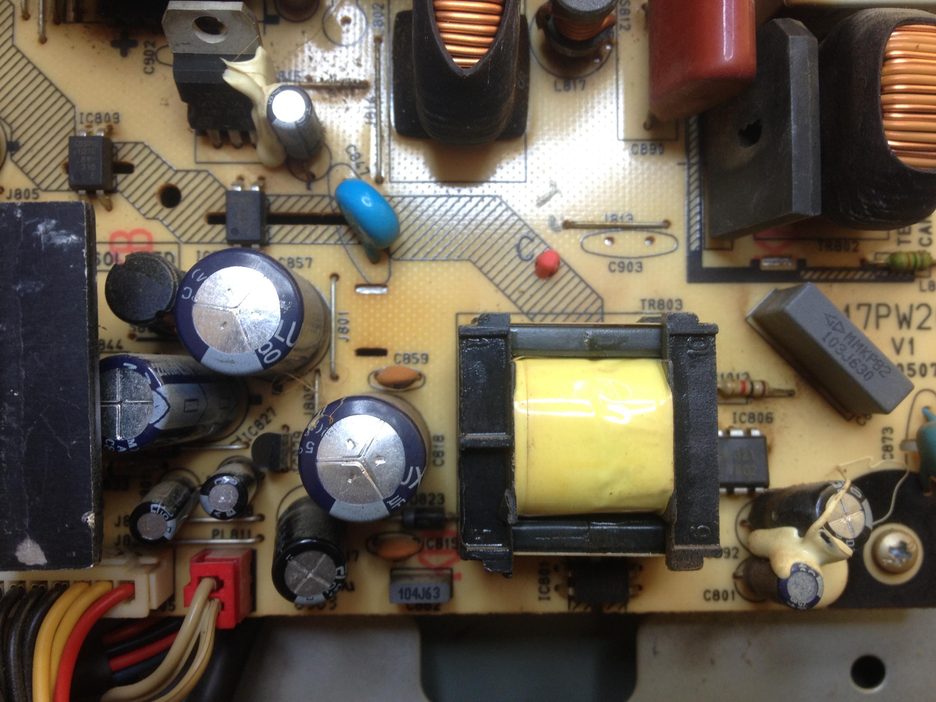

    Goodmans LD3265D1
    Picked up this set earlier with the complaint that when switching the set out of standby it would return to standby within a few seconds.
    Opened up the set up only to find a large number of blown capacitors in the power supply which was a Vestel 17PW20 V1. Replaced 13 capacitors in total and now the set is up and running.
