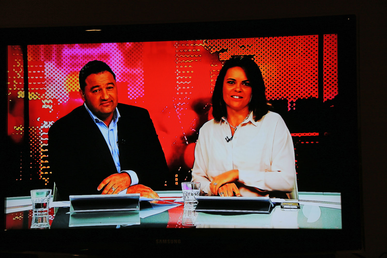

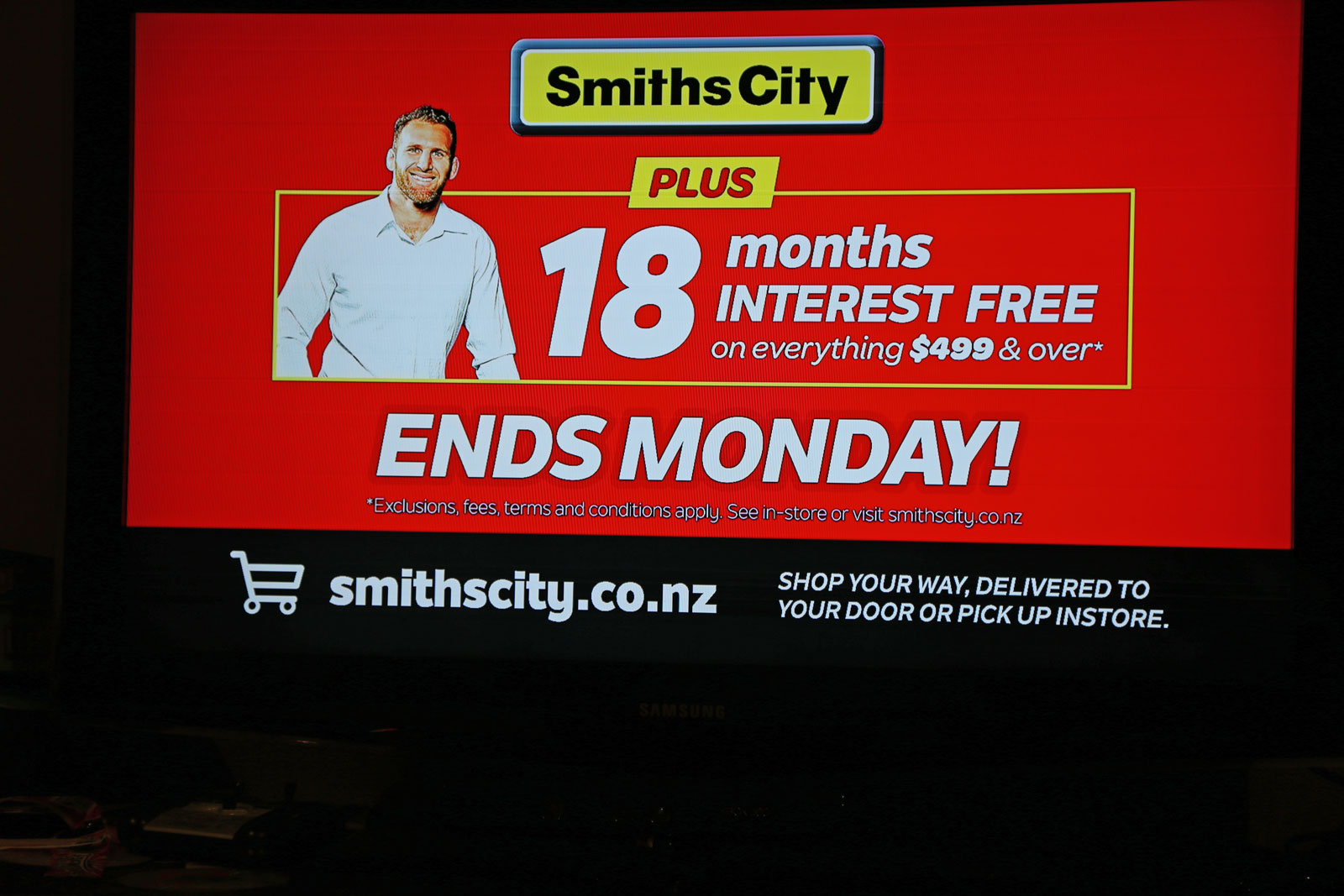

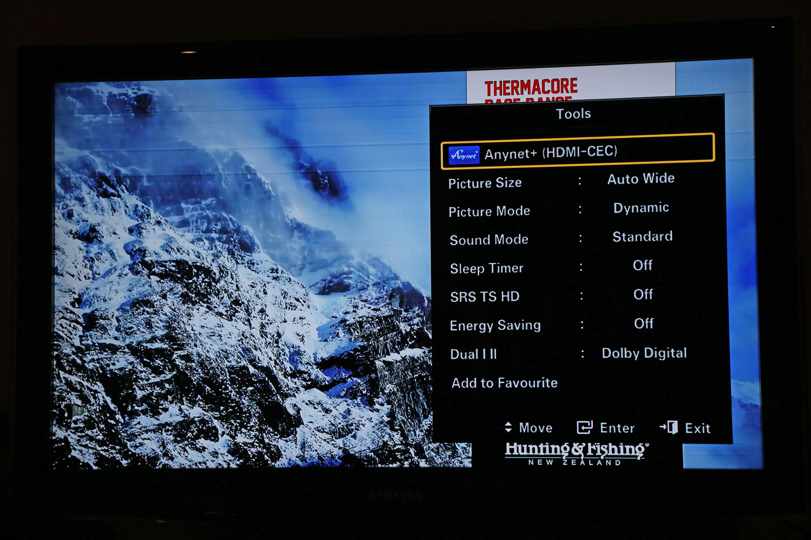

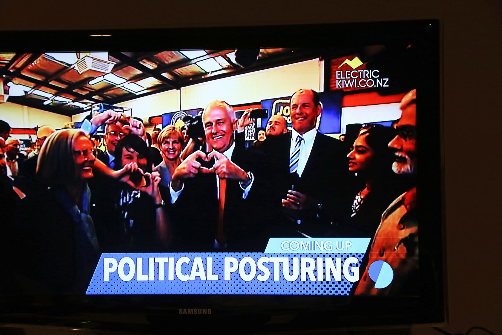

    Hi there, hoping you good people can help me figure out if I can revive my set. Colours are very red on particular channels, mostly noticeable in the skin tones. There are also horizontal ghost lines extending across the screen if there is any sort of graphics/words displayed. Have attached some images to show.
    Set was performing really well till a lighning storm (according to the wife who watches much more TV than I do). Not sure if coincidental or just her trying to join the dots.
    Initially I went into the service menu and was fiddling with the channels but nothing really made any difference so I did a service reset. You can see that the first image is very red. This is what it is mostly like. The second image the skin tones are better but no where near what it used to be like, and def not normal. I thought perhaps some setting had defaulted to something odd to shift the colours but nothing seemed to normalise things.

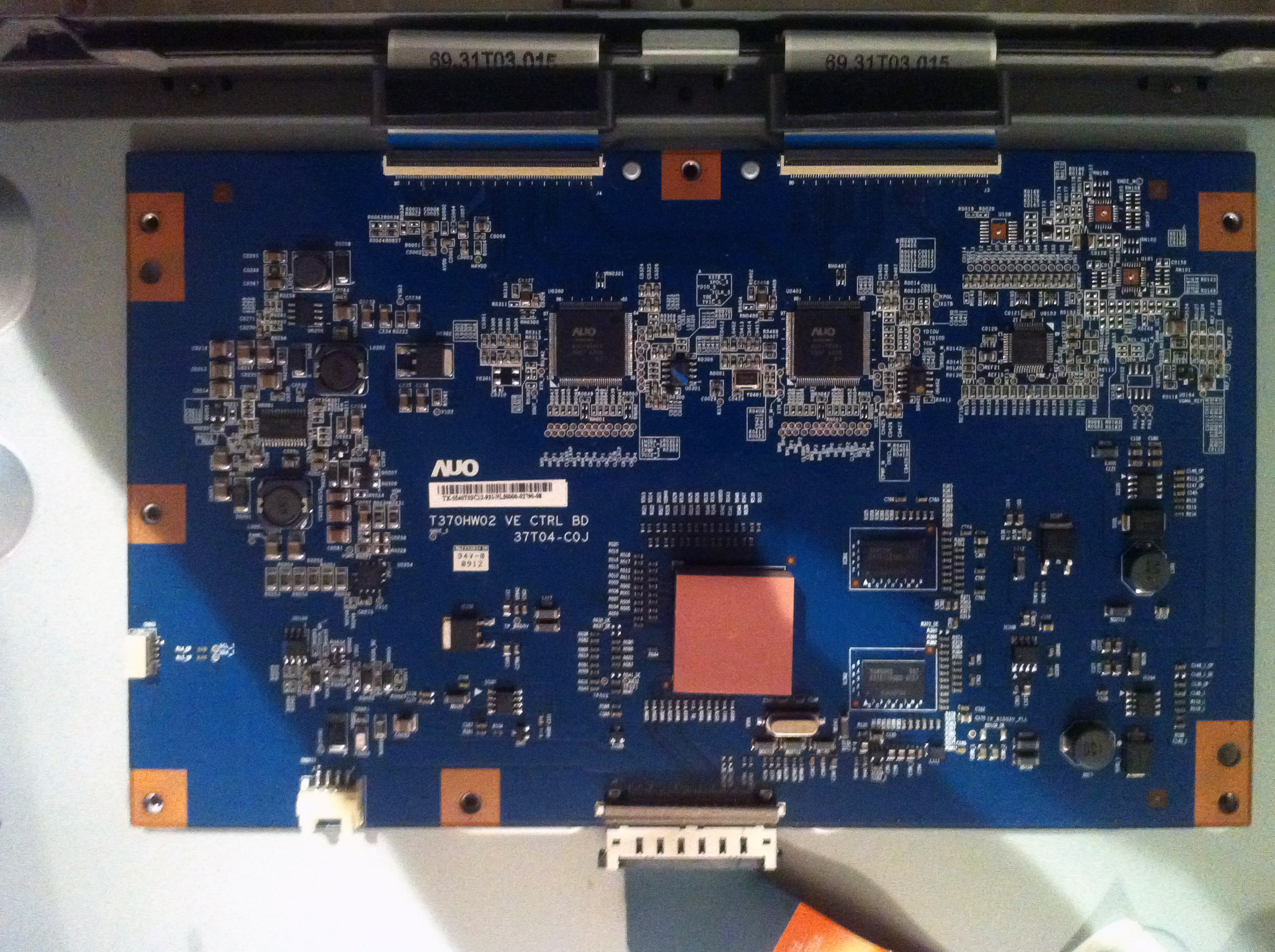

            post a pic of your tcon. Is there a AS-15 chip on there?

              Re: Samsung LA40B650T1MXRD - T-con? Very red people
              Ok. Excuse the noobish lingo, as I mentioned earlier am complete novice.
              So I removed the back off the TV and pulled the connecting cables out and put them back in. No signs of oxidation or dust or anything visibly in or around the connectors. The ones from the t-con to the display I didn't remove as they looked more fiddly and flimsy and I didn't want to break them. I did give them a bit of a push in to make sure they were sitting in properly and hadn't wriggled loose.
              Plugged the TV back in and made sure to take a pic of the T-Con when it was removed. Unfortunately it wasn't as clear as I'd hoped. Not sure where or what the AS-15 chip is but have attached photo it if it helps.
                That picture is too blurry for me. However, search here for "Gamma Voltages" or "As-15", "AS-15 gamma" etc. Measure the voltages on your gamma IC and record your voltages on a piece of paper. Look at them and they have to stagnate gradually. If there is a jump, it certainly is bad.
                  Vga test points looks to be under and slightly right of the top right LVDS cable going into the LCD. Also check the numbering on the square IC under the test points. It looks to be the right size for an AS-15 chip.
