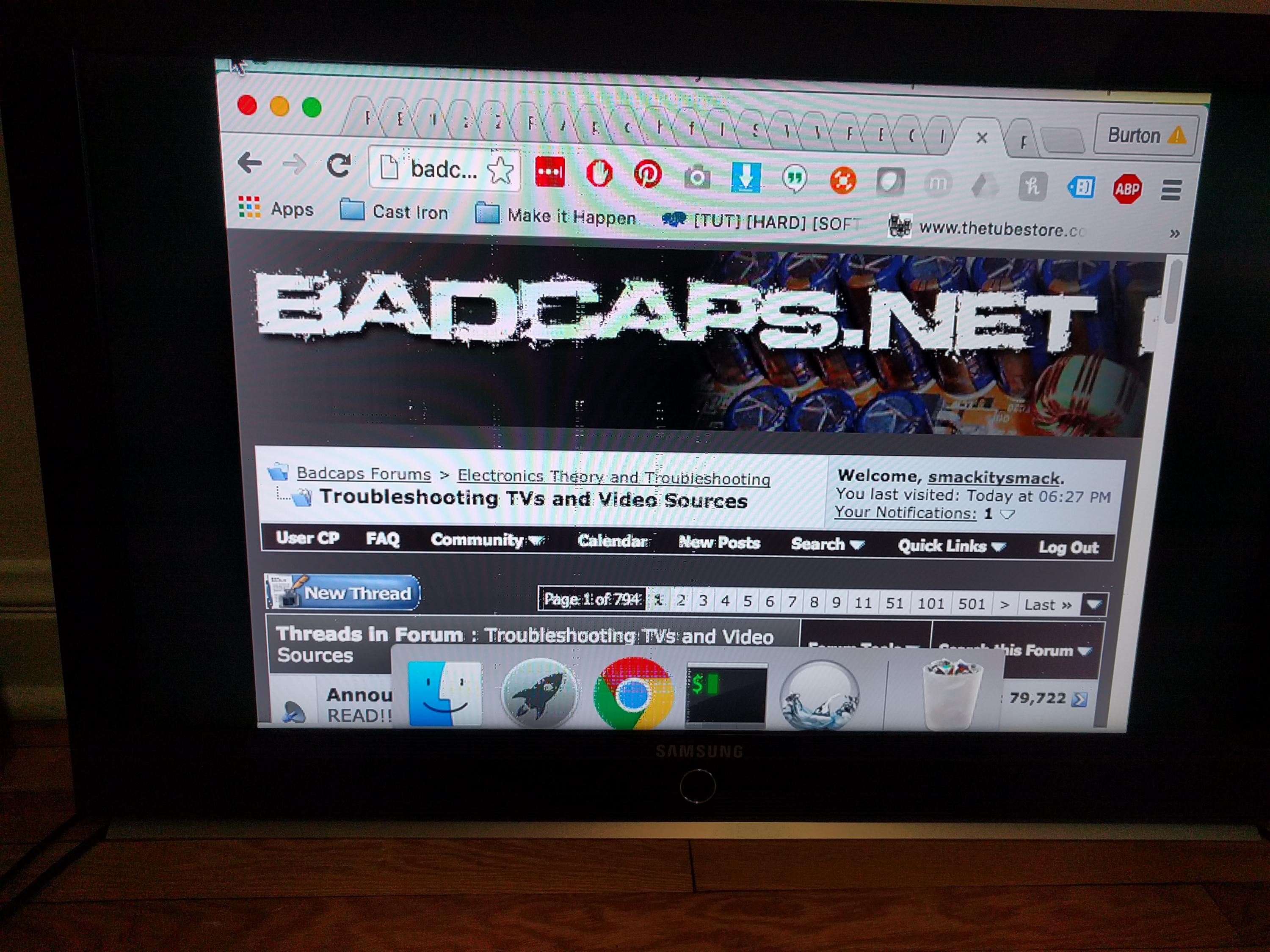

    The TV has noise from any input. If I choose a scaled down signal from my Mac (1080i or 780p) the display is better but still has noise. Sometimes noise tends to be greenish on lighter colors, reddish on dark colors. Otherwise it's just flickering white with more intense areas of noise spaced about 4" apart mostly on the left side of the screen.
    If there's no signal the screen is clean and has a No Signal message that looks perfect. I would think if it's the t-con board the menu would also have noise on it. So I'm inclined to think it's the main board.
    Also, the TV makes a click when turning on (a relay?).
    I checked the capacitors, none were swollen or leaking. Should I try replacing them anyway?
    Got into the service menu and did a reset. No luck there. Service menu had noise in the black background if connected to an input, was completely clean with no inputs attached.

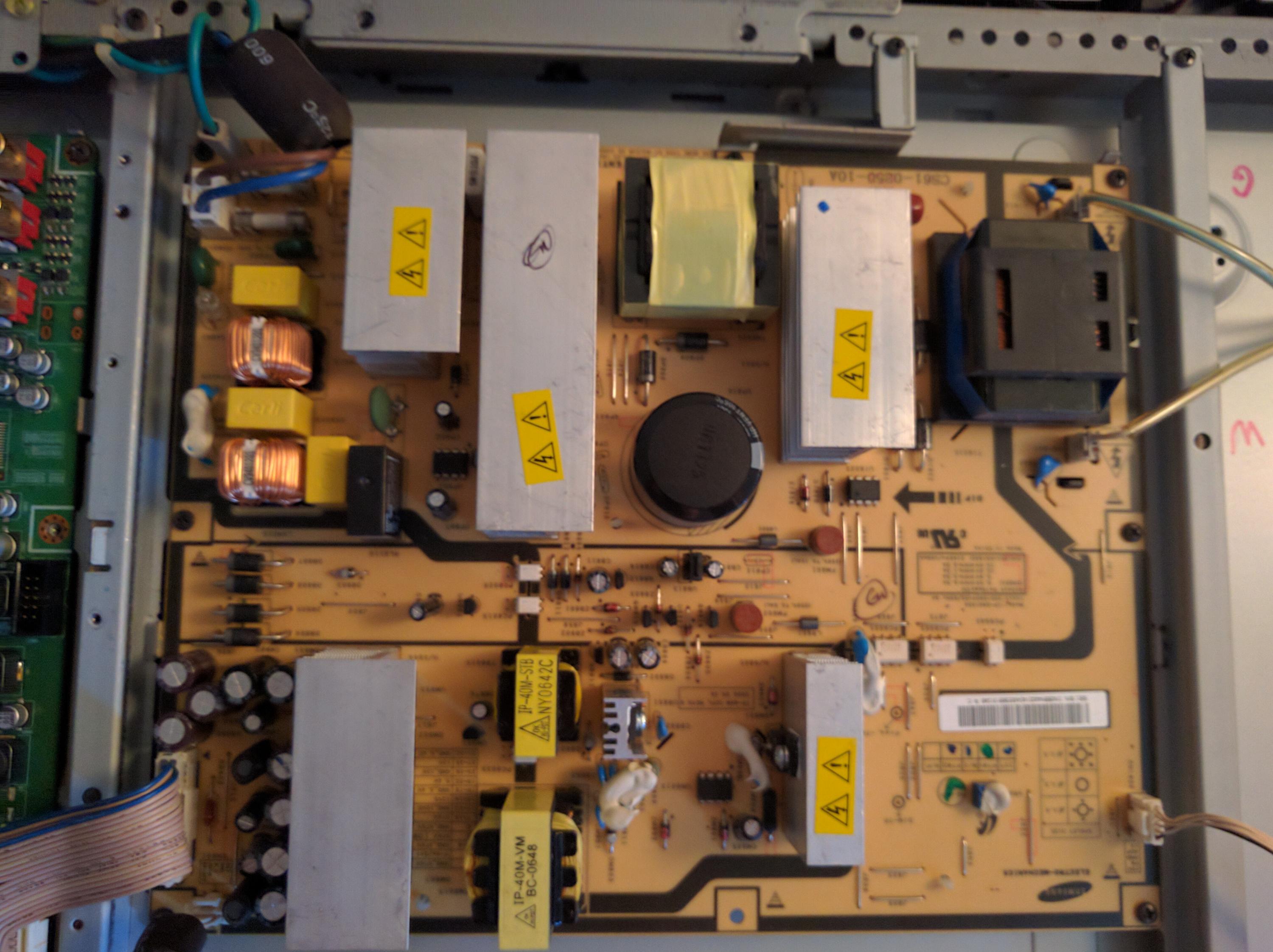

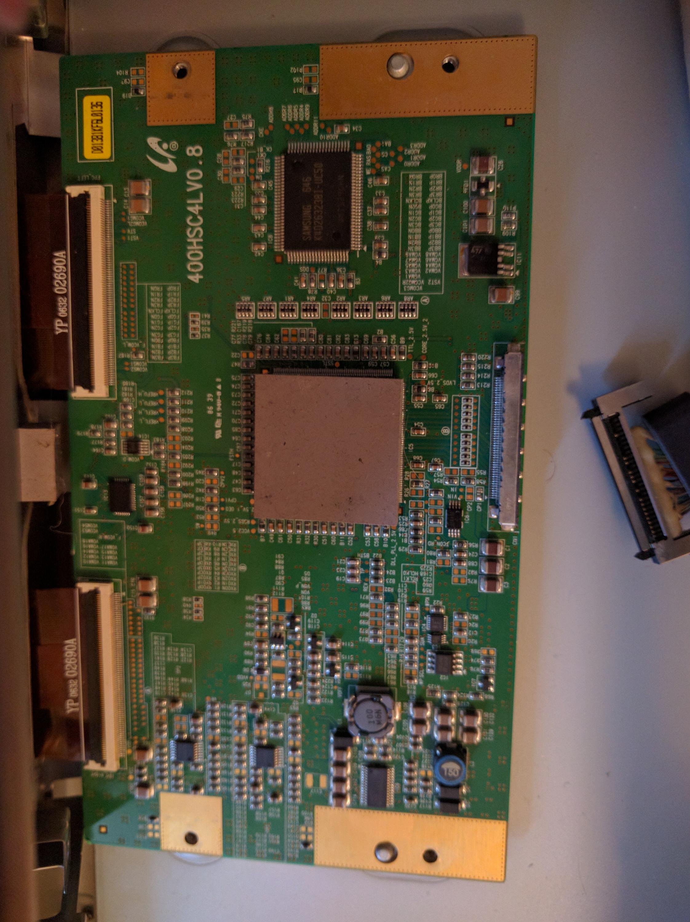

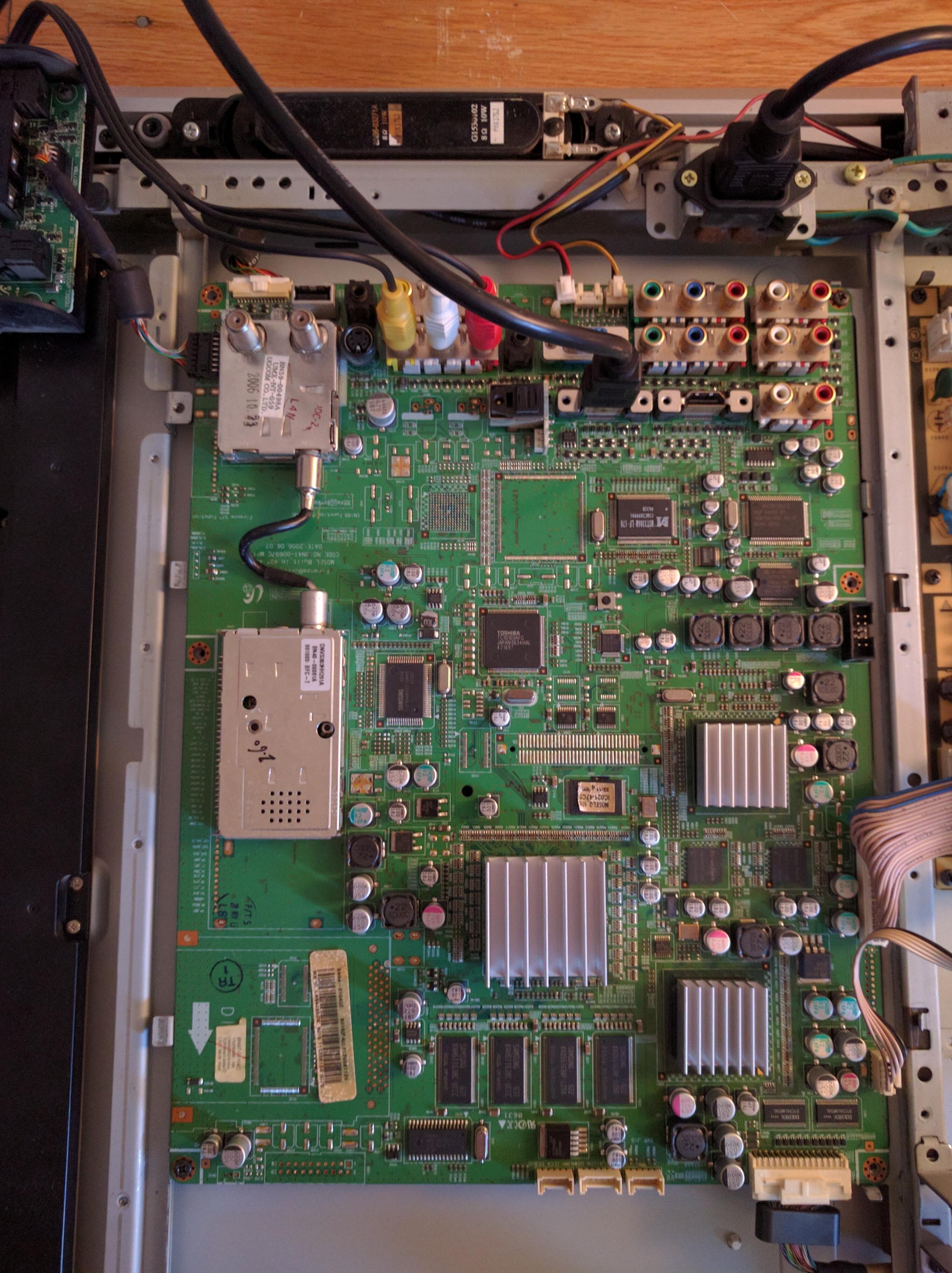

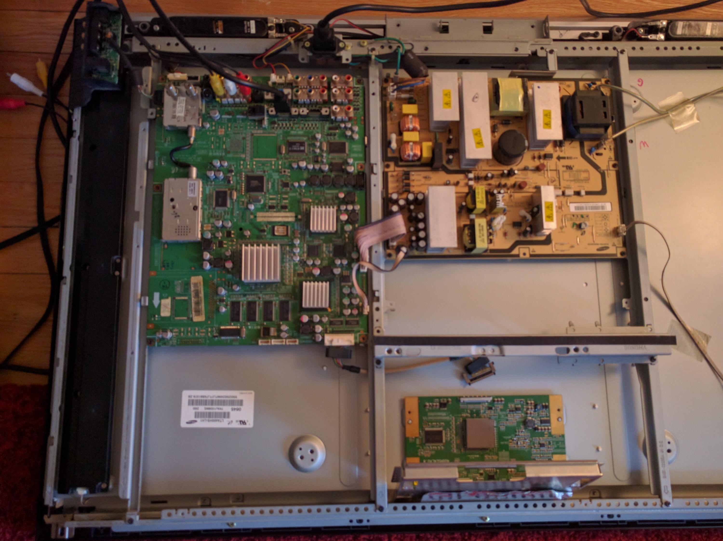

    Can you post pictures of the boards inside the TV? We'll need one good picture of each board and one of the entire set.
      Re: Samsung LNS4095DX/XAA
      Here they are. Thank you. However they were shrunk on upload?
