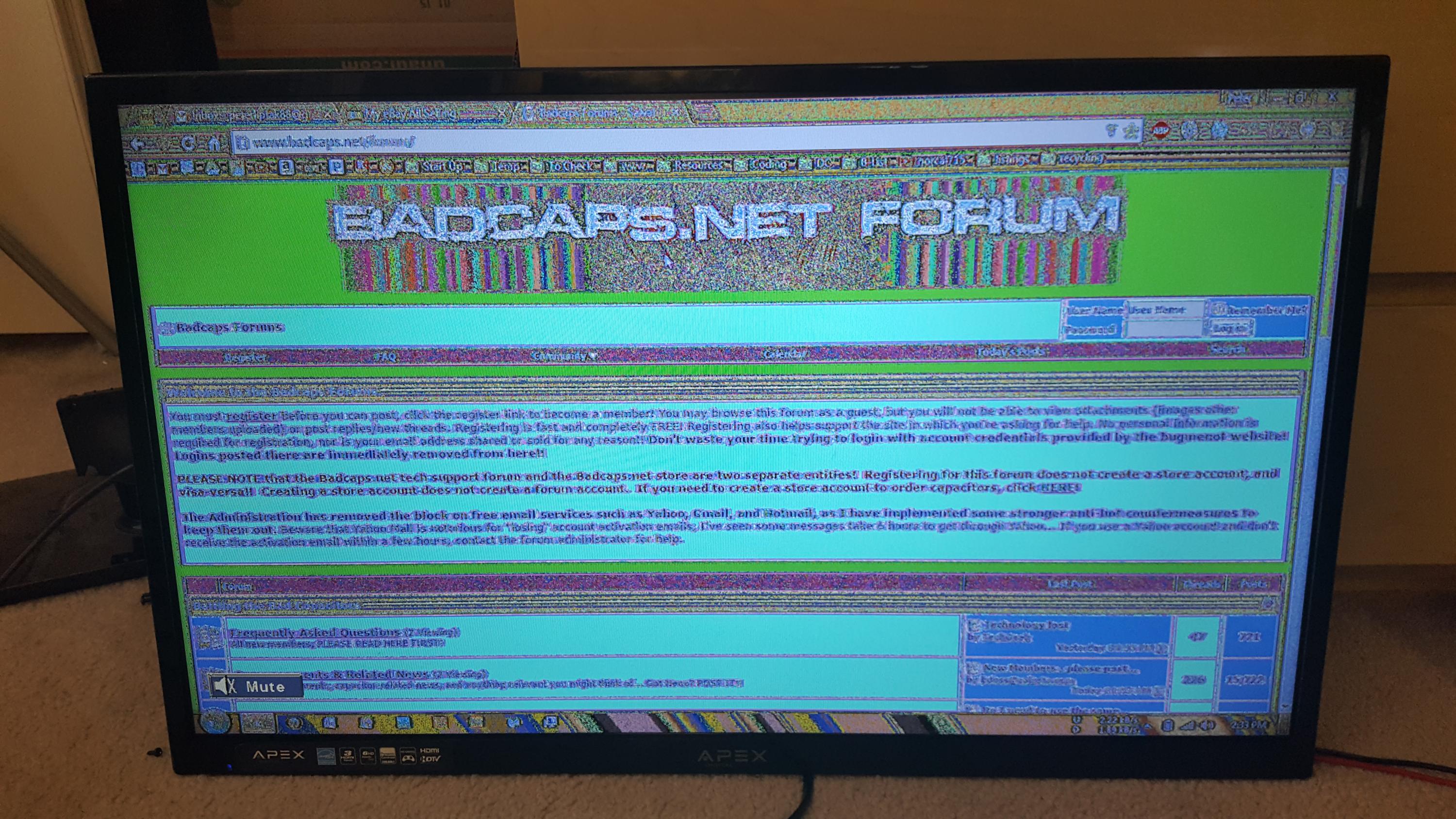

Does this Apex LE3243T have solarized image, or is it something else?
  • Pioneerx01
    • Apr 2015
    • 241
    • US
    I am trying to figure out what is wrong with this TV. I am not sure if it is solarized or something else is wrong.
    I get this on all inputs, and menu is off as well. I have re-seated all the cables. This TV only has main/power supply combo board that handles everything. No T-Con to replace.
    I am trying to get to service menu to change panel options, but I can't find one set of instruction that get me there.
    Video: https://youtu.be/aSD6p-caH2Y

    Re: Does this Apex LE3243T have solarized image, or is it something else?
    Mainboard firmware issue its not set up for that screen, did you replace the mobo ?
      Yes, I did. The original board was totally fried out.
