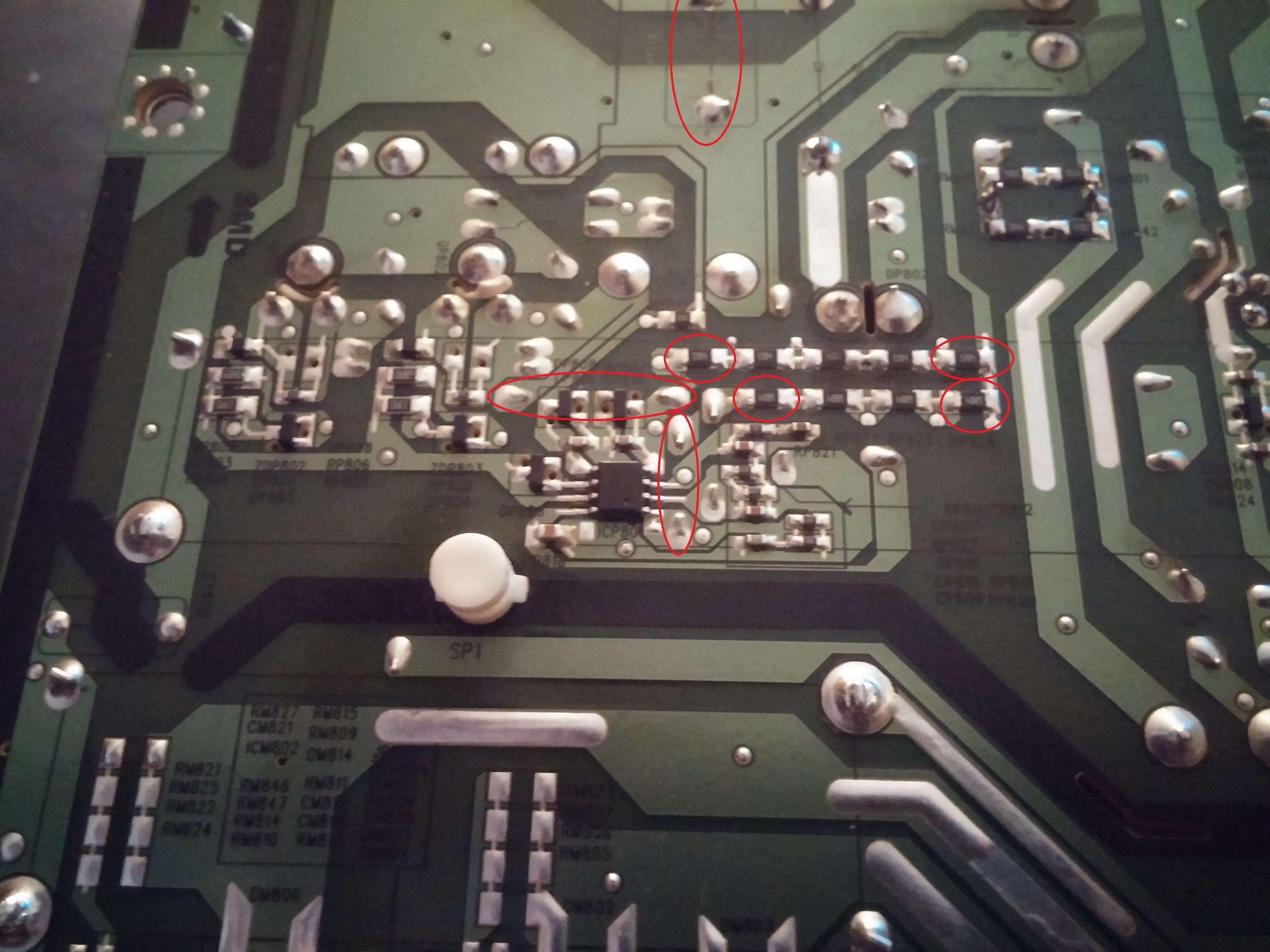

Samsung LN46D630M3F, TV powers on, sound works but no backlight
  • CapLeaker
    replied
    Re: Samsung LN46D630M3F, TV powers on, sound works but no backlight
    390V DC is perfect, PFC (booster) is working A1. The picture you outlined a few SMD resistors in a string. I don't think that was the cause, that looks too good. Anyway... main thing is the TV is working again.
    Leave a comment:
  • Five_magics
    replied
    Re: Samsung LN46D630M3F, TV powers on, sound works but no backlight
    Originally posted by budm
    Glad to hear, it is either bad joints or the value of the those high resistance have changed when heated with soldering iron, or contamination.
    Just keep an eye on it.
    So both meter show 390VDC?
    Yep both meters gave the same readings (390vdc).
    Also If you remember last week, I took readings in the PFC circuit (including these resistors), and after testing it the backlight actually came on for a few seconds, before shutting down.
    Will definitly keep an eye on it. Been working for an hour so far.
    Last edited by Five_magics; 04-19-2016, 09:30 PM.
    Leave a comment:
    replied
    Re: Samsung LN46D630M3F, TV powers on, sound works but no backlight
    Glad to hear, it is either bad joints or the value of the those high resistance have changed when heated with soldering iron, or contamination.
    Just keep an eye on it.
    So both meter show 390VDC?
    Leave a comment:
  • Five_magics
    replied
    Re: Samsung LN46D630M3F, TV powers on, sound works but no backlight
    Well, it looks like I fixed it. As mentionned earlier, took out the resistors to test them out of circuit. They were fine so I soldered them back. Also took the occasion to remake a few solders near the voltage divider, since I had like 5 minutes left to my lunch break.
    Came home, plugged it all back in to test it with another DMM, in case mine was inaccurate... main caps had 390vdc . My meter has to be inaccurate. Test with my meter, still 390vdc. Hmmm let's unshort the BL_on signal. Backlight came on and stays on.
    The TV has been running for a few minutes now and it's still working. Looks like it was a bad solder. Gonna leave it for a few hours to make sure.
    Here's a picture of the solders I remade.
    Last edited by Five_magics; 04-19-2016, 08:37 PM.
    Leave a comment:
  • Five_magics
    replied
    Re: Samsung LN46D630M3F, TV powers on, sound works but no backlight
    Yeah... just what I thought. I have that auto ranging one and it is the best cheap multi meter (when it is on sale $30) that money can buy.
    http://www.canadiantire.ca/en/pdp/au...l#.VxbKIxb2Ykk
    When things measure funny in circuit and you don't have a schematic, always lift a leg or take the component out and measure it again out of circuit.
    Skipped the auto-ranging since I personnaly hate them. Always takes me too long to figure what range Im on.
    And yeah I know about in-circuit vs out-circuit, just prefered to wait at work since its SMD and my personal soldering iron suck. Love my Hakko at work, with a JS02 tip. That thing does wonders.
    Leave a comment:
  • CapLeaker
    replied
    Re: Samsung LN46D630M3F, TV powers on, sound works but no backlight
    Yeah... just what I thought. I have that auto ranging one and it is the best cheap multi meter (when it is on sale $30) that money can buy.
    http://www.canadiantire.ca/en/pdp/au...l#.VxbKIxb2Ykk
    When things measure funny in circuit and you don't have a schematic, always lift a leg or take the component out and measure it again out of circuit.
    Leave a comment:
  • Five_magics
    replied
    Re: Samsung LN46D630M3F, TV powers on, sound works but no backlight
    Measured the resistors out of circuit and they're good.
    Leave a comment:
  • Five_magics
    replied
    Re: Samsung LN46D630M3F, TV powers on, sound works but no backlight
    Most of the time the batts are low when the meter shows crap measurements. If you have the biggest MasterCrap DMM that you got on sale for $30, that is actually the best cheapy and decent for the money.
    Battery is brand new. https://m.canadiantire.ca/#/products...055&quantity=1
    Thats the meter. Says voltmeter but it really is a multimeter.
    Leave a comment:
  • CapLeaker
    replied
    Re: Samsung LN46D630M3F, TV powers on, sound works but no backlight
    Most of the time the batts are low when the meter shows crap measurements. If you have the biggest MasterCrap DMM that you got on sale for $30, that is actually the best cheapy and decent for the money.
    Leave a comment:
  • Five_magics
    replied
    Re: Samsung LN46D630M3F, TV powers on, sound works but no backlight
    Originally posted by budm
    And it stays at that level? If it is really 450VDC between the two legs of the cap then the PFC circuit should shutdown, it has protection not to let the output Voltage goes way beyond 400V. I hope your meter is accurate.
    if you look at the spec sheet of the IC, there is explanation on how the IC works including the OVP (Over Voltage Protection), There are two strings of Voltage divider resistor networks for sensing function.
    If you look at the bottom side of the board, you will see two set of resistors, each set has a bunch of resistors connected in series to form Voltage divider and feed the IC pins per the spec sheet. so it can be that the value of the resistors have changed so it caused the output Voltage to go too high, I would check out those resistors.
    Meter probably isn't that great, cost me 35$, Mastercraft brand. Will see if I can borrow a Fluke/BK precision from work, just in case.
    Initially it measures at 430vdc~, goes up slowly in 1 volts increments. When it reached 450vdc I shut the TV off, because with caps rated at 450 volts... yeah.
    I have seen the divider you're talking about. Will check it out and report.
    EDIT: Just checked the resistors and I think the meter is crap. The resistors measure somewhat okay in a direction(1,05M instead of 1,2M), but when I reverse the polarity it drops to 800k or so. Will check it out with a Fluke tomorrow.
    Last edited by Five_magics; 04-18-2016, 11:20 PM.
    Leave a comment:
    replied
    Re: Samsung LN46D630M3F, TV powers on, sound works but no backlight
    Originally posted by Five_magics
    Didn't have much time over the weekend, but tonight I shorted BL_on to the ground via the 100 ohm resistor, and the PFC circuit comes on (around 450vdc on main caps).
    And it stays at that level? If it is really 450VDC between the two legs of the cap then the PFC circuit should shutdown, it has protection not to let the output Voltage goes way beyond 400V. I hope your meter is accurate.
    if you look at the spec sheet of the IC, there is explanation on how the IC works including the OVP (Over Voltage Protection), There are two strings of Voltage divider resistor networks for sensing function.
    If you look at the bottom side of the board, you will see two set of resistors, each set has a bunch of resistors connected in series to form Voltage divider and feed the IC pins per the spec sheet. so it can be that the value of the resistors have changed so it caused the output Voltage to go too high, I would check out those resistors.
    Last edited by budm; 04-18-2016, 10:49 PM.
    Leave a comment:
  • Five_magics
    replied
    Re: Samsung LN46D630M3F, TV powers on, sound works but no backlight
    Didn't have much time over the weekend, but tonight I shorted BL_on to the ground via the 100 ohm resistor, and the PFC circuit comes on (around 450vdc on main caps).
    Last edited by Five_magics; 04-18-2016, 08:26 PM.
    Leave a comment:
  • CapLeaker
    replied
    Re: Samsung LN46D630M3F, TV powers on, sound works but no backlight
    Well... if the backlight came on for a brief second, that is a big game changer.
    Leave a comment:
  • Five_magics
    replied
    Re: Samsung LN46D630M3F, TV powers on, sound works but no backlight
    It didn't come on until just now. By "this time" I meant like an hour ago :O. Used check-diode in the PFC circuit, tested the set again to take measurements and to my surprise it came on for a few seconds, which makes me think I charged a capacitor/FET making it work for a brief time -> bad ICP801?
    Will try shorting the BL_on signal tomorrow at work (again, lack of equipements/components).
    Last edited by Five_magics; 04-14-2016, 09:19 PM.
    Leave a comment:
    replied
    Re: Samsung LN46D630M3F, TV powers on, sound works but no backlight
    You can disable the bl-on signal by grounding the bl-on pin. With 100 Ohms resistor to Gnd to see if the PFC will come up and stay up.
    Btw, all these time we thought the backlights never did come on per post 3.
    Last edited by budm; 04-14-2016, 09:04 PM.
    Leave a comment:
  • Five_magics
    replied
    Re: Samsung LN46D630M3F, TV powers on, sound works but no backlight
    You actually made me doubt, but the TV is indeed on. Still 160vdc on main caps.
    Funny part is, this time, the backlight actually lit up for a few seconds before shutting down. Last thing I did was take measurements (check-diode) in the PFC circuit. Faulty PFC? Thought it could be a bad contact so I tried tapping the board near the PFC but no dice.
    Or can a faulty CCFL/inverter shutdown the PFC circuit?
    Last edited by Five_magics; 04-14-2016, 07:49 PM.
    Leave a comment:
  • CapLeaker
    replied
    Re: Samsung LN46D630M3F, TV powers on, sound works but no backlight
    160v DC is just rectified mains, so either the tv is off, or the PFC (booster circuit) isn't working.
    Leave a comment:
  • CapLeaker
    replied
    Re: Samsung LN46D630M3F, TV powers on, sound works but no backlight
    When the tv is turned on?
    Leave a comment:
  • Five_magics
    replied
    Re: Samsung LN46D630M3F, TV powers on, sound works but no backlight
    160vdc
    Leave a comment:
  • CapLeaker
    replied
    Re: Samsung LN46D630M3F, TV powers on, sound works but no backlight
    Again, how much voltage is on the main filter cap when the tv is on? Measure both leads directly on the cap. Should be more than 360v DC.
    Leave a comment:
    09-07-2024, 05:50 AM
  • ex250
    Kenwood SW-505D no sound issue and pops from time to time when it works
    by ex250
    Hello mates,
    I bought this subwoofer a few days ago used and blind and it works erratically, as far as I could see, it has been tampered with, the speaker is not the original one and of 8 Ohm when it should be of 4, and there are some welds like reworked by the boards.
    It doesn't have much power (expected more from it) and it distorts if you increase the volume over the middle, maybe it's because of the high impedance of the speaker. The problem is that it has sound when it wants, the led panels all work correctly, you can hear the power relay on power on, but right now...
    12-29-2024, 03:27 PM
  • jchang
    Samsung UN70NU6900F no picture and no sound
    by jchang
    Hi all
    I was just given a Samsung TV with the issue. I read various threads and videos and attempted the ribbon tape method to gain an image, but no luck.
    Symptom:
    No picture no sound.
    When I plug in the power cord, Backlight LED turns on for a half second and then turns off. The red LED next to the power button located center bottom flashes 2 or 3 times. When the power button is pressed after, it does the same thing.
    No sound at all.
    What I tried:
    1. I tried unplugging the left or right ribbon...
    01-09-2023, 06:28 PM
  • Ierwin
    by Ierwin
    05-13-2025, 03:31 PM
    09-06-2024, 11:40 PM
