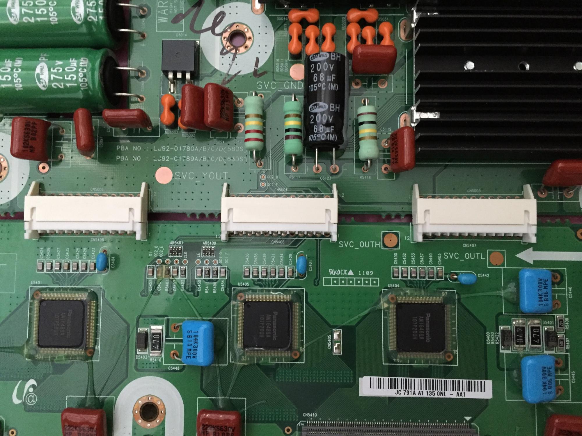

    Guys,
    How do you safely remove the y buffer from the y main board. For the life of me, I feel like I'm going to break the pins holding the boards together if I pull any harder. Thanks for the help,
    Retro

    Re: PN64D7000 SAMSUNG - how to remove y buffer from y main
    Inching them out carefully a bit at a time at each end of the circuit board should do it. Not that I've done it but it is probably tight because of the number of connectors its attached to.
      Have you undone the caught-es on the connectors. the little clips on both sides of the bottom connectors that lock the connectors in?
        Good point.
