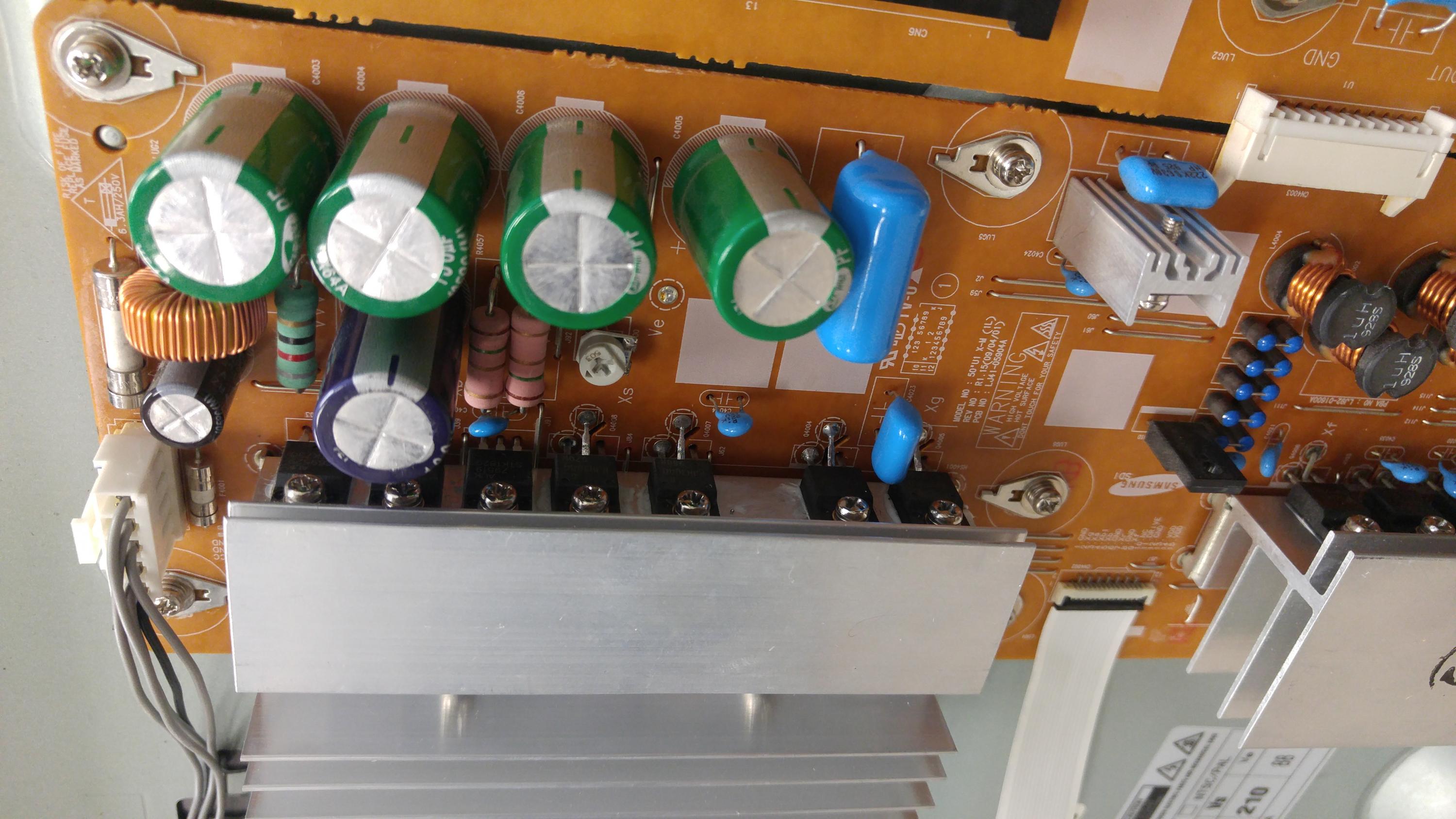

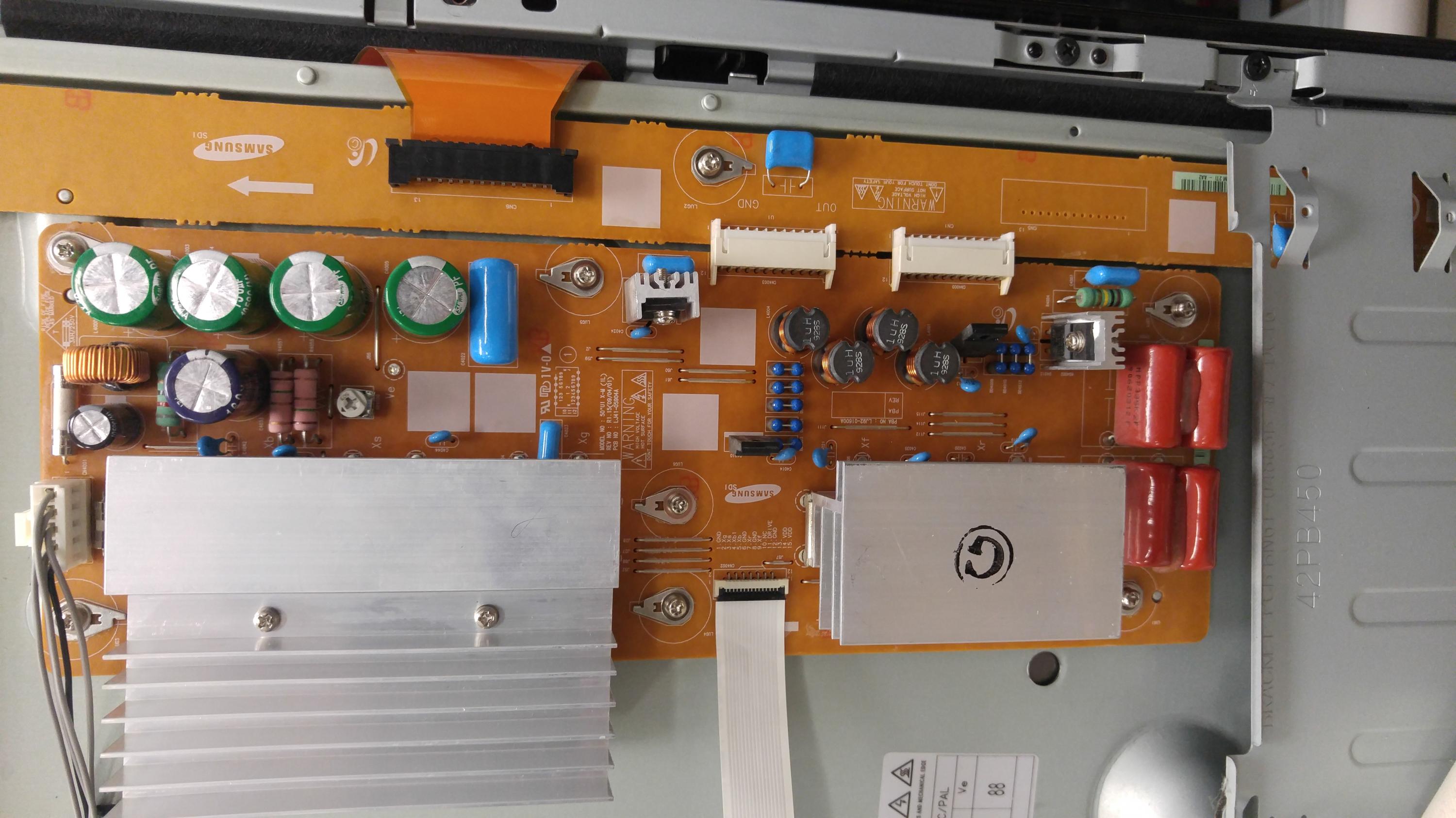

    I got a samsung PN50B450B1DXZA that came in the shop with a shorted X.
    X-main part number is BN96-09736A (LJ92-01600A) I replaced the 4 IGBT's location numbers Q4004, Q4005, Q4007,Q4008 with part number RJH3044 that were all shorted. I took some readings and found that they have 10kohms between the 2 outer pins from a 10k resistor, and about 78Kohms and 88kohms from middle leg to the outer legs. That seemed low to me, so I went on a multi hour search for something that could be lowering the ohms value but didn't find any faulty components.
    I plugged the X main back in and made sure the panel was disconnected. The voltages all seemed good through the board, and I had about 84 volts on ve aka the lines going to the panel.
    I turn the tv off, make sure the power supply clicks off, unplug it, wait a bit, plug the panel in, and boot it up. Fizzing/loud sounding discharge coming from that Xmain area of the set, and pop. IGBT's all short to ground. At this point, I think bad Panel. However when I redid the xmain repair, I did the same thing and didn't plug in the panel, so the tv stays on and you can see a partial crappy shadowy picture which makes me thing panel is ok.
    What do you guys think is going on.
    I very very rarely come across a bad panel, so I am hesitant to call it bad.
    Let me know if you need additional pics.

    Re: Samsung PN50B450B1DXZA X-main keeps blowing
    Nick my friend, this Tv chains the ERC between the Y and Xmain boards meaning that a bad Y can kill the X m. Check the Y for S/C on the power fets.
            Doubt its a bad panel thats VERY VERY rare on Plasmas, there is not much to go wrong inside them. Your missing something somewhere. The Tv should work with the Xmain disconnected you will get image with it out and on just distorted. Have you tried doing that ?
              Did you replace the gate driver ICs that control the shorted IGBTs? If not that will cause your new parts to blow.
                  The Xmain wont be working though when its not connected to the Pdp as it wont be sustaining the panel there for the fets wont run. Check the driver Ic's and other related parts Ie Zener diodes and resistors.
