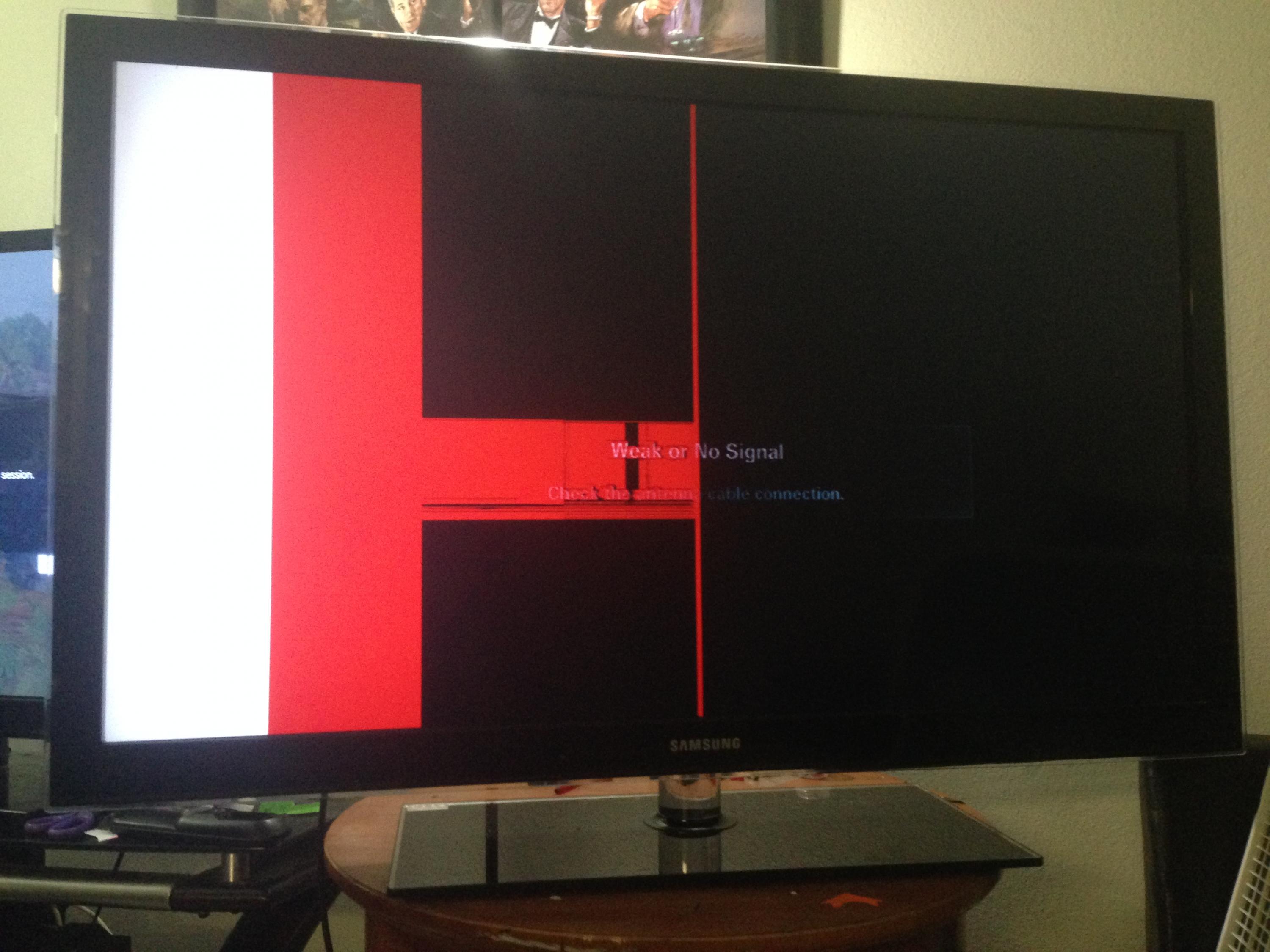

Has anyone seen this or maybe have an idea what is going on with this set?
TIA

Does this look like a bad panel or a T-Con/AS15 issue maybe?

Panel fault, possibly not fixable. Try pressing on the tab bond drivers see if it helps.
