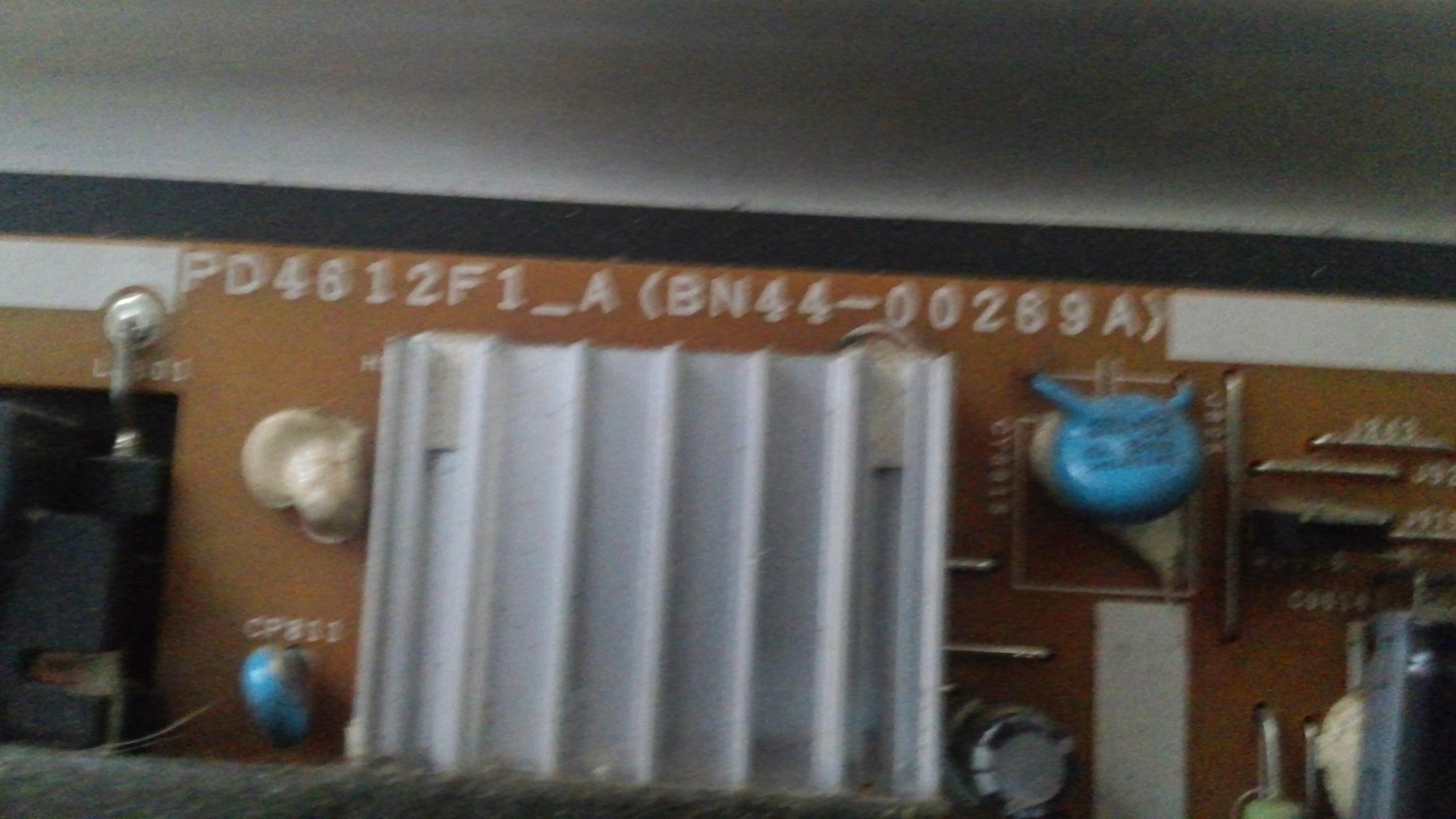

    Hello everyone, My Samsung led tv recently stopped working and the problem seems to be the mainboard as pointed out by the samsung tech guy. Sadly it cant be replaced as samsung doesn't have a spare board nor can i find it on the internet. The problem started after a sudden power outage while i was watching tv, settopbox connected to hdmi.
    When i turn on the tv, the red power light blinks once and i hear a clicking sound inside the tv. Once the powersupply cable is removed from the mainboard, the clicking stops and the backlight lights up. Is there any way to repair the board? or are there any compatible boards that would go with my tv?
    I have attached the model numbers of my mainboard and powersupply, Any tips/suggestions would be of great help!

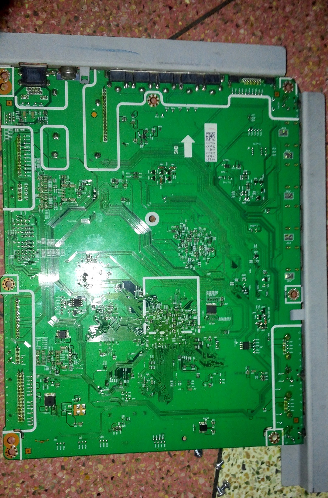

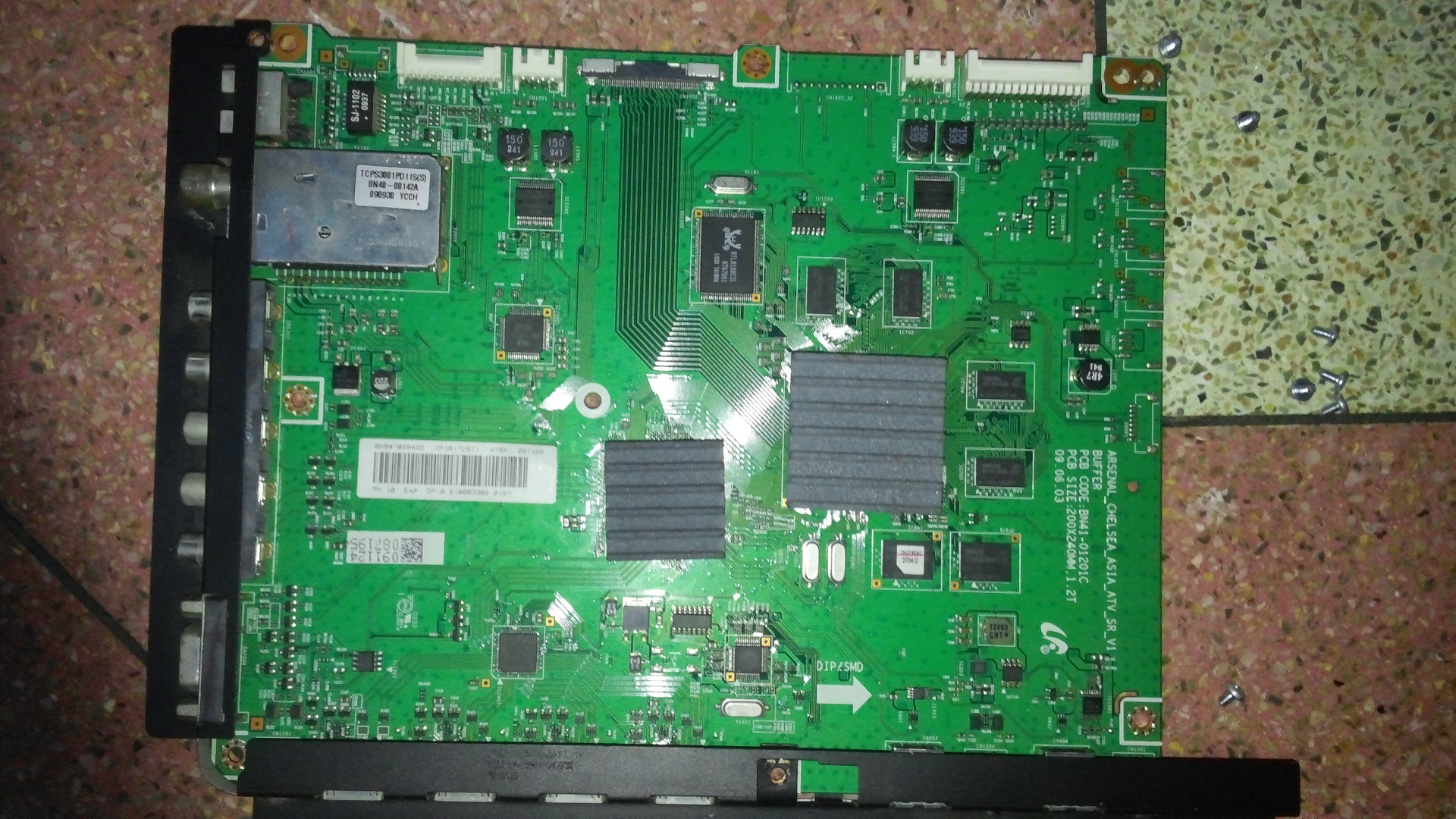

    can i get a good picture that shows the entire mainboard? I just stripped a couple led samsungs,will check then if i have a mainboard. Sometimes different bn41 numbers can match.
    On fixing your mainboard,you can try and measure all voltage regulators,maybe you get lucky and find a defective one. often eeprom just goes corrupt on power jolts like that.

      We need really good pix of the front and back of the main board.

        Thanks for the reply guys and sorry for the late reply, i was outta town. I have attached the full pictures of top and back view of my board. Will any other board work with my tv?

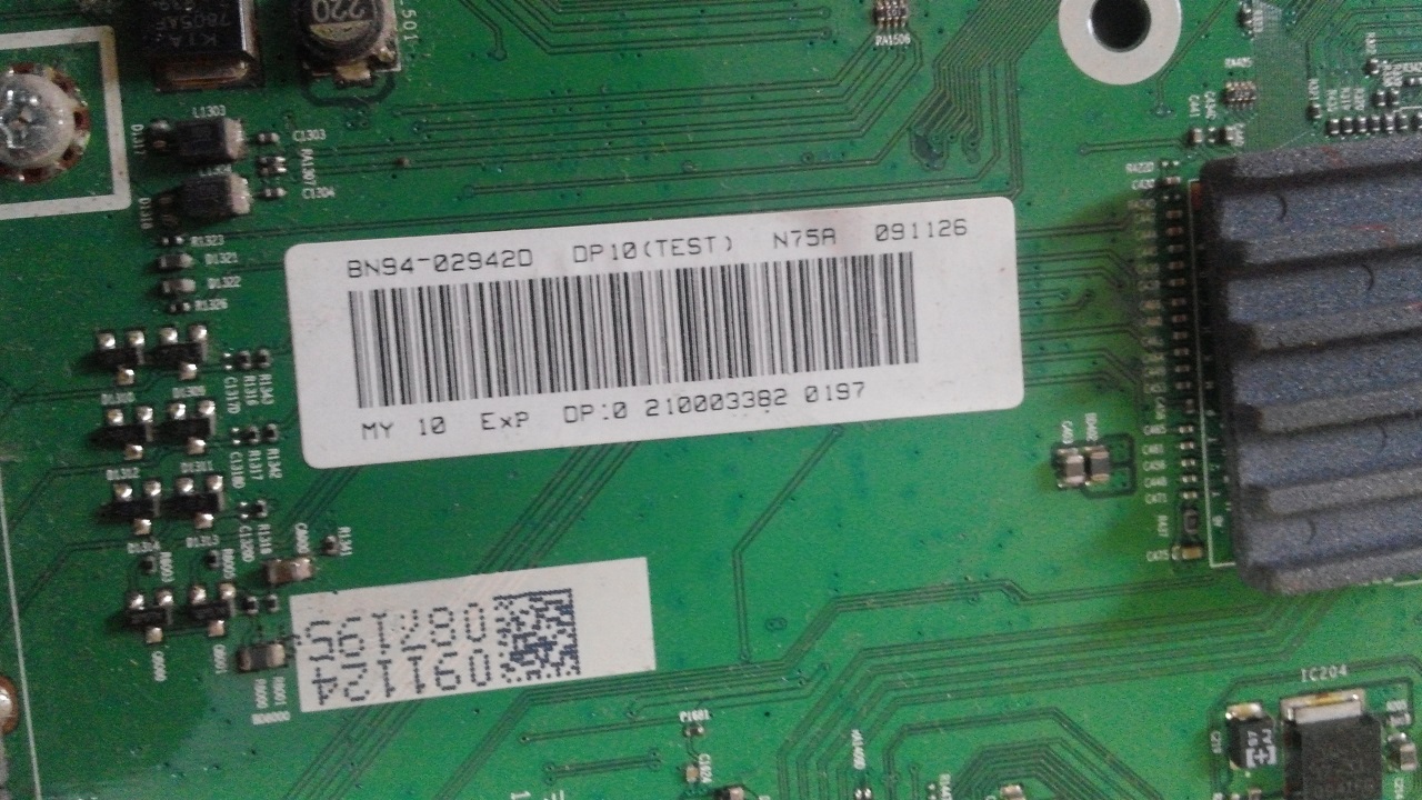

            Big white rectangular sticker, left and center of board,picture #1. It has a BN94-XXXXX number. That's the number you have to do a internet search for.

              Re: Samsung UA40B7000 LED TV Clicking sound, Doesn't turn on.
              I guess i am outta luck, tried searching that but not a single result
