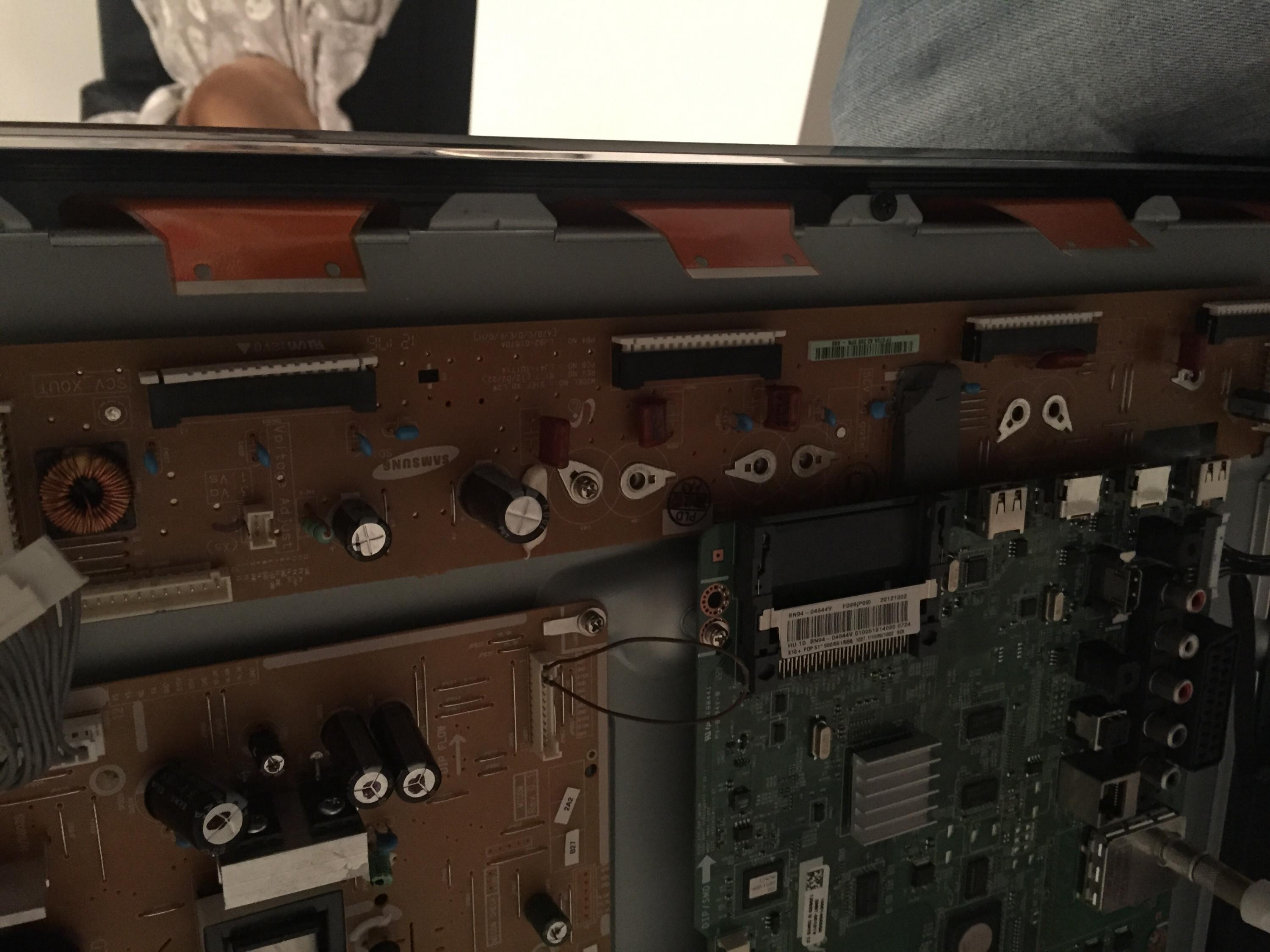

Re: Problem x-board on Samsung PS51E550OD1P
I agree 100%, I don't even bother wasting my time downloading SM anymore.
Problem x-board on Samsung PS51E550OD1P
Re: Problem x-board on Samsung PS51E550OD1P
Service-manual will be utterly useless anyway--No schematics are ever included for Samsung sets--like most of em these days. Firelighter fodder only.
--If Y is bad, all the service-manual will say is replace it!
--Pointless rubbish--not a service-manual, its a joke!Leave a comment:
Re: Problem x-board on Samsung PS51E550OD1P
Where i can see the chassis number of this tv? I don't find any service manual with product numberLeave a comment:
Re: Problem x-board on Samsung PS51E550OD1P
Shorted transistor, they are mounted under the pcb. Remove it and test them for S/C.Leave a comment:
Re: Problem x-board on Samsung PS51E550OD1P
probably...but this could be caused by what ? the board of the tracks are in good condition ... it could be a mofset or resistance ?Leave a comment:
Re: Problem x-board on Samsung PS51E550OD1P
Vs on the Xmain or Ymain either way thats a dead short to ground on the Vs input which is not good ?Leave a comment:
Re: Problem x-board on Samsung PS51E550OD1P
Ok, with all unplugged, in the vs ( there are 2 vs pin in the same connector), i have 0 and beepLeave a comment:
Re: Problem x-board on Samsung PS51E550OD1P
Right unplug the Ymain from Xmain and unplug Xmain from Psu. Then if you look at the connector you can see something like "Vs" put your meter in diode mode then black probe to chassis ground then red probe to "Vs" on the Xmain what do you get ?Leave a comment:
Re: Problem x-board on Samsung PS51E550OD1P
Yes i can do it... But i must do it in x-main board?Leave a comment:
Re: Problem x-board on Samsung PS51E550OD1P
Right does your DMM have a diode mode ? Also do you know how to check for S/C ?Leave a comment:
Re: Problem x-board on Samsung PS51E550OD1P
Anyone that can help me please?Leave a comment:
Re: Problem x-board on Samsung PS51E550OD1P
Thanks for reply, but if i connect the xmain, the vs voltage must be present? Because i just try with only x-board connect, and i can see only 5 and 15vLeave a comment:
Re: Problem x-board on Samsung PS51E550OD1P
The Ymain gets it power from Xmain on these common issue is Ymain failing but makes the Xmain appear to be at fault as they share the energy recovery circuit.. Unhook the Ymain plug and try to boot also check for S/C between Vs and ground.Leave a comment:
Problem x-board on Samsung PS51E550OD1P
Hi, i have a problem with a Samsung plasma PS51E550OD1P
The problem is that the X- buffer low board (lj41-10171a) doesn't work correctly, when this board is plugged are present only 5 and 15v, there aren't VA anD VS voltage.
I just try to test the power board without the x-board ( i make a bridge between vs-on and 5v) and the vs and the va are correct.
On the xboard i don't see any faulty, all the capacitors and the SMD resistors are good... Where is the problem?
Sorry for my english please
Attached Filesif you find these attachements useful please consider making a small donation to the site
Tags: None
This specification for the Samsung Galaxy Book 2 Notebook can be useful for upgrading or repairing a laptop that is not working. As a community we are working through our specifications to add valuable data like the Galaxy Book 2 boardview and Galaxy Book 2 schematic. Our users have donated over 1 million documents which are being added to the site. This page will be updated soon with additional information. Alternatively you can request additional help from our users directly on the relevant badcaps forum. Please note that we offer no warranties that any specification, datasheet, or download...09-07-2024, 05:50 AM
by howardc64Fixed a 9 year old UN55JU650 by replacing backlight. Original backlight LED was still working after 27k! hours but terrible picture of course. Few LEDs were out, 5-6 lens fell off (bright white spots) and another few popped off with slightest force. Surviving LEDs were all slightly blue so picture has a blue tint.
This TV runs older Tizen OS (updated to latest version, see pic) and have problems with network (wifi or ethernet) connection. The Tizen UI frequently switch to coax input source while changing content sources. . If no good signal (coax not connected, no prior antenna/cable... -
by alro7779Hello, everyone!
A co-worker gave me a 55-inch Samsung TV model UN55MU6103F so I can try to fix the following problem... As soon as I plug it in to the wall, the TV turns on, and the display shows a few stripes all over the screen. I took off the back cover and disconnected both ribbon cables that go to the display (one at a time) so by doing that I can narrow down the bad section of the problem, but in both cases the display turns black. I know there are some voltages that I have to check (VGH, VGL, etc.) but don't know what reading each has to show. If anyone could guide me on this,... -
This specification for the Samsung Galaxy Book Ion NP950XCJ Notebook can be useful for upgrading or repairing a laptop that is not working. As a community we are working through our specifications to add valuable data like the NP950XCJ boardview and NP950XCJ schematic. Our users have donated over 1 million documents which are being added to the site. This page will be updated soon with additional information. Alternatively you can request additional help from our users directly on the relevant badcaps forum. Please note that we offer no warranties that any specification, datasheet, or download...09-06-2024, 11:40 PM
This specification for the Samsung Galaxy Book Ion NP930XCJ Notebook can be useful for upgrading or repairing a laptop that is not working. As a community we are working through our specifications to add valuable data like the NP930XCJ boardview and NP930XCJ schematic. Our users have donated over 1 million documents which are being added to the site. This page will be updated soon with additional information. Alternatively you can request additional help from our users directly on the relevant badcaps forum. Please note that we offer no warranties that any specification, datasheet, or download...09-06-2024, 11:40 PM
- Loading...
- No more items.
Leave a comment:
