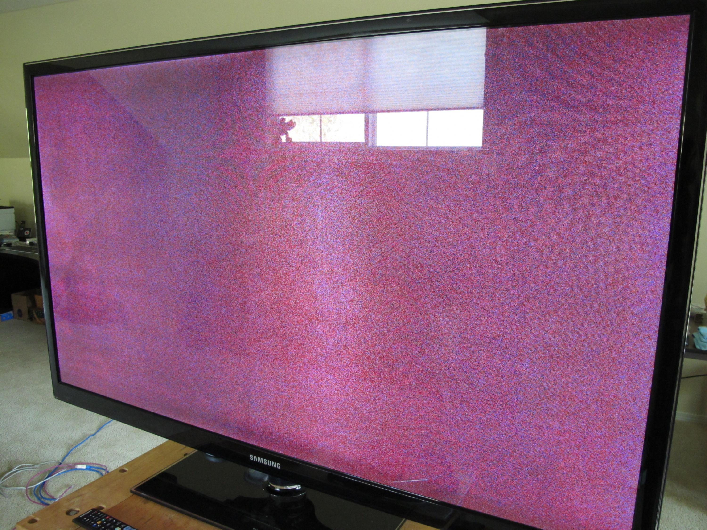

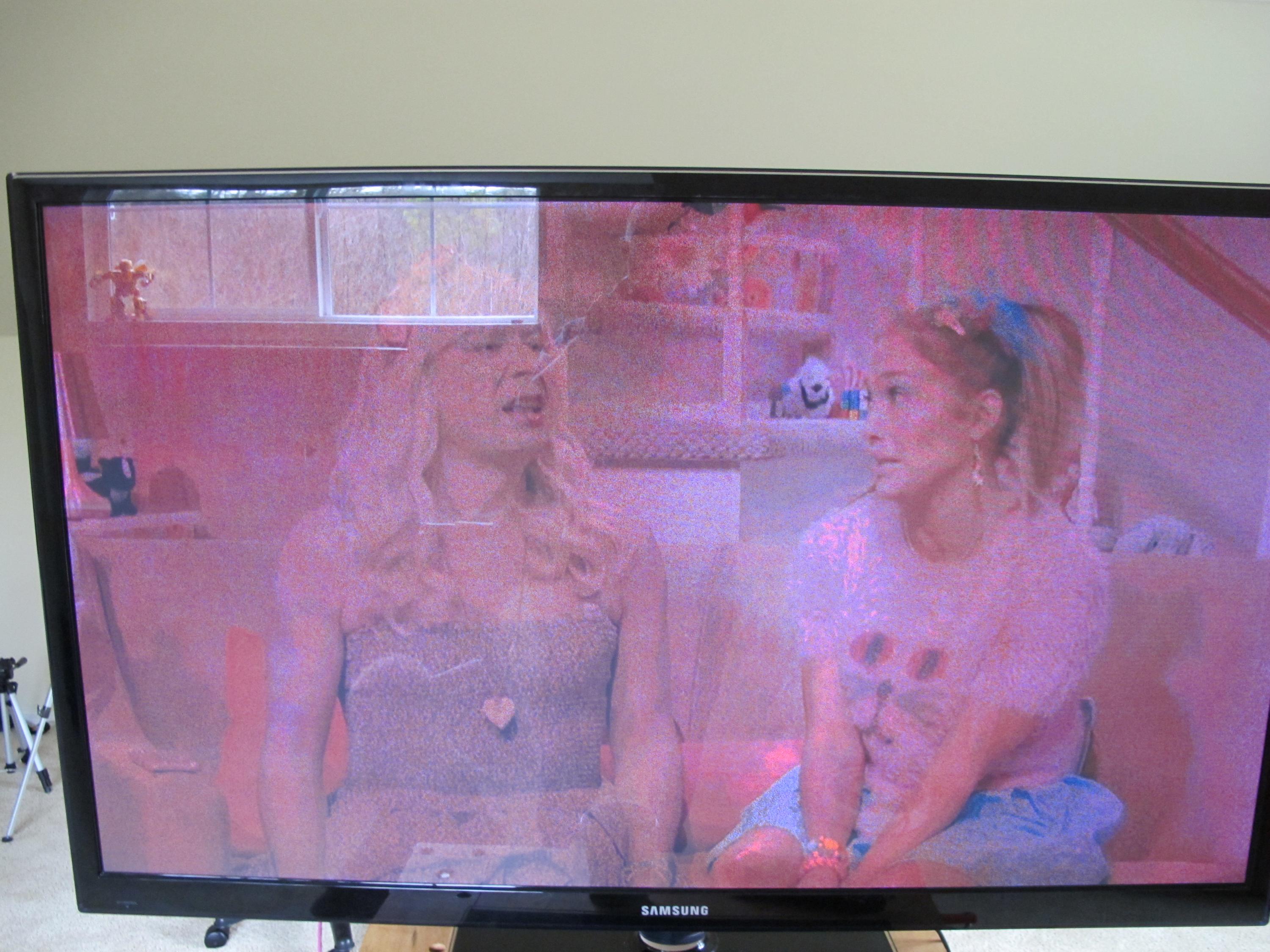

    I have a Samsung PN60E550D1FXZA Plasma with a born date of December 2012. Has pink noise color issue. see picture. TV powers on, connects to network, updated the firmware, can watch video but there is a pink cast to the display. Tried the BN96-22114A module, but no joy with that.
    As a note: I looked at all caps and found nothing visually bad. I do hear a very slight buzz from the top left and right main boards.
    thoughts on next steps?

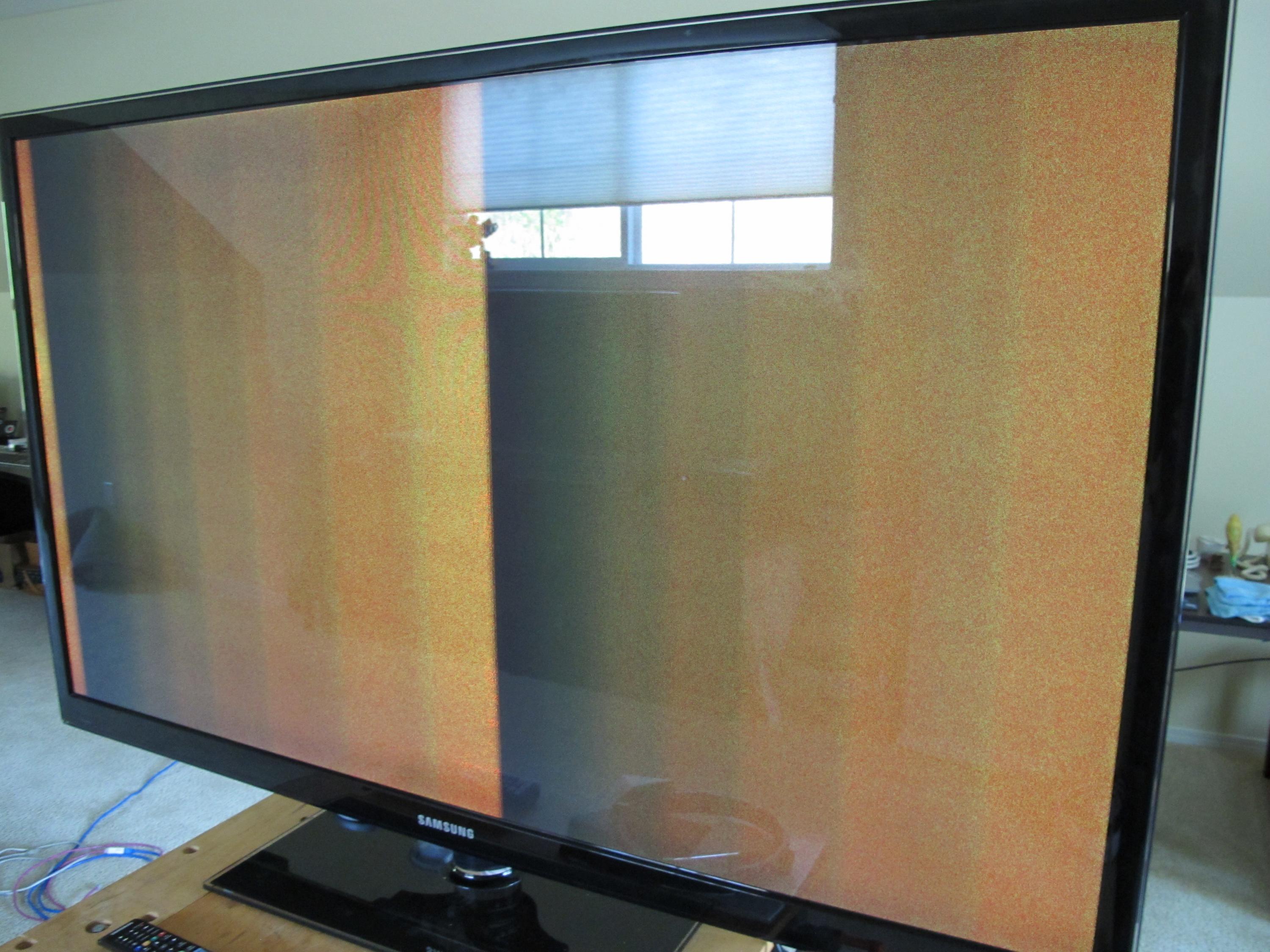

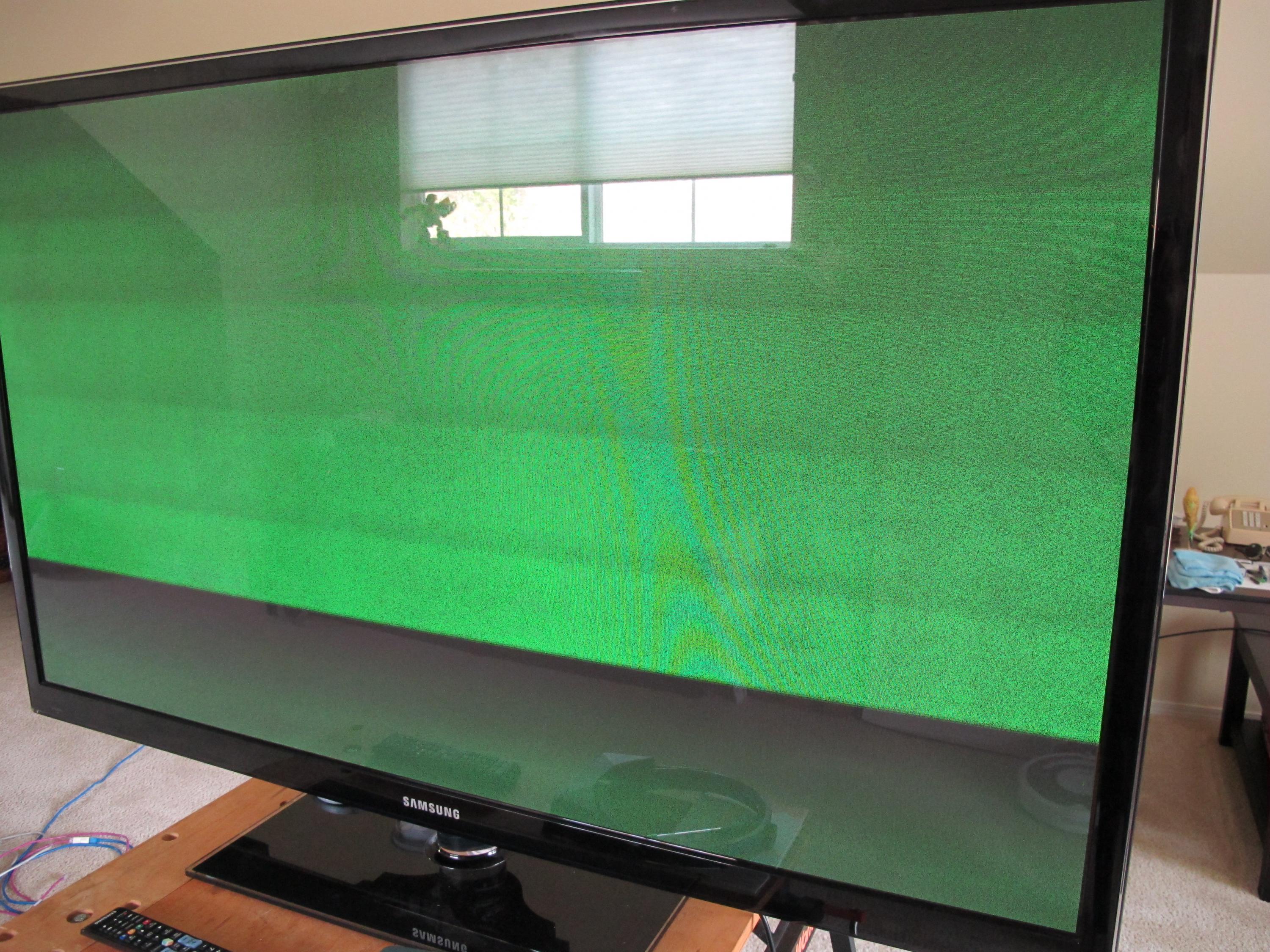

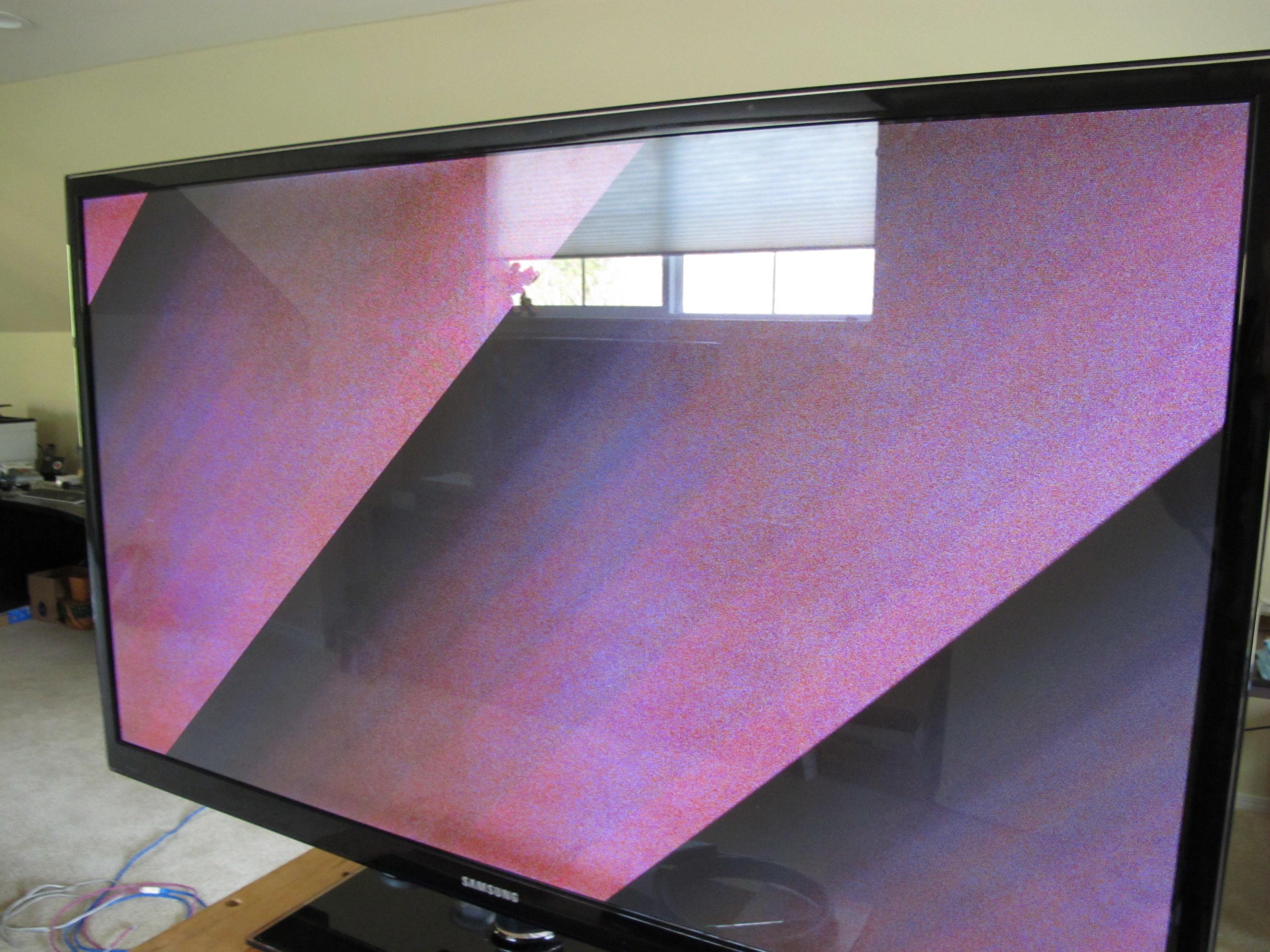

          Well try running test patterns with the main board unplugged ? this will show that the main is good or bad and cross that off the list. on the control board you will see four pins or holes marked 1-4, connect pins/holes 3-4, then with the cable from the power board to main board unplugged the test patterns should run when set is powered from wall socket(power board could need PS-on grounding but think on these newer sets when pulling the main PS-on goes low on it own if not just link PS-on to ground on the plug you have pulled from the main ) Flocko
          • chuckpen
            • Jul 2009
            • 11
            Re: Samsung PN60E550D1FXZA pink noise
            Flocko,
            Thank you for this step. Ran set in self test and still see the issue. Couple pic's attached. As an FYI had to jumper PS-on to low to get set to start.

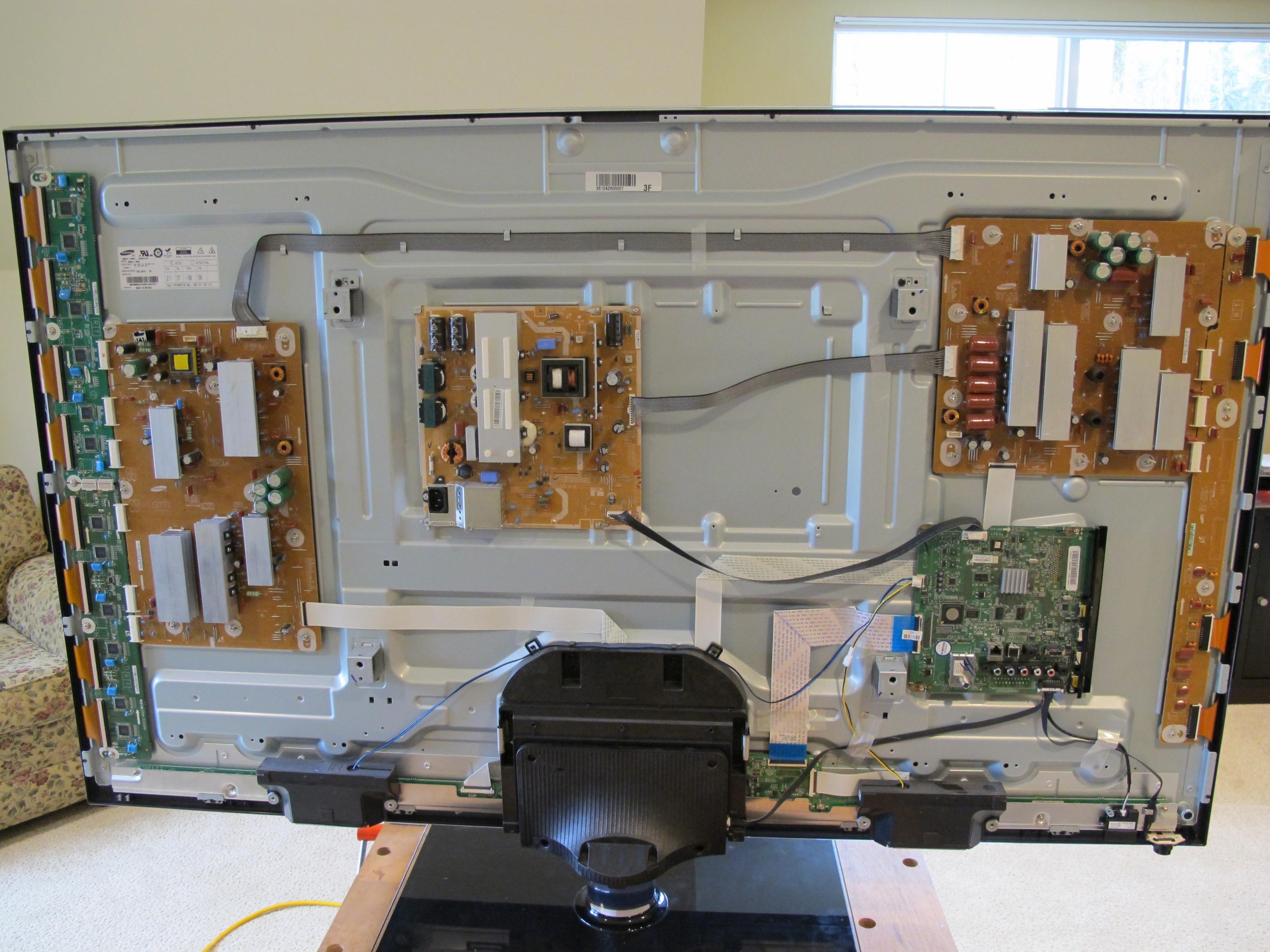

                  I would try changing the Y Sus board, We now know its not the main board as it runs Test patterns test from control board and these still show the problem. My bet would be with the Y Sus, have seen this on other models. Do not play with the voltages leave set as per sticker this fault will not get any better playing with the voltages and could give you more problems
                  • chuckpen
                    • Jul 2009
                    • 11
                    Thanks Flocko,
                    I will acquire a Y SUS and update once received and installed. I also see what appears to be a pretty thorough repair kit for these boards. Any thoughts on that? I have a good amount of soldering experience so that does not bother me. Looks like a refurb board is about $125 these days, and the kit is about $34. Thoughts on this? Too difficult a R&R?

                            Thanks to everyone providing guidance and insight into this issue. I received a replacement Y Sustain module and it has repaired the screen. Now, off to find another project TV and an O'scope for my further forays.
