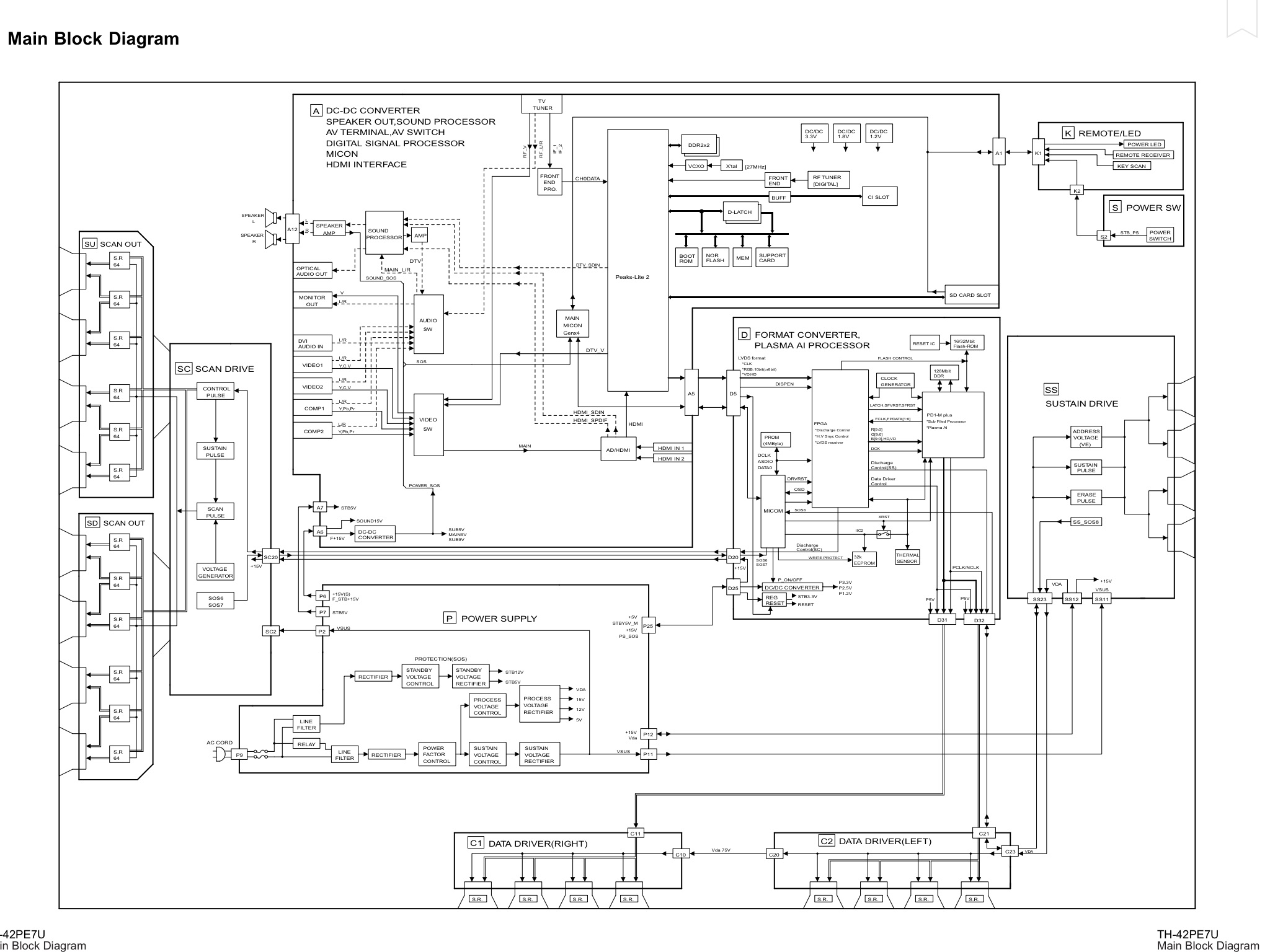

Panasonic th-42pe7 12 blinks
  • Malachi
    • Dec 2015
    • 1077
    • Usa
    I have a th-42pe7 with 12 blinking sound SOS that I got for a 12 pack. A main board is $100.
    Not worth it. And it's a 720p.
    Could someone with limited soldering skills repair the mainboard?

    Have you eliminated shorted speaker wires or damaged speakers first?

      Re: Panasonic th-42pe7 12 blinks
      I completely disconnected the speakers from the board. That didn't help.
        Have you got the manual, had a look at the circuit yet? Audio IC is pretty big . Could be a challenge but as you say these older Tvs are not getting much value.
          Does this help?
            I got a supposedly working mainboard in today. I've replaced the SC board and SS board, they were cheap, $15.
            The green LEDs on the boards turn on but I still get 12 blinks.
            I'm left with the psu, control board and Lower buffers.
            Any ideas?
              Could it be the D-board, the logic board?
                Ohh my days I love the diagnoses here, so in depth and accurate. Were willing to help just please stop throwing parts at it Malachi save yourself money and learn along the way !
                Maybe try running the test patterns I know you can override some errors on Panasonic's into test patterns.
                  According to the service manual, if the SS and SC board LEDs light up its a bad D-board.
                    I see just realised the thread dates, I dont mind and im sure others dont mind you boosting the post we can help just might not be first thing. Its a forum with alot of members so anyone could comment. Also does sound like a D board to me just resing the SM now.
