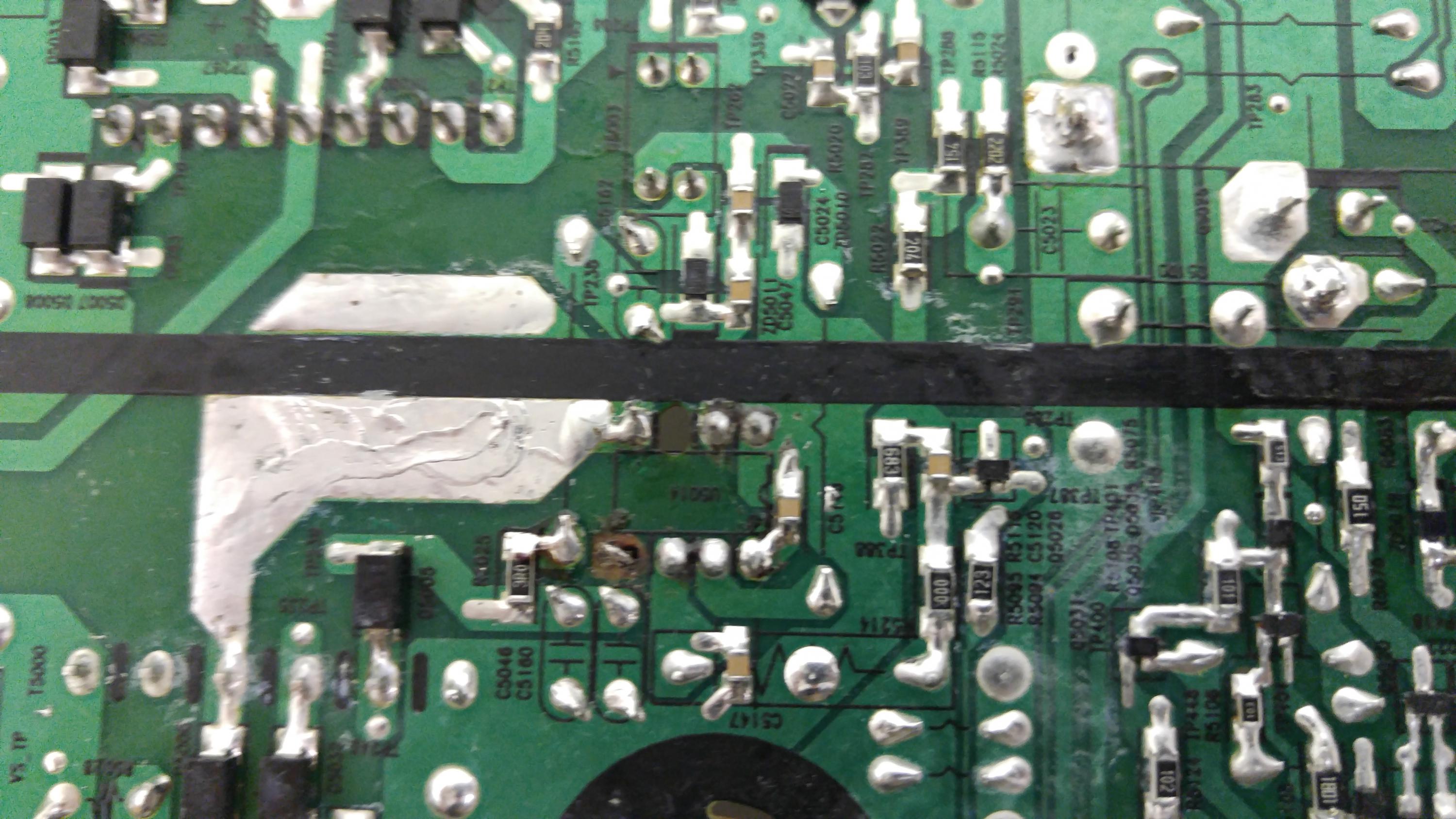

    Vs and va go up to 211 and 57 respectively but slowly start going back down to 0 volts. I get sound but no pic. Other thread said freeze IC. U5014 on the Y-main/sustain.

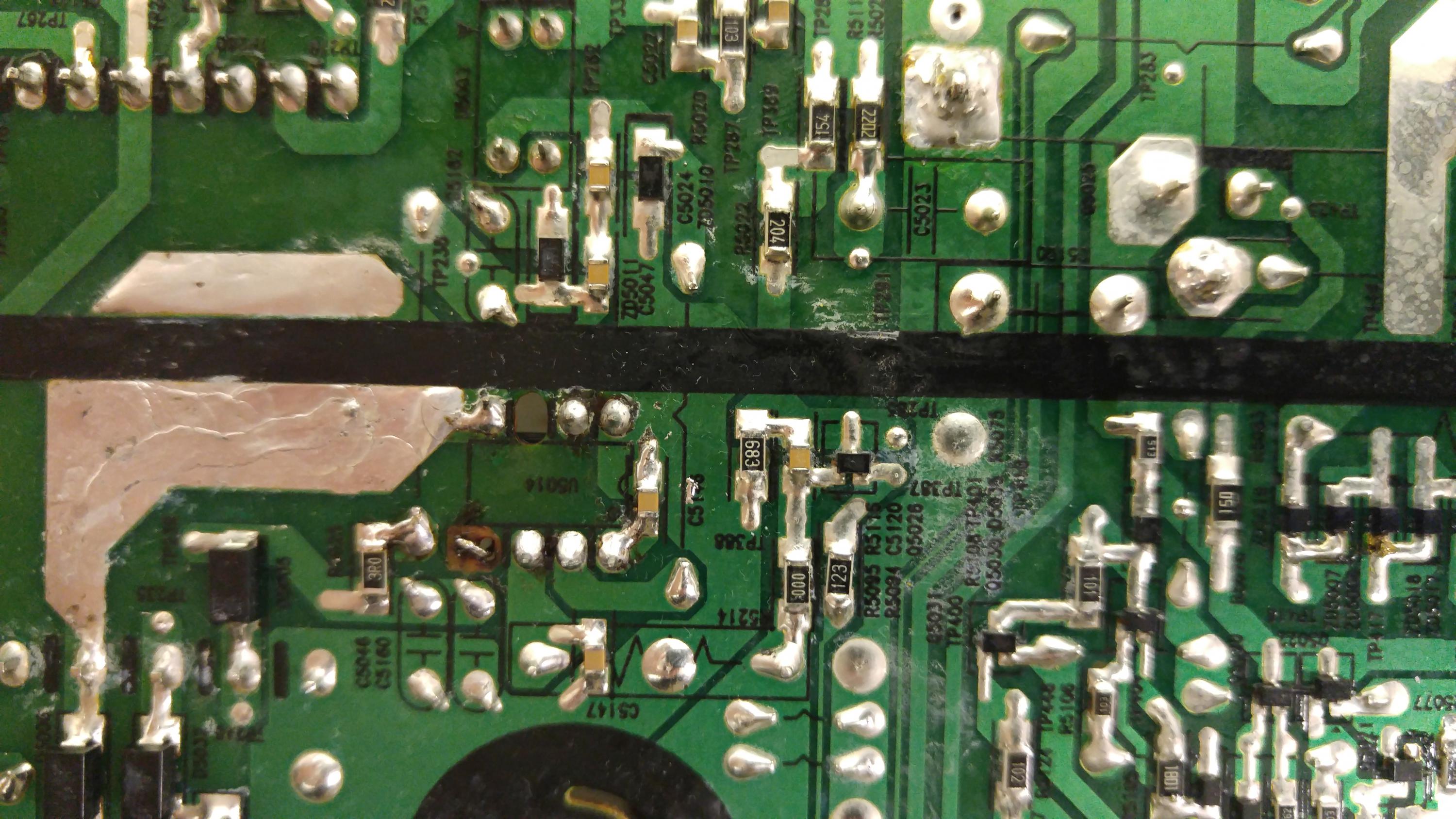

    I did and got good constant voltages and the tv turned on with proper picture. I go to order IC 3BR0665JZ to fix it but the new one does the same thing. Seller says I need to buy their full repair kit that includes 3 ceramic caps as well. So he send me a new IC and the 3 caps. I decide to replace the new IC first but screw up by having my soldering iron on to hot and leaving it on the pad to long. So the pad for the top left pin stays on my iron as I am using desoldering wick to get ride of old solder off the pad. Top right pin if you are looking at the ic from above but top left if looking on soldering side of the board.
    Any help as to how to fix this would be appreciated.

    Either scrape the masking around the missing pad down to the copper and solder it to that.
    Or solder a bit of wire to the leg, and connect the other end to the next part in circuit.

      I was hoping to go with option B but I dont know which is the next part in the circuit and for some reason I am unable to load pics. I will try loading pictures again in the next hour or so. Also I have never scraped masking around a missing pad, so if it does come to that, do you have any tips for me?

        finally got the pics to upload

          Missing pad is NC.

            That's probably why it came off so easily.
            Thanks for that. Very much appreciated. Will give an update once the set is fixed.

              Thanks got the new IC in there along with the replacement capacitors and the set is up and running properly now!

                  The pad the lifted went to a 'No Connection' or 'NC' pin on the IC so it was not needed.

                    Yeah I ended up just leaving the leg floating there.
