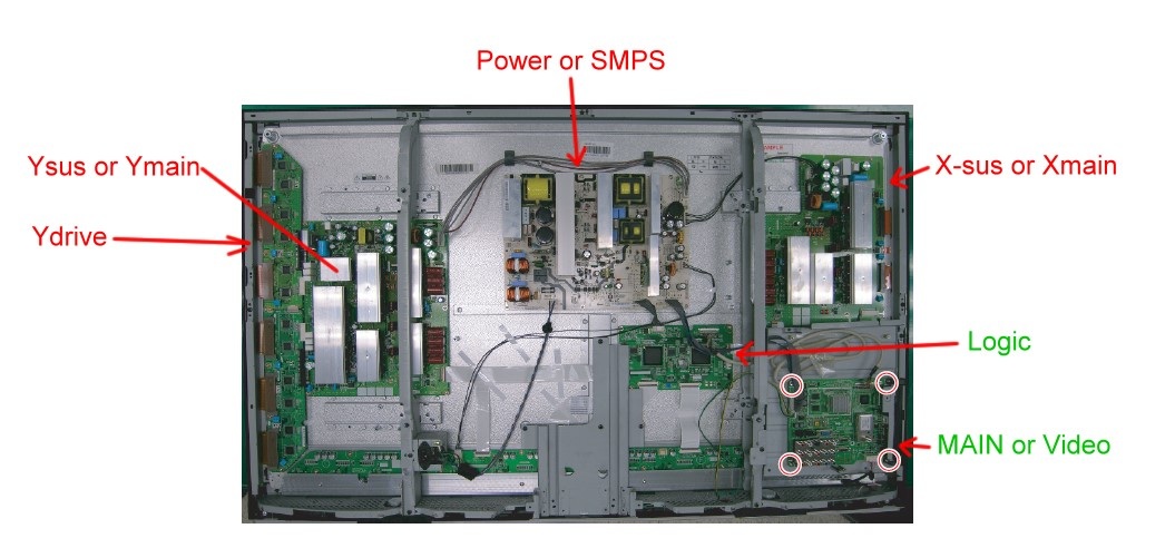

LG 50PC55 Plasma–multiple attempts to turn on; but now no image... help
  • mojo7676
    Mojo7676
    • Nov 2015
    • 19
    • uk
    Newbie to the forum and fairly inexperienced when it comes to TVs – I don't have a digital multimeter. Apologies if this post seems long, but I hope the details are useful. For at least the last couple of years, our LG 50pc55 has had a rather odd and annoying fault which we couldn't be bothered repairing. When you switched the TV on, after it had been off over night for example, it would take maybe 10-15 attempts to switch on either through the power button on the tv or the button on the remote control. Eventually it would come and all would be well. If you switched it off then switched it back on, it would come on again immediately. If you switched it off and left it for an hour, then it would take maybe 3-5 attempts to come on. Sound and picture were always fine when it was on. However, a couple of days ago, this stopped. All we have now is sound but no images. I've done a few trawls and I think it might be the Y-Sus board (read Tom66s helpful guide) but I can't be sure given the earlier problem with the multiple attempts to switch on problem. I removed the back to identify the part number (EBR36223601/EAX34151501) and can get a replacement board for around 30 quid but it might be something else, like the Y-buffer/s or power board, that needs replacing. Any ideas/comments highly appreciated. Thanks in advance.

            Re: LG 50PC55 Plasma–multiple attempts to turn on; but now no image... help
            The Mainboard has all your Hdmi input and other I/O ports.
            The control board is normally in the middle of the tv and has lots of white ribbon cables coming out of it going to the Ysus, Zsus and address buffers at the bottom of the screen.
            The Psu has the mains Ac plug going to it and is normally is in the centre at the top of the tv.
            Here is an example:
