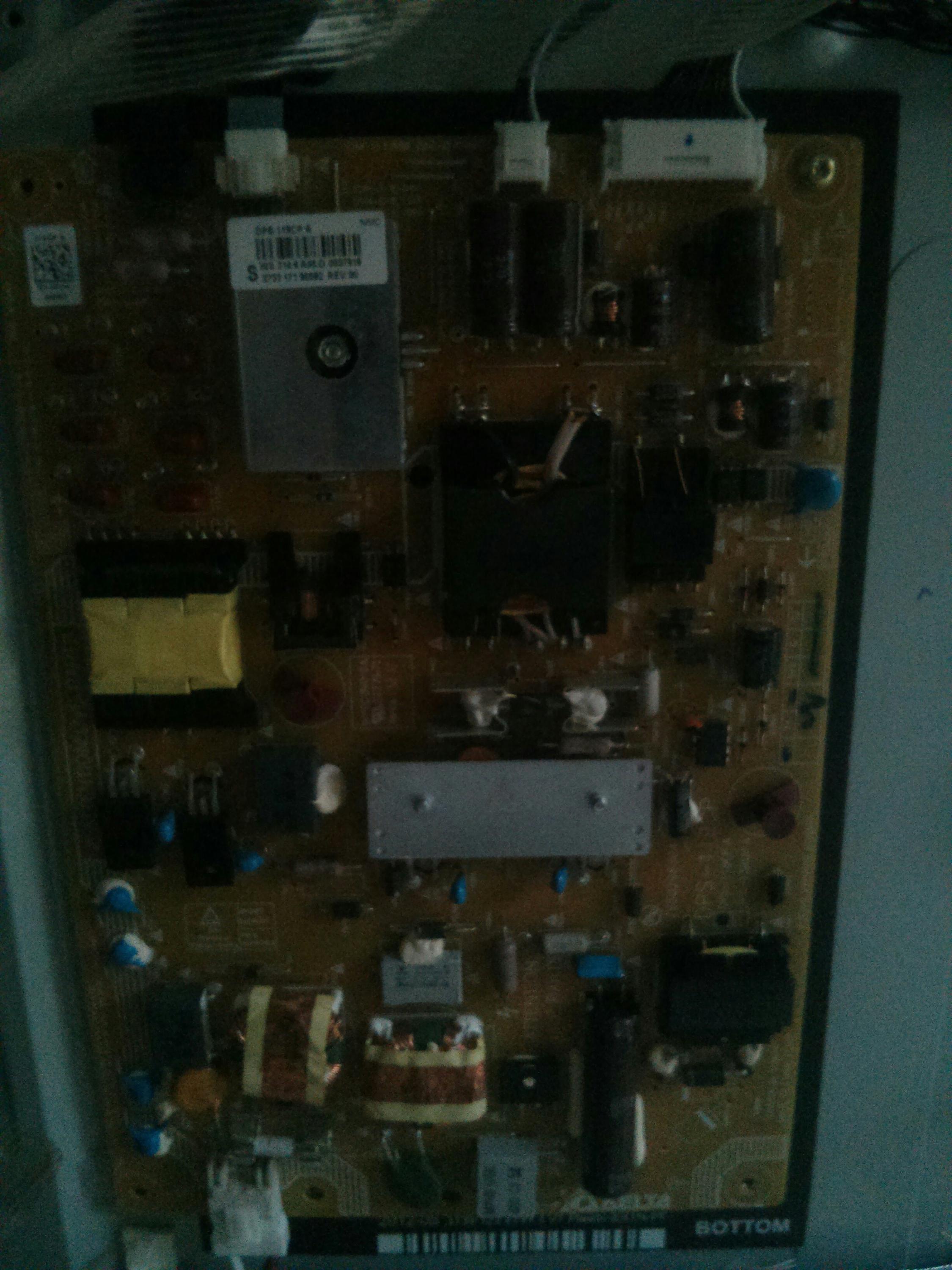

    This is my first post here, trying to fix this tv. I have measured all the voltages from the connectors from psu to ssb, and are all there
    1m99
    Gnd
    12
    Gnd
    12
    1m95
    3.3
    3.3
    0
    0
    12
    12
    12
    12
    0
    0
    0
    0
    0
    1.593v
    After 4min. the red led starts blinking twice and voltages become
    1m95
    3.351
    3.348
    0
    0
    55mv
    55mv
    55mv
    55mv
    0
    0
    0
    450mv
    450mv
    190mv
    Source is dps-119cp and ssb is 310431365664
    I don't know what to do next. Somebody can help me please ?
    Thank you in advance.
  • kastilio
    • Aug 2015
    • 13
    • Belgium

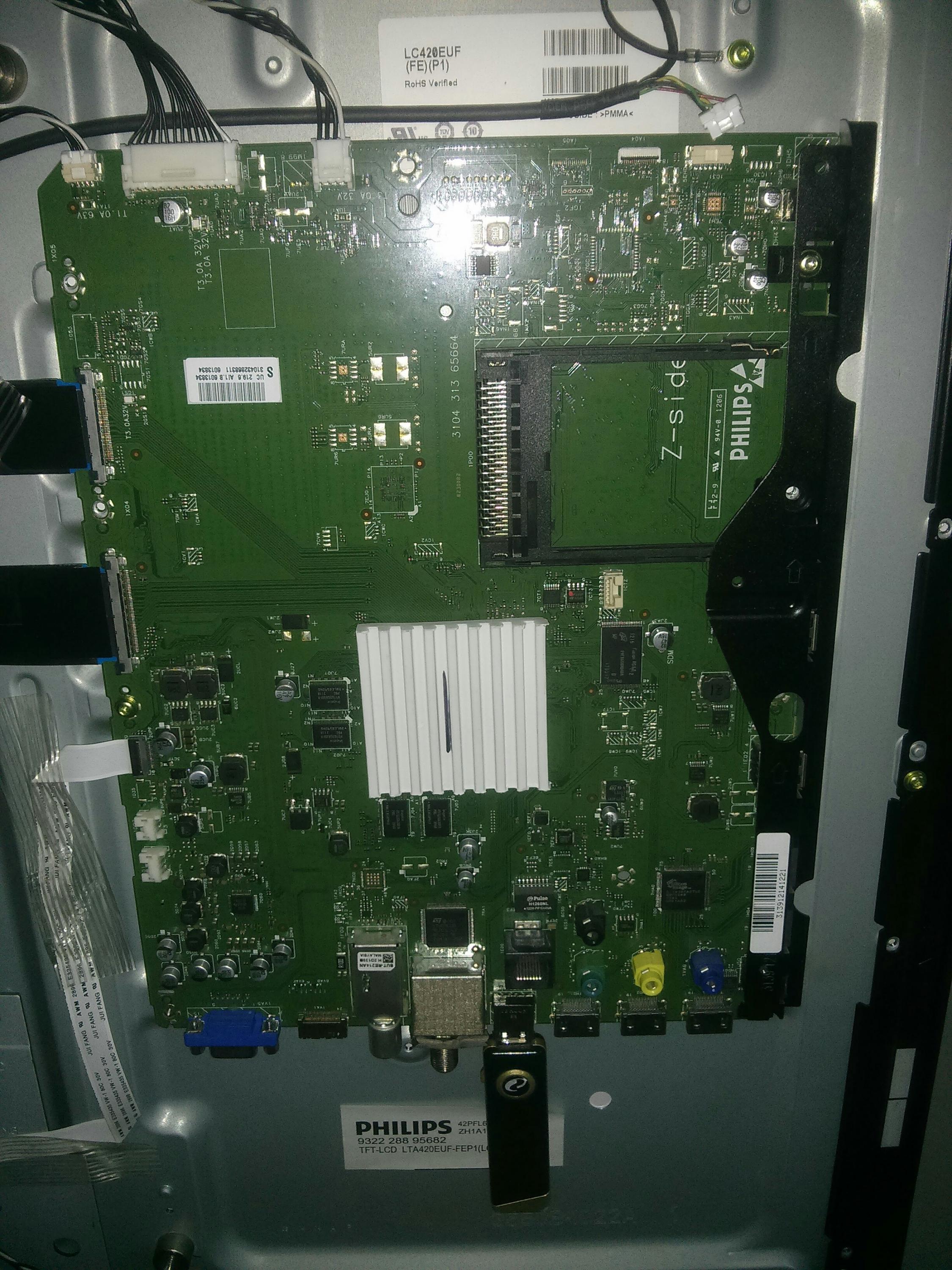

    Re: philips 42pfl6687 red led blinks 2 times
    Photos with source and mainboard

      I am having similar problems with my TV, it has the same PSU and motherboard as yours . What turned out to be the problem in your case? I suspect it was the motherboard? In my case, the LED flashes only one time when the power cord is put in the outlet and it doesn't flash anymore. I'll check the PSU shortly with my multimeter, I'm curious if I'll get your results
      • kastilio
        • Aug 2015
        • 13
        • Belgium
        For me it was the mainboard, the nandflash was bad. Still not solved .
        Did you solve it, yours?
        • Pragmatiko
          • Jul 2013
          • 468
          • IT
          yes 90% is nand flash problem
