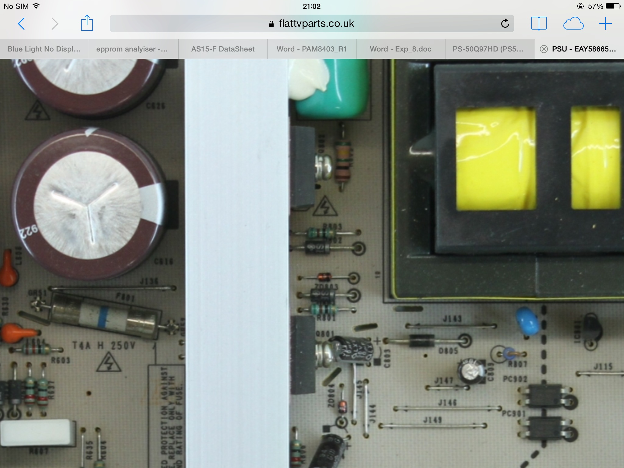

    Hi, I have a 50 inch LG plasma tv here, it seems to power up fine but getting no display, I tried disconnecting the z sustain first and got same symptoms, then tried removing power for y sustain and again same problem, also same when both removed, I tried testing va and vs voltages but both at 0, There is a blue light on the front of the tv to show its powered on but it changes to red/standby about 30 seconds after, I get voltage at both sides of all the 3 main fuses on the power board and can hear a slight buzzing from the set so it appears to power on just nothing happens on the screen at all, Any help would be great as im stuck with a 32 inch till i fix it, this ones my own tv that broke and im startin to miss it. :-o

                    Ok so I was wrong, 2 fuses on power board are ok but the 250v 4a fuse F801 is blown, Im not an expert on these now so not entirely sure what to test next,

                        Thats the Vs line fuse, more than likely the transistors that run the Vs line are shorted and have blown the fuse. Do you know how to check for S/C ?

                                    Do you know what the transistors look like ? I have uploaded a picture the two devices mounted on a heatsink are the Vs and Va fets they are connected after the fuse, if those transistors are shorted they will blow that fuse.
                                    • ReeceyBurger123
                                      Never Give Up !
                                      • May 2014
                                      • 7325
                                      • Britain
                                      Re: LG 50PS3000 Blue Light No Display
                                      Remove the Psu and check the legs on them transistors, if you get a beep when testing any of the legs the transistor will be failed and will need to be changed. To test the transistor place one probe on a leg of the device then another probe on another leg do this and check all 3 legs of the device.
