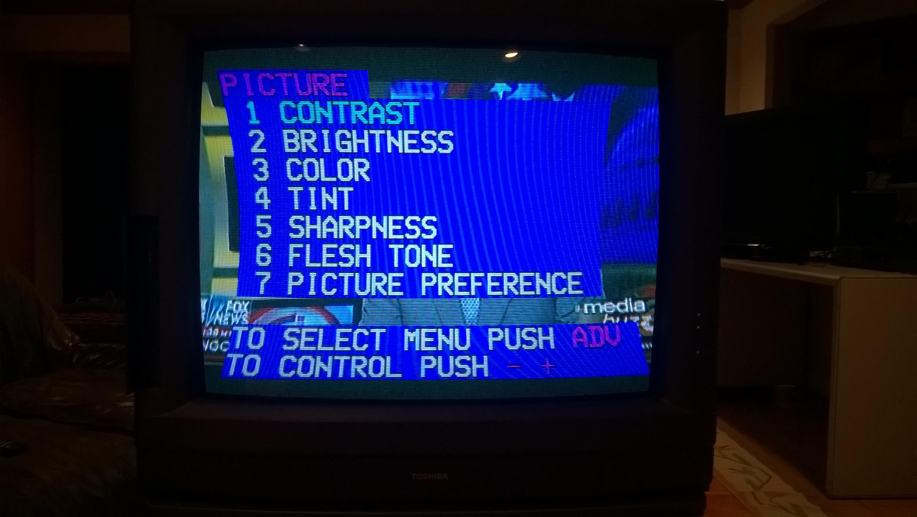

    toshiba 35 " crt
    This is a late 90's 35" Toshiba crt, when its first turned on there is horrible pin cushion effects on the screen (see pics of menu, though it affects everything obviously). I assume there is a cap somewhere that has to warm up. What area is this cap likely located? board behind the electron gun? (I know nothing about crt's so just guessing)
    Where should I be looking / testing with free spray / heat gun?

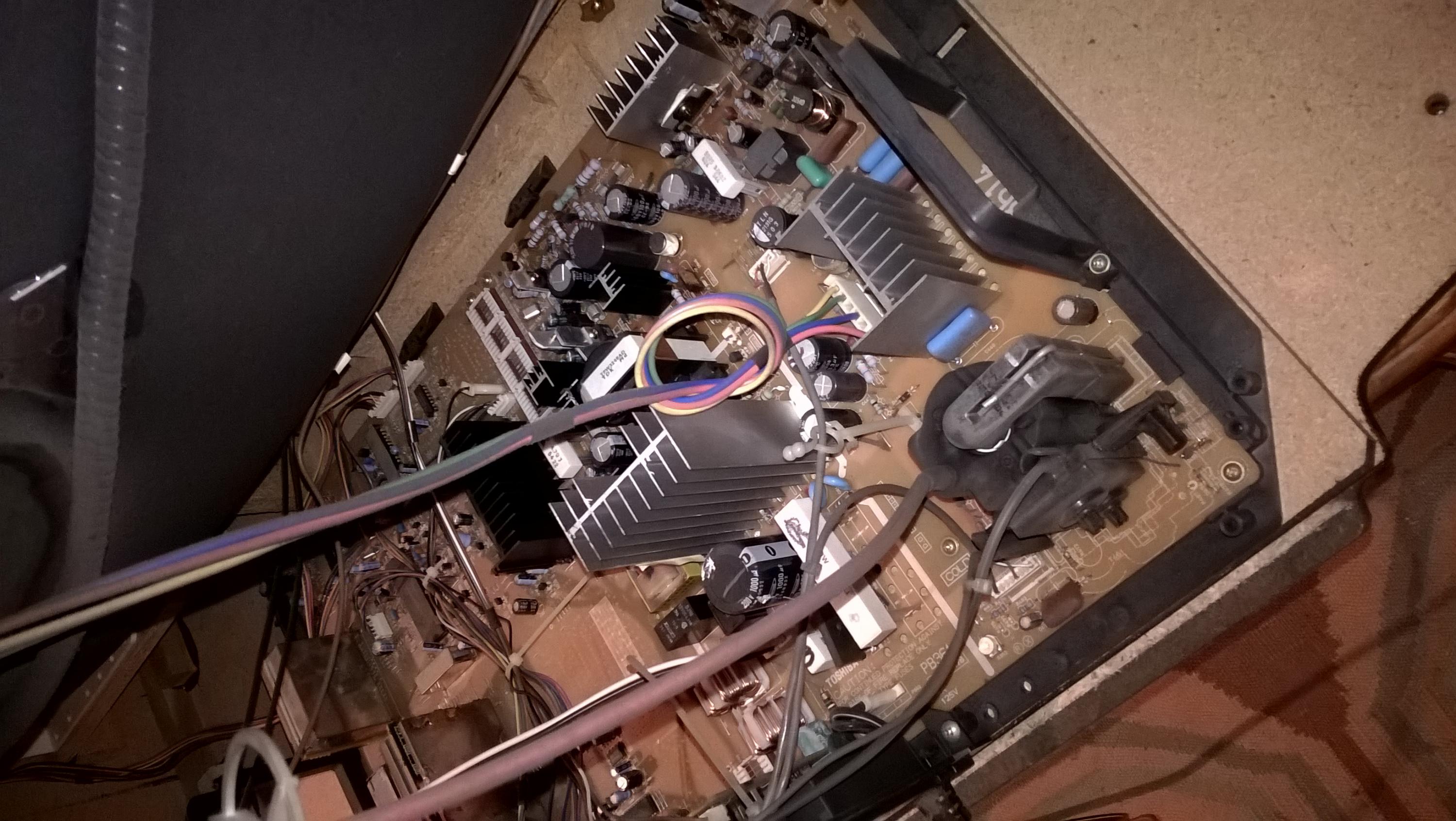

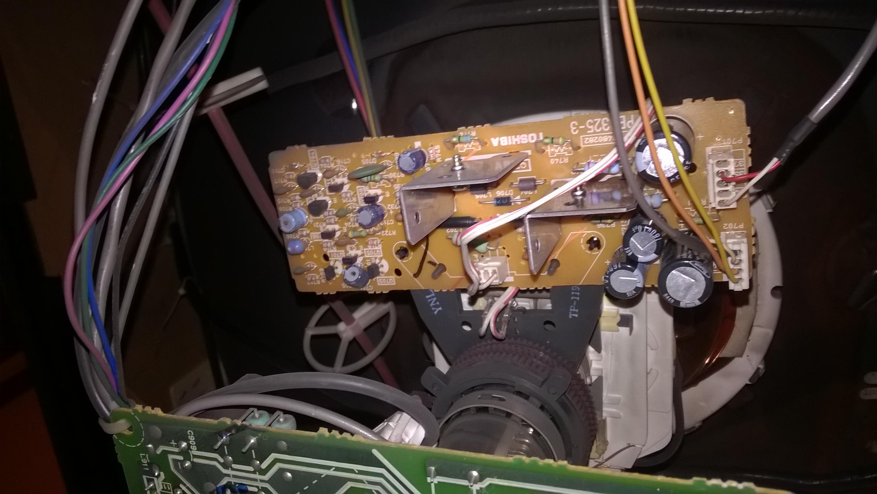

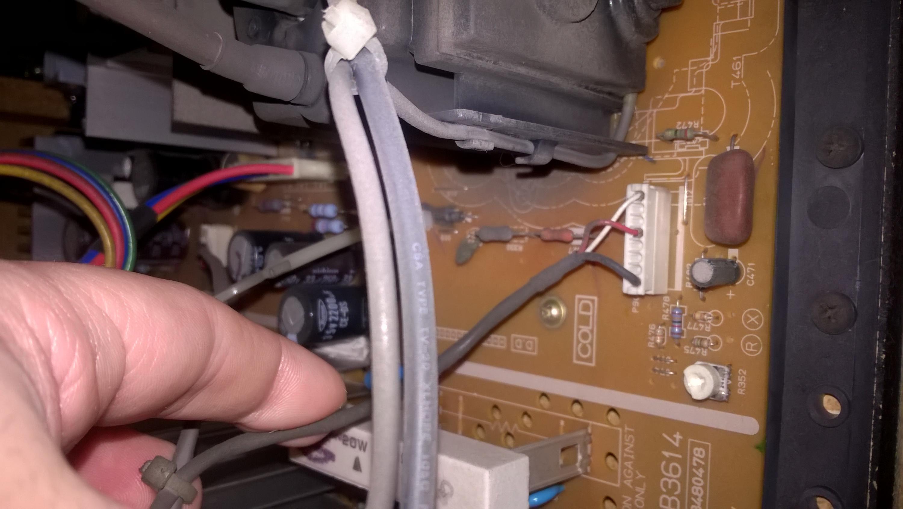

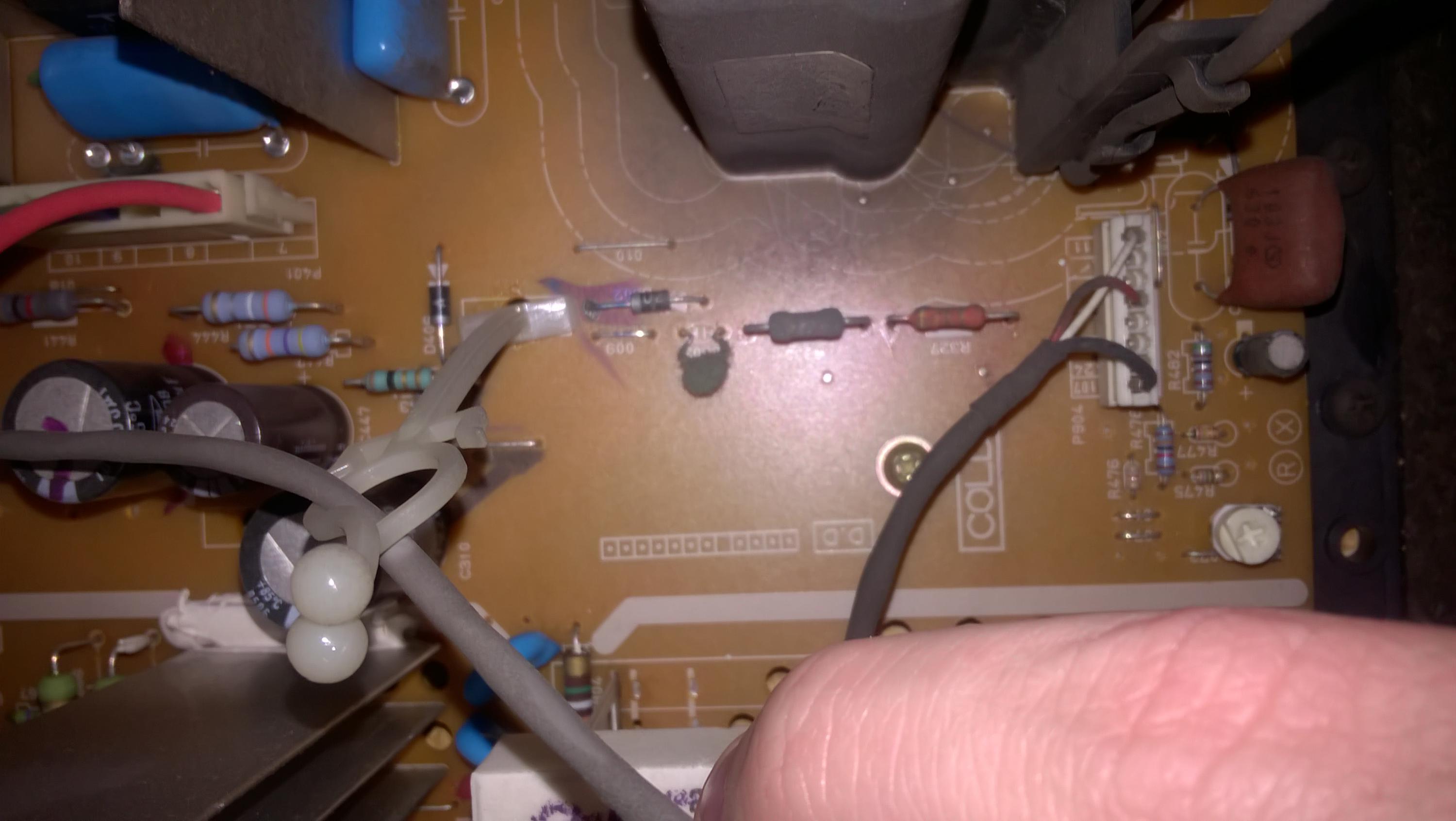

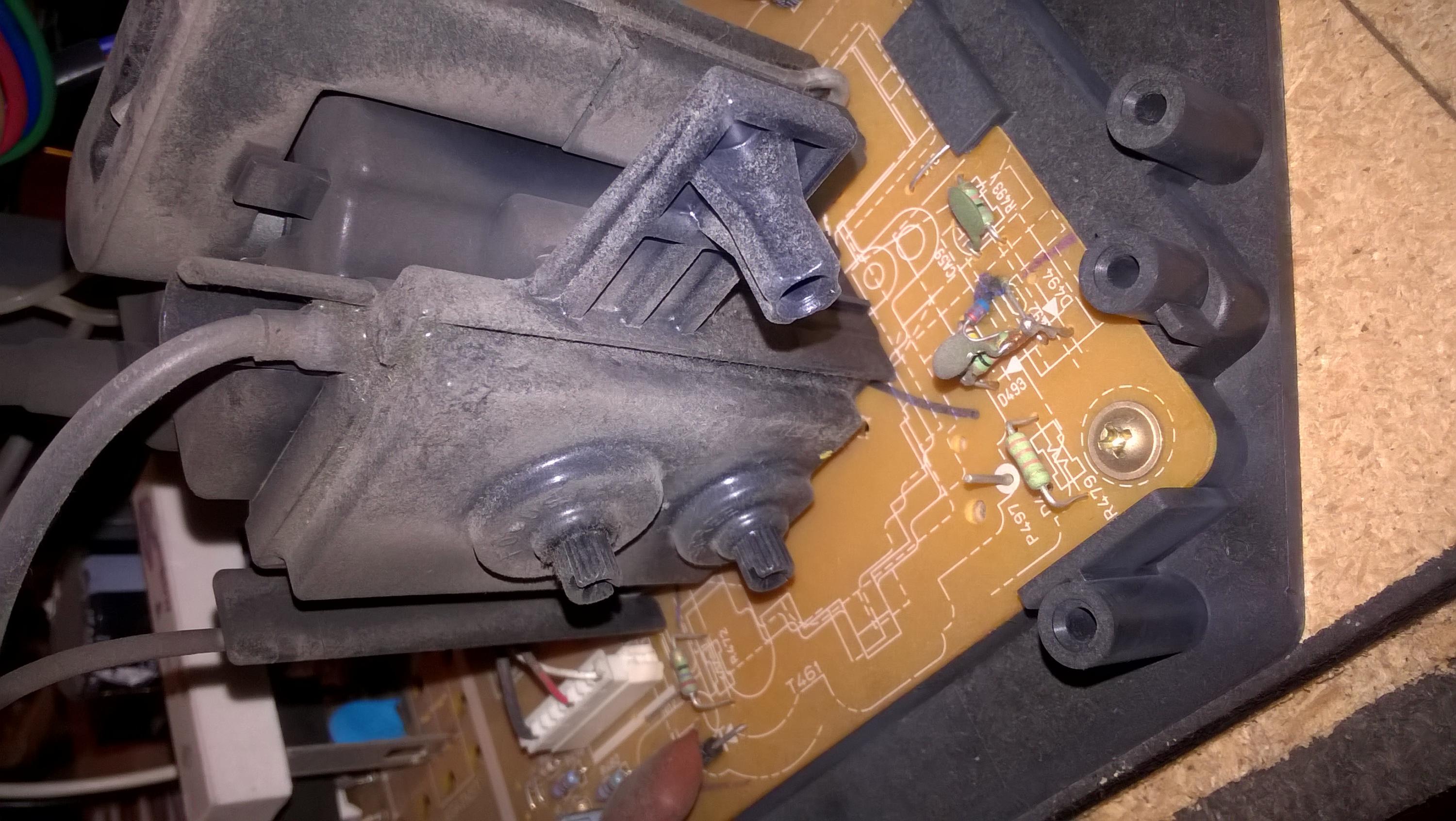

          here are some closeups of the flyback transformer, I assume it would have to be something around it.

            Test the big Filter cap and any other Hi-volt elect-caps in the Primary and Secondary power supplies. Test caps in the Horiz Osc and Output circuits including the Hi-volt Non-polarized caps as well.

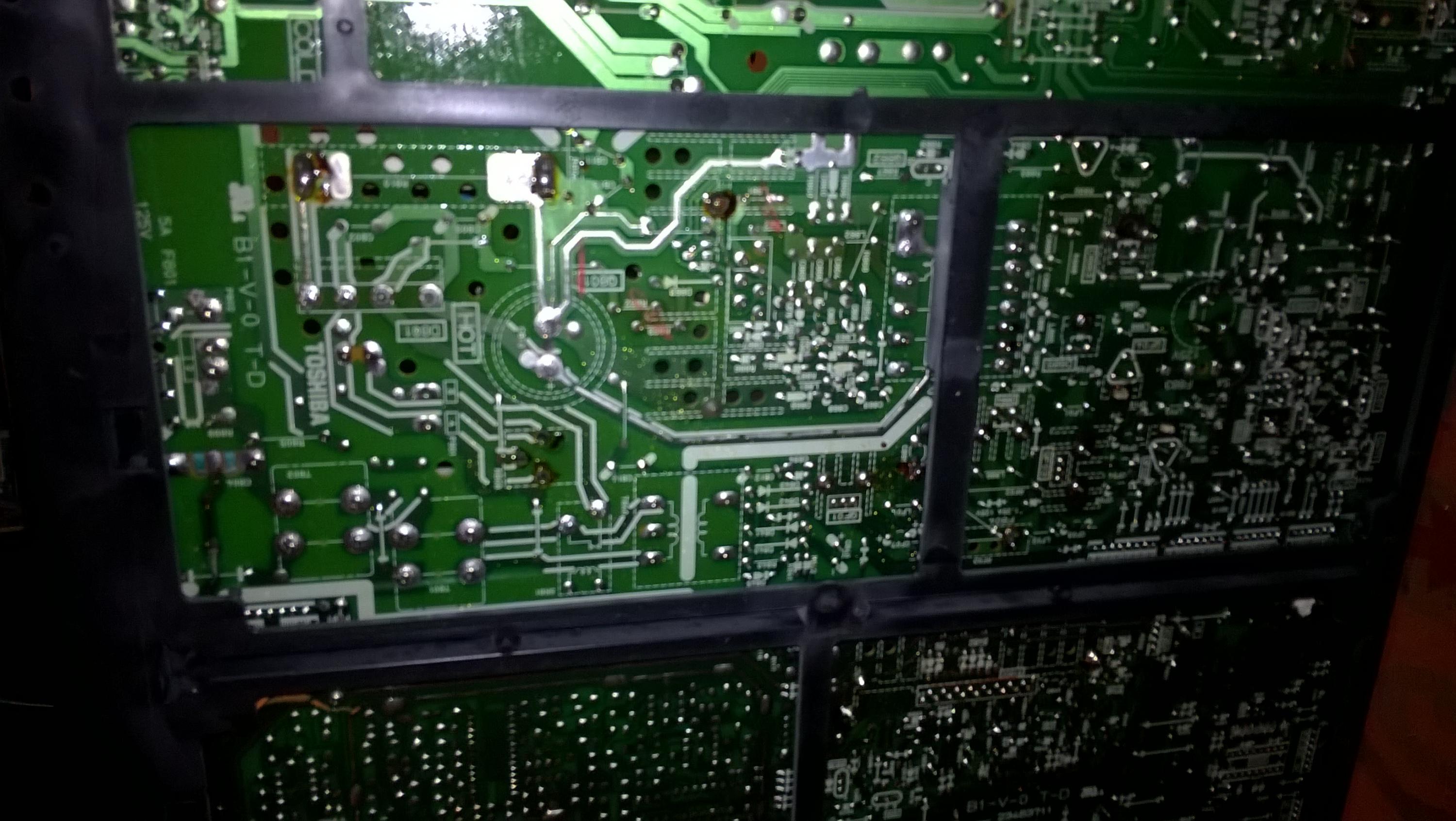

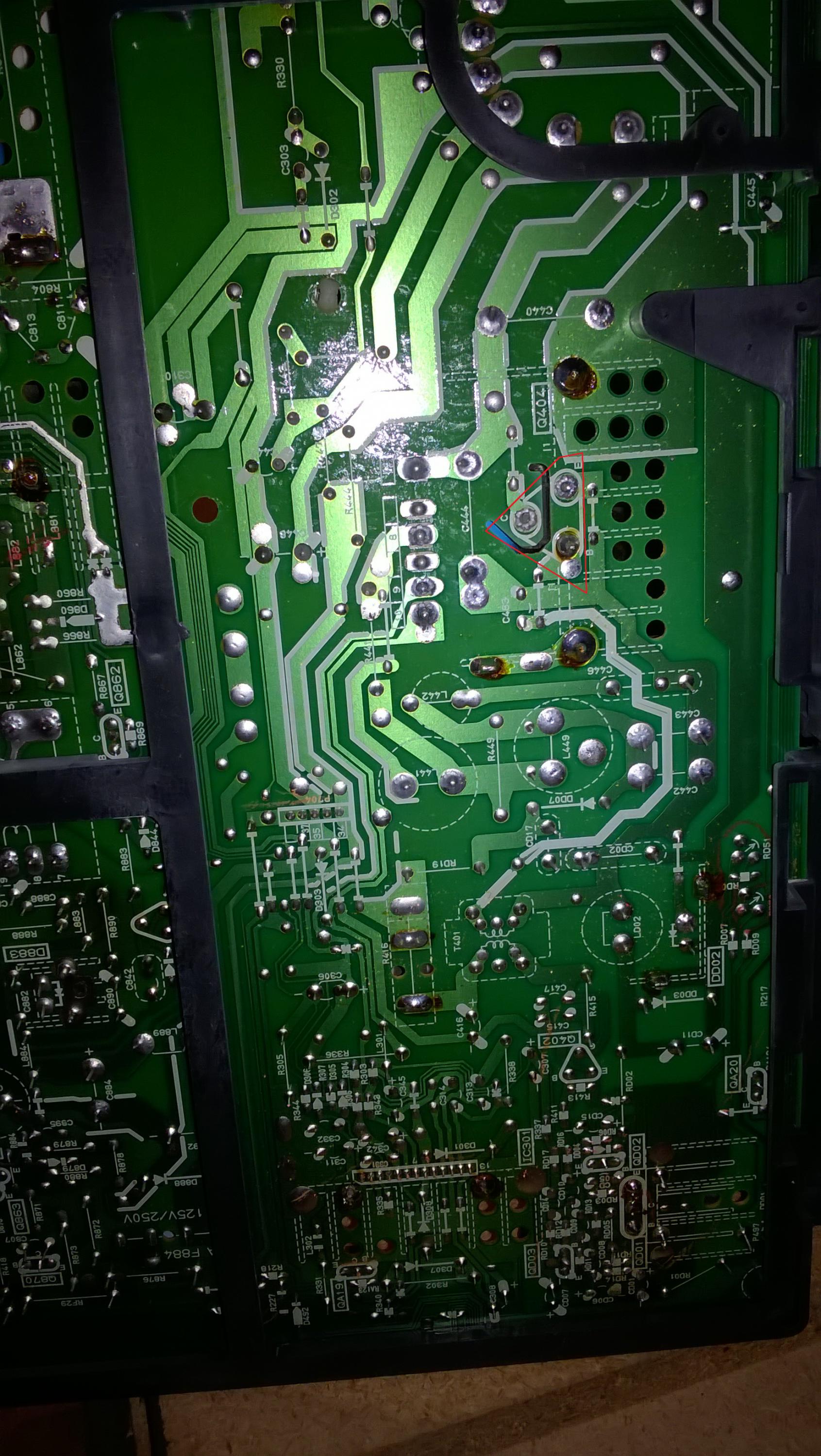

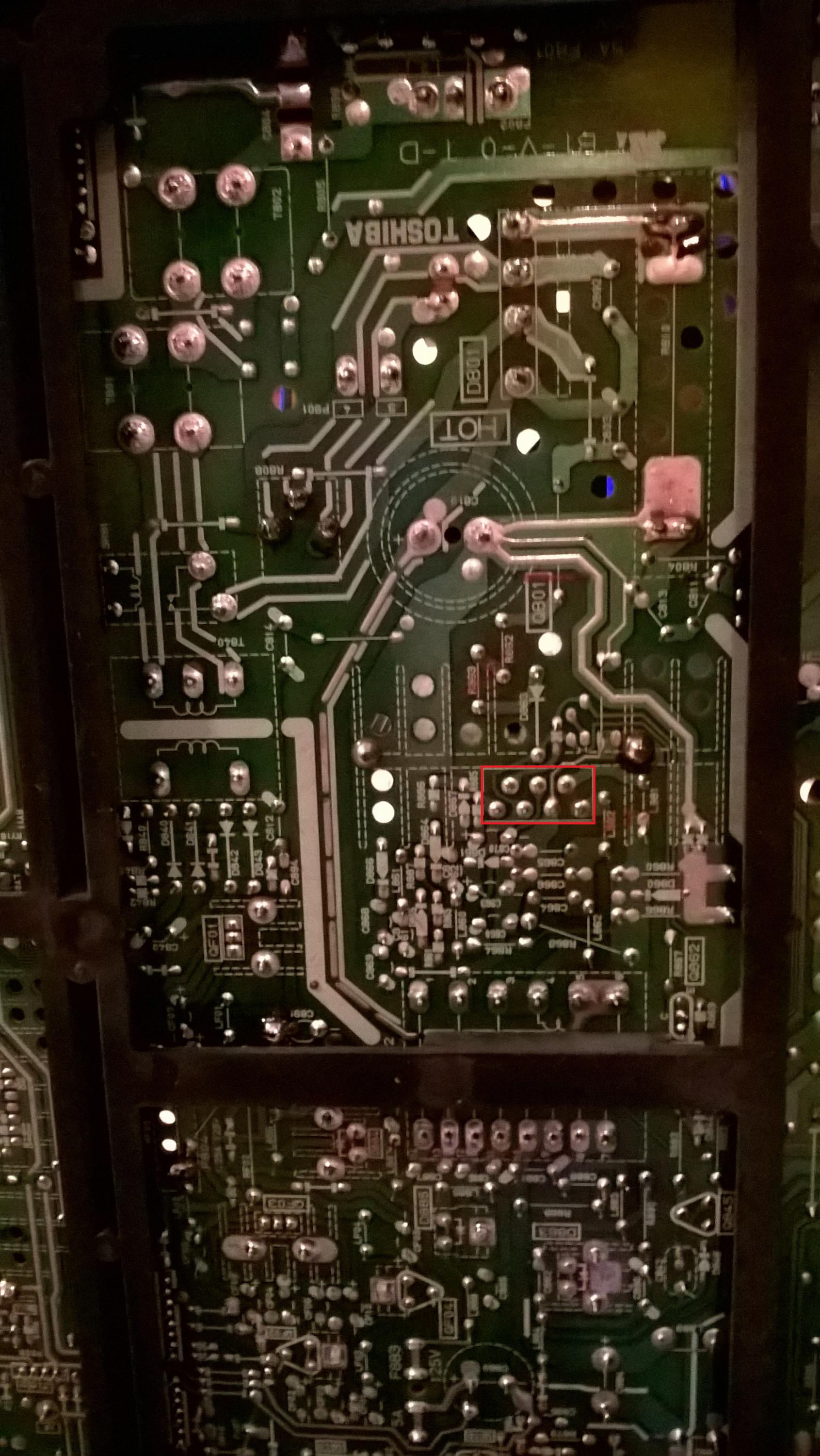

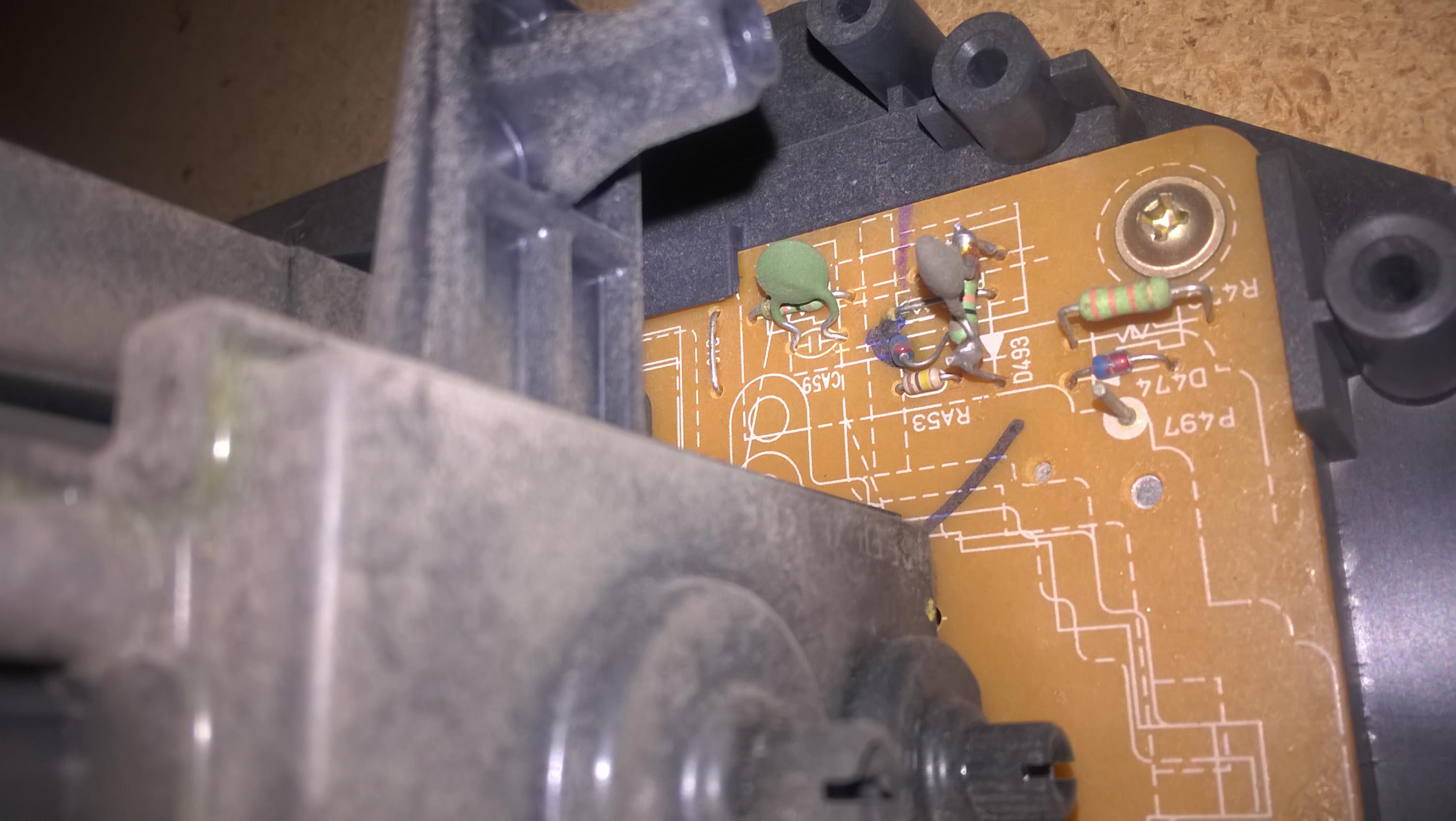

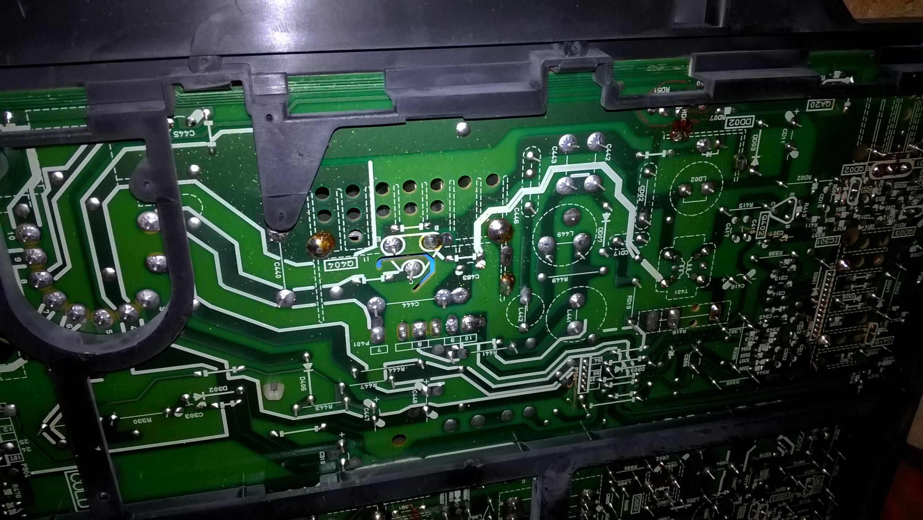

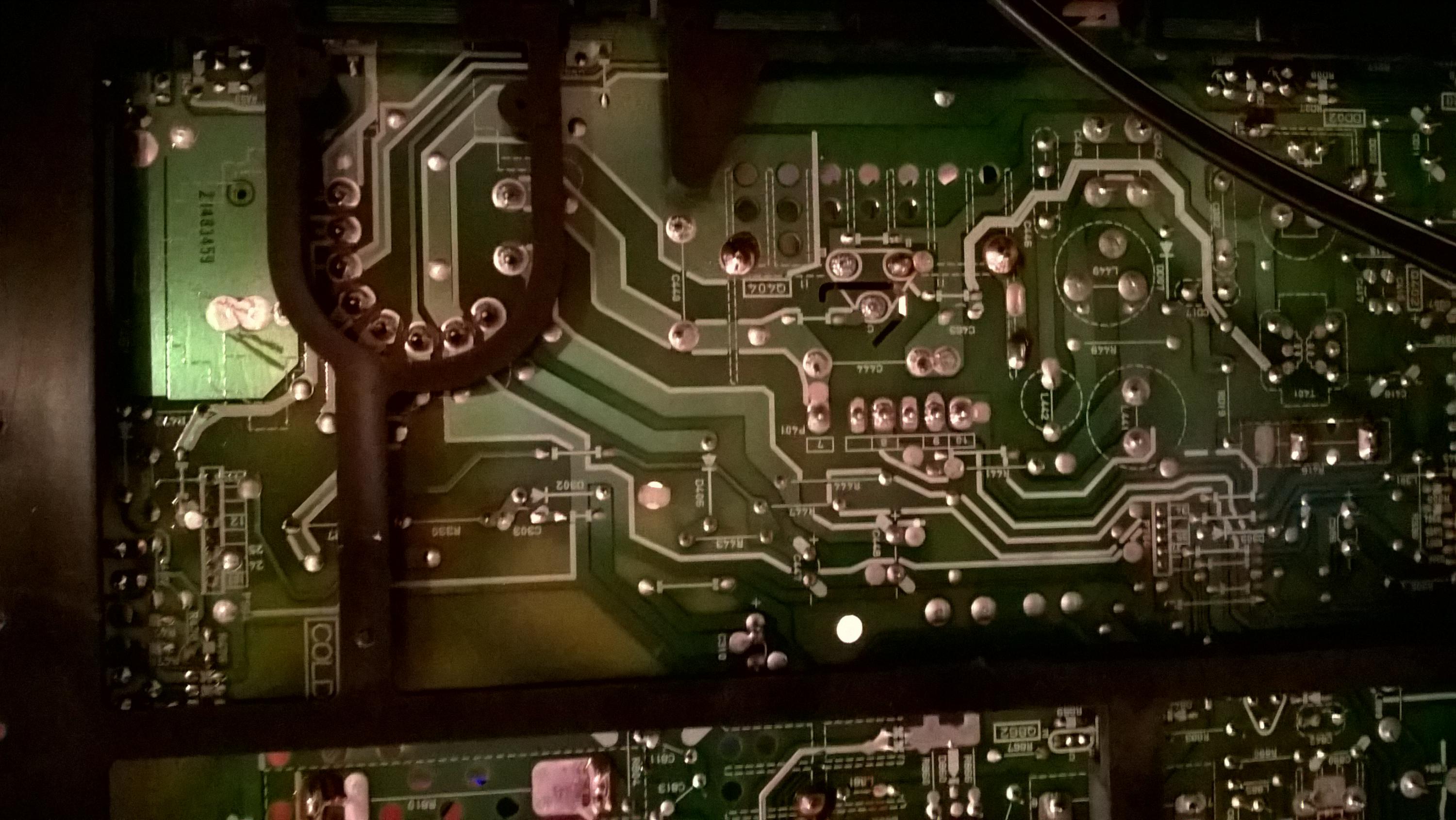

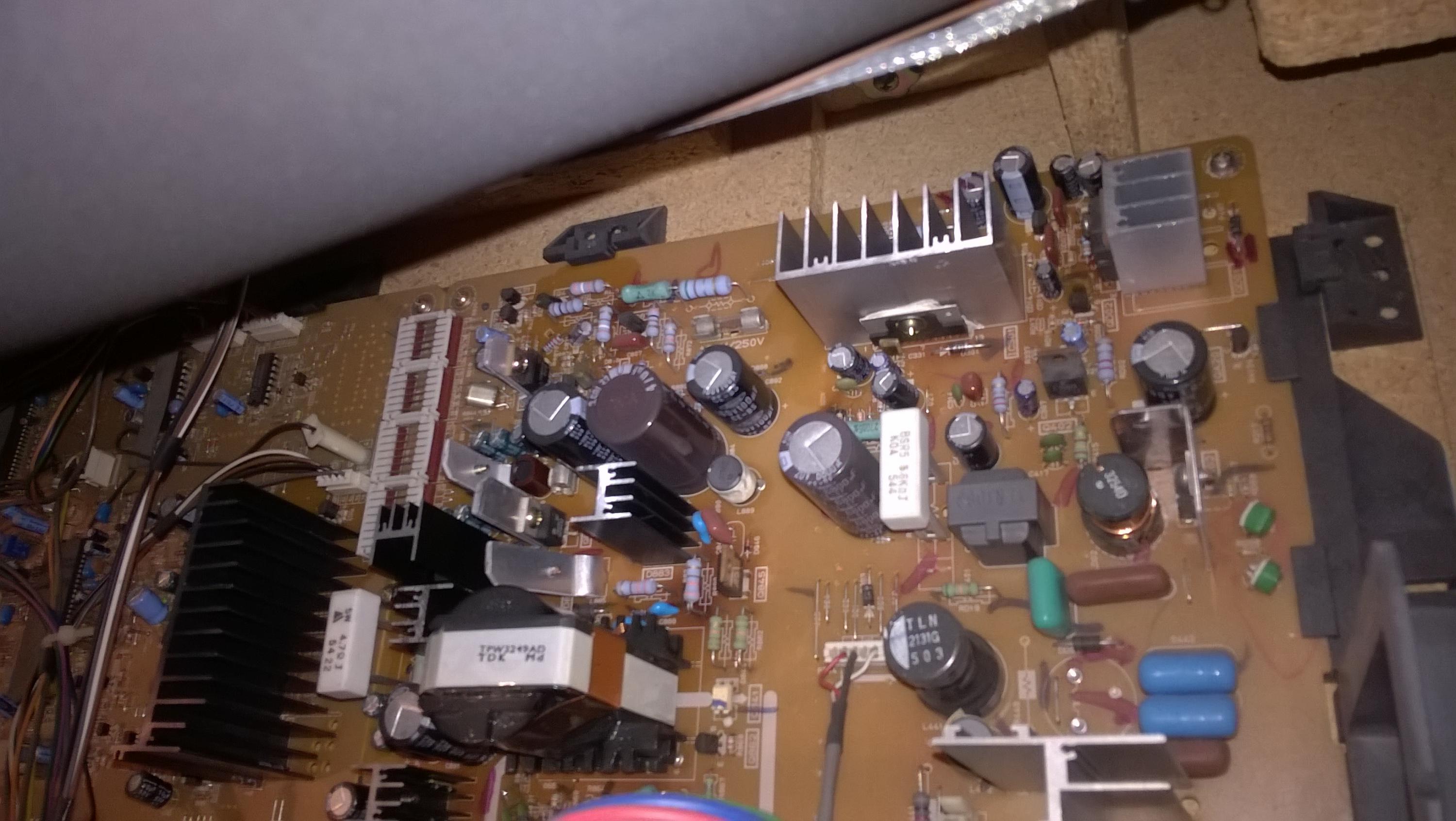

                    below are some pics of the back of the board, the 2 major components that are attached to heatsinks are circled in red. Almost all of the major joints were held together by clips? before soldering, making it hard for me to really tell a dry joint, but I'm not any good at finding bad joints anyway.
                    There a couple of joins with flux / or paste residue next to them, such as the heatsinks.
                    There a bunch of hidden hand soldered after thought components under the tunner / logic portion of the set. Lots of marker / writing over the board, hopefully that's just internal testing and not that the board had a lot of errors originally.
                    When you say not to disconnect the tube without discharging, does that refer to the 4 thick wires that go to the neck of the tube, or what I assume is the degauss / thick wire running all around the back of set but not going into set, or the thick wire from the flyback transformer?

                        Could be bad B+ regulation. Check boost supply first. Primary capacitors. Horizontal pincushion usually relates to low B+. Use the old hairdryer method on filter caps.

                            deflection control i'c(s) probably single sided and bolted to a heatsink
                            they often have a few small caps in front of them.

                                  The joints on the component circled in red in the first picture in post #10 do look suspicious.
                                  I think the simplest thing to do is to start by reflowing the joints on all larger and heat-sinked components. Also reflow the joints on all connectors. Bad solder joints may not be the problem, but it's good to do it anyways so then you don't have to guess.
                                  The easiest way to reflow that many joints is to get some liquid or paste flux (or flux pen) and apply on all joints that you intend to reflow, then hit them with the soldering iron. You need not apply solder to the iron for every joint... just a tiny bit once in a while to help with the heat transfer.
                                  And preferably do it with a 50-60 Watt iron. 40 Watts may just be enough, but you may struggle on some of the bigger joints with it (or take too long to melt the solder).
