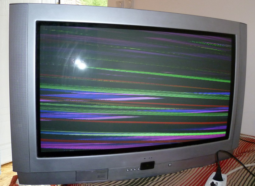

    TV CRT Thomson 32WR45E G
    It is chassis:ICC20 EN
    Error: There is no horizontal synchronization.
    I replaced the CC060 / 1uF, the error has not been corrected.
    Could it be a bad processor IC001 / TDA9321H?
    Thanks in advance!
  • fzabkar
    • Mar 2009
    • 772
    Re: TV CRT Thomson 32WR45E G
    I would try replacing CL004 (1uF), CL005 (100uF), and CL008 (100uF) in the horizontal output section. Resolder the horizontal drive transformer (LL001) while you're there.
      • 31185
      first check the soldering on *everything* connected to a heatsink or metal plate.
      you will find lots of broken joints.
      well done for having a working one btw, those suffer a lot from tube failure.
      before you ask, the sumptom is picture with a solid colour field behind it inc scanlines - usually the blue gun.
      • Andrew F. Ali
        • Jan 2014
        • 2450
        • Trinidad & Tobago
        That seems to me that the Horizontal Oscillator Frequency is OFF frequency. I think there is a Horiz Osc crystal near the Main IC in the Horiz Osc circuit....Replace that...It may be blue in colour.
