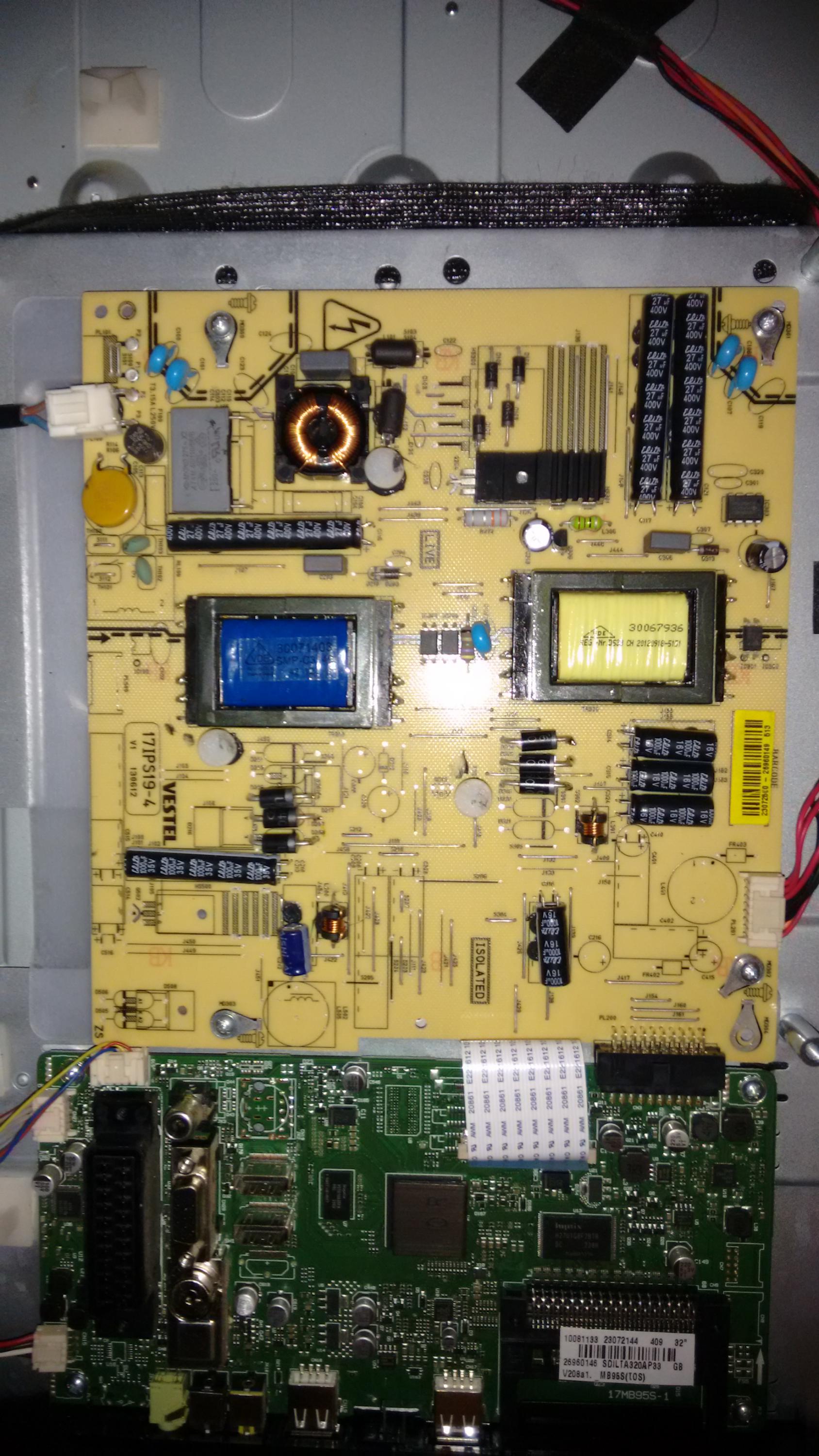

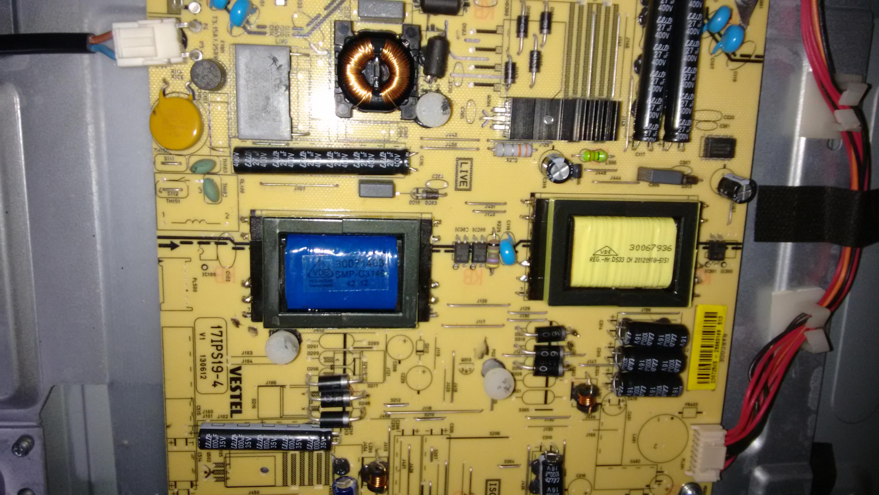

    Hi GUys,
    I have the above tv Toshiba 32w1333b with a problem.
    Sometimes it will turn on fine but most of the time it tries to start up but fails.
    The best way I can describe it is like a Flourescent light with a starter gone.
    There is a small flicker of light from the panel and then nothing.
    I think it maybe psu related as this has one of the infamous vestel panels 17ips19-4 psu's.
    I will take some pics of it when I get home this evening.
    Red

    Sounds like a loose connection on the leds see it alot on these cheap vestel sets. Let me confirm this the leds fire on but some times wont stay on ?
    • redriddick
      • Dec 2014
      • 93
      • Ireland
      Re: Toshiba 32w1333b
      Yes exactly,sometimes it is fine.
      I then power off the tv and try to power it on and there is nothing.
      I took the back off and tried to turn it on and I can see a small flash of the panel looking from the back.
        Pics attached
          Ahh right well sound like you have an led backlight fault more than likely the psu is ok. I repaired on with the same issue "2 seconds to black" where the bulbs fire on but don't stay on it was due to a corroded connector on the led strips them selves. I had to add some fresh solder on to the strips connections and the issue was solved.
            So what your saying is that I need to remove the psu,mainboard to get at these????
            • ReeceyBurger123
              Never Give Up !
              • May 2014
              • 7325
              • Britain
              You can keep the Psu and Mainboard mounted but you will need to remove the Lcd panel and diffusers to get to the leds.
