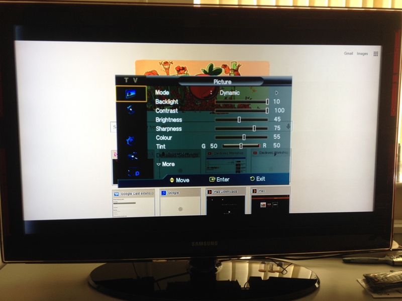

      Thanks for your reply. I had seriously considered that may well be the problem but what is niggling me is why the OSD Menu appears nice and clean with no colour distortion in the middle of the screen even though the picture immediately behind it is faulty.

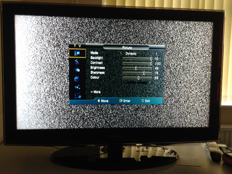

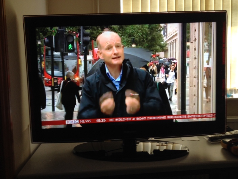

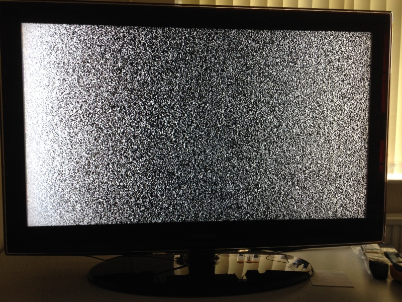

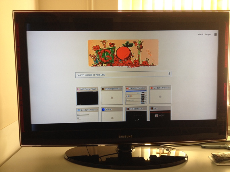

              I have reduced the file size and finally uploaded two pictures. The screen is set to TV with no signal input and I think you can see the dark centre of the screen. The next picture is with the OSD and it appears to sit on top of the darker area of the screen and not be affected by the darker area of the screen behind it.

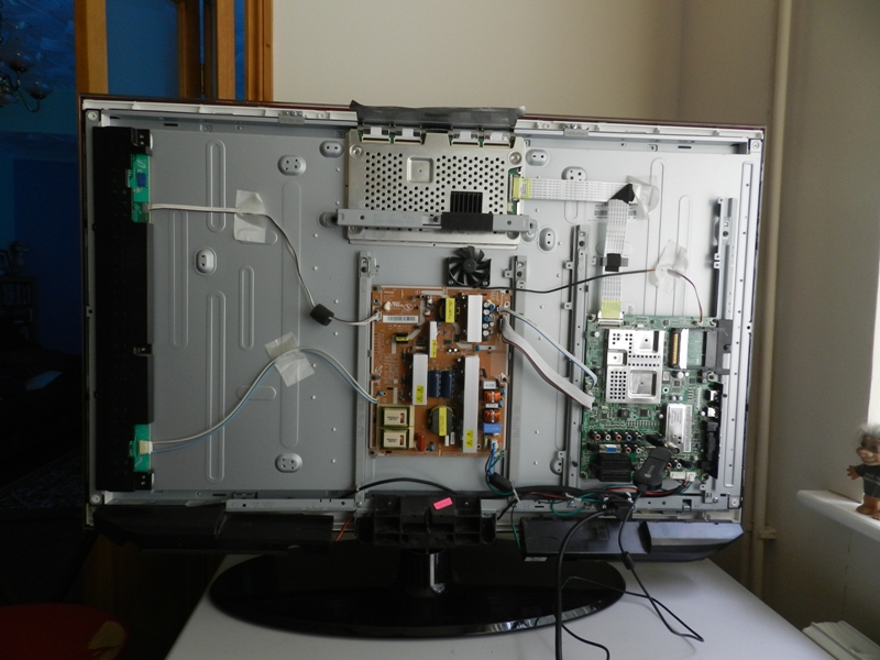

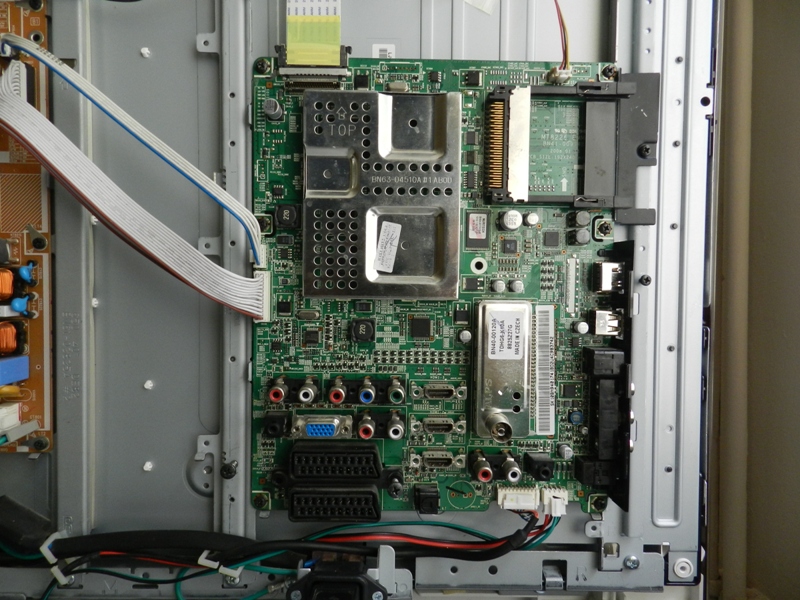

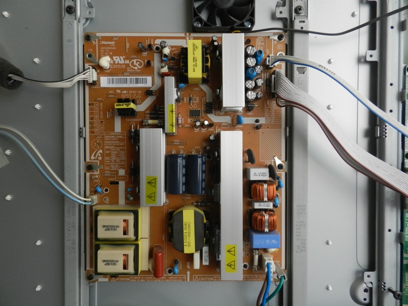

                Interesting almost looks like a led fault but I don't know how the leds are arranged in this set. Post a pic of the set with the back off and of each board.

                  Here are some more pictures of the back of the set.
                  Regards

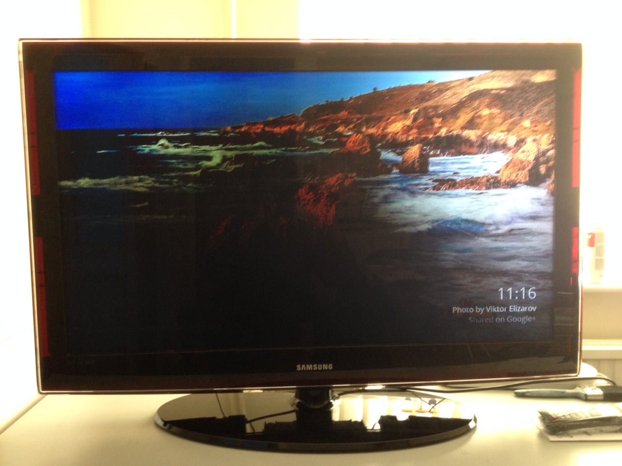

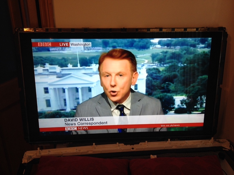

                    What happens if you put actual video on the screen? Is the left side sluggish in response? It's either tab bond or the panel.

                      The left hand side is extremely sluggish and smears as the picture content changes. The centre part of the screen is darkish and very red the right-hand side of the picture is pretty good.

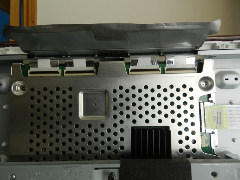

                        Oops I missed the part about the refresh problem. I concur with Capleaker about bad panel. Unplug one side of the tcon to panel ribbons and check the pic. Then unplug the other side and check pic again.

                          Moving one of the ribbons on the Tcon board which go to the long narrow circuit board sat at the top of the screen panel does clear the fault and / or brings it back when wiggling.
                          I must admit that you were both spot on with your diagnosis for which I thank you.

                                Unfortunately the puzzle continues. By opening up the tab on the leftmost Tcon connector looking at the rear of the set and wiggling it I can get a good picture. If I switch off, wait 30 seconds and switch back on the picture is dark again and will only return to normal when I open the tab and wiggle the (left-hand) connector once again.
                                Wiggling the other 3 in turn does not appear to return the picture to normal.
                                I have removed the frame from around the screen and have easy access to the screen panel tabs. Putting finger pressure on these 16 tabs in turn has no effect on the picture.
