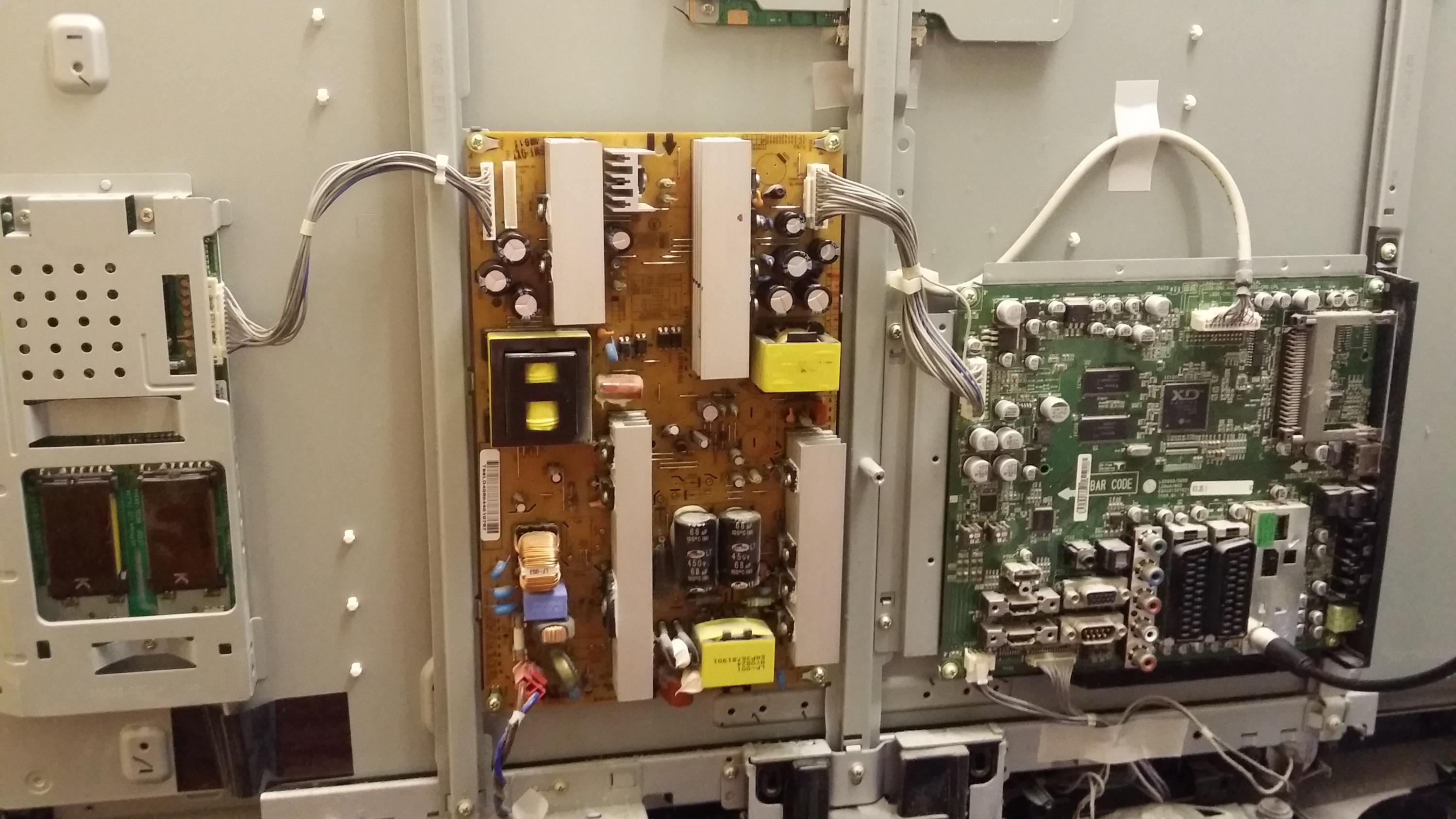

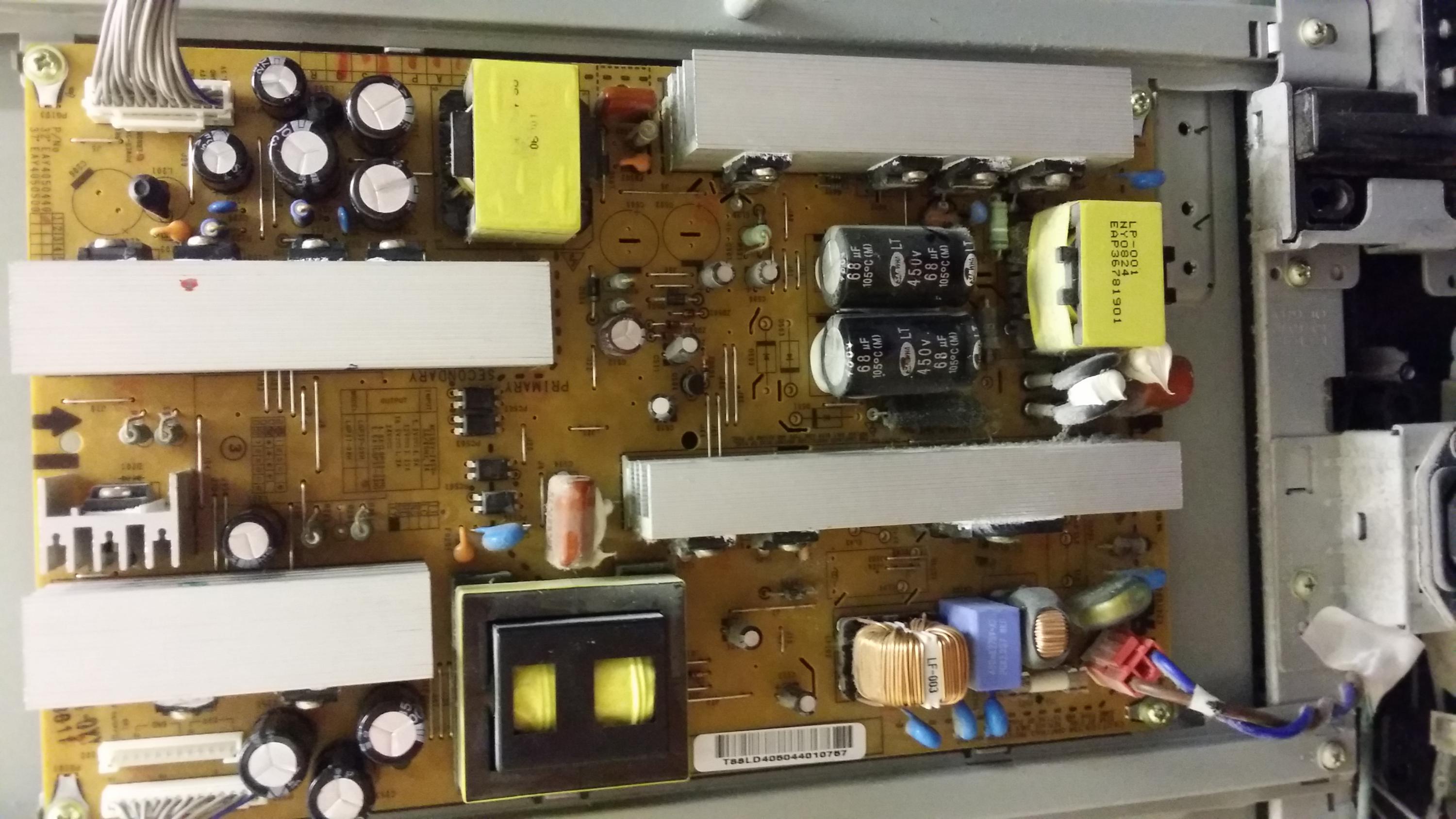

    Hey guys I Have a 32lg3000 tv which appeared to work until after an hour or so I turned it off and turned it back on the red light blinked through the motions and went blue but no sound or picture.
    Now everytime i press the power button and it starts blinking i know if its going to come on or not because when its going to there is noise coming from the transformer and when its not going to come on its silent.
    Ive changed all the caps on the psu apart from the 2 large ones because i didnt have any to hand but they appear fine visually just like the rest did but its the same.
    Does it sound like the transformer itself ? Or is there somewhere else i should be looking?
    Any help would be appreciated. I can add more pictures if needed.

    Run a fan to blow air on the main board from the time you turn on the TV to when you turn it off to see if the TV will turn back on after an hour.
