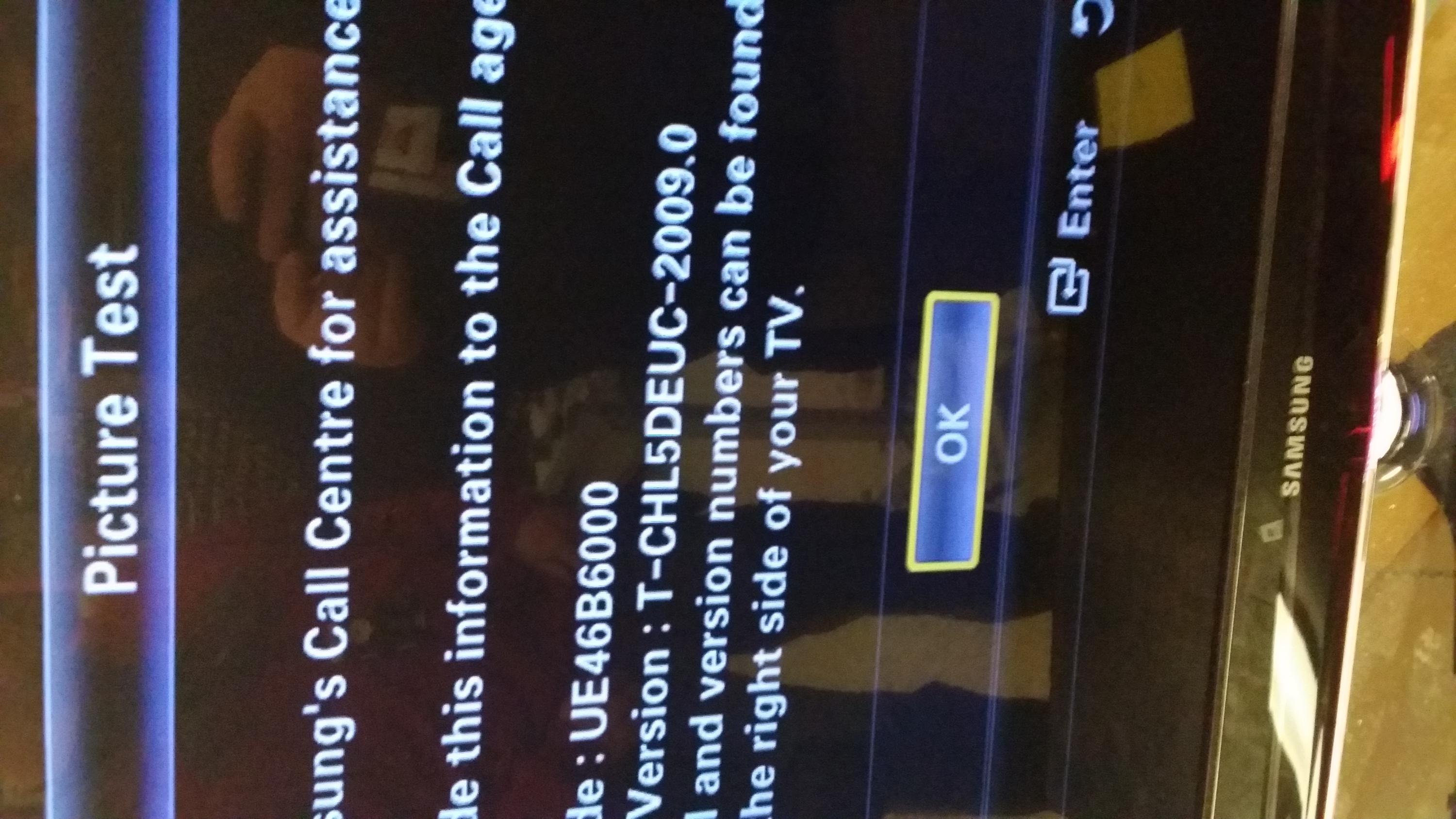

    Firmware: T-CHL5DEUC-2009.0

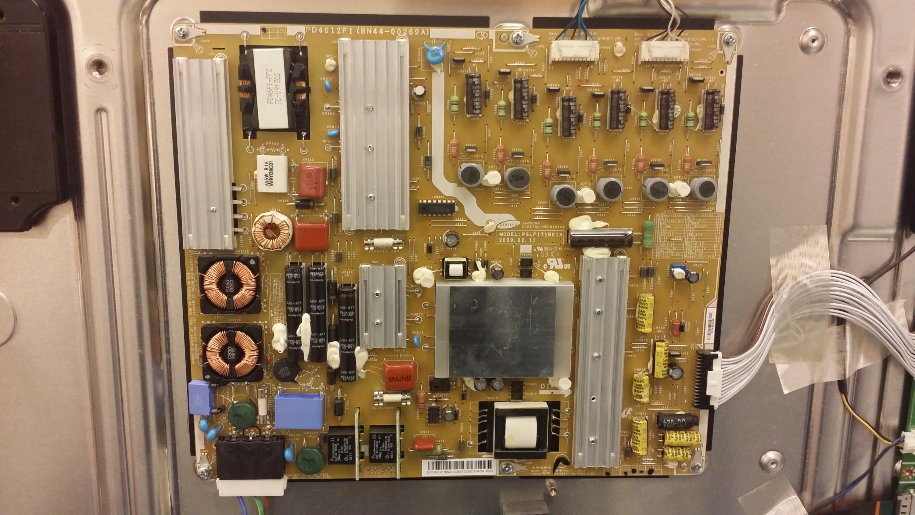

    I`ve opened the TV, checked all the capacitors on the PSU and they seem fine. No bulging, measures according to marking and so on.

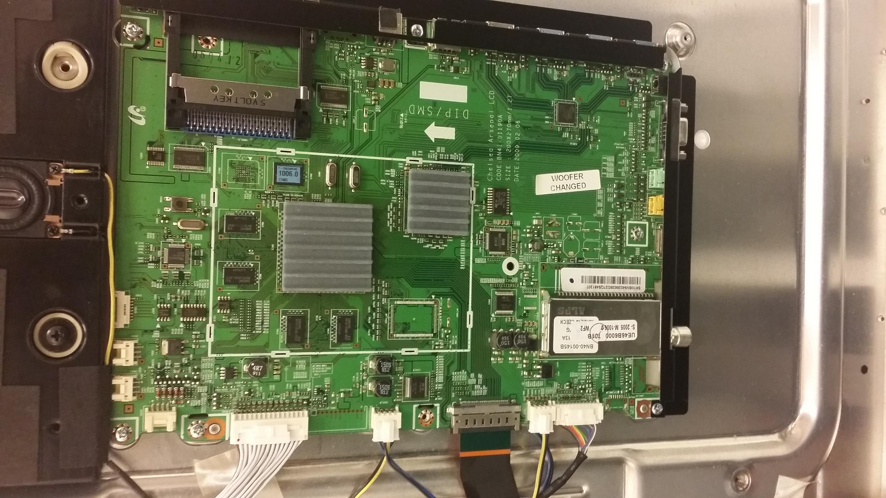

    When i disconnect the mainboard and start it the backlist comes on, so i focused on the mainboard.
    Took it out and visually inspected it, couldnt see anything special. Put it back in and measured the voltage regulators ( 3 i found )

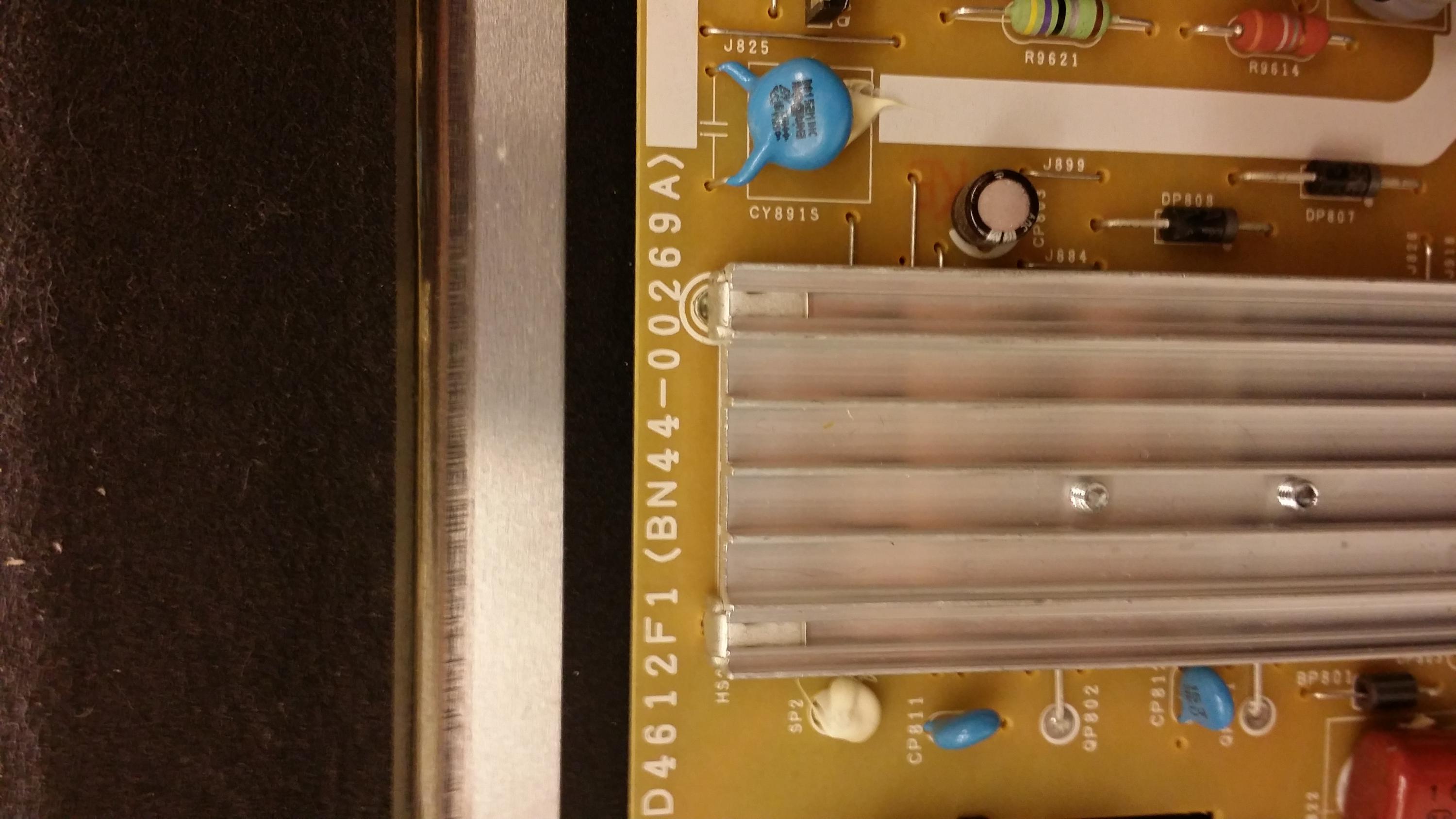

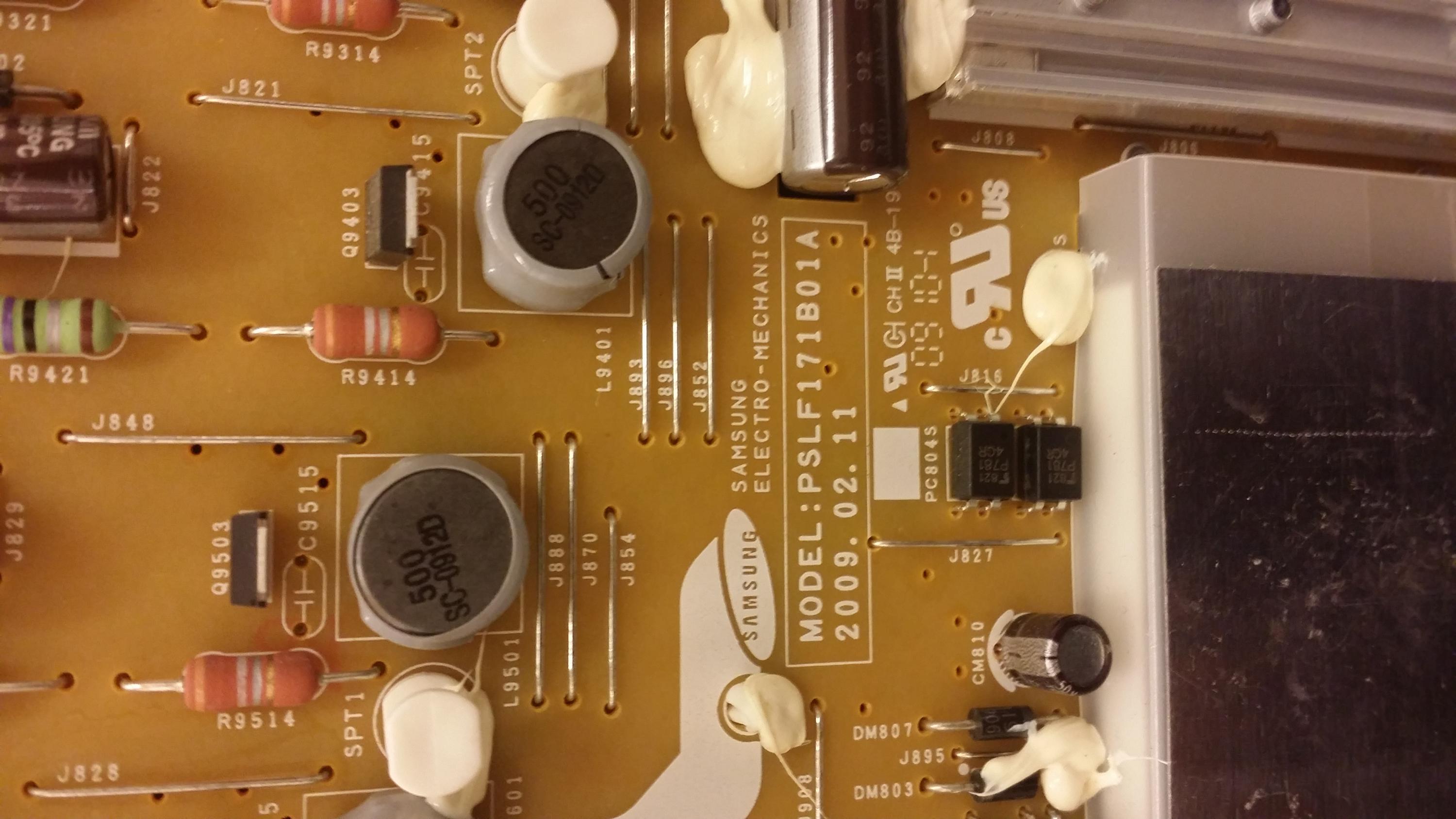

    Re: Samsung UE46B6000 problems.

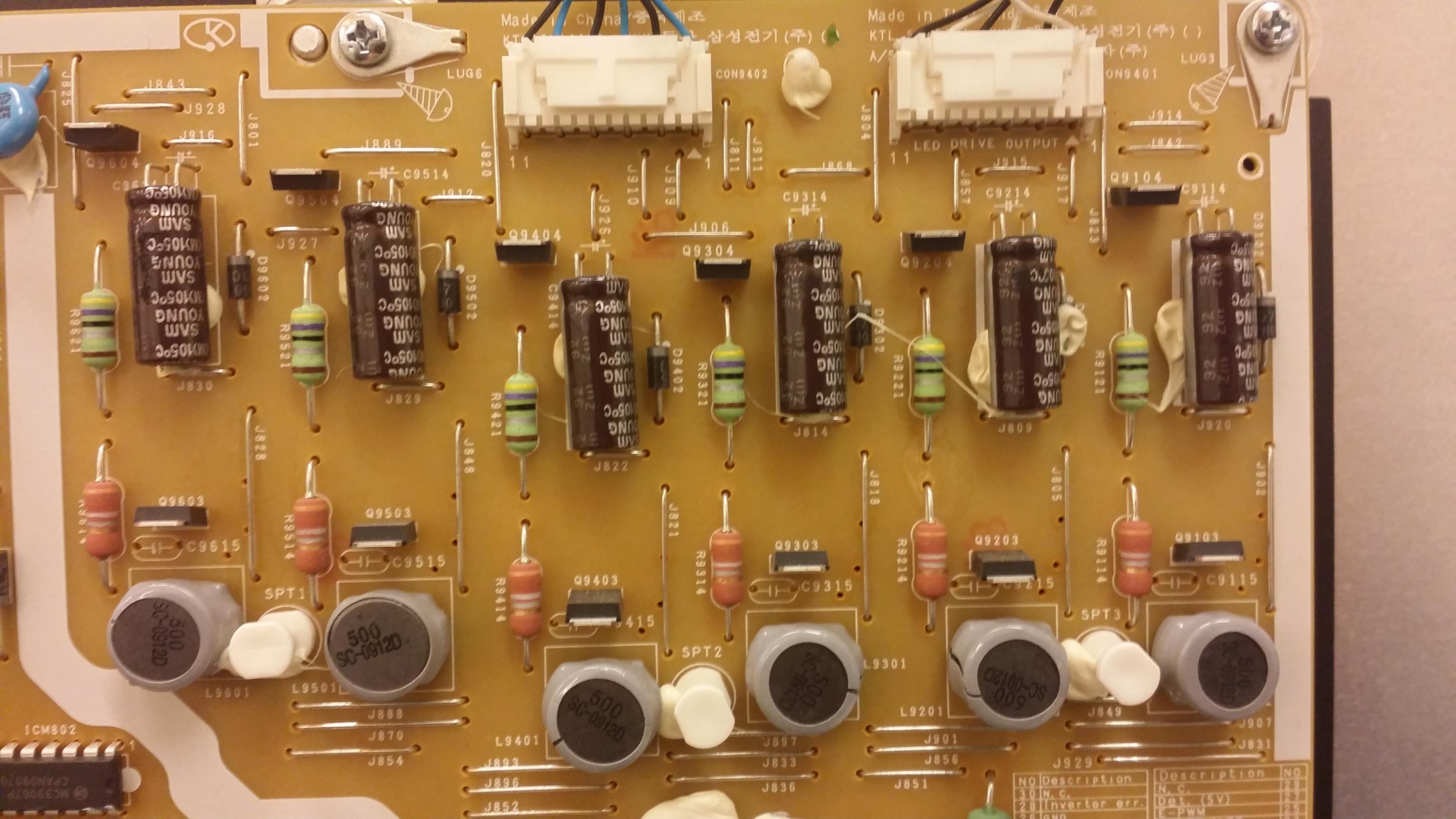

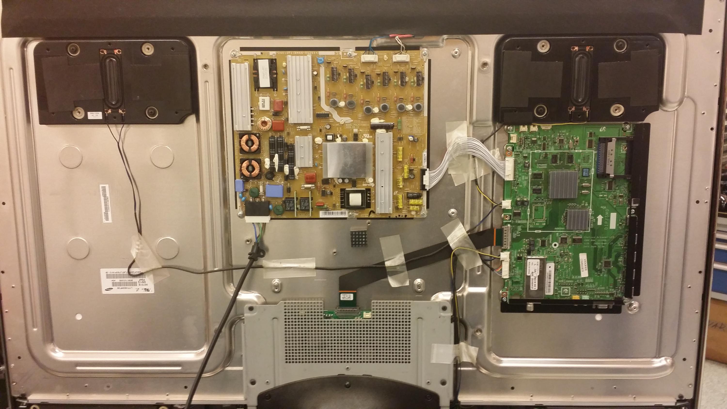

    Pictures as promised

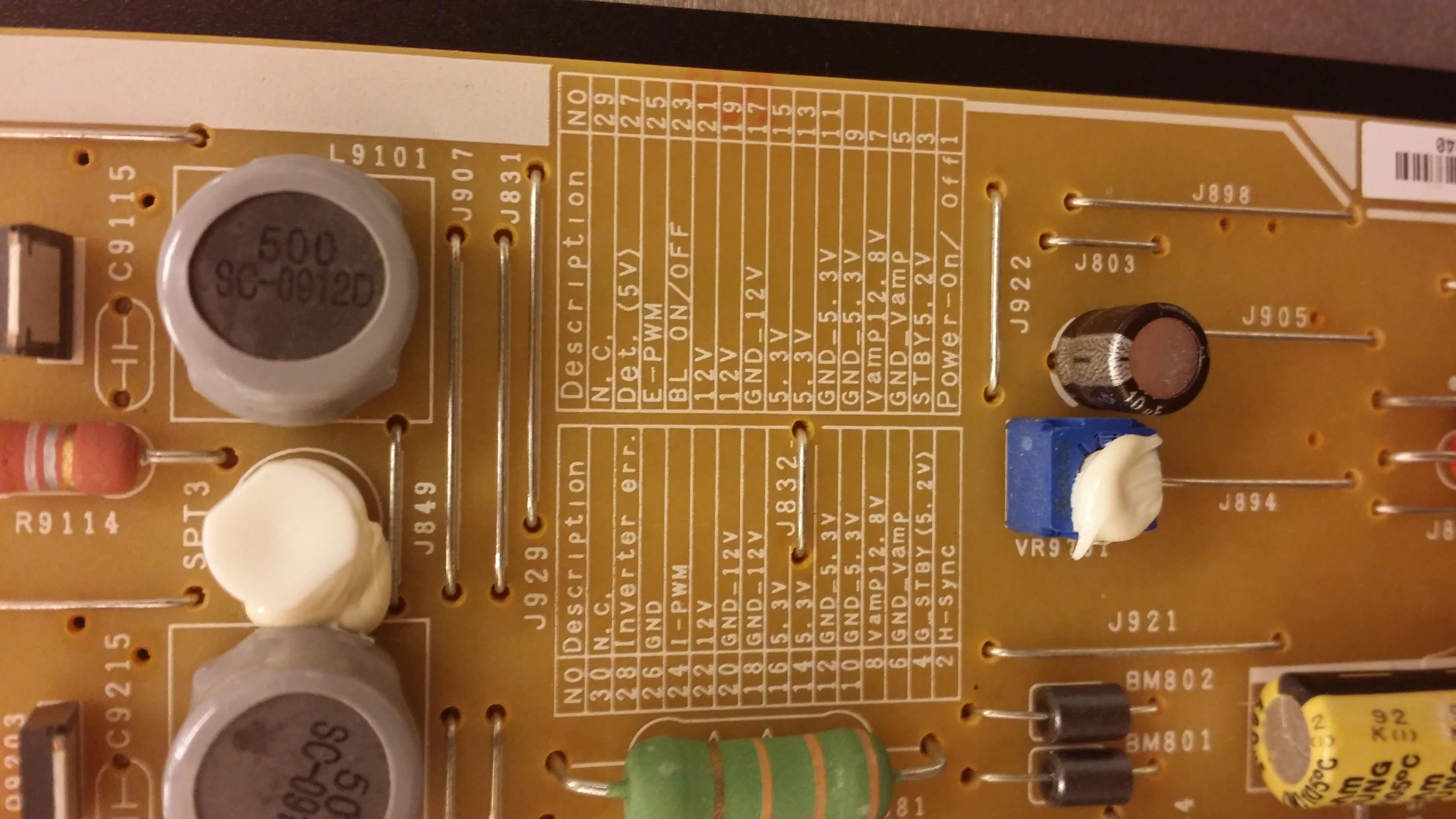

      Measured the voltages coming from the PSU to the Mainboard.
      1: 0,85v
      2: 0v
      3: 5,3v
      4: 0v
      5: 0v
      6: 0v
      7: 12,6v
      8: 12,6v
      9: 0v
      10: 0v
      11: 0v
      12: 0v
      13: 5.29v
      14: 5.29v
      15: 5.2v
      16: 5.2v
      17: 0v
      18: 0v
      19: 12.6v
      20: 0v
      21: 12.6v
      22: 12.6v
      23: 2.9v
      24: 0v
      25: 4.2v
      26: 0v
      27: 4.8v
      28: 0v
      29: 0v
      30: 0v

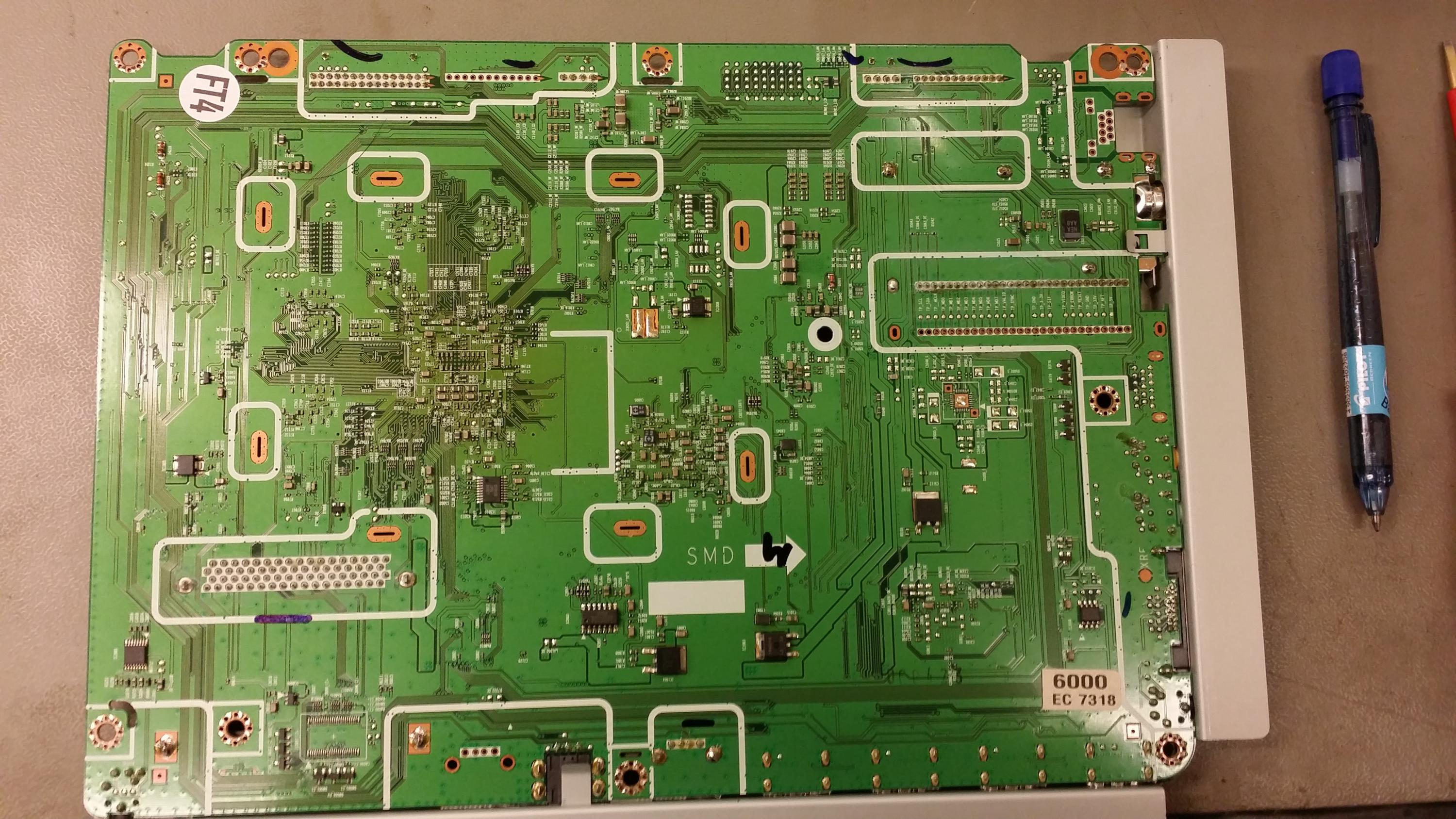

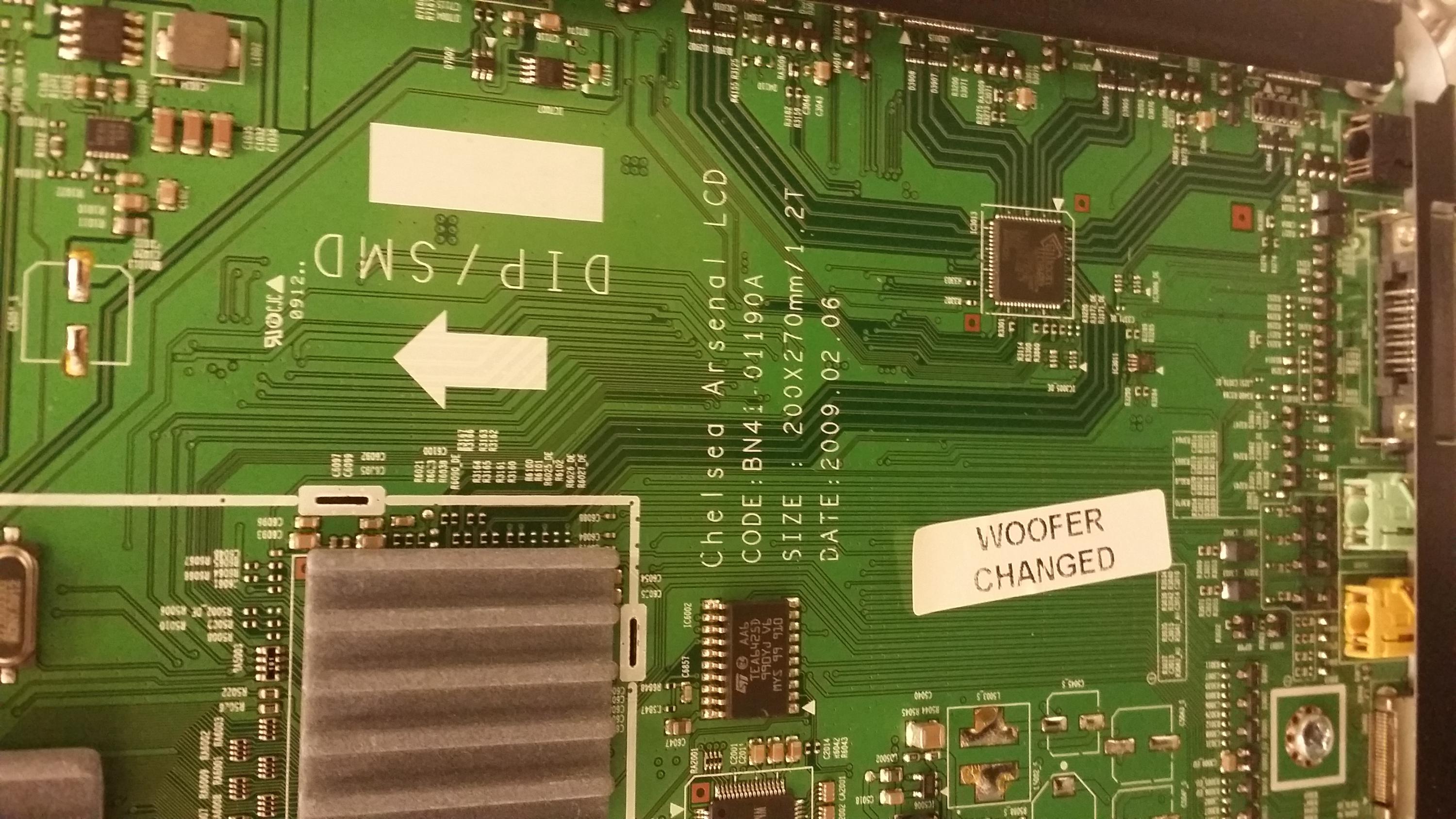

        Could you provide a picture of the back of the mainboard? I think this model applies for a repair kit on shopjimmy. Its a IC that needs to be replaced , thats causing the tv to turn on/off randomly.
                    Added a picture of the mainboard backside
                        Checked and it had an update available, upgraded but still no difference.
                        Also i noticed i dont have any sound, not on startup/shutdown or when i ran the selftest.
                                  The fix that i mentioned applies for alot of models.
                                  https://www.youtube.com/watch?v=oC4f2Ik8rCI , maybe you can search the net and see if your mainboard has the same issues. Or has this same chip!
