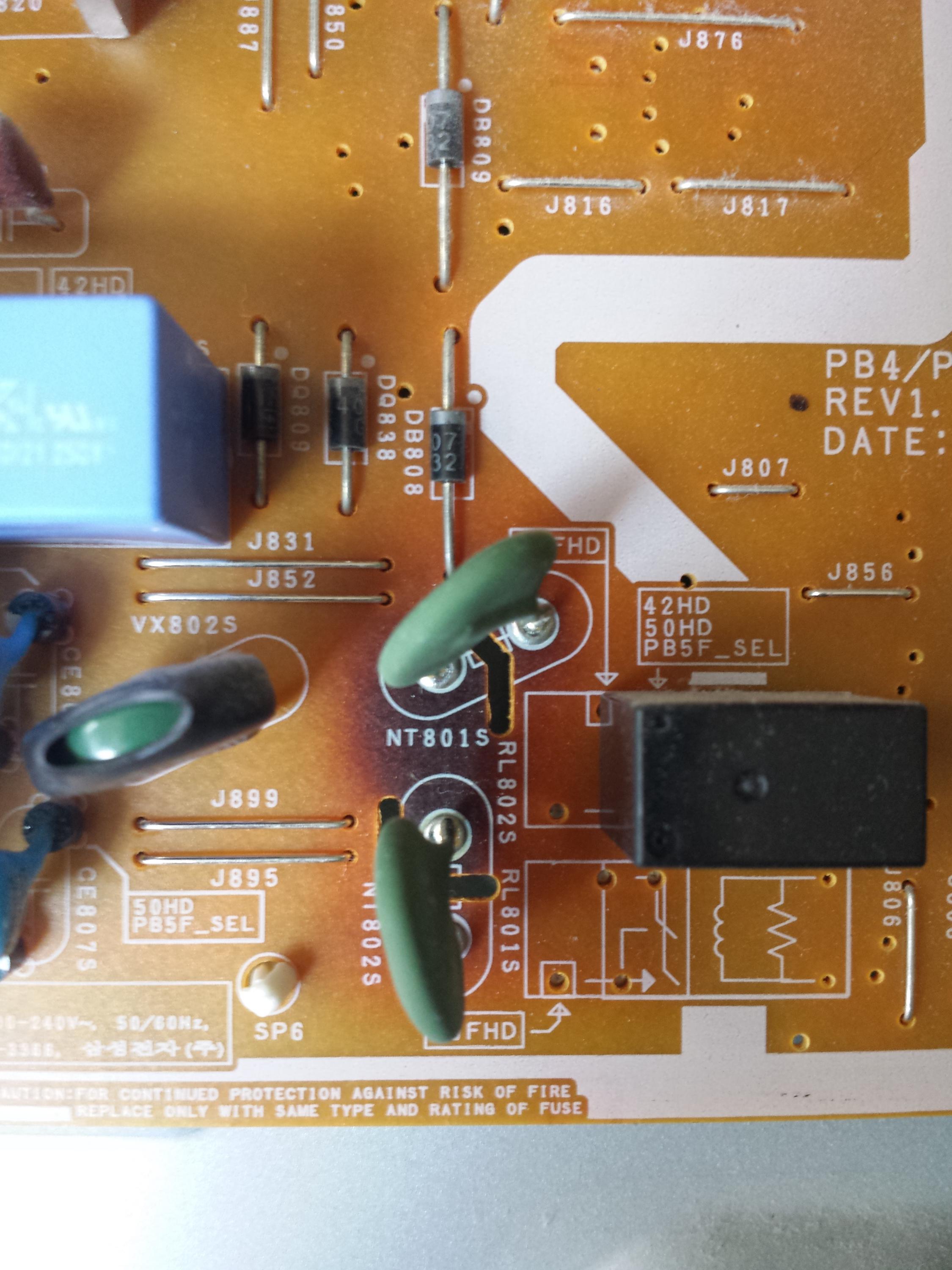

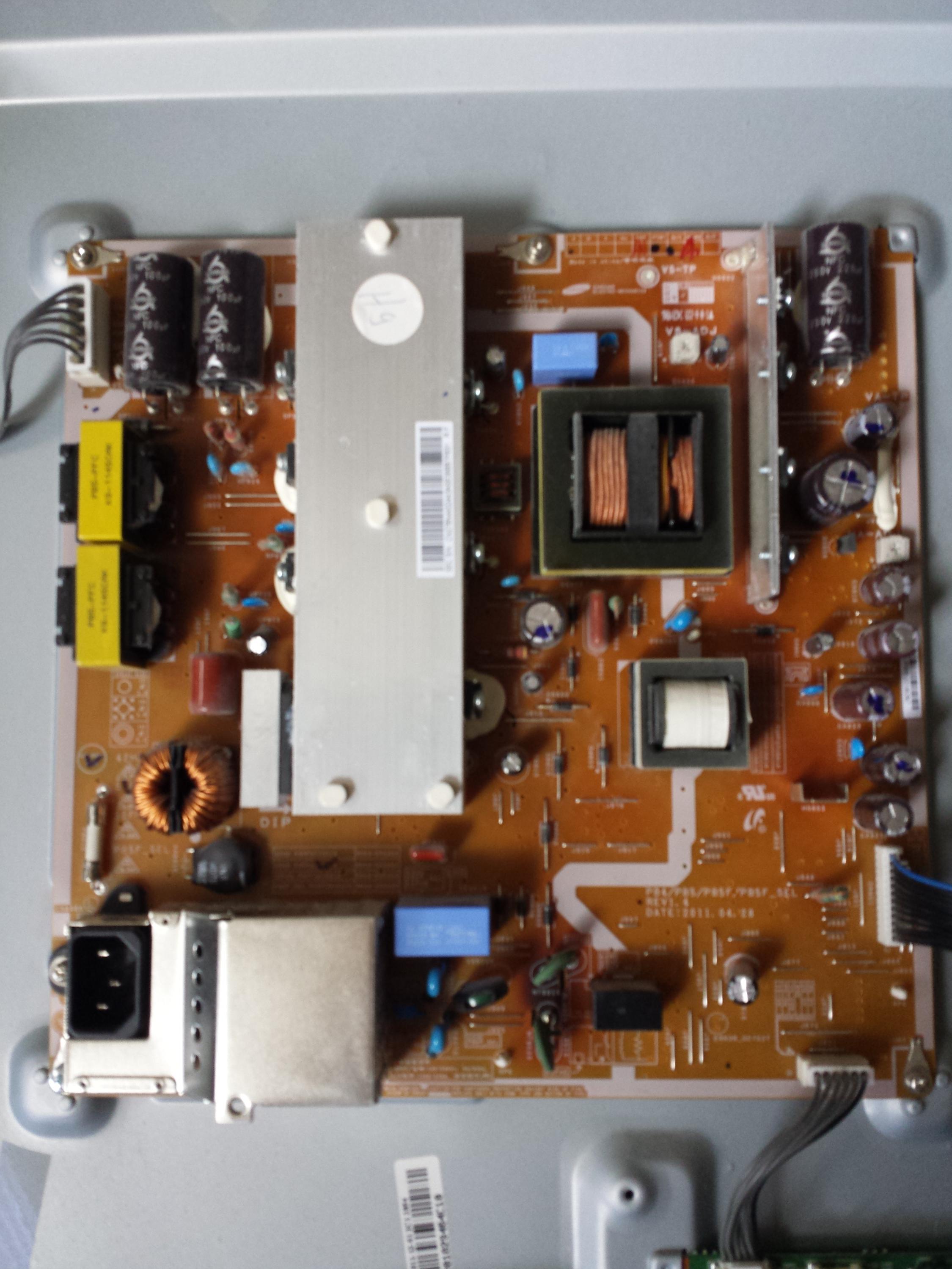

    Hello, said tv was working fine this morning, came home this evening to find the tv will not come on. The only thing i can go by is the red LED is blinking rapidly. I can only describe the blinking would be like morse code or something, rapid with no distinct pattern. I did take the back cover off, i didnt see any bad capacitors or anything like that however i think there is a burnt spot on the board, i dont know if its burnt or not. I can upload a pic of the board if it helps!

      Re: Samsung pn51d450a2dxza rapid blinking LED
      correction, its not a burn spot, but is there anything i can try to do before buying a new power supply? Im looking for a replacement power supply now.
        We need pictures, don't buy a power supply. There's a very good chance it's not causing your problem.
        A TV not turning on could be caused by anything... Especially a plasma.

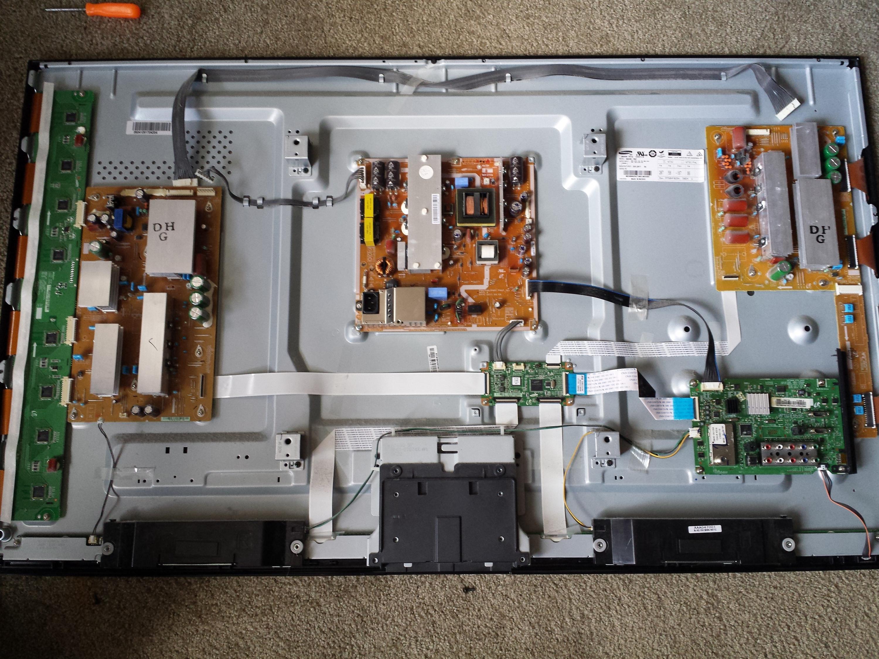

                  sorry, the pics are upside down..uploaded in a hurry!
                    Originally posted by Hamie
                    What boards did you unplug?
                    This is why pictures are important.
                    We need to see the whole assembly and the way the boards are linked up.
                    I unplugged the y-sus and z-sus boards, the ones to the far left and right. However, after plugging them back up, i still have no blinking led. Its like the thing is just dead now.
                    • Hamie
                      • Apr 2014
                      • 1383
                      You'll need a digital multi-meter to troubleshoot further.
