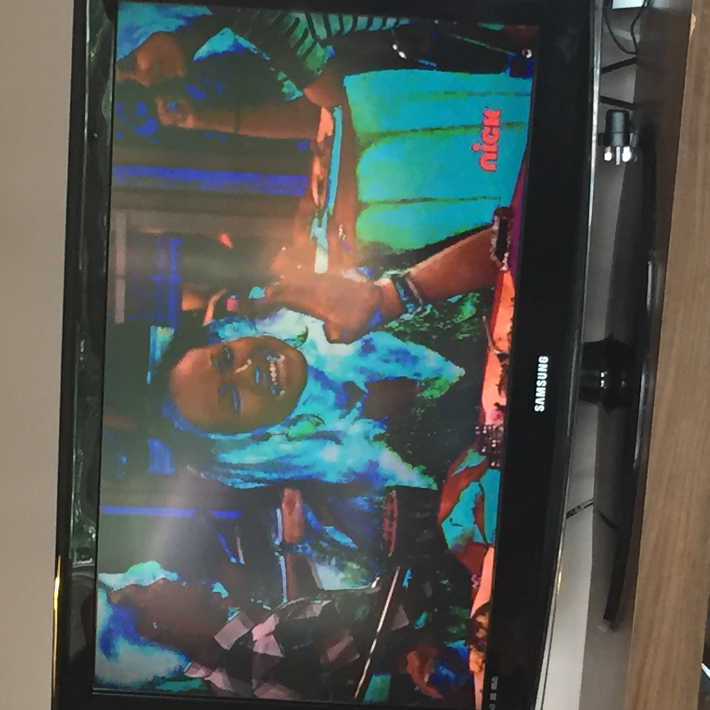

    hi all,
    Having a few problems with this samsung, it was powered off for a week and when it was put back on the screen was as pictured.
    tried to change the settings and a factory restore and tried to get to the ddr settings in the menu but would not let me change it.
    can anybody advise on things to try? or is the mainboard gone
    thanks

    Re: Samsung le37a456c2d
    Bad AS15-F chip on the t-con by the looks of it.
      Hi guys i've go the same problem with one of my tv's just stripped out the t-con board and looking for a replacement it's a CPT 370WA03C 4H can see loads on ebay but the 4H part of the code is different will one of these be ok for this samsung set or do i need to try and find one with the eaxct same code?
        If you're not comfortable replacing the gamma chip yourself. Why not phone a laptop or tv repair shop and ask if they will install a new chip for you.
          I'm pretty good at soldering myself what chip is that needs to be replaced?
            Ic202
            as19-hg
              Hi All
              Had one of these I just used a tcon repair service off ebay to replace the AS15 chip
