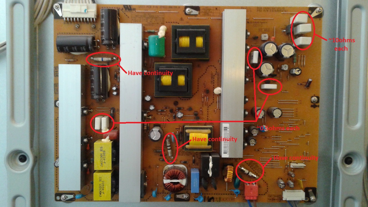

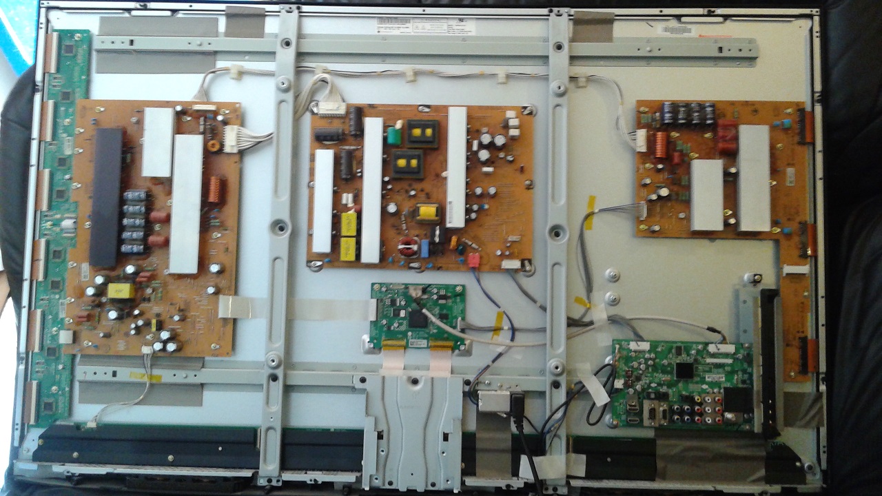

    New member here, trying to fix my parents' TV. It is an LG 50PJ550 plasma manufactured in 2010. Last night they were watching TV and heard a POP, then the TV wouldn't stay turned on anymore. I have been looking for a fix online for most of the day but I still cannot determine what is wrong.
    SYMPTOM: Power cable plugged in, get the red light on in the front. Turn TV on, red light disappears, hear it click-click, no flash or anything on the screen, red light appears again, hear it click-click. Same thing happens each time.
    So far I have done the following:
    1) I have checked the power supply board with a multimeter. My findings are indicated in the second picture.

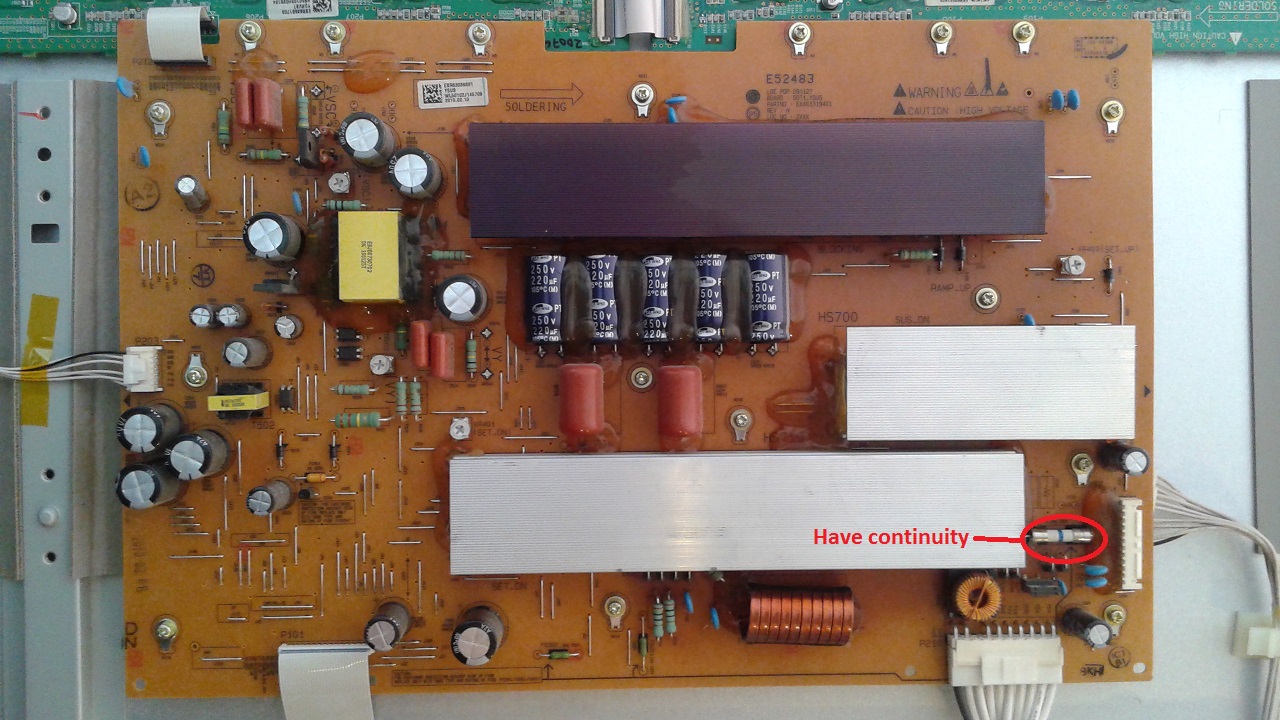

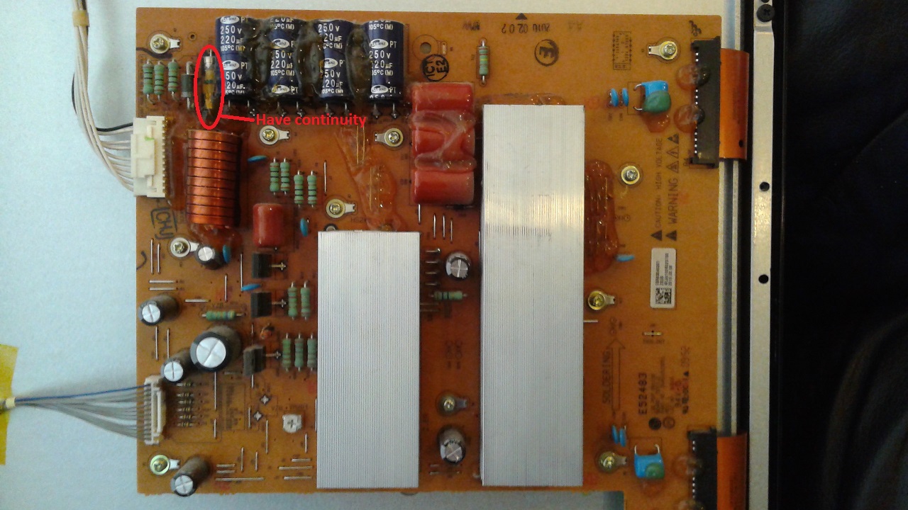

    2) I have checked the YSUS and ZSUS boards with a multimeter. My findings are indicated in the third and fourth pictures.
    3) I have visually checked all the capacitors and have found none that are blown or bulging.
    4) I unplugged the YSUS cable from the power supply board and turned the TV on. The TV stays ON now but nothing else happens.
    5) I plugged the YSUS cable back onto the power supply board and I unplugged the ZSUS cable from the YSUS board. I turned the TV back on and my symptom happens again with the addition of a humming sound for 2-3 seconds on startup and another 2-3 seconds when shutting down.
    I don't know what my next step should be, I would greatly appreciate any sort of help on this one.

  • Agent24

    If it runs with the YSUS unplugged I guess that indicates a fault on that board. First thing I would do is check all the big power transistors\diodes etc on it for shorts.

      Everything on the ysus heatsinks need to be checked for shorts.
      Usually the black heatsink is ok.
      Start with the smallest silver heatsink. There should be a diode RD2003, and 2 igbts. If they test short then both IGBTS will need to be replaced.
      Then check the larger silver heatsink usually most of the parts on this are blown.
      btw the ysus can usually take out the zsus when it fails, so you'll need to check the heatsinks for shorts.

                          These are the parts that are usually faulty and need to b checked.
                          D01 - RD2003
                          Q02 and Q03 - 30F124
                          Q29 - K3667
                          Q26 and Q27 - fqpf51n25
                          Q22 and Q24 - rjp63f3
                          D21 - rd2004
                          Usually D01 and D21 will test ok, if they are also shorted then you will need some extra parts.
                          Also remove the glue between the legs of All blue disc ceramic capacitors, eg: c203.
                          Once repaired the capacitors still might blow off the board so make sure you have 2 or 3, 102k caps just in case.
