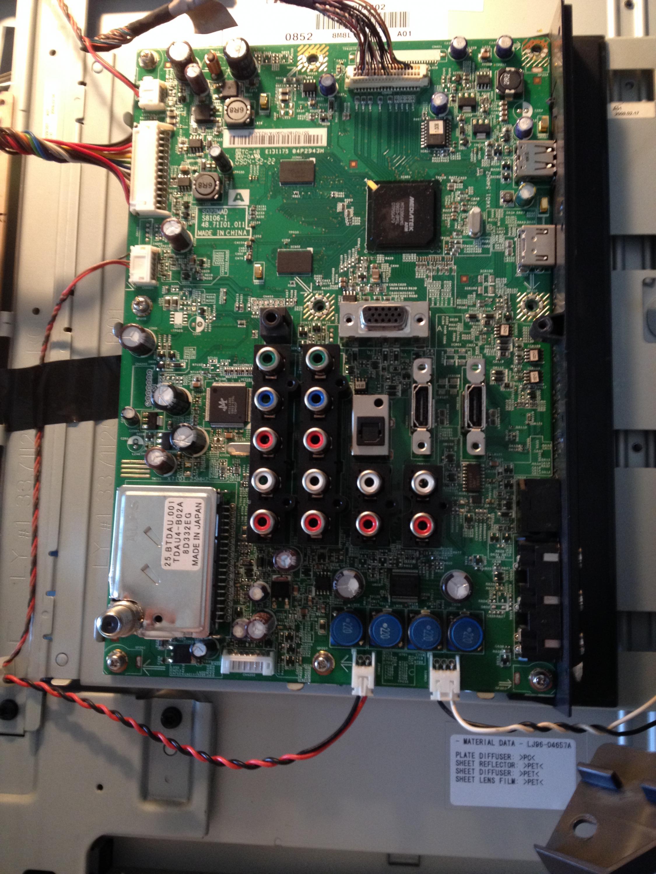

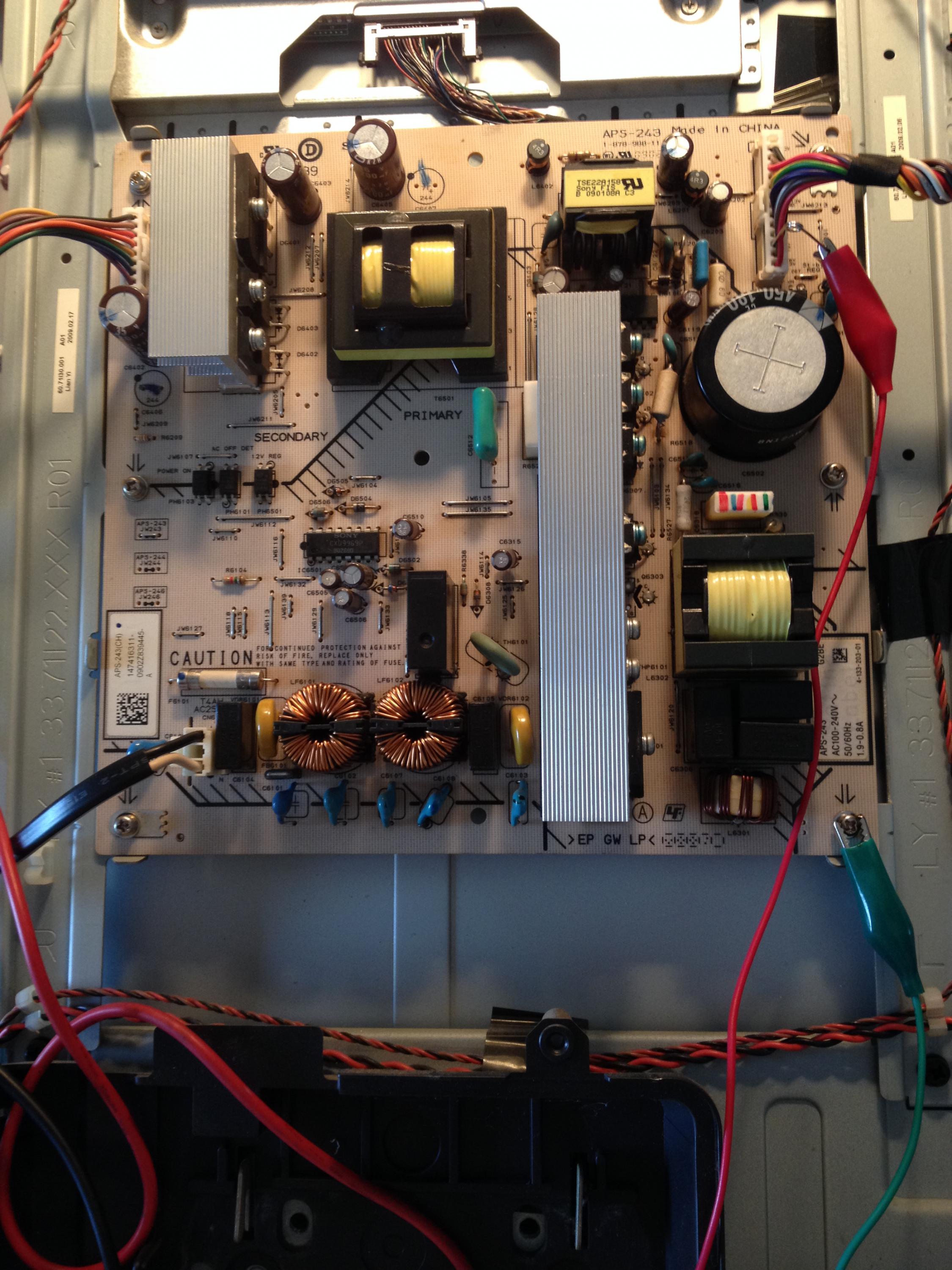

Picked this up the other day and when plugged in sometimes I get no LED and other times I get green power led and other times i get green power and picture/timer green led. Never red standby led. Have my voltages as soon as it is plugged in, relay clicks pson, stby volts and 12 volts to inverter. Don't have remote for this. Power button does nothing. tried heat on main, unplugged various connectors one at a time, no change. Main board? Thanks
KDL-32L5000 no standby led
