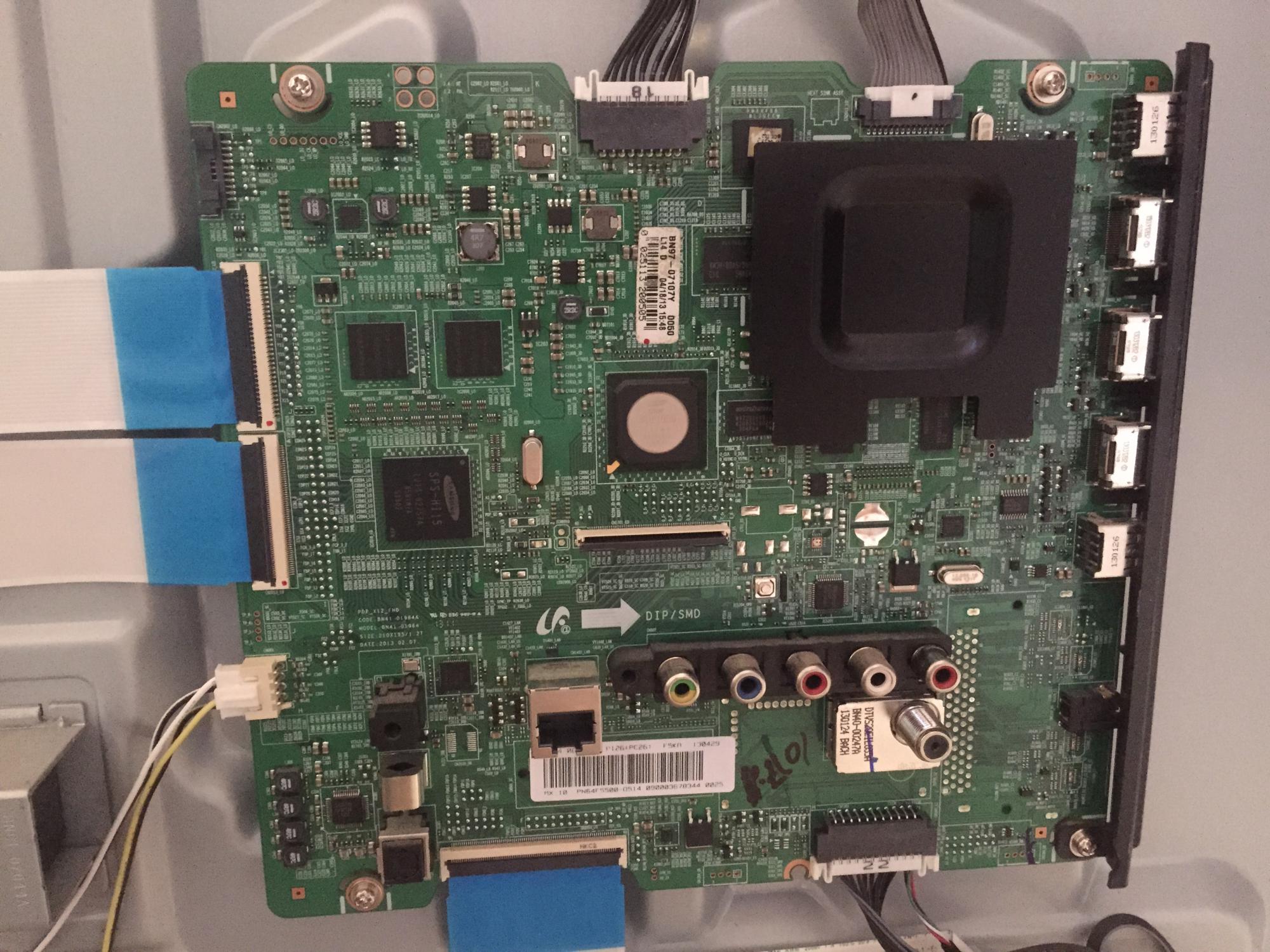

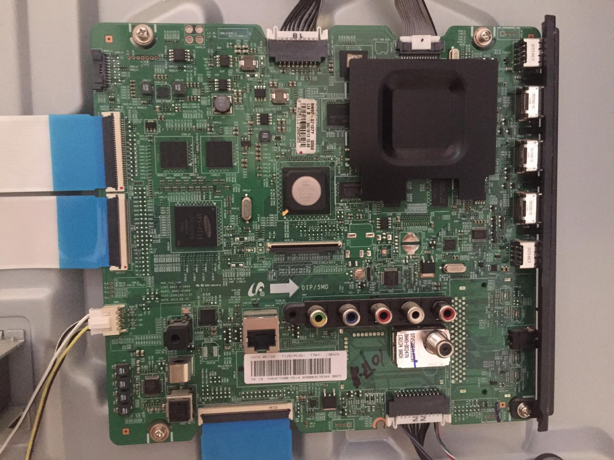

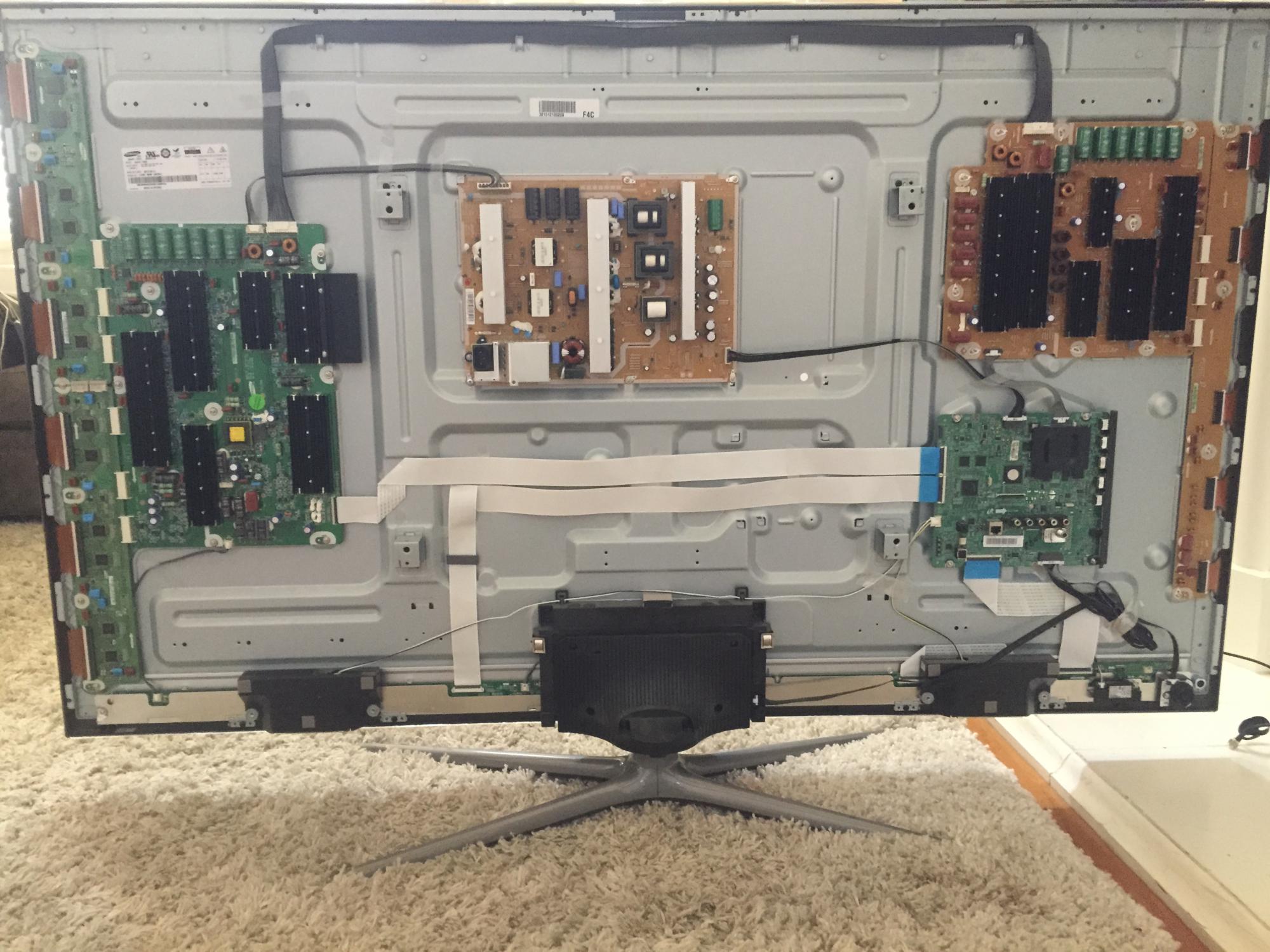

        Double checked and I think my the control board might be merged with my main board or else I simply can't find it. Here are some pictures of the back of the TV and the main logic board

          Yeah looks like it.
          Ok the sticker above the ysus has the voltages that must be present for the TV to operate.
          Vs, va vsc and ve.
          Vs and va test points are on the power supply, vsc on the ysus and ve usually on the xmain (zsus)
          You need to have the TV powered on and monitor these voltages and see if any drop and rise when the panel goes black then back on
