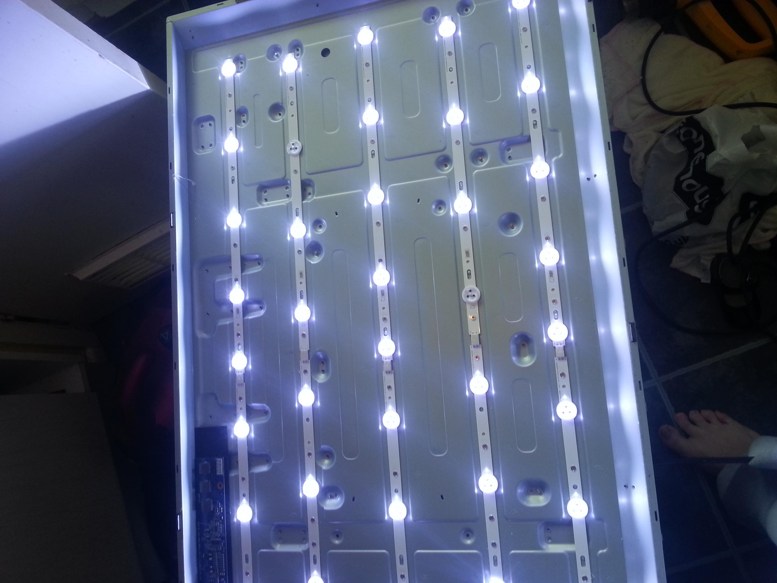

    hi got this led tv the other day as back light not working I managed to get it working but 2 bulbs dont light up and occasionally there's a slight ficker on the backlight the picture on it is great but you can see the leds through the screen is this normal of have I put the films on in the wrong order?
    Re: Toshiba 40L1333B fault?
    LEDs shouldn't flicker, so more than one LEDs are bad.
    And you've probably forgotten a film or put them in the wrong order if you can see the LEDs.

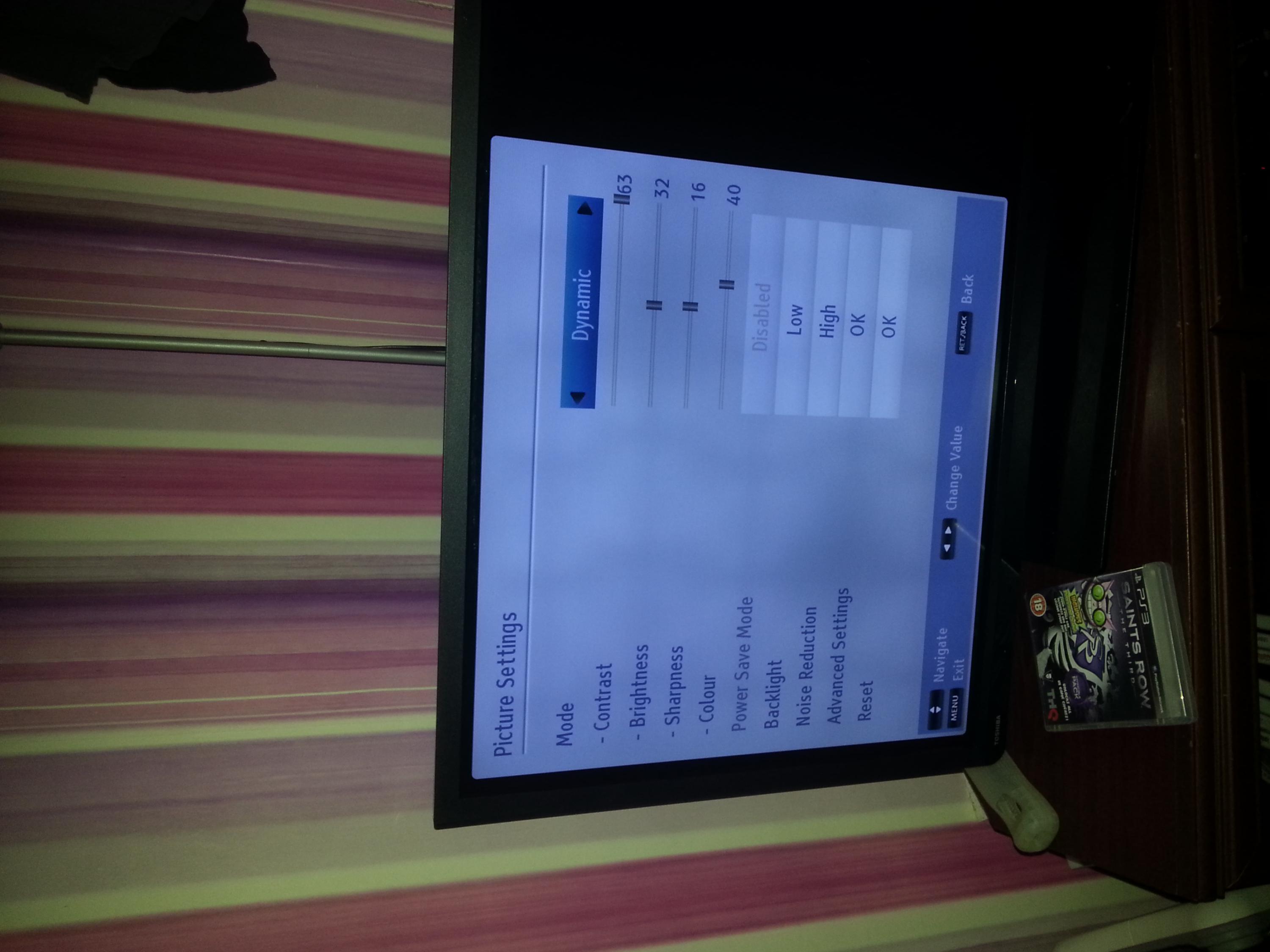

      found out the flickering wasnt actually flickering it was the eco mode dulling the brightness also ive added a picture as to what I mean by seeing the backlights
        It looks like two LEDs are shorted out (not on).
