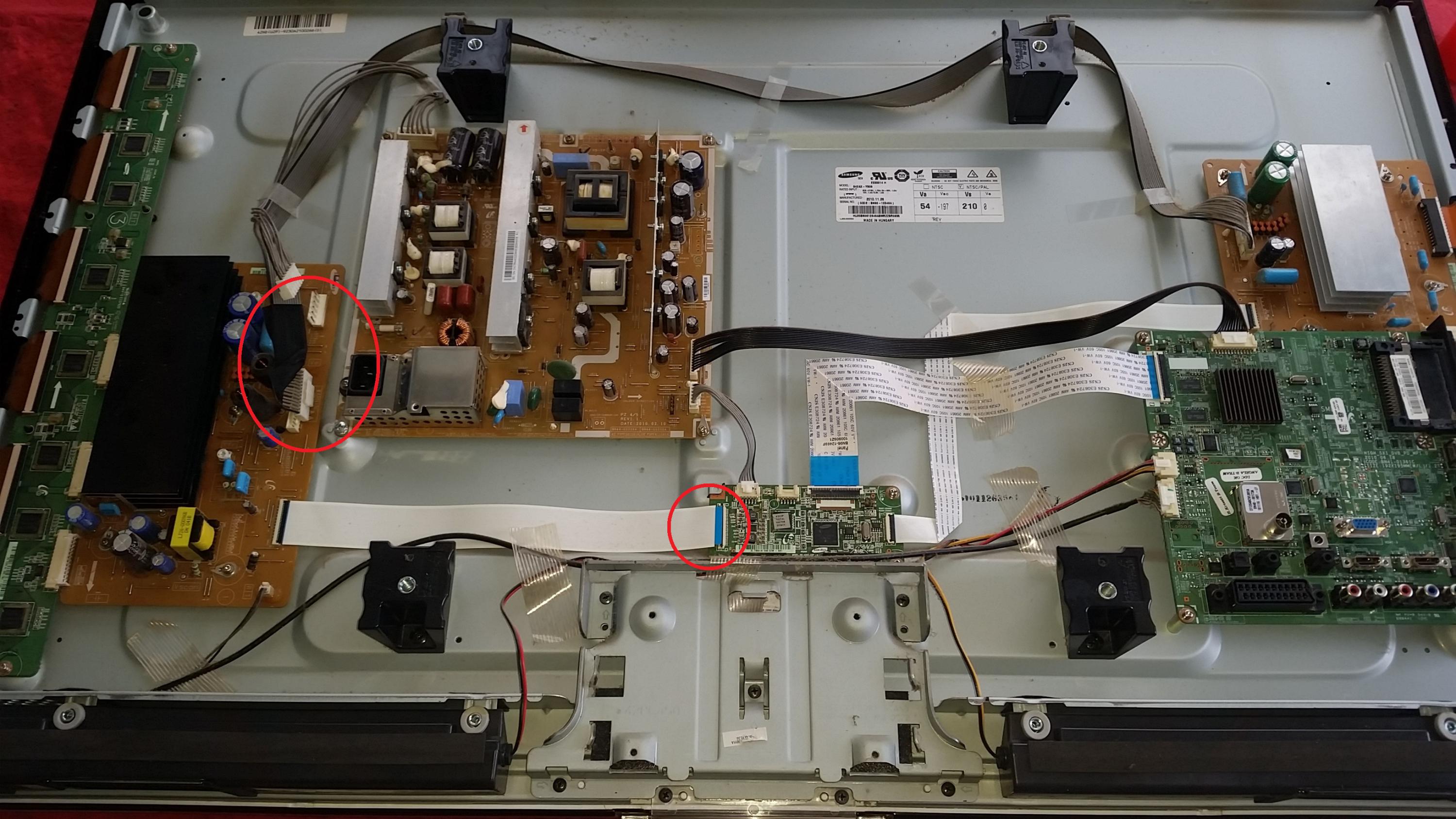

    hi guys
    been trying to fix this plasma tv
    the tv is just clicking when you try and turn it on
    ,the only way i can get VS/VA voltages is by disconnecting the Ysus power attached in the pictures then i get 205volts/50 volts and the samsung start up chime.
    The buffer board is fine no shorts so im suspecting its the Ysus ?
    thanks

    Re: Samsung ps42c450 clicking
    What happens when you reconnect that and disconnect the X-SUS?
    Y-sus feeds supply to the X.....
      already tried that alastair but the tv still clicks
        ok so replaced the Ysus today but still Vs/Va dropping
        Vscan is 12.2 volts
        Va 20.8 volts
        Va 3.1 volts
        tried disconnecting the buffers board but still the same readings
        tried disconecting the xsus still the same
        led on control board is slowly flashing once every 3 seconds roughly
                This model has a known problem in that you need to change all the boards Y buffer/Y Sus and X Sus in one hit as one bad board will take out the rest and you will go round and round by trying to change one board at a time. the new Y Sus you have fitted will most likely be blown now. loads and loads of post on this model and the Bush that used the same boards do a search Flocko
                    thanks flocko yes i read about this but never connected the xsus yet but also read toms reply about how they all should be connected but im waiting on a few transistors for the xsus now,also buffer board tested no shorts but ill update the thread once i fit them
                      https://www.youtube.com/watch?v=8BLqaZJeCk0
                      ok so changed the ysus and the xsus today but still getting no picture i have uploaded a video above
                      VS now 205 volts
                      VA 53 volts
                      VSCAN -194
                      VE 134 volts
                      what i have done so far:
                      1.tested buffer that has no shorts
                      2.tried adjusting the Yrr/Yfr
                      3.tested test patterns it tries to do patterns but very much as in video but different colours
                      the only thing different is i needed a RJH30E2 transistor on the xsus but only had a RJP30E2
                        RJP30E2 is this the right number? the only RJP30 IGBT I have stocked is the RJP30H and that has a built in high speed diode and could be your problem the RJH30E2 has no diode Flocko
                          thats the number flocko i have used in my xsus but i have since ordered a RJH30E2 which was the orignal one used in the xsus
                            Should be OK without a diode, it might fail while running, but should not affect the operation of the set, the diode is only there for protection reasons.
                              can i ask what should VE measure because on the panel label its got 0 but on the Ysus its 103 volts and the Xsus its 103 volts
                                Fixed :
                                changed a few transistors on the Ysus that was blown
                                  103V is about right. Anywhere from around 80 to 120V. Always less than Vs.
