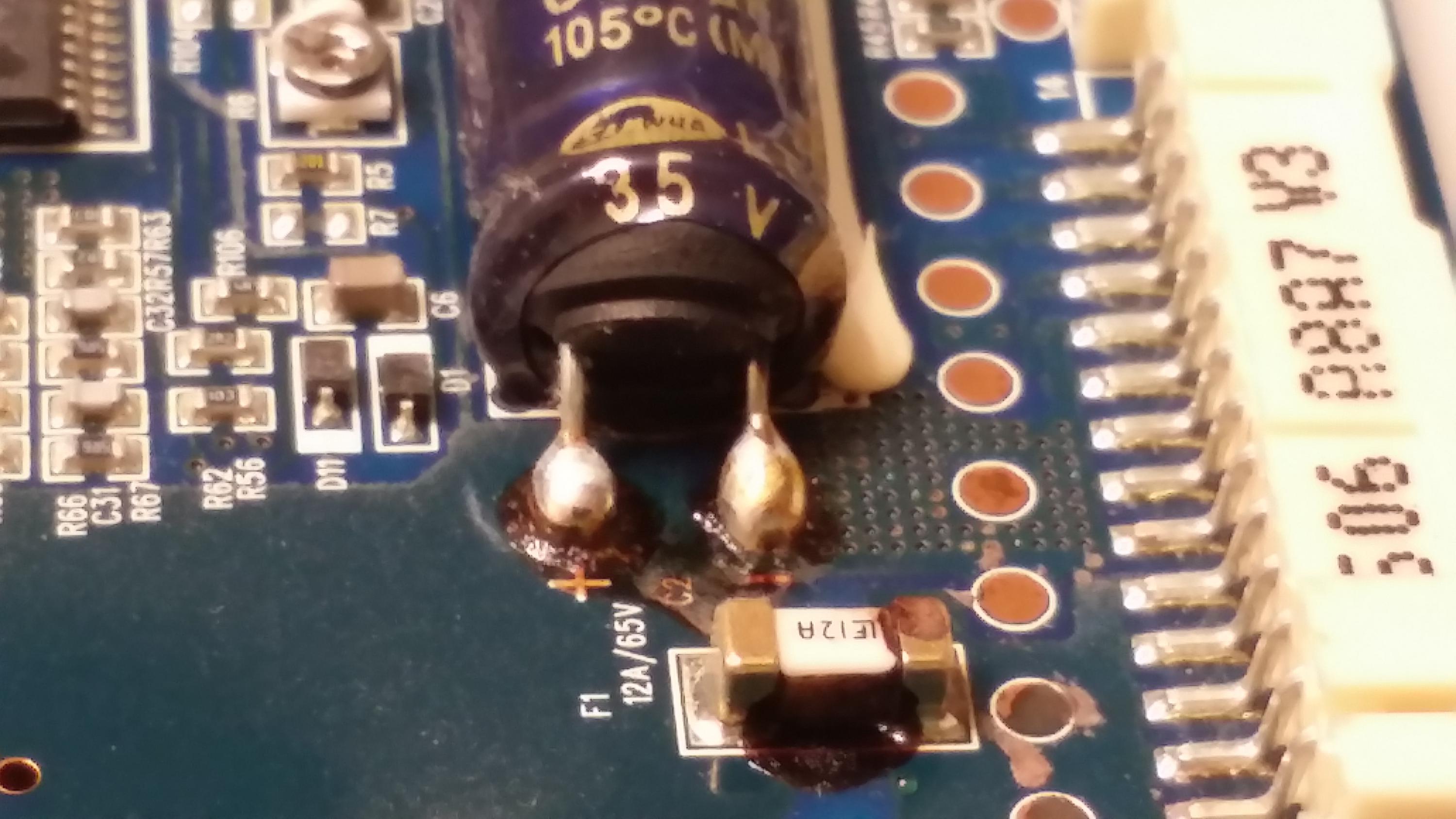

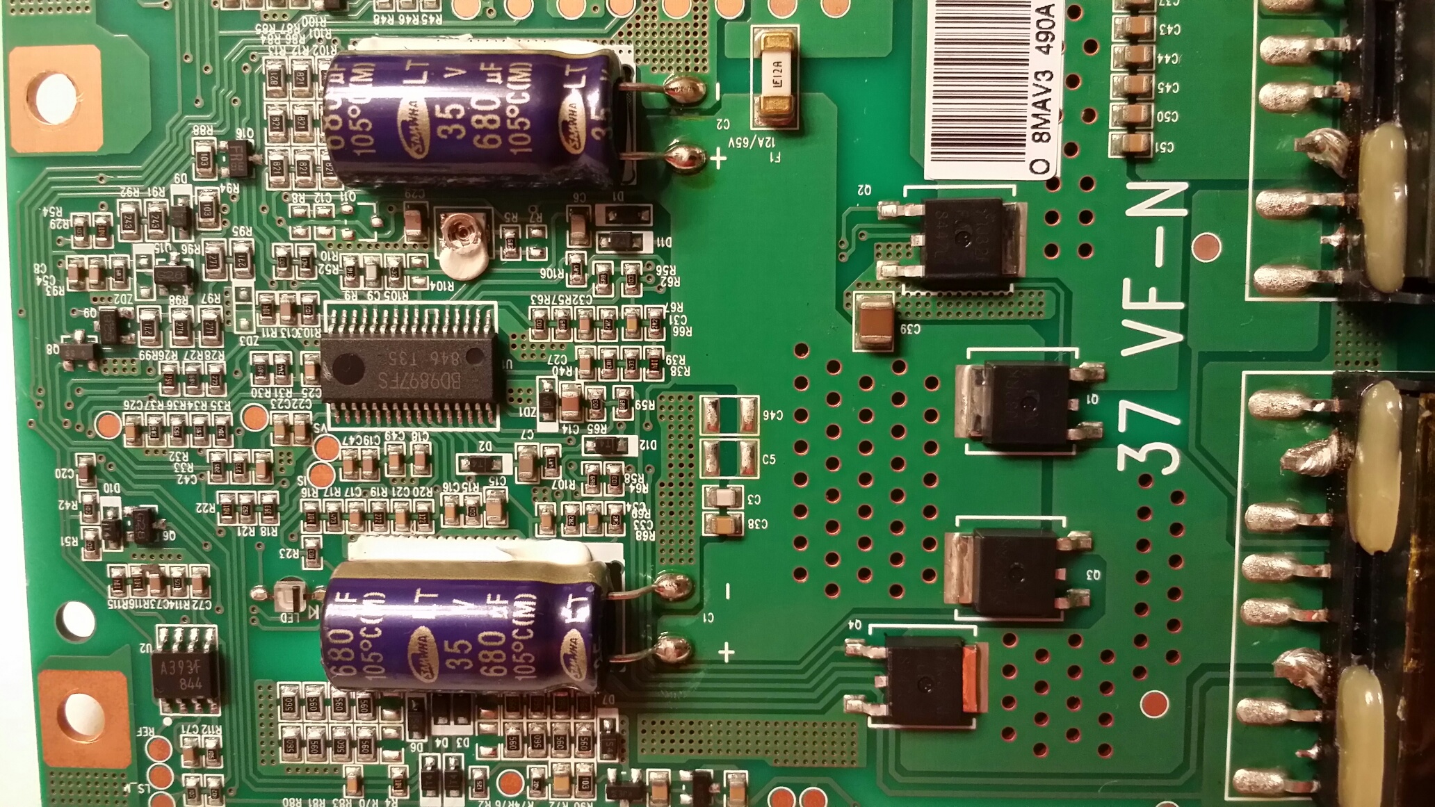

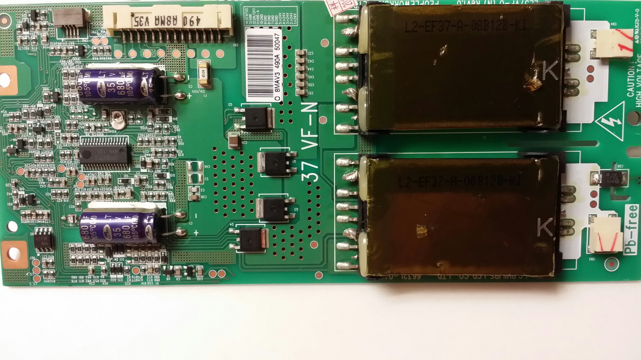

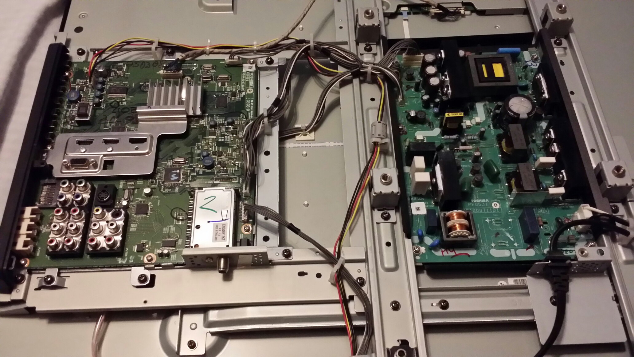

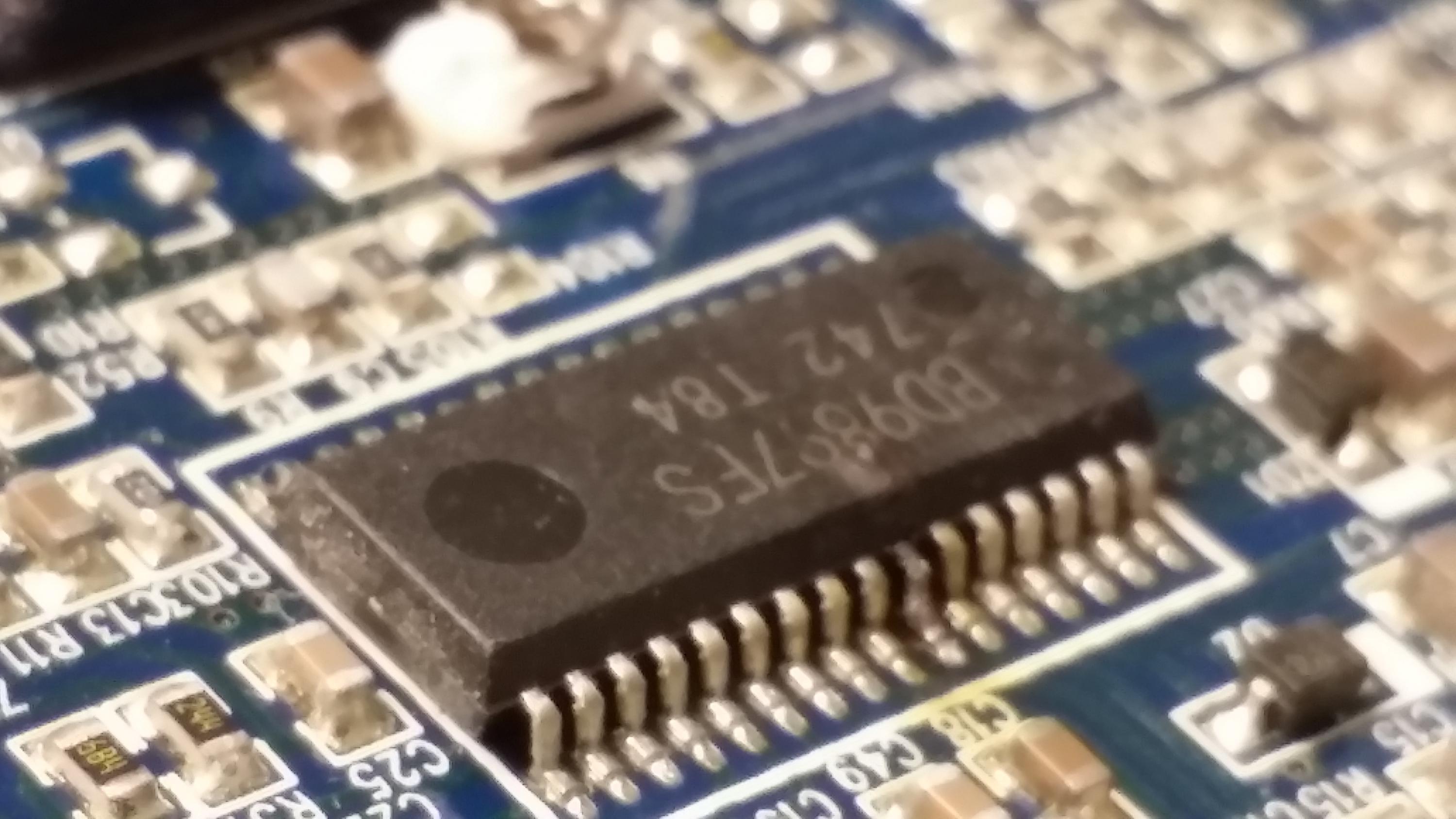

when I first opened the tv up and looked at the inverter I could tell it had failed. I purchased a brand new inverter and installed and now the tv works for about 1 hour and then the back light goes out. but I still have audio. what would I test first.

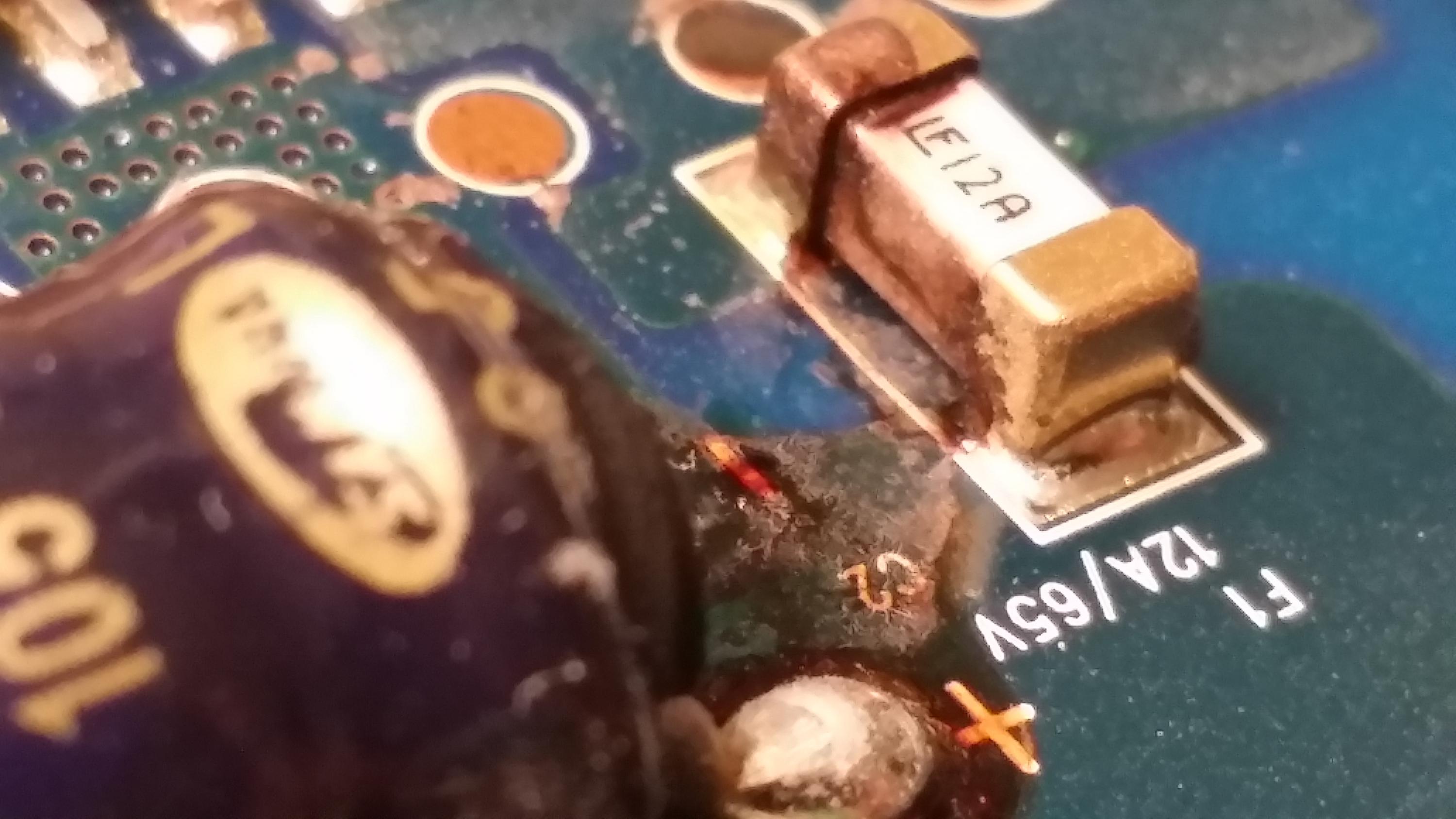

https://www.badcaps.net/forum/attach...6&d=1428428242

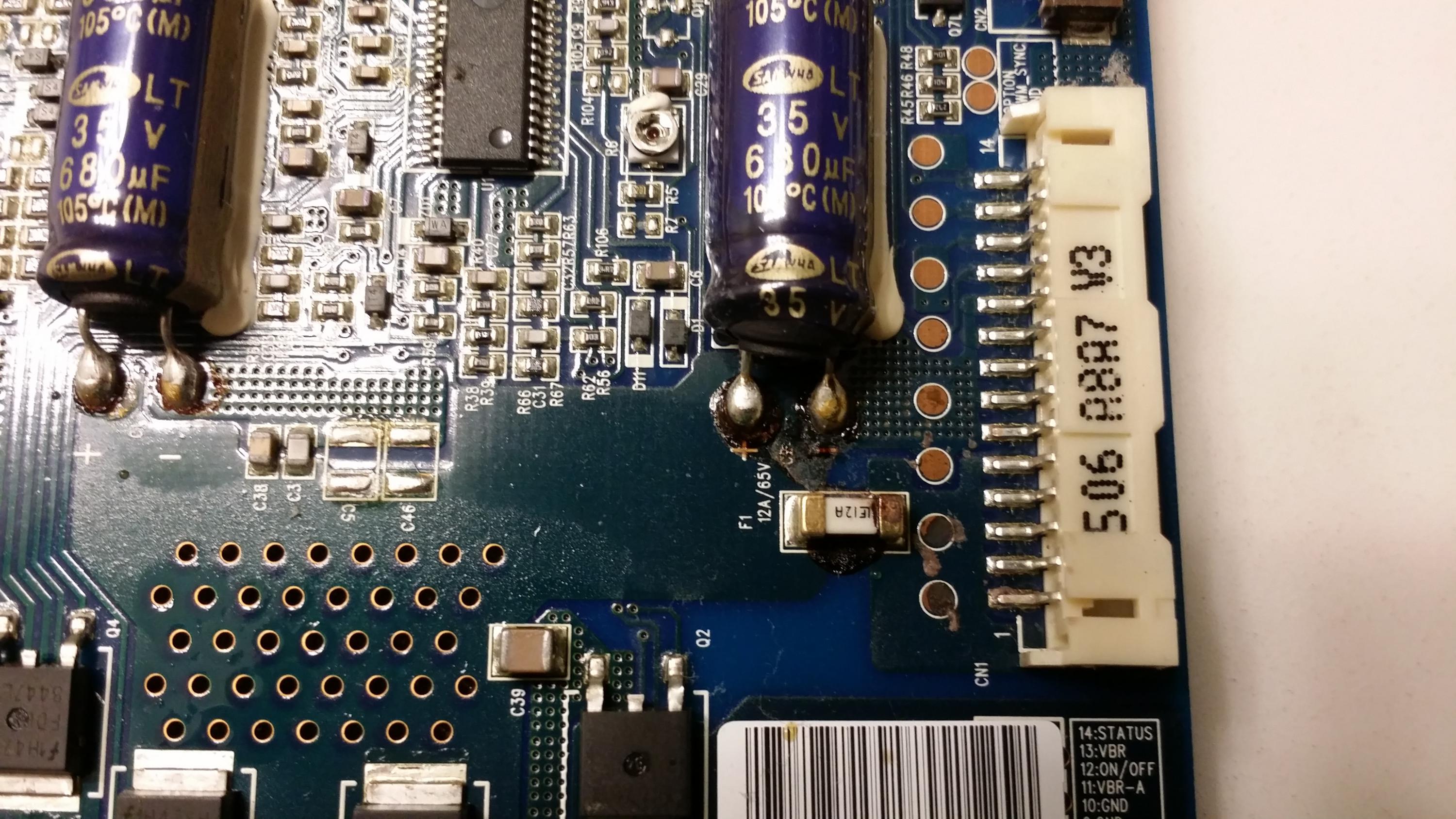

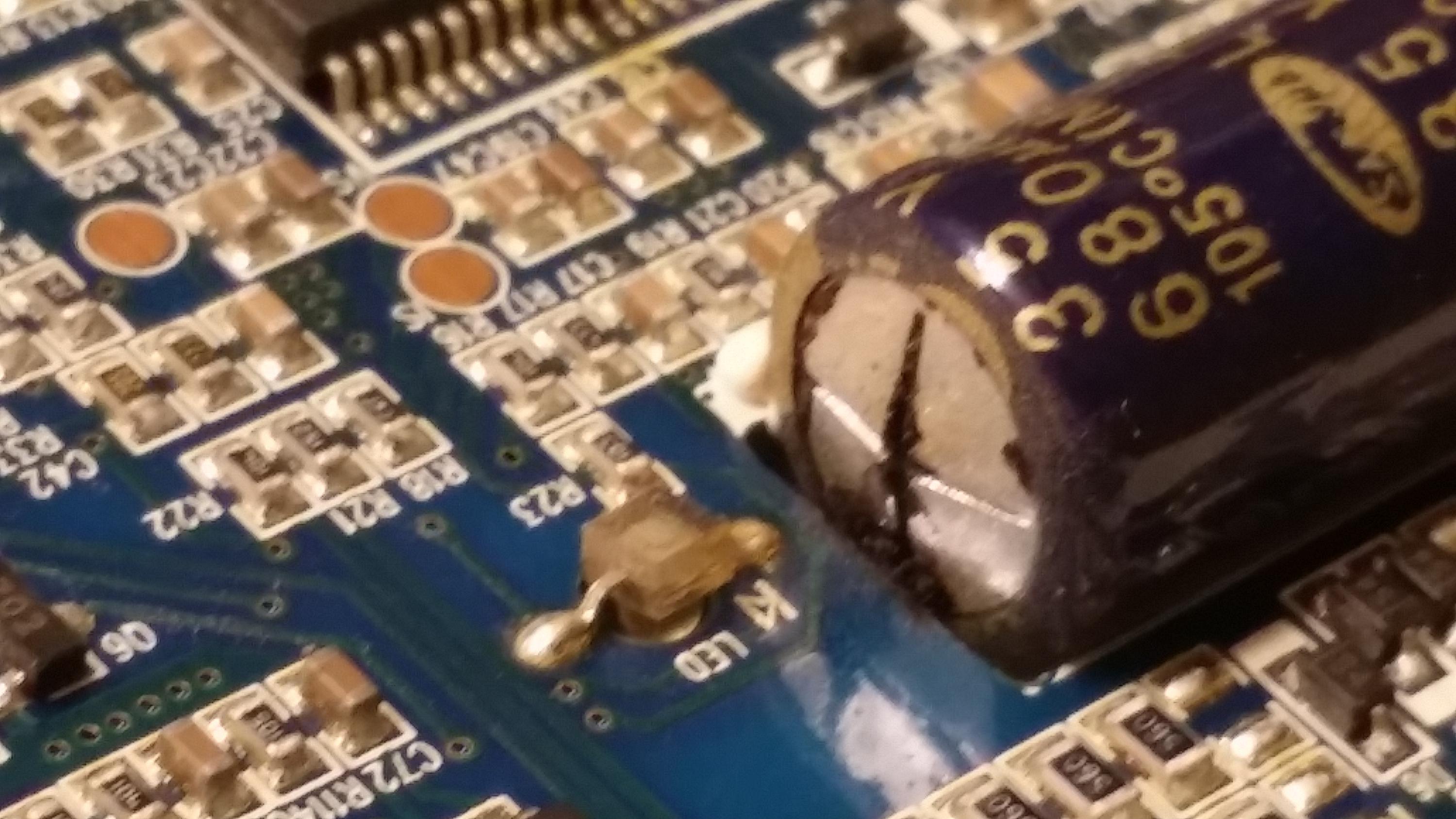

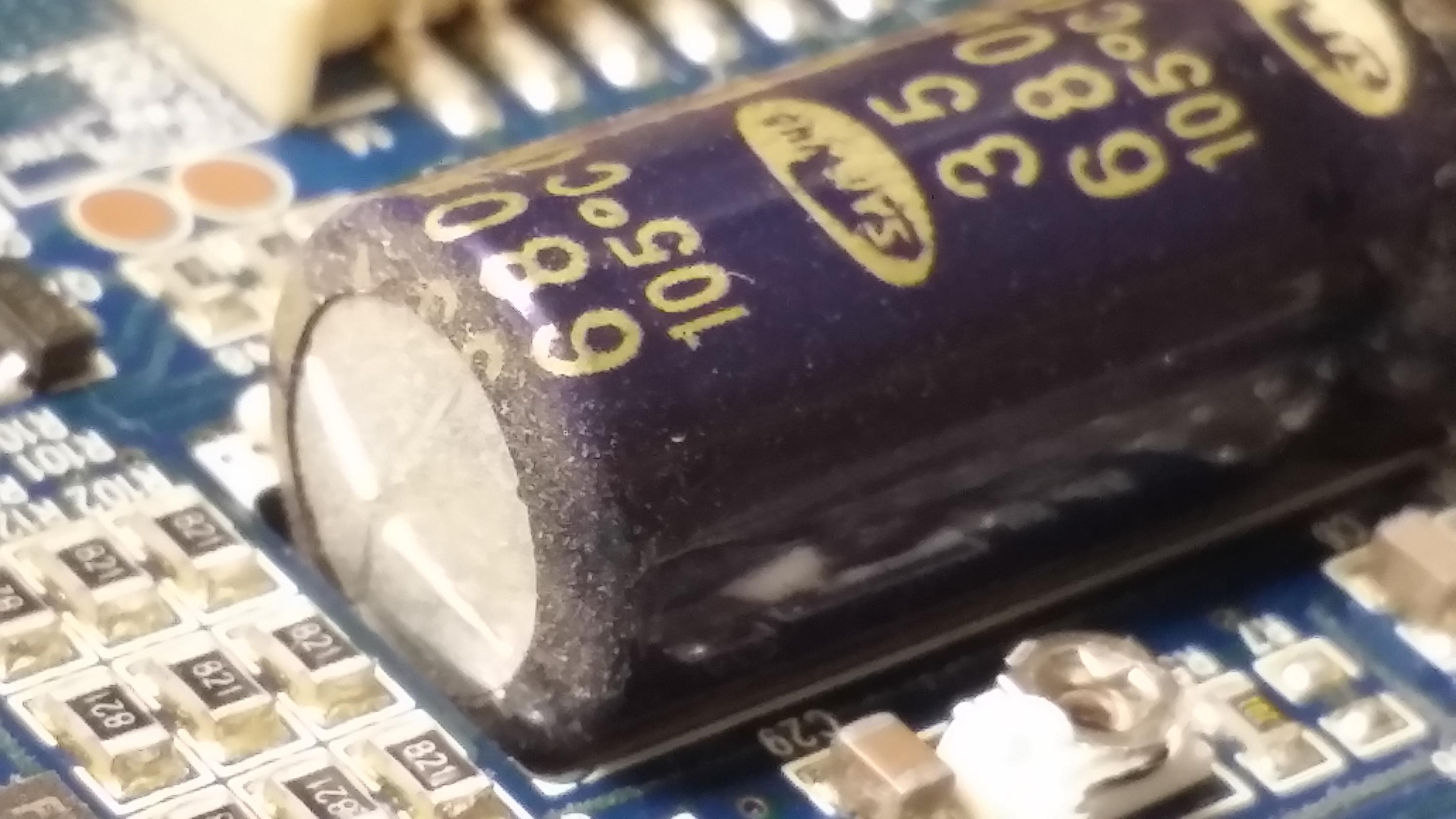

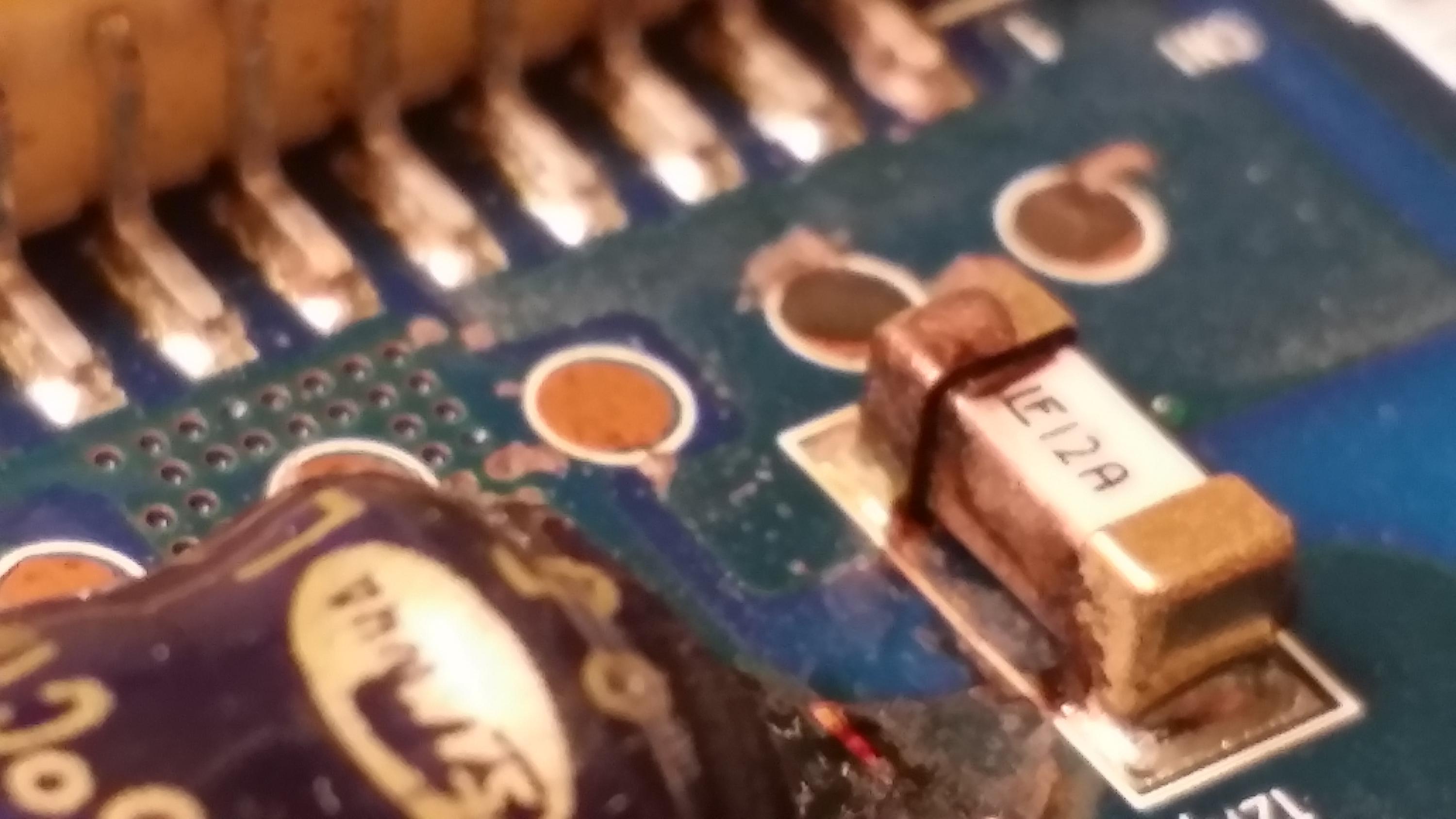

It looks like the cap by the white fuse has bottom rubber seal bulging out?
https://www.badcaps.net/forum/showth...901#post547901
Also liquid came off it.

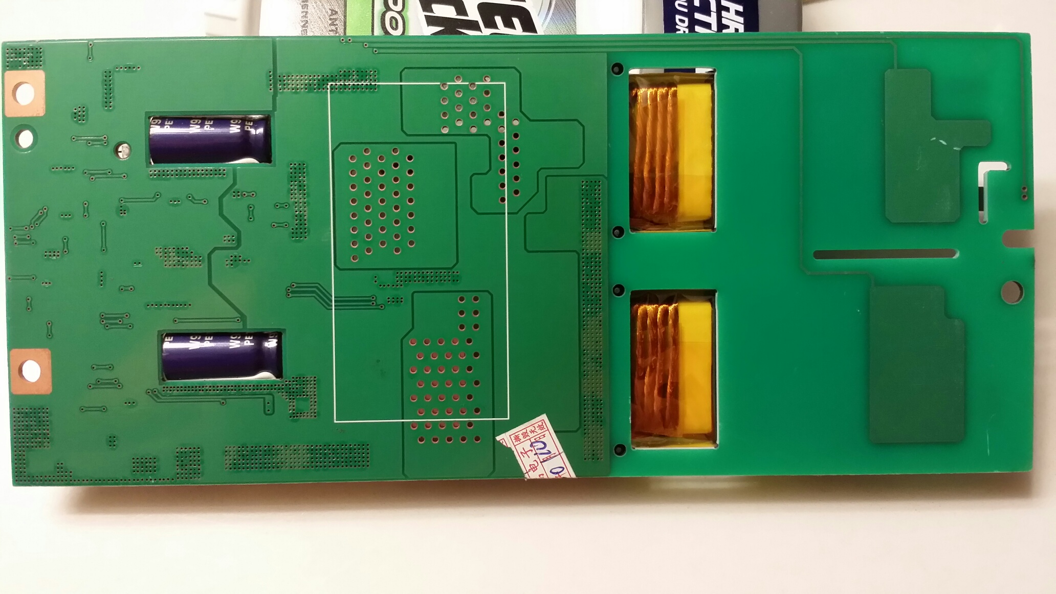

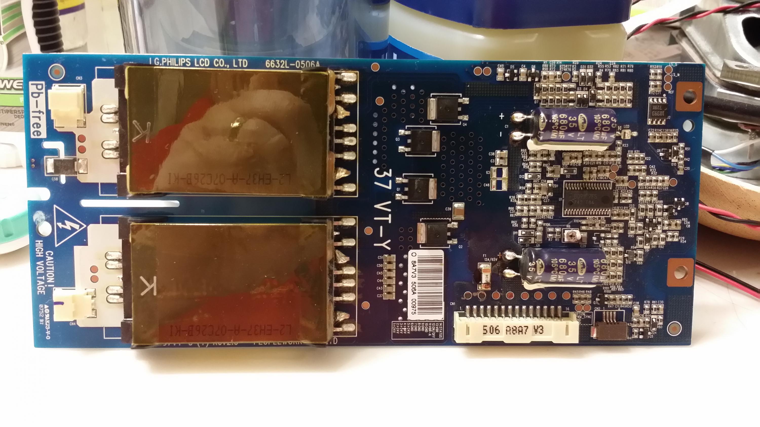

So are those pictures of the old boards or new boards?Last edited by budm; 04-07-2015, 11:49 AM.Never stop learning
http://www.badcaps.net/forum/showthread.php?t=24809Comment
Re: Toshiba 37CV510U bad inverter
So are you still getting the 24VDC for power and the BL-ON command for turning on the inverter?Never stop learning

if I let the tv sit for about 10 minutes then turn it back on the tv will work for about 1 hour. I will test the BL-ON and the 24 volts. is it possible that the power supply was damaged when the first inverter went out?Comment

You need to find out what is missing first when the backlights go out, if the 24VDC disappears or the BL-ON disappears.Never stop learning

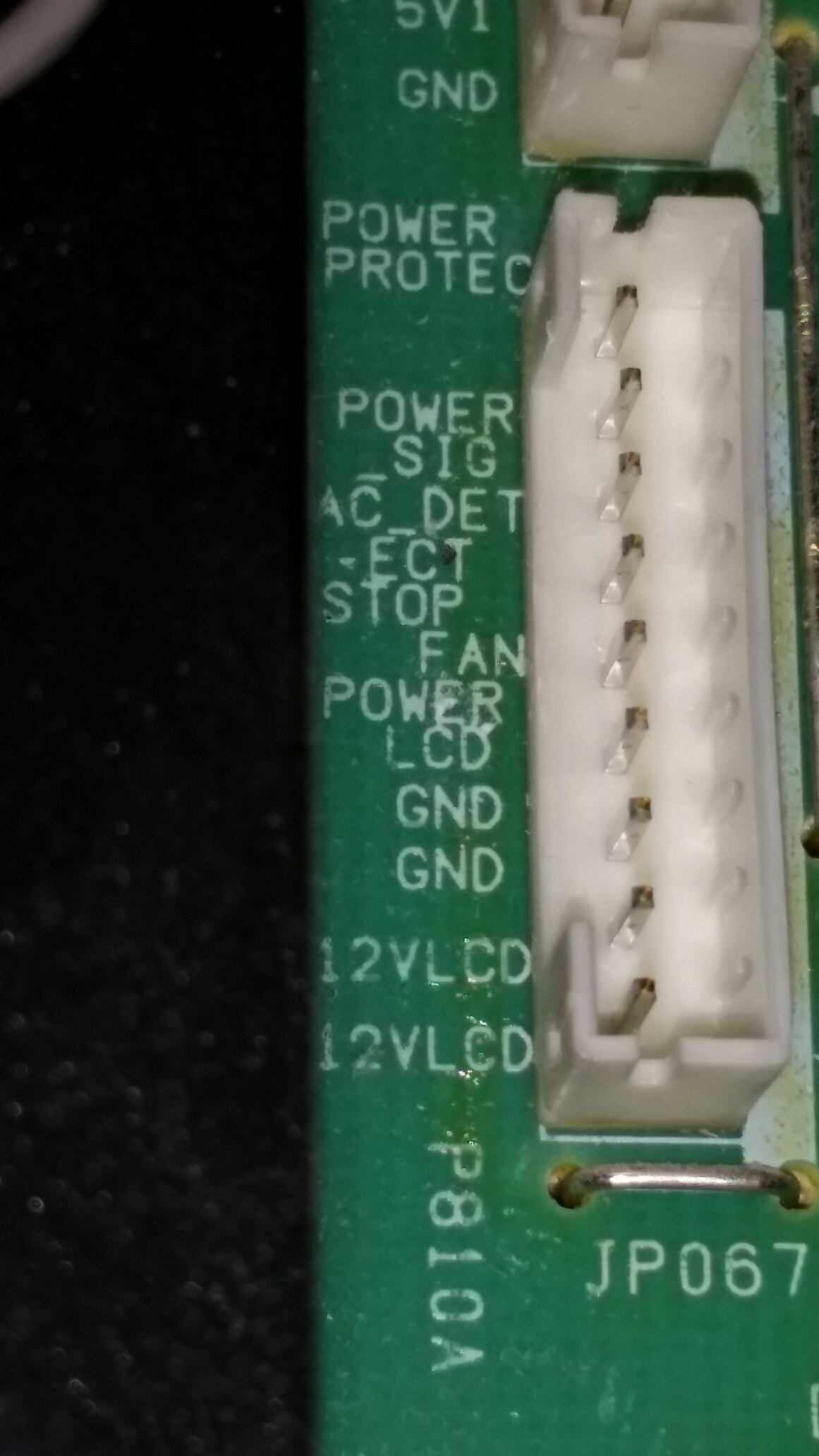

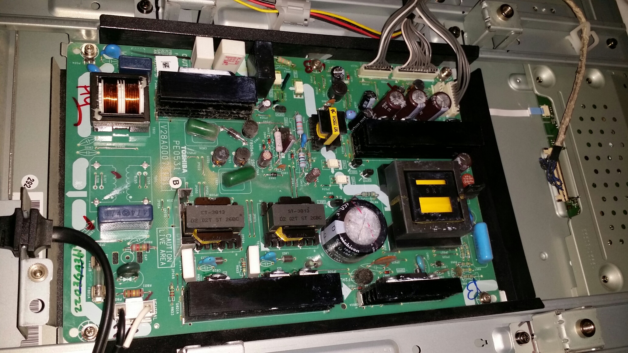

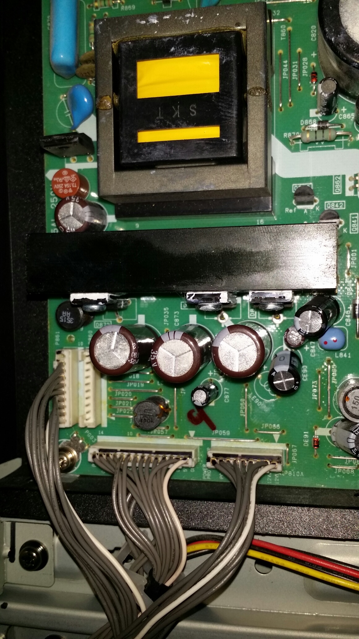

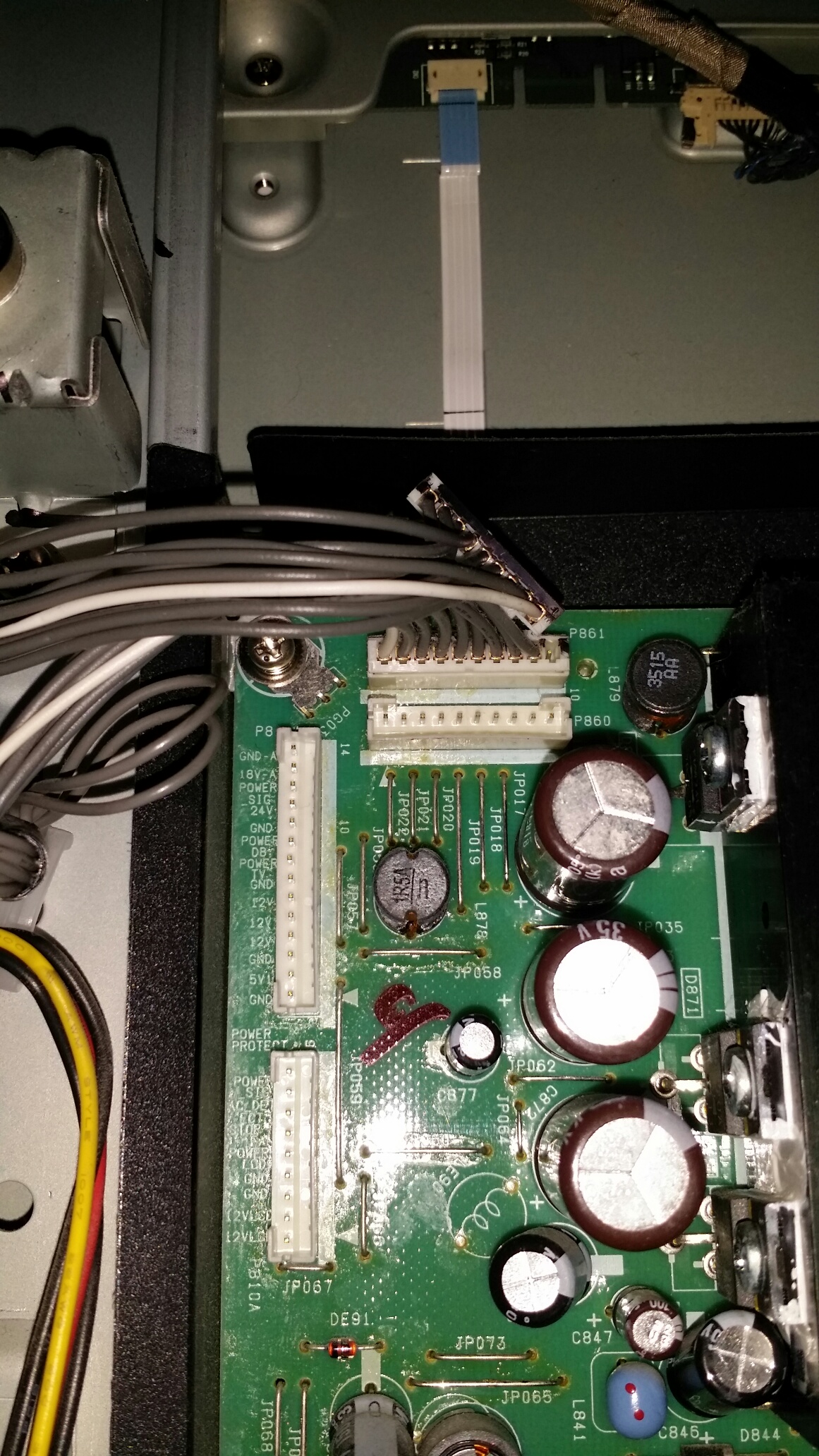

in picture 20150407-201954 this heatsink gets extremely hot. all of the rest of the heatsinks on the power supply are just warm. this one I think is the one that is driving the 24volts to the inverter is very hot. I have tested the 24 volts and when the backlight is on and when it turns off I still have the 24volts. where do I test the BL-ON?Attached Filesif you find these attachements useful please consider making a small donation to the site

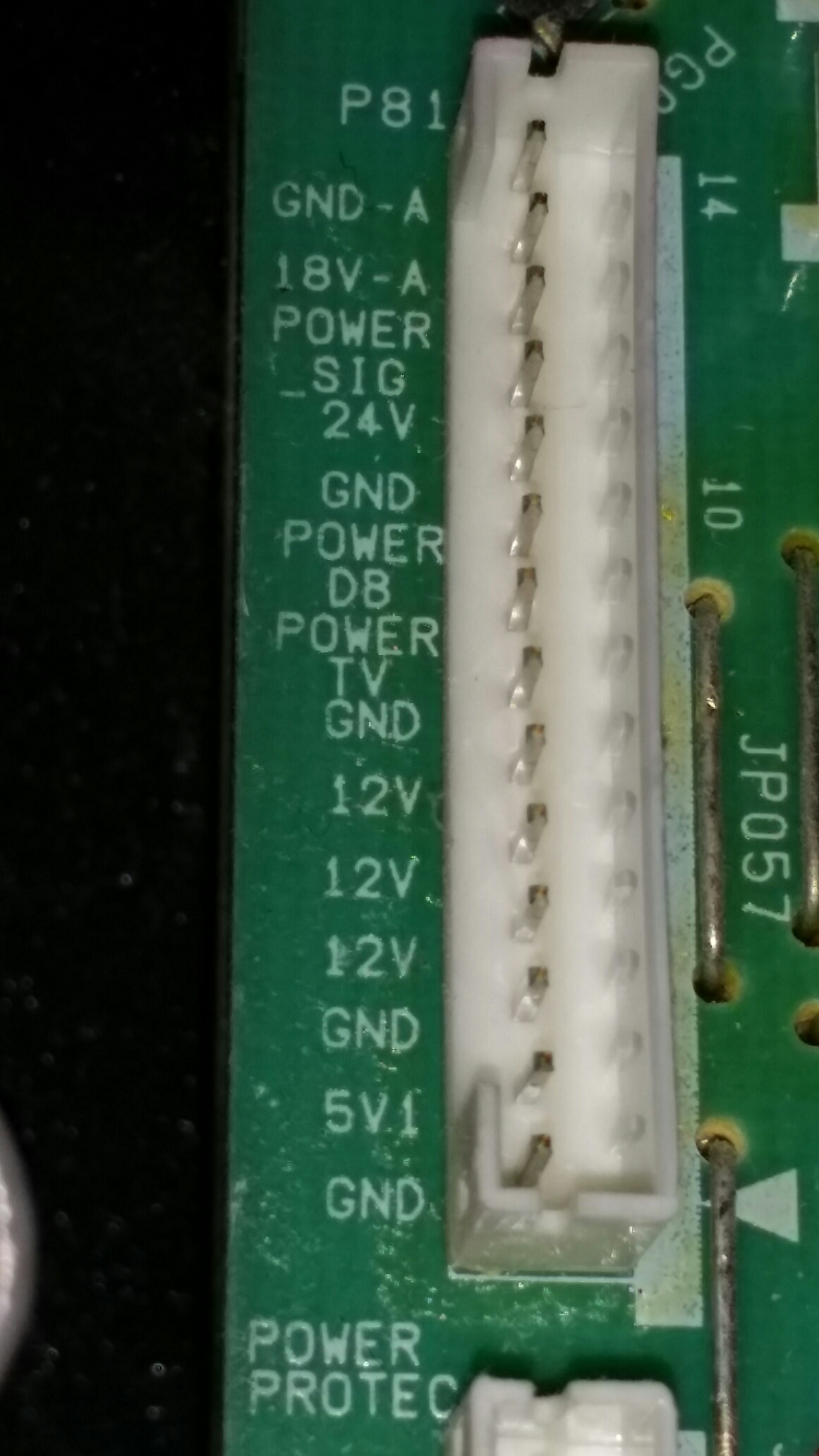

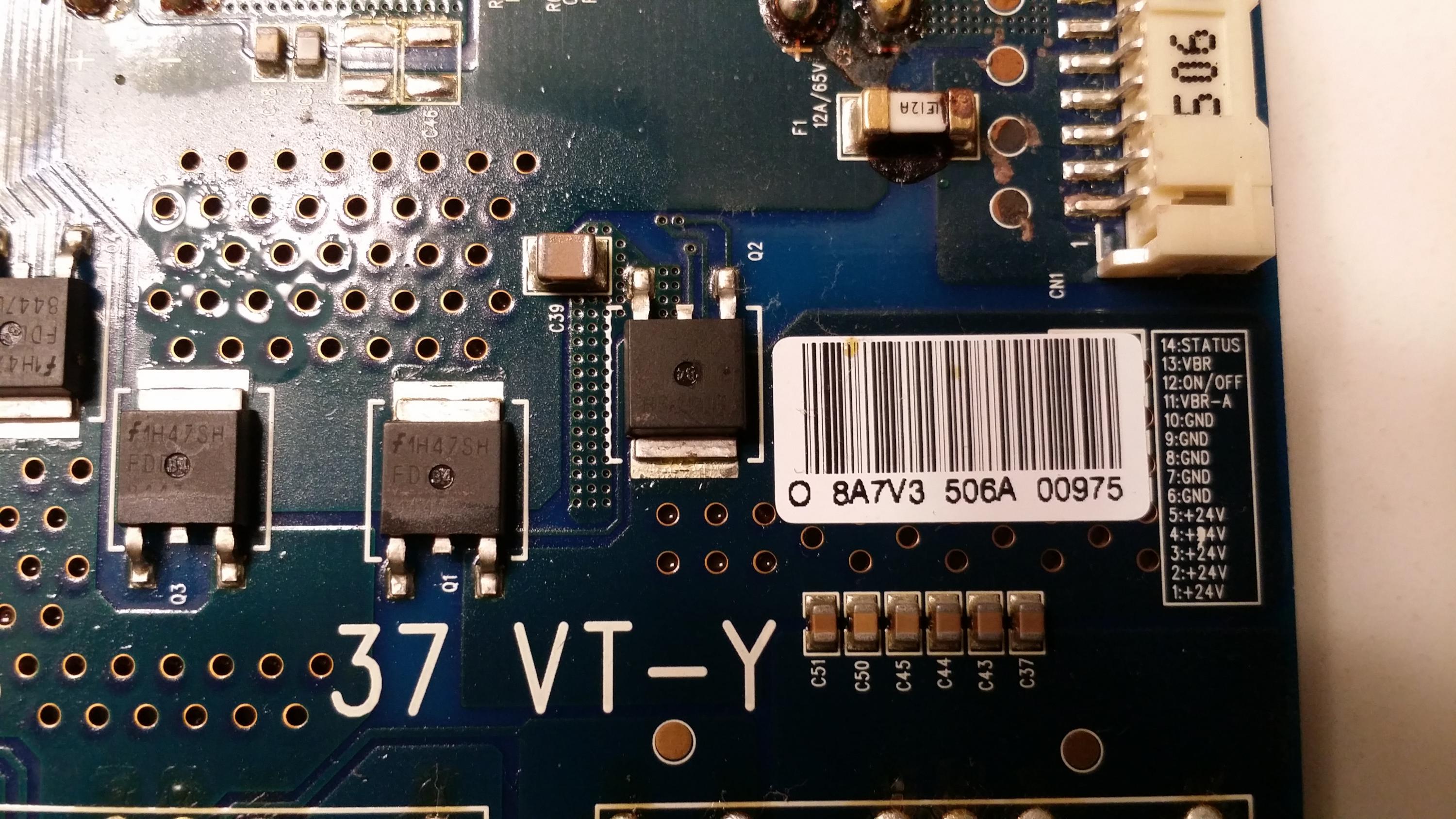

OK:
PIN 12 ON/OFF is the BL-ON PIN.Never stop learning

That heatsink is for the rectifier diodes so may be something is drawing too much current, or problem with the rectifiers which you should check.Never stop learning

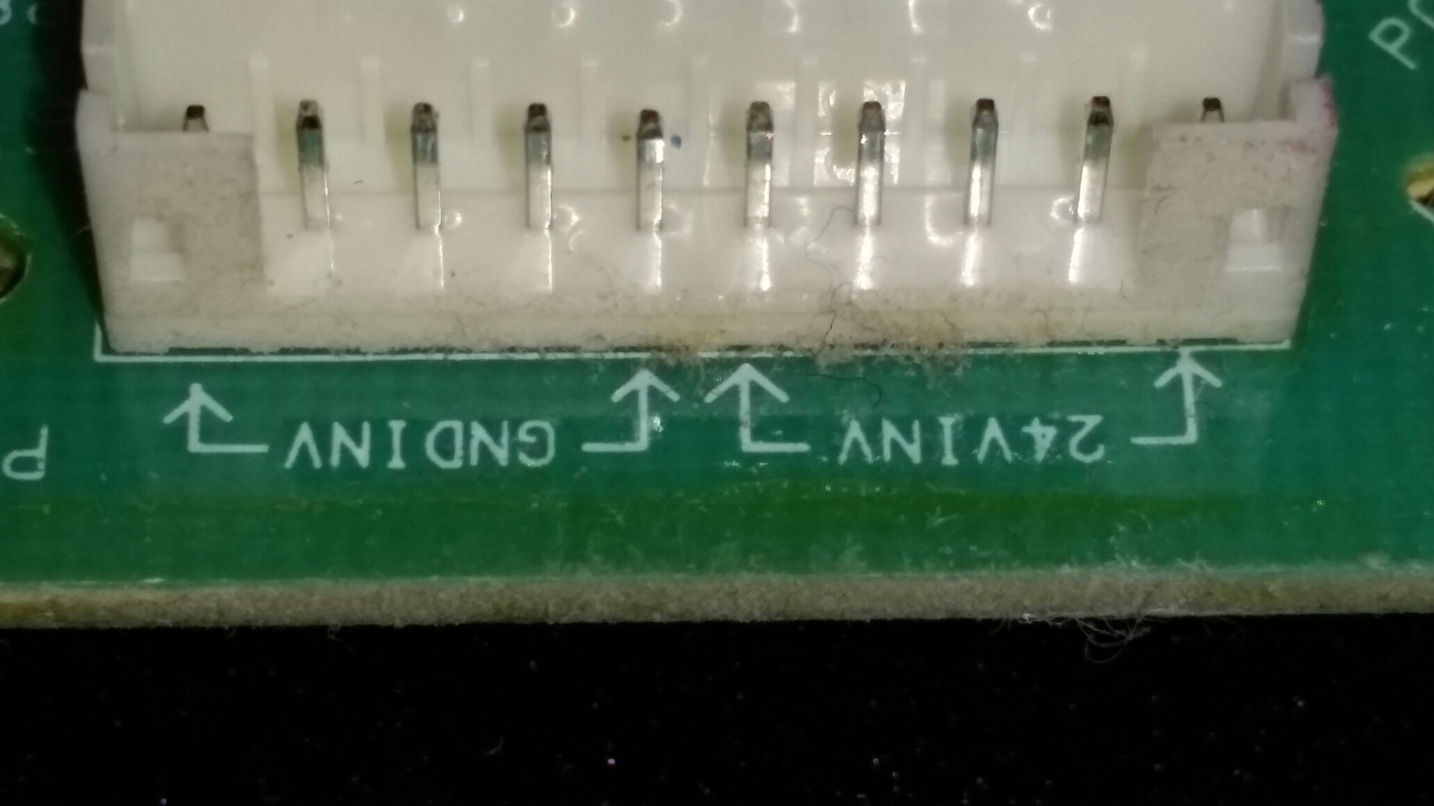

ok this connector with backlight in fault and not on
pin 1 gnd = 0
pin 2 5v1 = 4.9
pin 3 gnd = 0
pin 4 12v = 11.7
pin 5 12v = 11.7
pin 6 12v = 11.7
pin 7 gnd = 0
pin 8 power tv = 3.2
pin 9 power dv = 4.9
pin 10 gnd = 0
pin 11 24v = 23.8
pin 12 power sig = 2.7
pin 13 18v-a = 17.9
pin 14 gnd = 0
ok and this is when I restart the tv and the backlight is on
pin 1 gnd = 0
pin 2 5v1 = 4.9
pin 3 gnd = 0
pin 4 12v = 12
pin 5 12v = 12
pin 6 12v = 12
pin 7 gnd = 0
pin 10 gnd = 0
pin 11 24v = 23.8
pin 13 18v-a = 18.2
pin 14 gnd = 0Attached Filesif you find these attachements useful please consider making a small donation to the site
Why don't you check the signal right at the inverter as I indicated in post 16?Never stop learning
