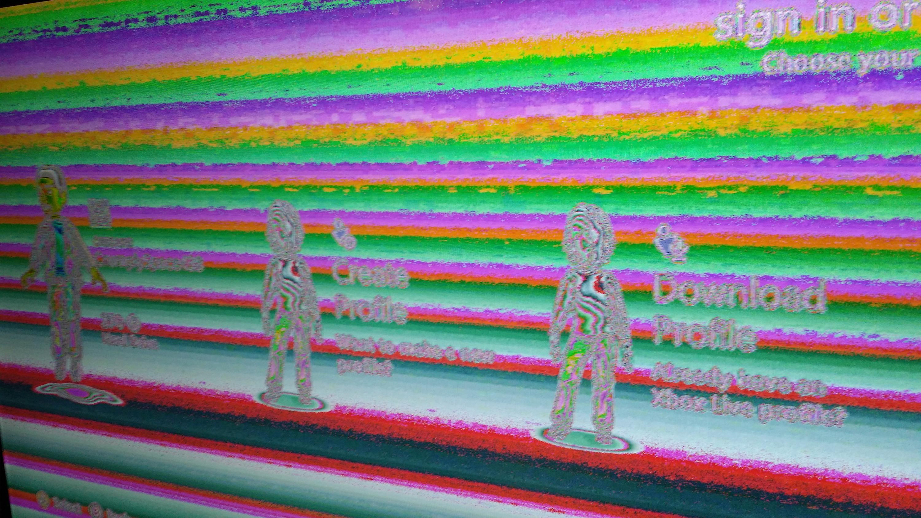

    Orion SLED4668W
    Hey!! I have a problem again..
    I have a Orion SLED4668W, with a distorted picture.. ive replaced the Tcon board thinking it would fix it but it didnt.. anyone have any ideals on what to do next?

    Are the system menus (volume, settings) also affected?

      Re: Orion SLED4668W
      yes

        Re: Orion SLED4668W

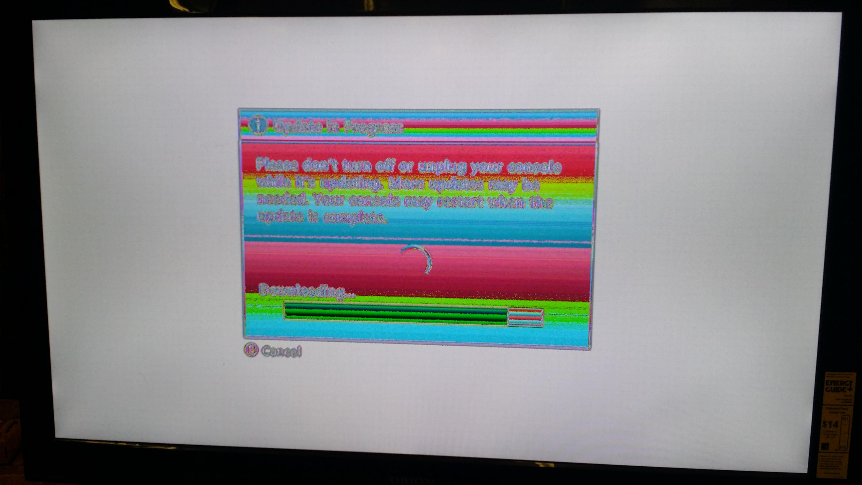

        yes, and it does it after being power on for a few mins
          Re: Orion SLED4668W
          I suspect it is an LVDS setting fault or main board problem.
          If you can get into the service menu I've found a factory reset usually fixes these sets.
          Looks like a Chinese OEM, so I'd try:
          Input 3690
          Input 2580
          Input 4725
          Input 9631
          And see if any bring up a hidden menu...

                            yea i couldn't none of those to work.. couldn't find anything online about it either.. should I replace to board would that fix the problem? cause customer wants her tv asap
                              Re: Orion SLED4668W
                              Main board replacement (HDMI inputs, etc.) would probably fix this fault.
