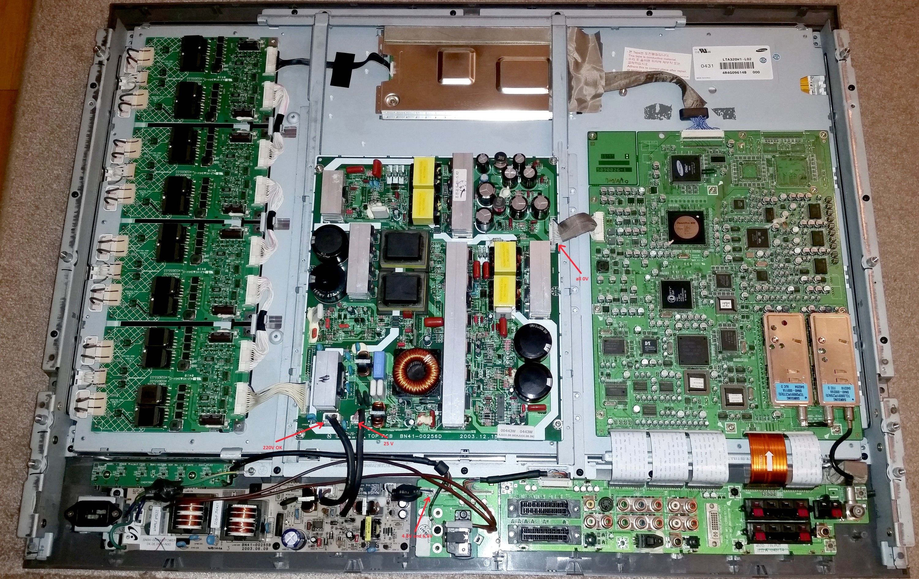

    Well, this one is for my mother in law ;-) So, you know the level of importance...
    It's a year 2003. model 32" LCD TV Samsung LW32A23W. Quite solid and quality TV as I can see... But, TV came to me year and a half ago. Initial symptom was "sometimes it won't turn on". Really, TV sometimes turn on OK, works OK, you can switch it on/off with remote or soft buttons. But sometimes it fails to turn on with soft switches or remote. Relay clicks, LED is orange (not green) and it's stuck. Once when you are stuck in that point you must turn it off with hard power switch or eject AC plug, and than retry. After few retries TV would switch on OK again.
    Now, I left it aside to repair it when catch some free time, and year and a half has passed ;-) Yesterday I finally decided to troubleshoot it and repair. Now after year and a half in storage it won't power on at all. Problem deteriorated, when TV is plugged to AC and hard power switch is turned ON, relay clicks, LED is orange and that's all. No response to soft switches or remote.

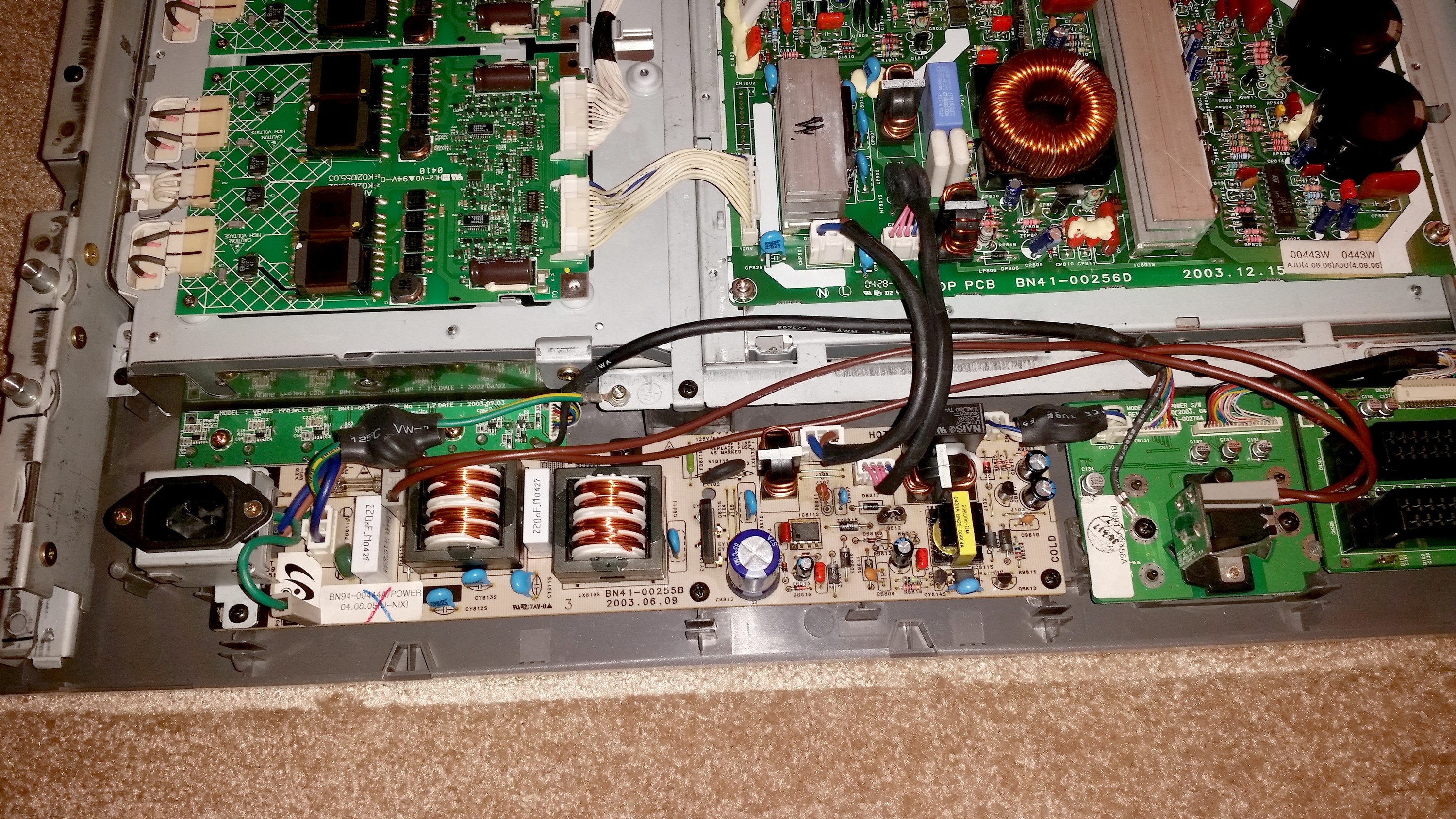

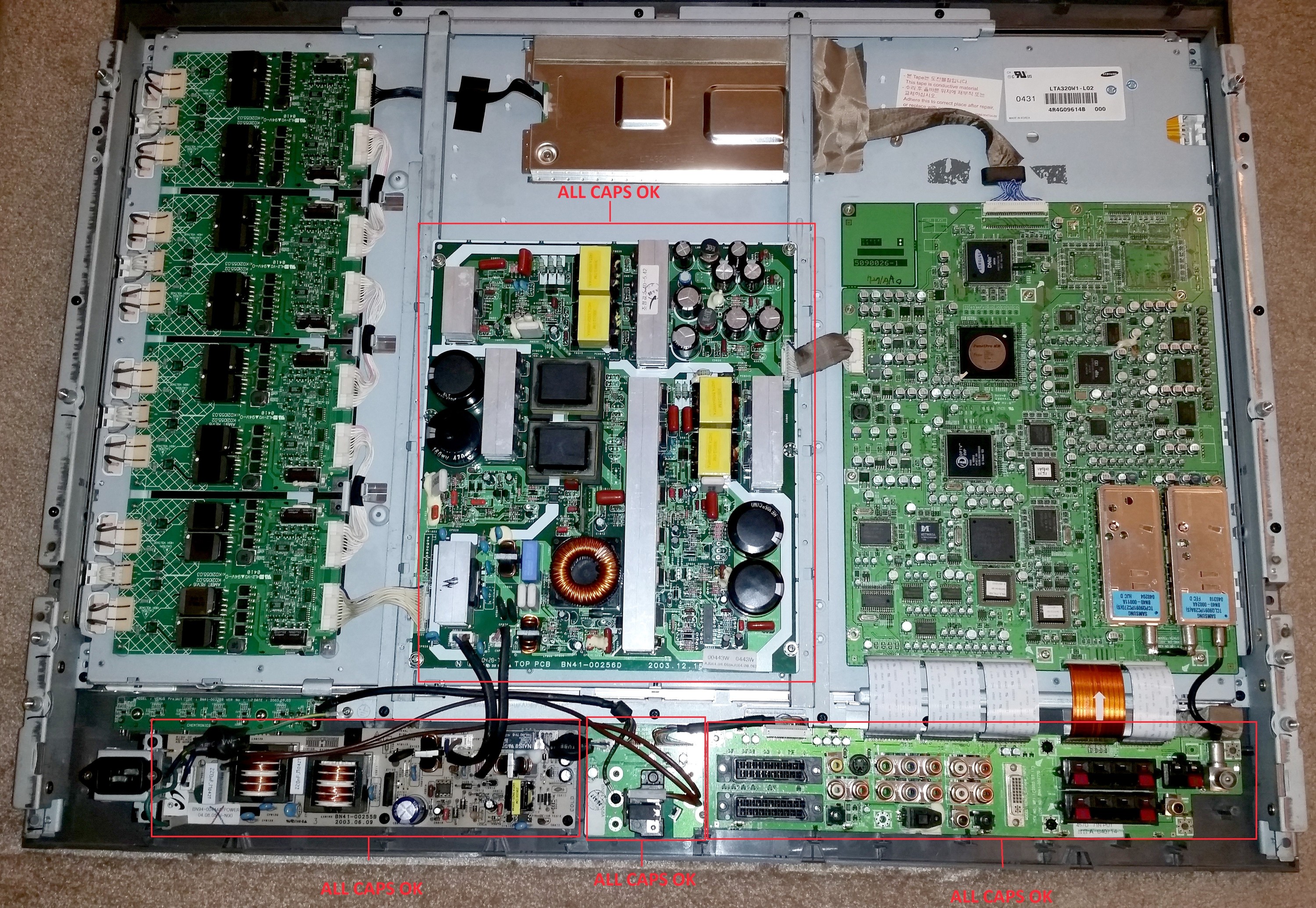

    First I was sure it's caps because problem deteriorated over time, but I checked PSU caps with ESR meter, all caps are OK. I didn't checked caps on inverters, t-con and digital board. I have no ideas what to check next.
    Please, could you give me some advice, where to start, what to check...
    Service manual is attached.
    Thank you!

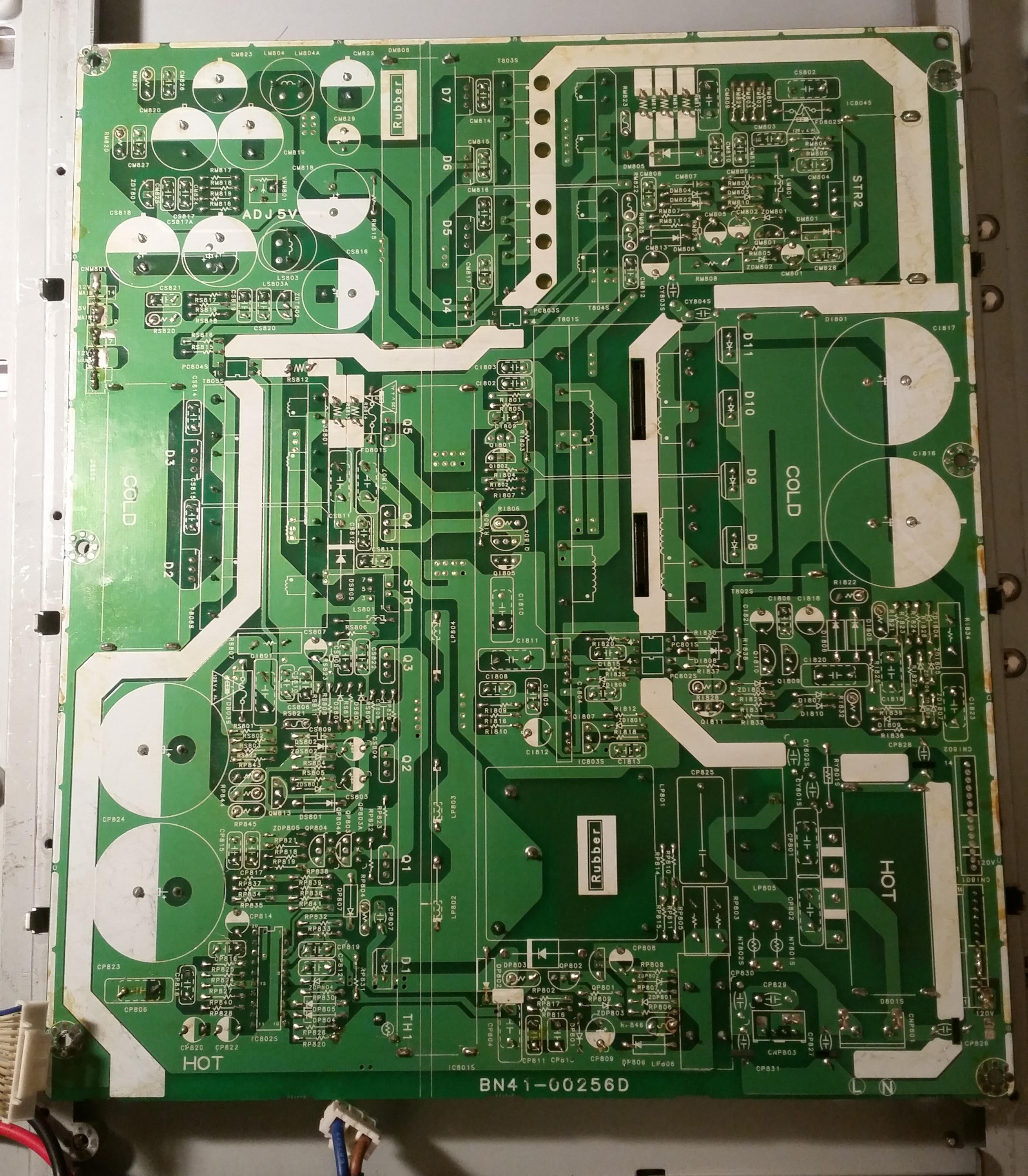

                      Re: Help needed - Samsung LW32A23W 32" LCD TV won't turn on!

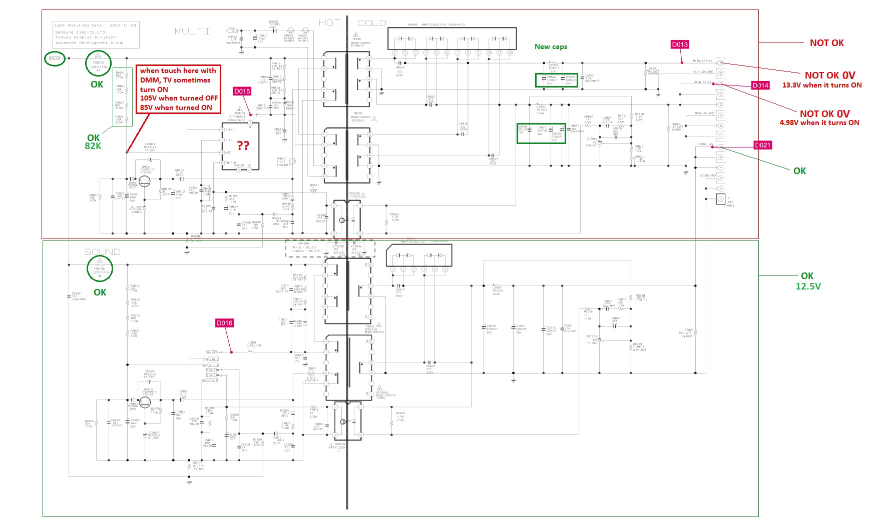

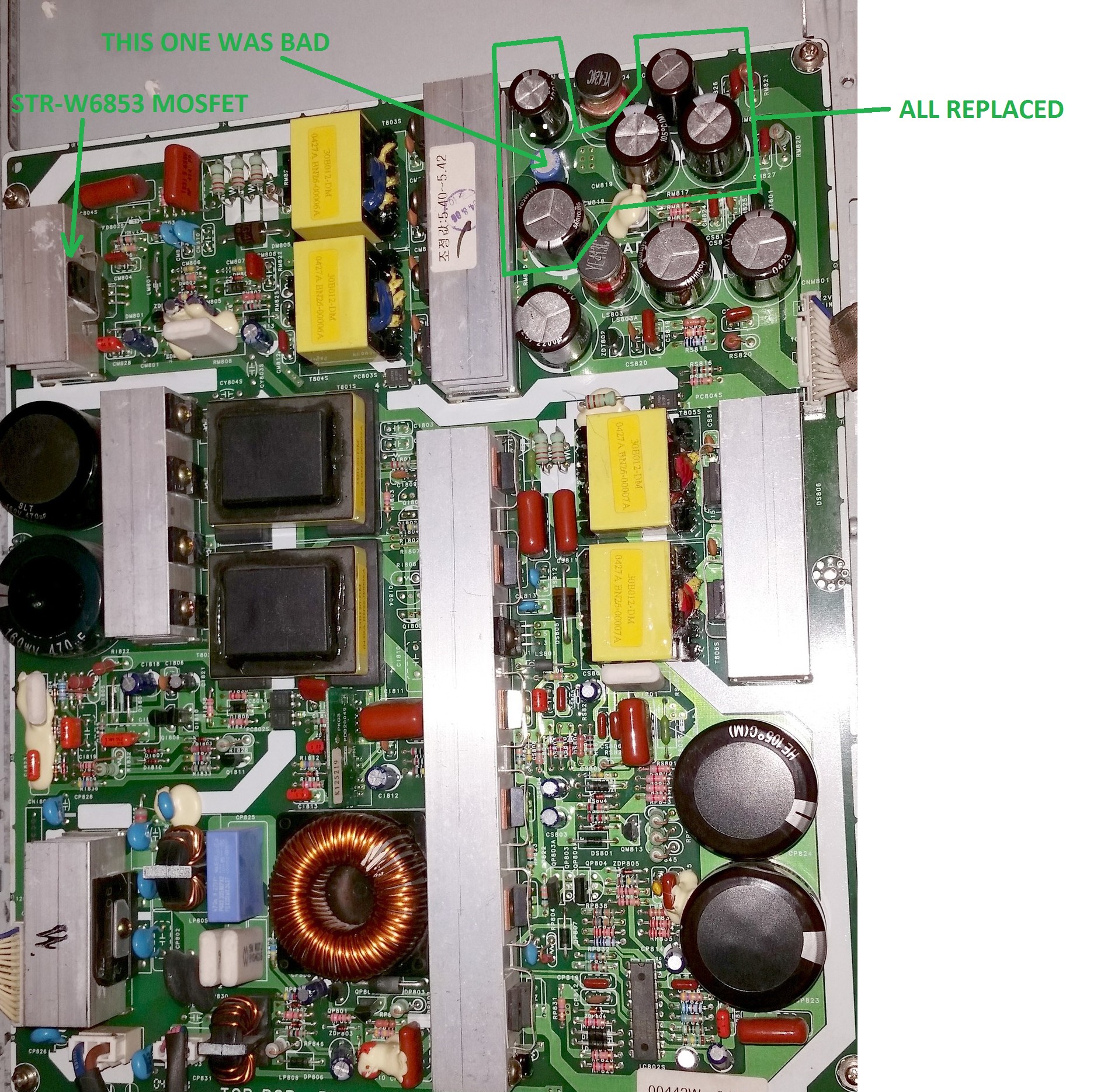

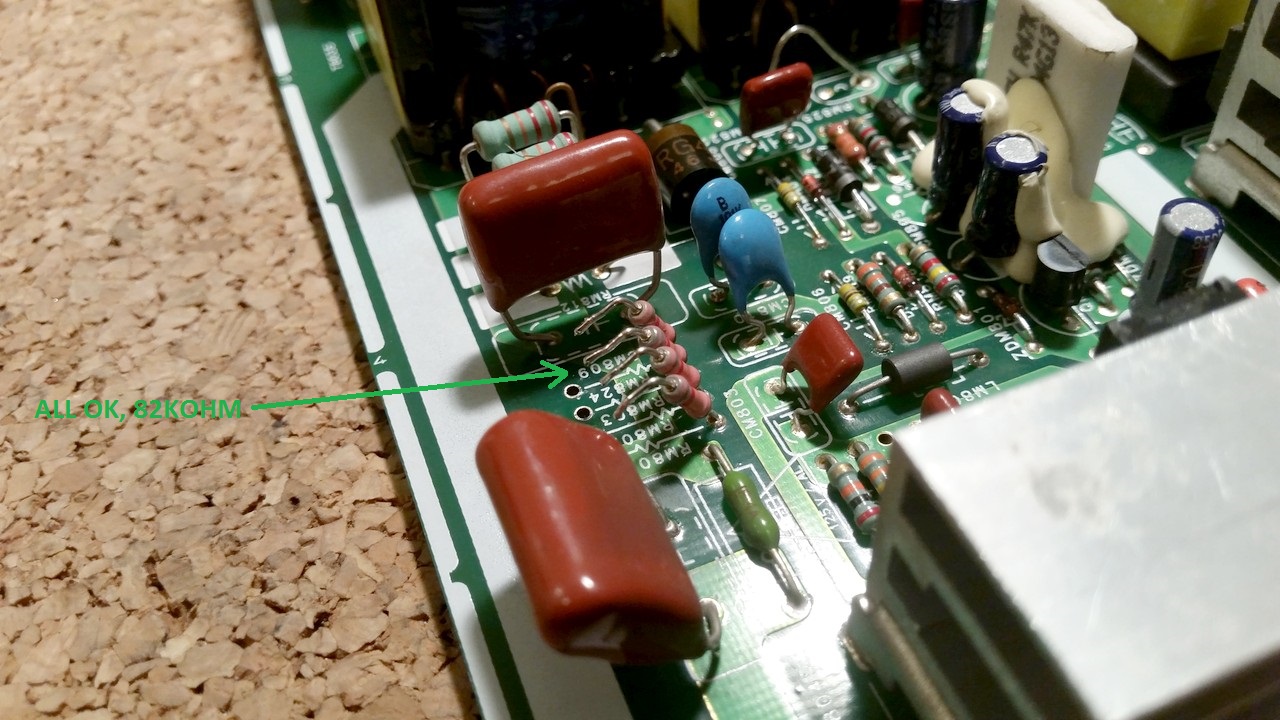

                      Here is the update:
                      I did lot of testing on the main power supply board. 220V input, standby power, PS-ON voltage is OK, all fuses are OK.
                      12V sound power supply is OK! (12.5V), but 12V and 5V are dead.

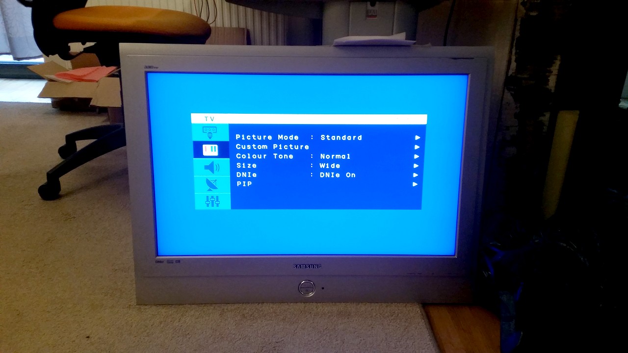

                      I found when I connect DVM to STR-W6853 MOSFET input (pin 4). TV powers ON! Sometimes it turns ON imidiately when I connect DVM to pin 4, and sometimes I have to touch pin 4 several times, but from that point TV works OK. Look at the schematics picture. Hi res schematics you can download on my initial post, page 34. Once TV is switched ON, I get normal 5V (4.98V) but 12V looks little high (13.3V). Is it normal?
                      Does it mean STR-W6853 MOSFET is my primary suspect?

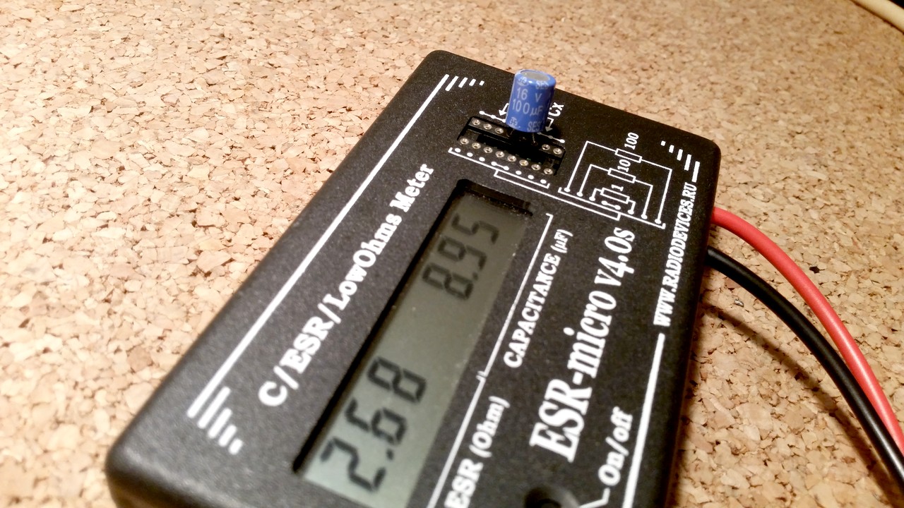

                      Just in case I replaced all caps on 5/12V secondary and I found one small 100uF cap that reads 9uF on my ESR micro. It's a solid state capacitor (see picture), I was puzzled why it's bad. Is it some special sort of capacitor so my ESR micro gives bad reading? I replaced it with standard low ESR capacitor - no change, TV still won't turn on with all secondary filter caps replaced. Funny thing is, I cannot find this 100uF solid cap on schematics. It's not there!
                      I will check all the caps on 5/12V primary as well.
                      So, what do you think now? What to check next? Should I change places of STR-W6853 MOSFET from audio power supply so I can monitor changes?
                      I'm quite puzzled with this one.
                      When I switch TV ON (with touching pin 4 with DVM), TV works OK. But, when I turn it off with remote and than back ON, it won't switch ON unless I touch pin 4 of STR-W6853 MOSFET again. I checked for cold/cracked solder joints - all is OK.
                      Waiting for your response...
                        Pin 4 of the STR-W6853 is the VCC pin and it must have 18.2V (see page 14) for it to start up.
                        So did you check the start-up/running cap for this IC?
                          Is it the one I marked on schematics? (see picture) Please could you mark what to check/replace. When I measure pin4 and GND (GND directly, not thru RM808 resistor) with DVM I get 100V.
                            Measure between the legs of CM801, also between the two legs of CM802.
                            Also check that resistor RM808 to see if it is OK.
                            Do not use the chassis for your meter.

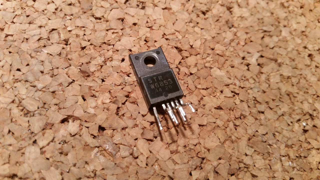

                              Re: Help needed - Samsung LW32A23W 32" LCD TV won't turn on! - SOLVED!
                              SOLVED!!!
                              It was STR-W6853 MOSFET after all! I checked, RM808 - OK, checked and replaced all small caps, and finally I swapped STR-W6853 with other one from audio 12V exclusive. After swap I got 12V and 5V but lost 12V audio voltage. I bought new STR-W6853 for 5$ in a local shop. Problem solved.

                              3. I used standard small caps (10u/50V, 33uF/50V, 22V/50V...), not low ESR. Should I leave it or return old ones? I have low ESR ones but all are 35V and not 50V.
                              4. any suggestions what more to replace just for maintained?
