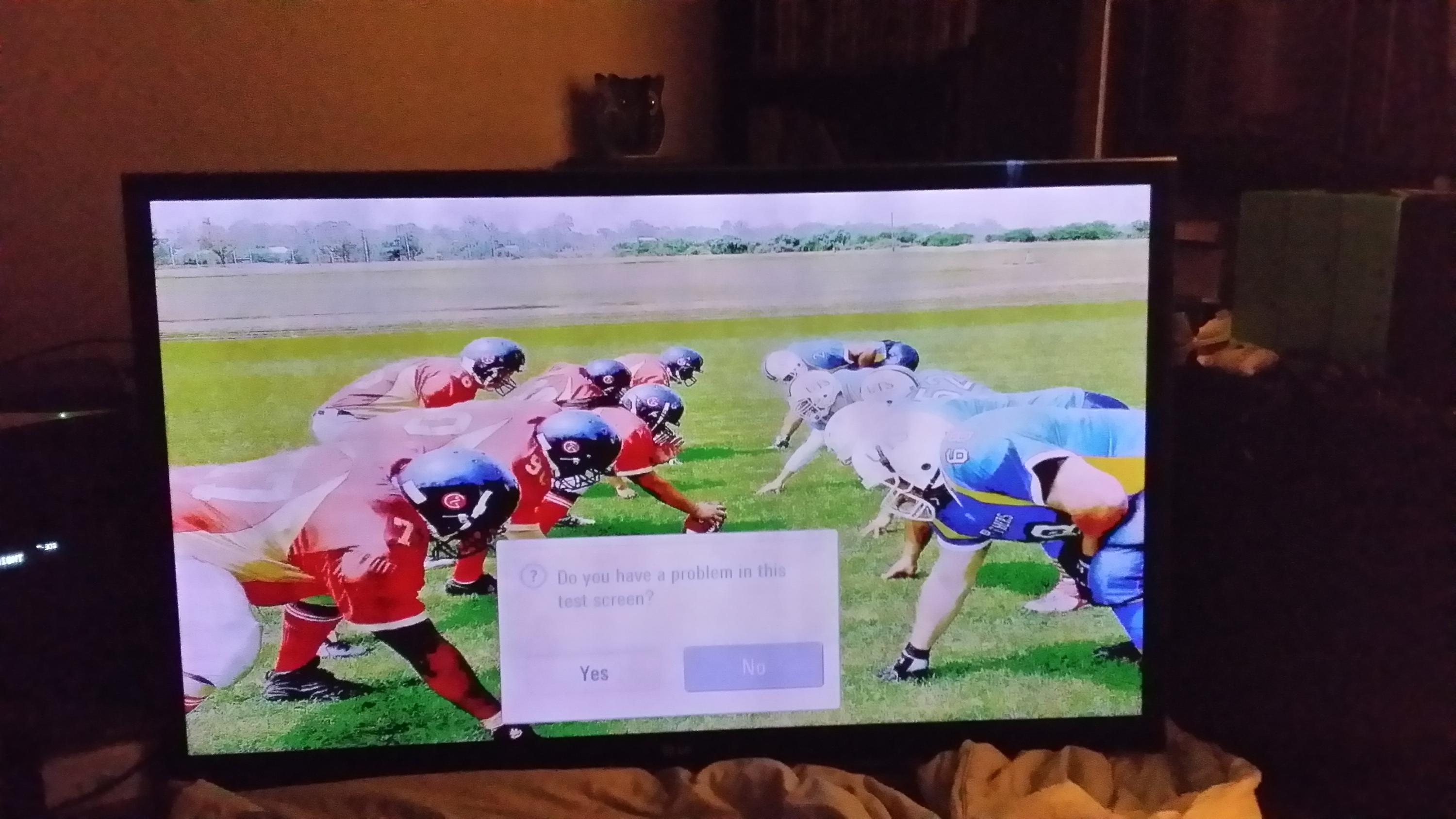

    My LG 60PZ950 has the same problem posted in the following thread https://www.badcaps.net/forum/showth...t=33393&page=1

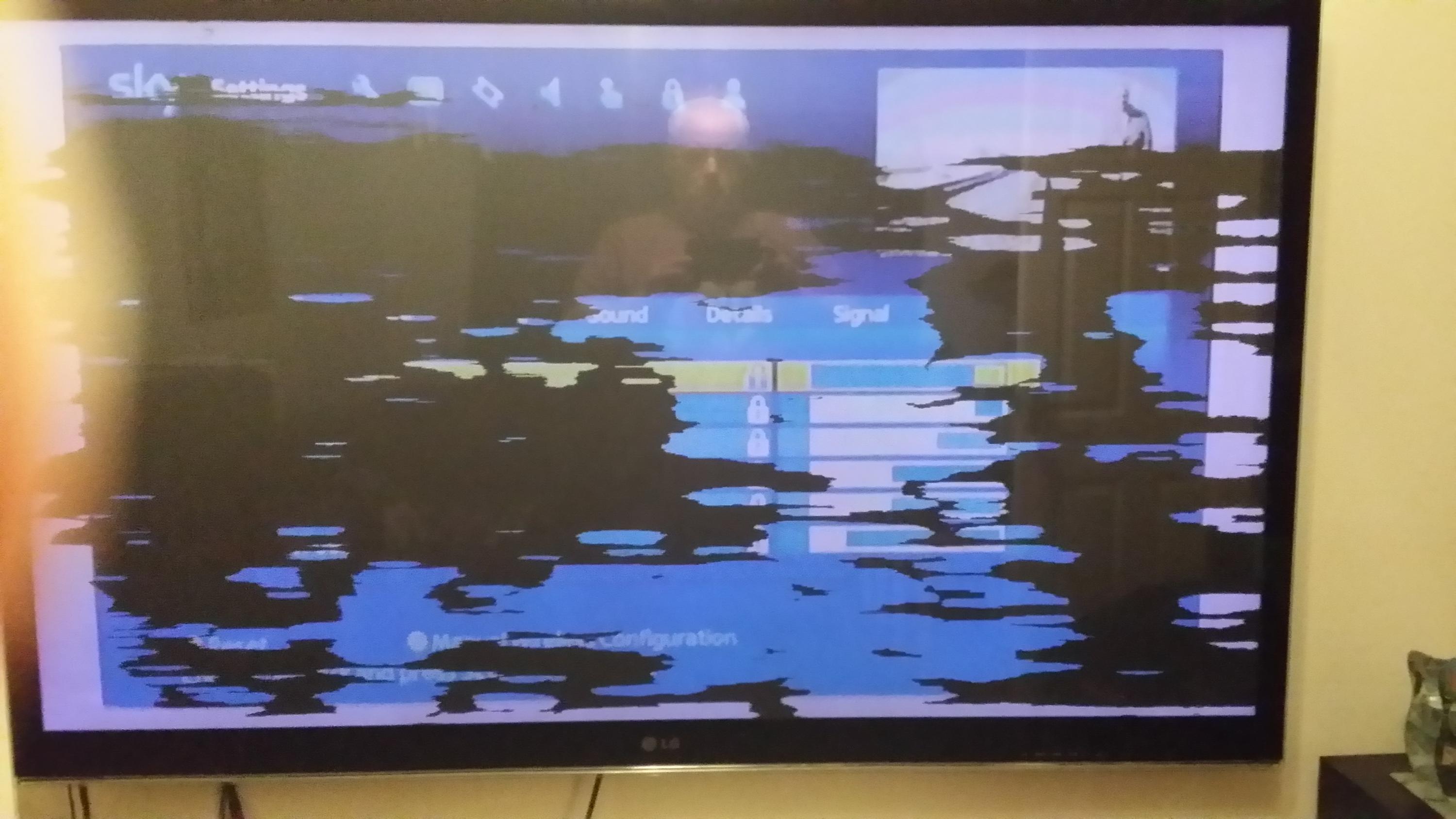

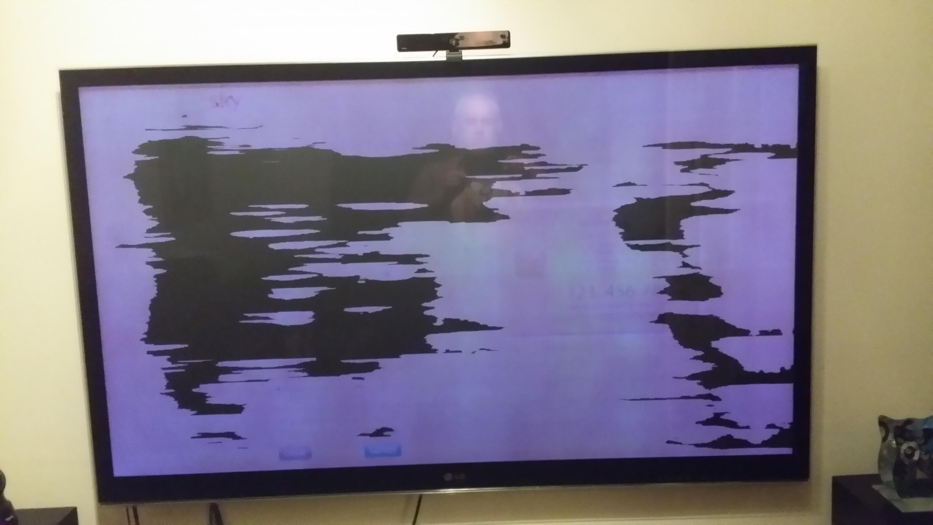

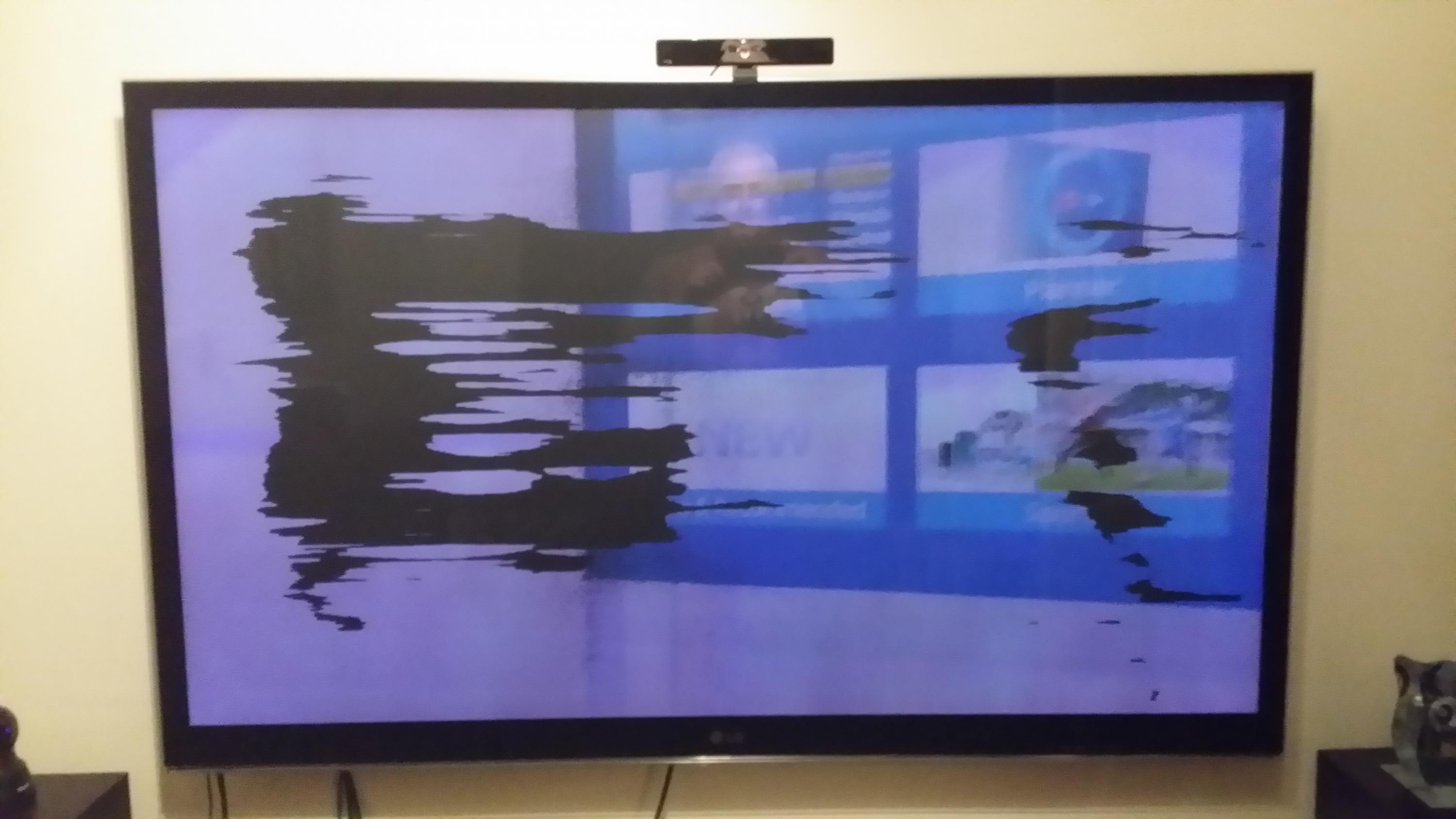

    Gradually it's been getting worse , whilst i try and find someone who can fix it , this morning it went a stage further....the screen now looks like a child has been let loose on it with a magic marker , the marks are not static and look like they are clearing up whilst the tv is on , i've attached 3 images a few mins apart.
    Do you think this is the same fix as in the above thread or far more serious ?
    Thanks in advance
    Simon
    Re: LG 60PZ950 purple and green color artifacts again
    This will not be the same fix, unfortunately as the problem has been left for too long the Z-sustain has now failed and you will have to conduct an extensive repair, or replace the board.

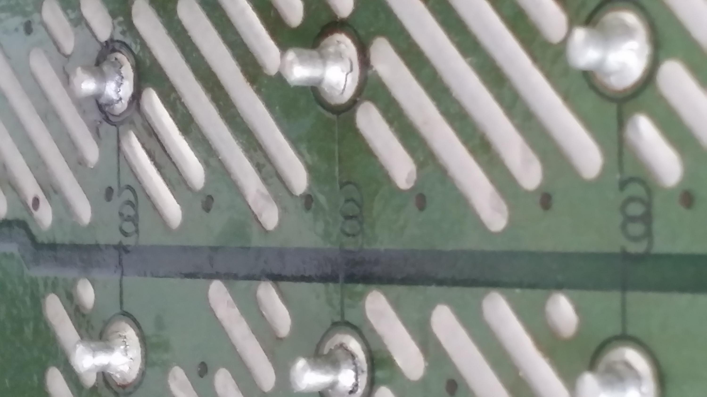

      Finally Got the TV off the wall and lying on the floor on top of a duvet , removed the back , taken ysus board out seen the cracks on the joints resoldered them , refitted the board (just 2 screws to hold it in place)
      If anything it's now worse going to pull the ysus board out again and see if i have missed anything
        As I've said the Z-sustain will require repair or replacement now. When the coil soldering fails the Z-sustain is placed under much greater stress than normal; this can lead to failure.

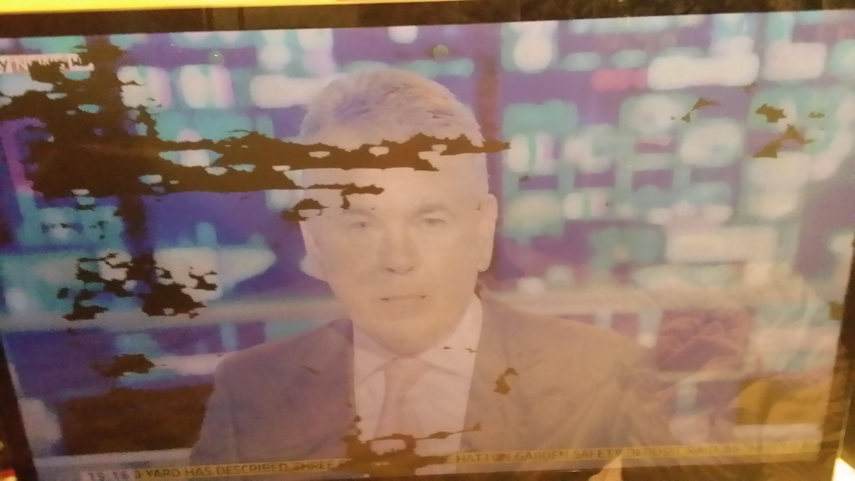

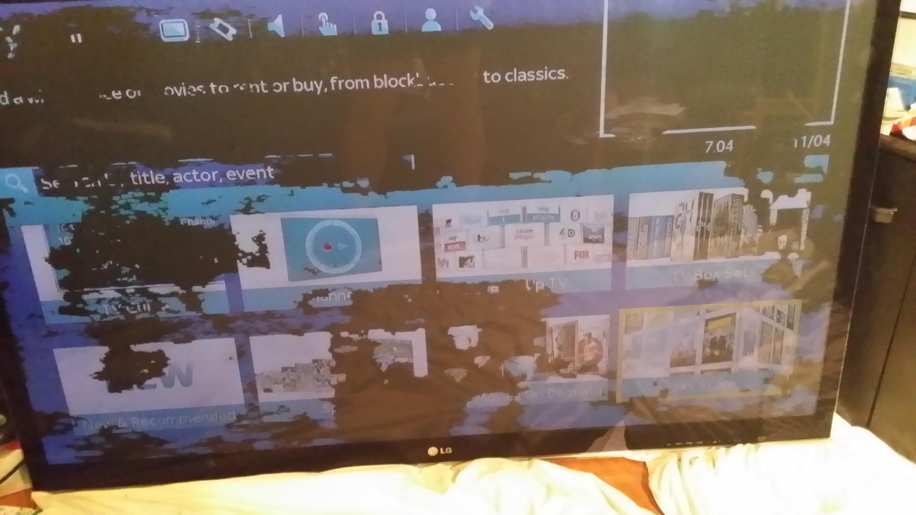

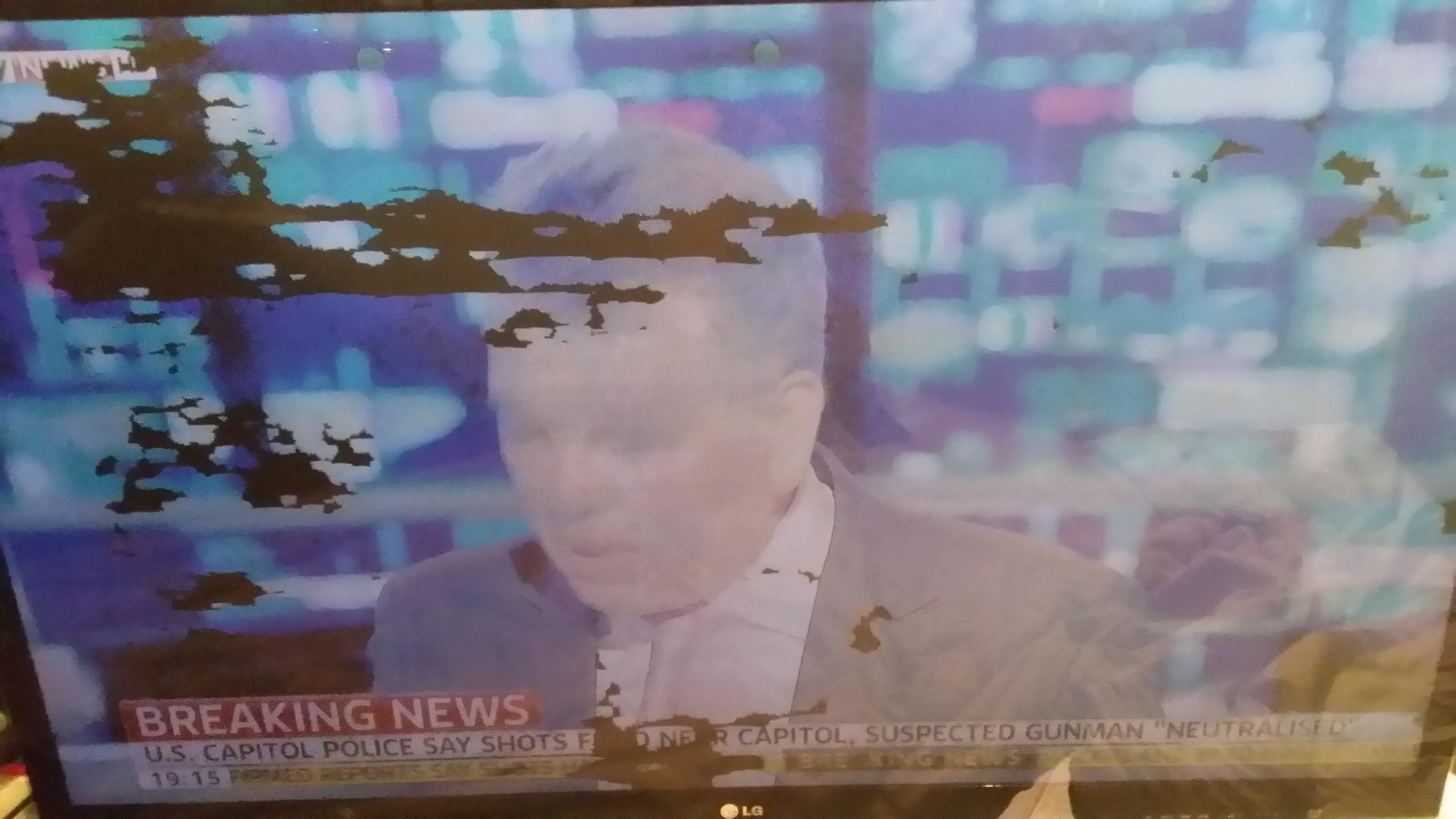

                Update
                I ordered a new card , cost me £98 and had to wait a couple of weeks.
                Fitted the new card , made sure everything was connected properly and fired up the tv.
                Black screen , tv turns on and off , the remote light works but no picture whatsoever.
                refitted card , double checked everything , turned tv back on
                Black Screen!

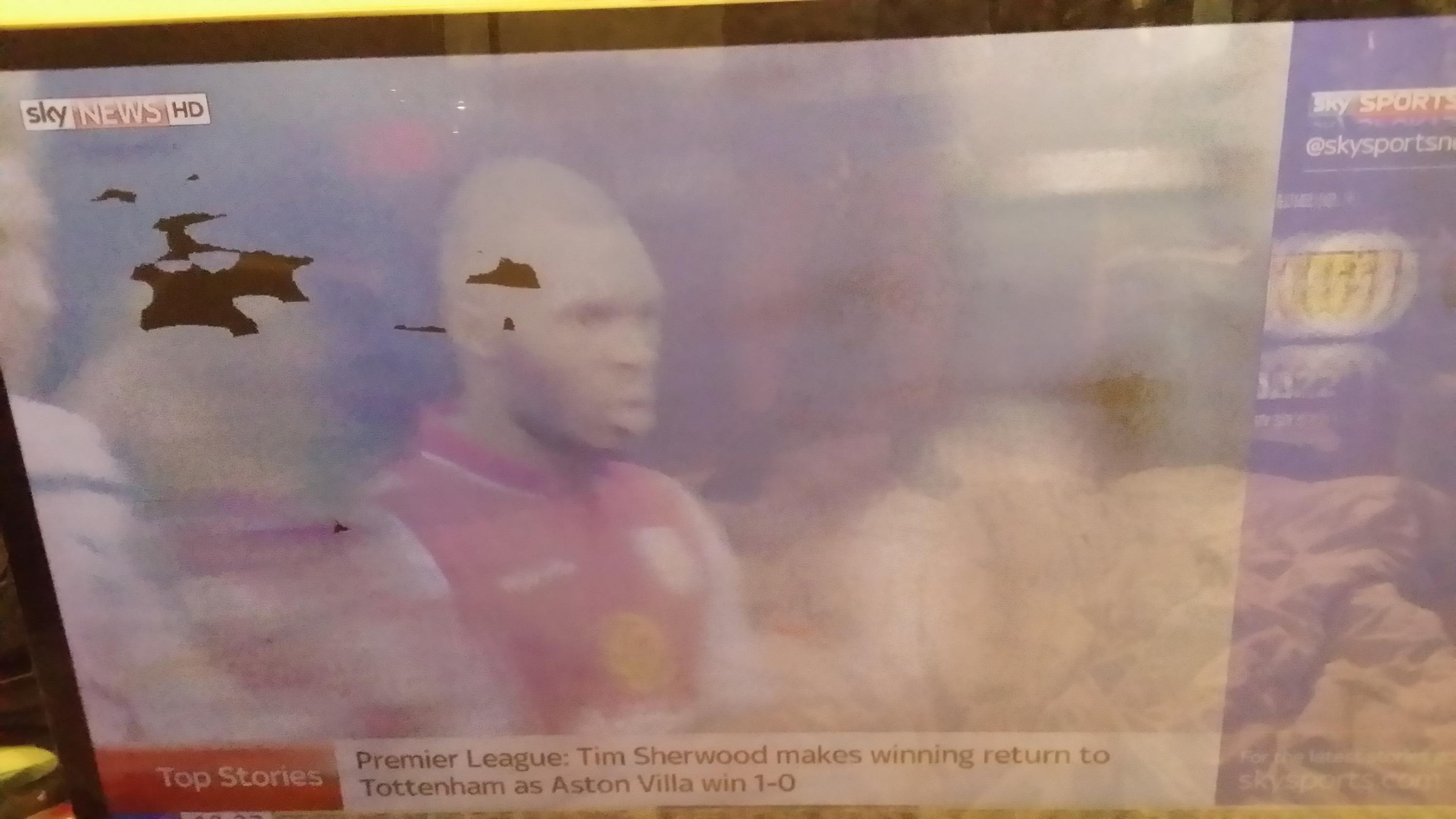

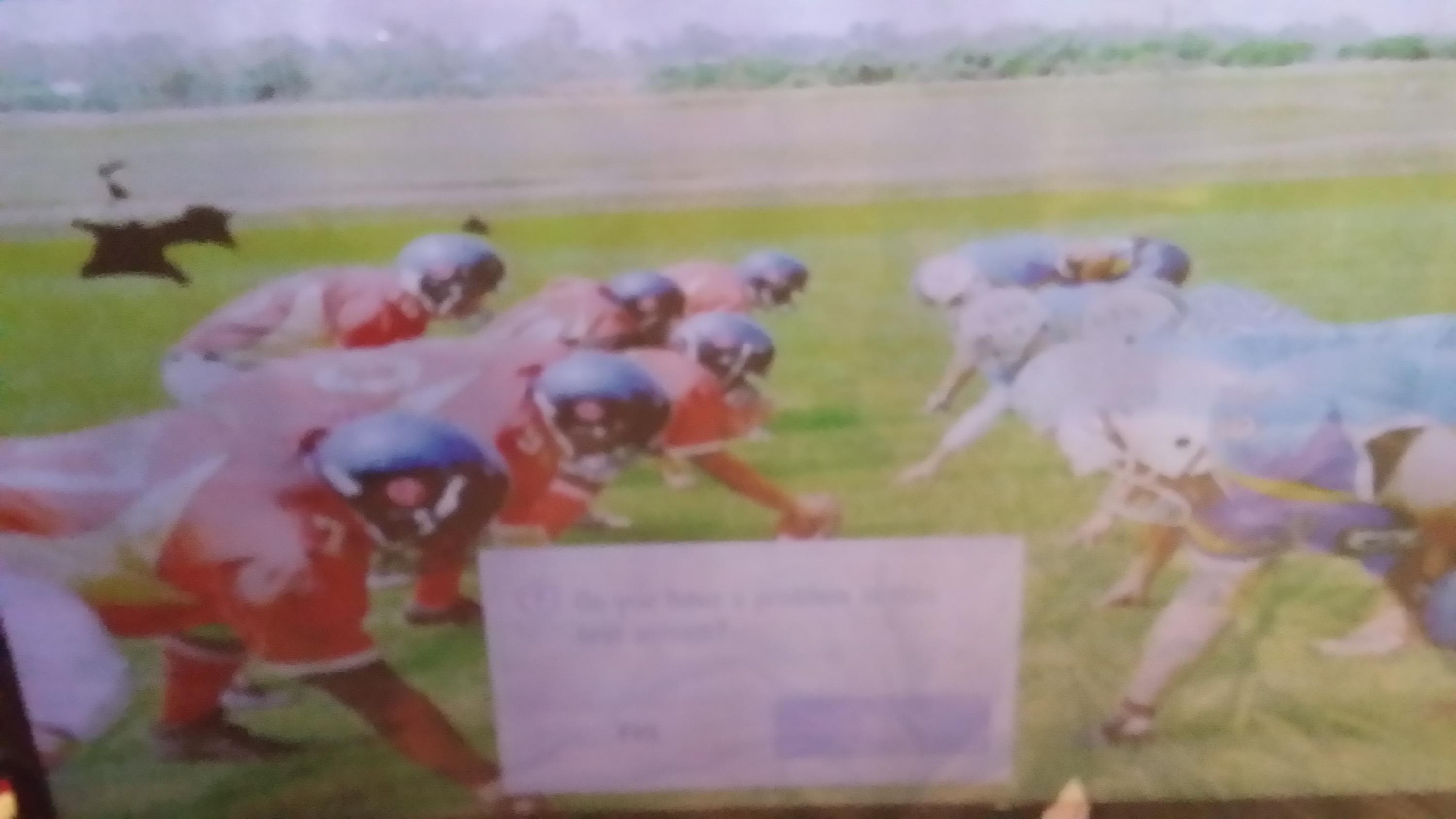

                playing with the remote , i could vaguely see the volume graphic appearing. after a while i got a picture but still with the black marks.
                after an hour or so the black marks seem to have been cleared but the picture is badly faded , the colors seem to be washed out
                have some pics on my phone , will post them later
                  Well, looks like a dud Z-sustain. Again. Sorry....

                        i just turned the tv back on after 1hr and the black marks are back but cleared up within a minute
                          Ok, if it's brand new maybe it's not bad. Just seen so many dud used parts by sellers tht don't test them. Can you check Vzbias voltage? Should be marked on the Z-sustain board.
                          The black marks are symptomatic of a Z-sustain fault. The Z-sustain provides biasing energy to make the plasma panel discharge properly. As the panel warms up, the required energy is reduced, so the black marks reduce. But, the fault will never clear up fully without the Z-sustain.
                          There is a small chance the control board is causing your problem - but that is quite a small chance.
