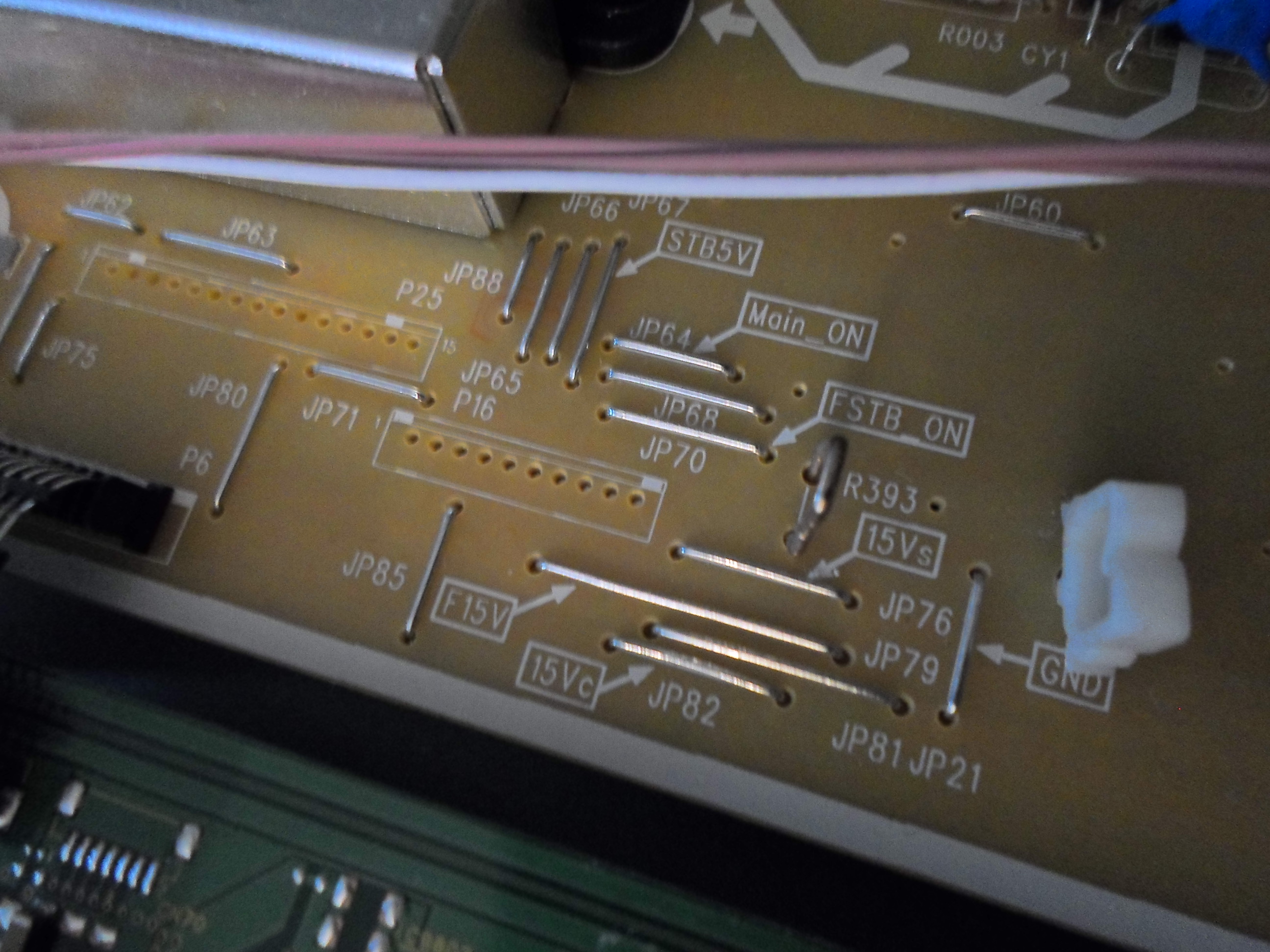

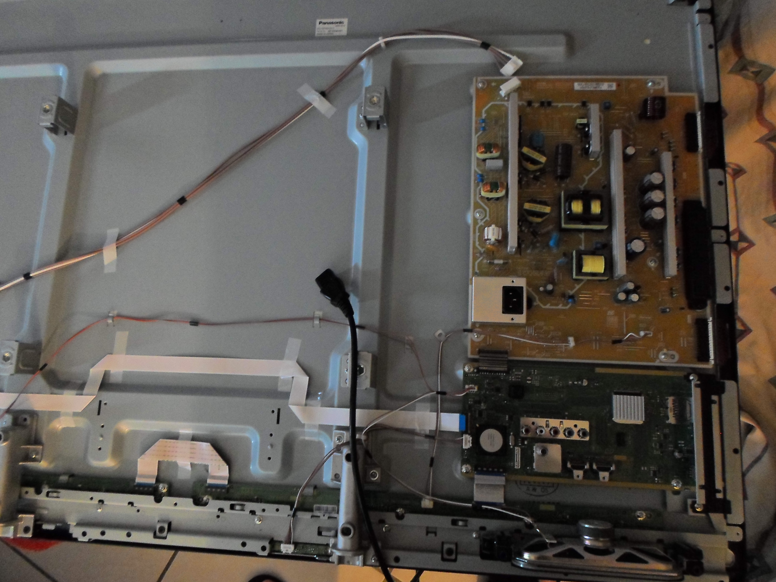

      Here's a few quick photos. The story is a guy brought this to me to fix, and he cracked the screen on transport. I don't know what was wrong before, but I was going to try to find the issue so I know what parts are good. I imagine it was in the same state before the screen broke.
      I have 5V on STBY5V, and 15V on F15V, nothing else. Nothing happens on pressing the power button. The power LED is not lit (I'm not sure if it would be anyway while in standby), but the optical connector is lighting up red on the main board when plugged in so I know we're getting the 5V to the main board.
      From there I don't know where to TS or if those other voltages in the photo should be on at this point or only after it gets the PS-ON signal.
      Seems very easy to work on if I had the troubleshooting flow chart.

        yeah, ok , well I think finding out what the original symptoms from the person would be handy place to start.
        having 5vstb and F15v is a good start plus the optical jack suggests the A board is somewhat functional, no front LED though, not sure.
        This is one of those horrible PSS boards which seem to give trouble.
        have you had GENERAL PROBE ON THE pss AND THE sN TO SEE IF THERE'S ANY OBVIOUS SHORTED PARTS?

            No obvious shorts, on the SN board there is a SRVP5V test point which has 5V.

                I honestly don't know. I have the darfon schematic for the PSS and I know u203 can cause a dead TV but not having any experience with these i can't remember if you end up with no standby or not when it is faulty or if it is present and the front LED is out.
                so have you watched the front LED as you plug in, any sign of life there even if only brief?

                  There is no light from the LED but I think it may just go red when you power it on. Can you post the schematic? (It may be in my SM I haven't checked)
