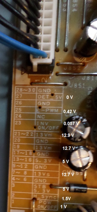

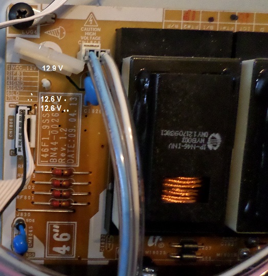

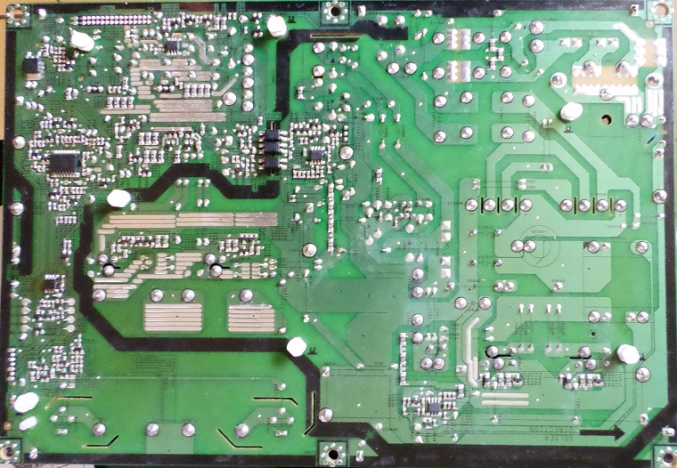

    I took psu Measurements while ON And results can be found on the pics.

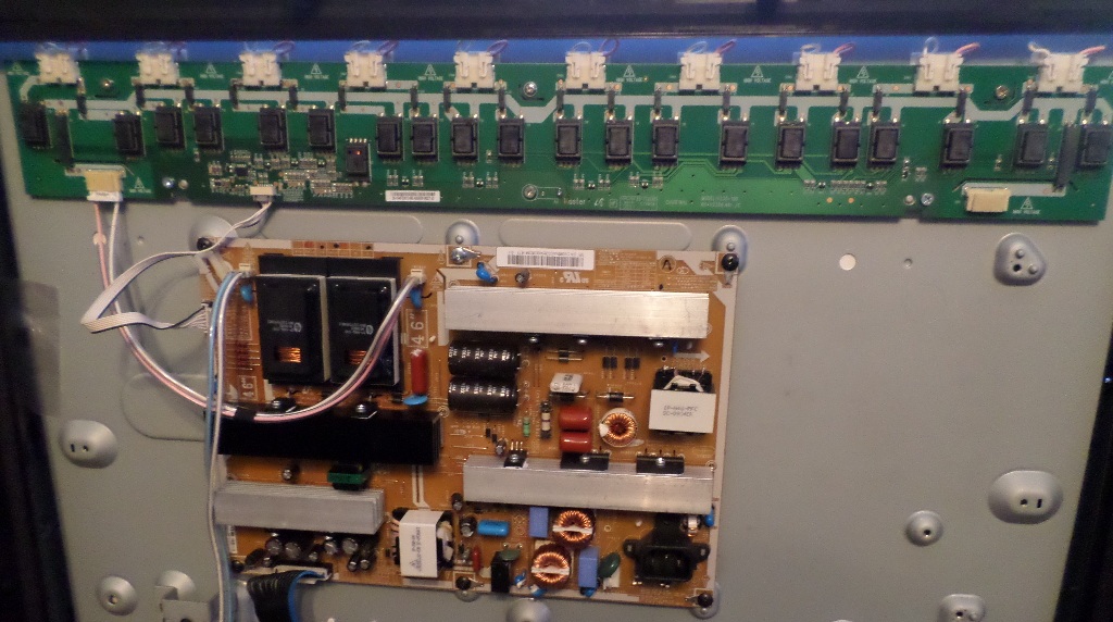

    I know this Tv was Tampered with by 2 other people who couldn't identify the problem before the owner let me have it
    This tv has the following symptoms:
    Tv plugged in has Red light, when power button on remote is pressed the samsung "On" chime can be heard.
    Tv does not turn off until Remote is used and "Off" chime can be heard.
    No Back light turns on whats so ever not even a flicker in a darkened room.
    When I shine a flashlight at the screen I can see "Static Snow".
    No bloated caps anywhere and pulled them ALL off and measured them with my Cap meter and all where within 10% of there stated rating.

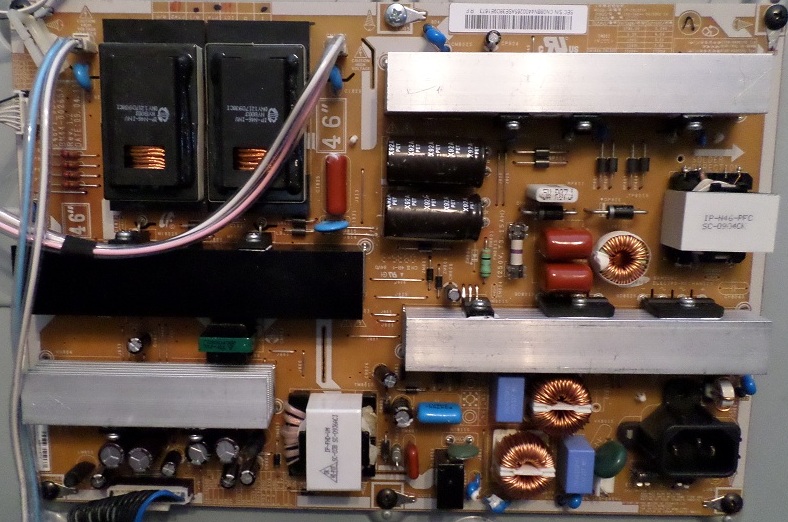

    I took pics of the boards If others are required, Just ask.

    Please measure the DCV right at the two legs of the MAIN FILTER CAPS in the primary side (450VDC caps laying on their sides), it should have >360VDC when TV is turned on.
    The Voltage readings in this picture, is it after the power switched is activated?
    https://www.badcaps.net/forum/attach...1&d=1425662978
    It is missing required signals from the main board.
    BTW, what is the P/N of the power supply/inverter board combo as printed on the barcode sticker? Picture is not clear enough to read the numbers.

        OK, the PFC Voltage booster is not working.
        The main board is also not sending the INV ON/OFF (BL-ON), you are only getting 0.057V, same for the PWM Dimming signal of 0.42V.
        The POW ON/OFF (PS-ON) is also very low, only 1.00V.
        You should verify that your meter is OK or not.

                OK, BN44-00265B is about the same as 265A, the board has pull-up resistors for PS-ON and BL-ON so if you disconnect the cables between the main board and the power supply board you should then see the backlights come on when you plug the TV into the AC outlet if the power supply/inverter board is OK.
                Did you inspect the board real well to make sure what done to the board before are done properly?

                  Q: Did you inspect the board real well to make sure what done to the board before are done properly?"
                  Nothing looks horrible ,on the underside of the psu there's slight discoloration on the pcb mask around the 2 black transformers on the bottom left(of the pic , I took) and by a KIA393F BIPOLAR LINEAR INTEGRATED CIRCUIT : tested fine.

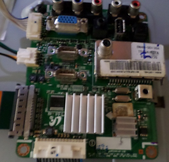

                      The cpu has a heatsink and touching the top of it you cant leave your finger on that thing for more than 7 seconds, maybe it has a short somewhere and it appears to be a BGA chip.
                      Should I be seeing "snow" with a flashlight if the mainboard was bad?
                      Doesn't that control all the input signals attenna ect.
                      It could still be working but malfunctioning correct? so its not completely fried.

                        If you can see snow on the screen then it is not completely dead, so you will have to concentrate in the PFC circuit to get it running first, you can check the VCC pin and the GND pin of the PFC controller IC to see if it is present.

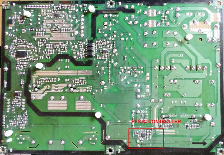

                            ICP801( 'P' for designator used in PC section), UCC28061
                            Remember that we are using 265B diagram for troubleshooting 265A board so not everything will match exactly.

                                  OK, I look at the bottom side of the BN44-00265A and compared it to BN44-00265B, they are not even close to each other at all.
                                  So the 265B diagram cannot be used. So it is going to be tough.
                                  http://assets.shopjimmy.com/media/ca...65A-BOTTOM.jpg
                                  http://assets.shopjimmy.com/media/ca...B-BOTTOM_1.jpg

                                    Nope not on my board the only thing in the pcb mask i can see that has 16 legs as
                                    UCC28061 is the lx6503 chip http://pdf1.alldatasheet.com/datashe...MI/LX6503.html and thats not the same.
