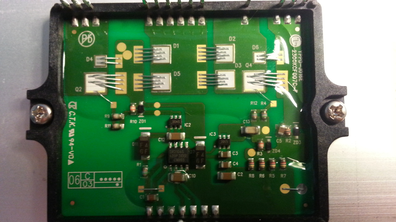

                          My confusion is, say, a little more basic. Here is the ER ipm from the ysus of a 50" LG. It is the J016E.
                          As you note it is simpler in design. This was ticking so I nothing blew perhaps the igbt went open. But I see where these diodes and transistors are labelled but the components are not visible because they are in some non-standard form factor bebeath the board ?? More confusing is that Q2 and Q4 are a single pad with jumper wires so I can't imagine the actual connections. Am I making sense ?

                            Re: Hybrid IC IPM YPPD-J017C J018C repair
                            Oops forgot the ipm pic

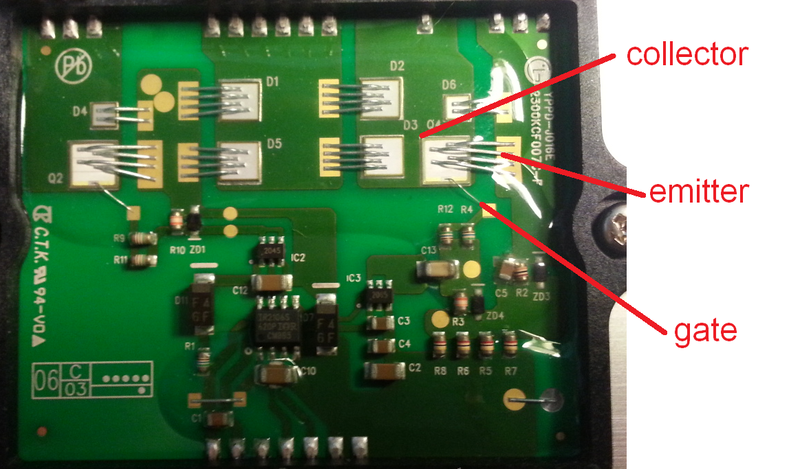

                              The bright squares are the actual components, that would be similar to what you would see inside a transistor or diode. The jumper wires are the terminals bonded to the die.
                              If one of these was blown you would remove the wires, then the die is already isolated. Then just place the IGBT / diode terminals were the jumper wires were bonded to (the golden-like traces)
                                This module looks good though. Why do you think it's blown?
                                You can check the diodes directly with a multimeter. to see if the IGBTs work you would need to drive them and put a power supply on the gate driver and a little bus voltage and load.
                                    These fail open too as far as I know. Not sure which component exactly but have had this happen in couple of sets and replacing the ipm fixed it.
                                    In the above pic are the emitter and the gate jumpers not touching the same spot ? And where is the collector pointing to ? Lol sorry for being obtuse.
                                      Gotta think in 3D!
                                      --The Collector is actually the underside of the die device--attached to the solder/track the device is fixed to.
                                      The Gate appears to connect--just like the Emitter, to the top of the die--But Very close examination by powerful Loupe will show that the surface of the die is divided up into specific regions that form the device terminals....
                                        Aha! Thanks for the explanation!
