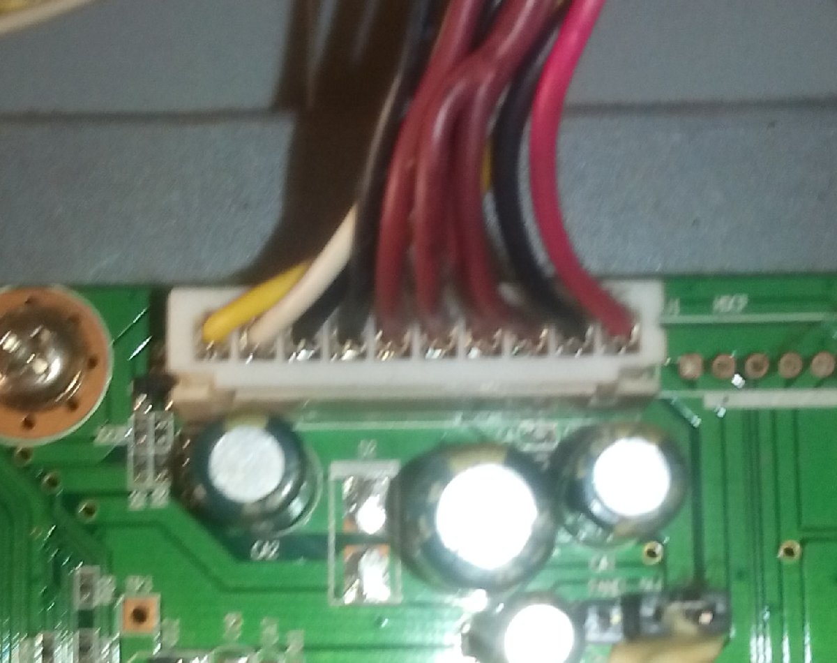

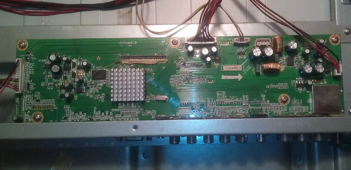

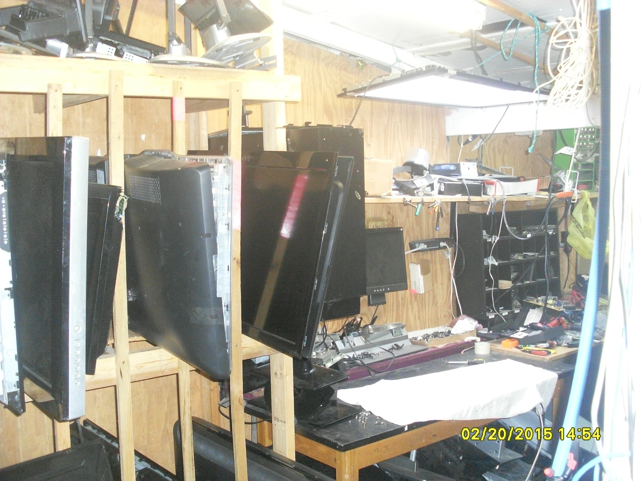

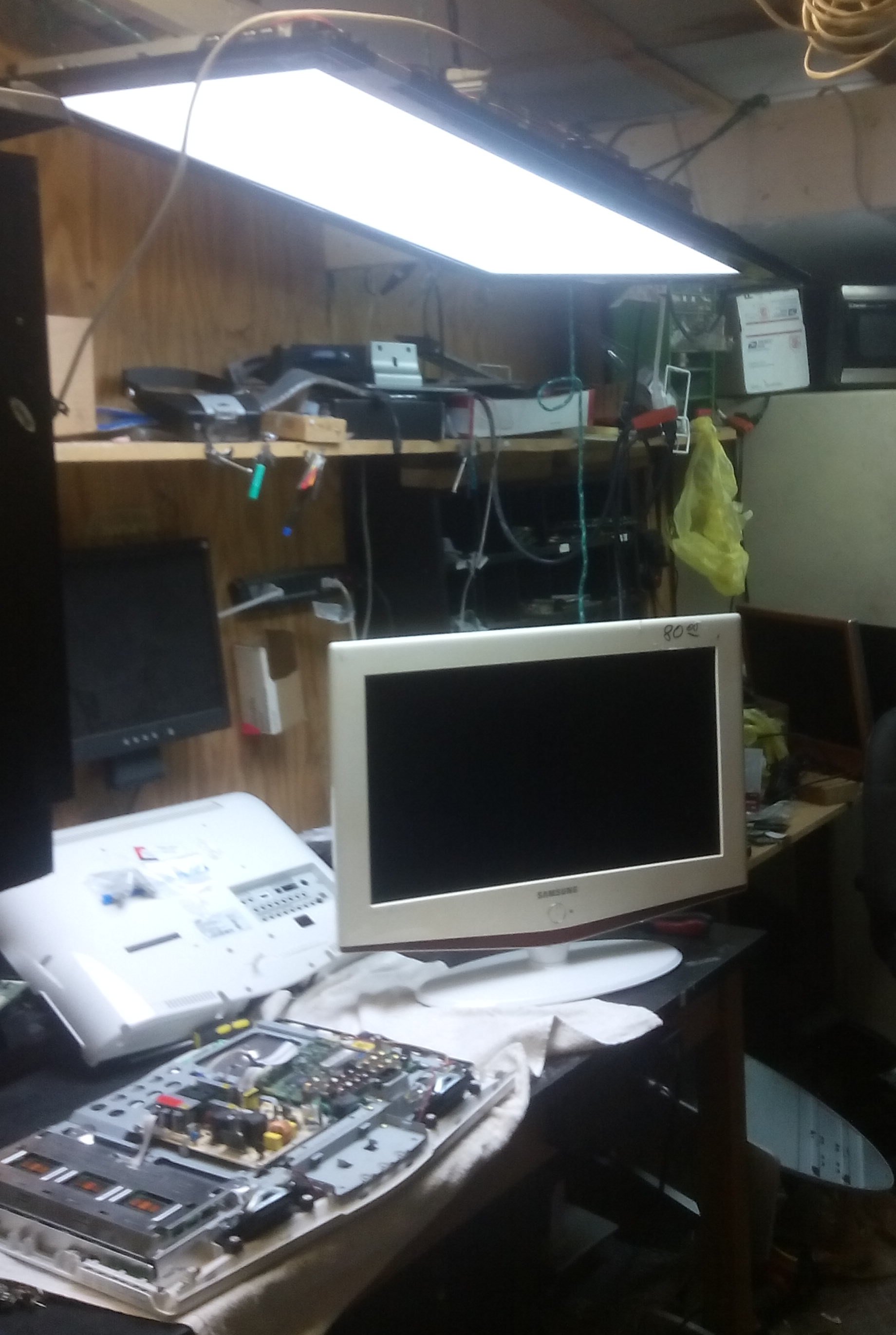

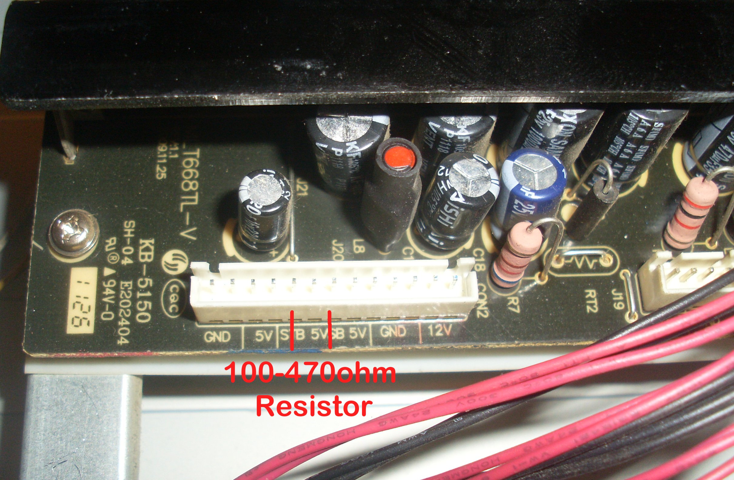

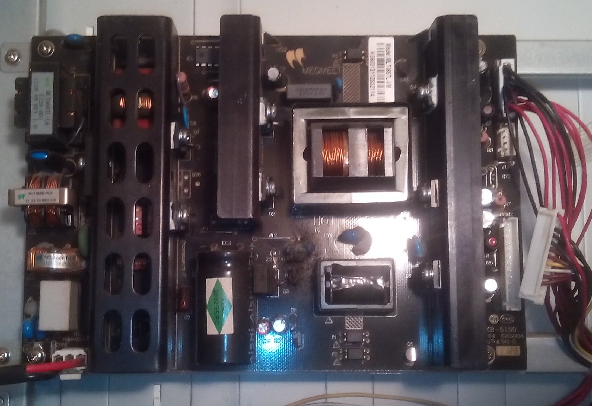

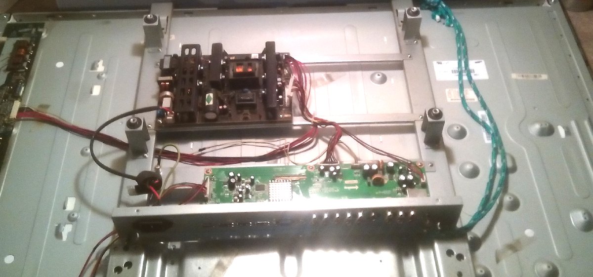

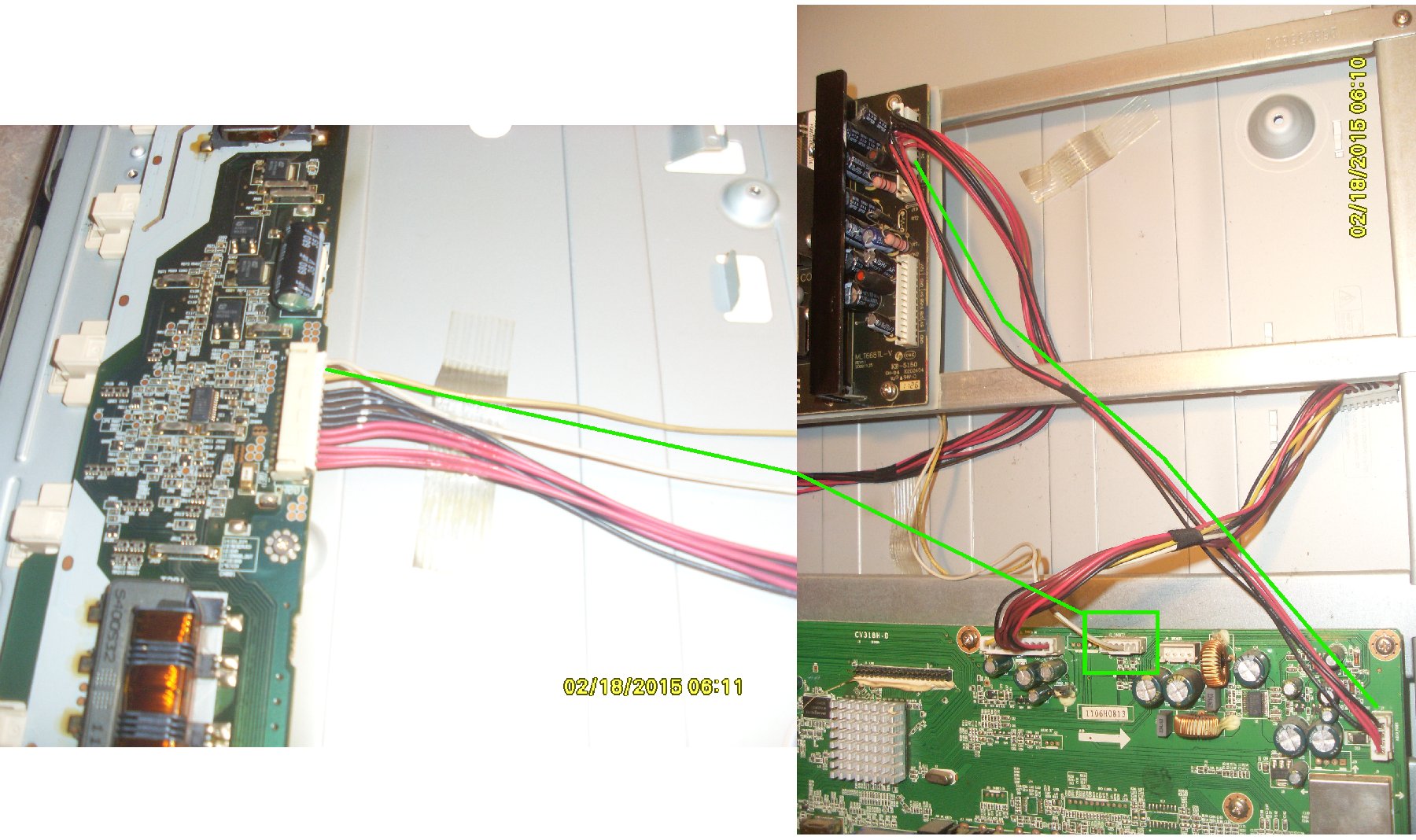

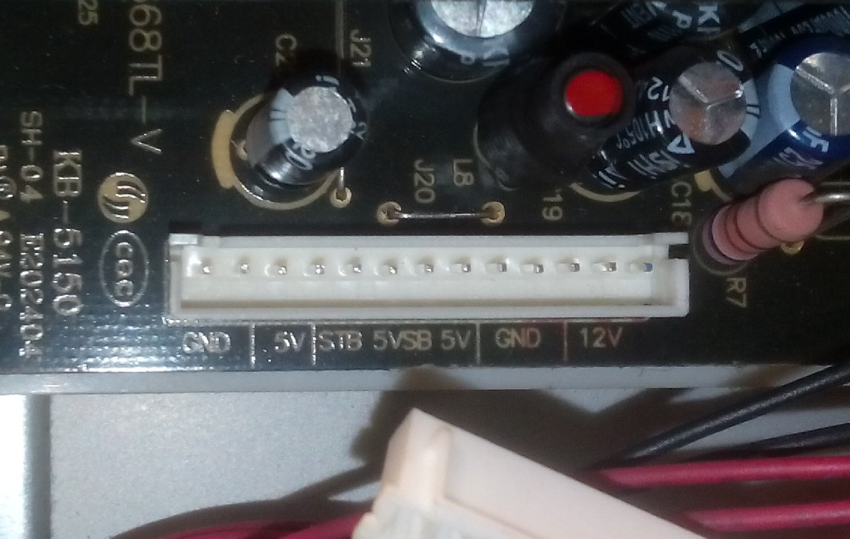

Using Element 42" As Light Source
  • Michale32086
    • Nov 2011
    • 1453
    Using Element 42" As Light Source
    I had an Element 42" in with a busted screen. I have always wanted to use such a critter to be a good light source for my workbench.. (see pic)
    But I have 2 issues with it..
    1- I hate to waste a video A board when it's not really needed for my use
    B- It always shuts down after x minutes. Idle timer probably..
    Is there a way to short the A Board connector so that it stays on and frees up the A Board for other use...
    I realize the exact model number of the Element is likely required. I'll have that in a few.. But I just wanted to get a general idea if it's even possible..
  • Michale32086
    • Nov 2011
    • 1453
    Re: Using Element 42" As Light Source
    TV is an ELEMENT ELDFT404
      Re: Using Element 42" As Light Source
      Yes, would be pretty easy. Post a picture of the power board connector (should have labels next to it)
      • Michale32086
        • Nov 2011
        • 1453
        Re: Using Element 42" As Light Source
        Damn!! I knew I shoulda checked this before heading home!
        I'll follow up in the morning..
        Thanx...
        • Michale32086
          • Nov 2011
          • 1453
          Re: Using Element 42" As Light Source
          Here are the (what I assume to be) relevant connectors off that Element 42"
            Re: Using Element 42" As Light Source
            Hmm odd, no BL ON/OFF pin, could you supply a picture of the whole TV board arrangement, and one of each of the power & main boards?
            • Michale32086
              • Nov 2011
              • 1453
              Re: Using Element 42" As Light Source
              Originally posted by tom66
              Hmm odd, no BL ON/OFF pin, could you supply a picture of the whole TV board arrangement, and one of each of the power & main boards?
              Attached
                Re: Using Element 42" As Light Source
                Ok, that little 6 pin connector to the right of the main power board one (on the main board), does that go off to the inverter?
                • Michale32086
                  • Nov 2011
                  • 1453
                  Re: Using Element 42" As Light Source
                  Yea, that goes over to the Buffer Board (??) on the left of the unit..
                  • Michale32086
                    • Nov 2011
                    • 1453
                    Re: Using Element 42" As Light Source
                    I finally got a nice 8MP camera to use. So if you need any close ups of connectors I can do it now...
                      Re: Using Element 42" As Light Source
                      That's actually the inverter. What you'll need to do is use three resistors and the power supply/inverter. The rest, you don't need.
                      Connect pin STB to 5VSB with 100-470 ohm resistor.
                      Connect each of the two connected pins on the 6 pin connector to 5VSB also with a 100-470 ohm resistor.
                      Plug the set in and the BL should come on fully.
                      • Michale32086
                        • Nov 2011
                        • 1453
                        Re: Using Element 42" As Light Source
                        Originally posted by tom66
                        That's actually the inverter. What you'll need to do is use three resistors and the power supply/inverter. The rest, you don't need.
                        Connect pin STB to 5VSB with 100-470 ohm resistor.
                        OK, that's simple enough..
                        Originally posted by tom66
                        Connect each of the two connected pins on the 6 pin connector to 5VSB also with a 100-470 ohm resistor.
                        This is a little more dicey... The 6 pin connector has 4 wires going to the Main Board.. Plus there are two wires going from the Main Board to the Inverter..
                          Re: Using Element 42" As Light Source
                          I mean the 6pin between main & inverter.
                          You can remove the main board and its connections entirely.
                          • Michale32086
                            • Nov 2011
                            • 1453
                            Re: Using Element 42" As Light Source
                            Originally posted by tom66
                            I mean the 6pin between main & inverter.
                            You can remove the main board and its connections entirely.
                            OK, I see where I am screwing up..
                            I thought you meant the "6 pin" on the Power PCB.. Which is actually an 8-pin which caused me to read your posts more closely...
                            You are talking about the 6-pin on the A/Main Board that only has two wires..
                            OK, NOW it all makes sense..
                            I don't need a ton of bricks to fall on me.. well, not ALWAYS..
                            Thanx.. I'll dig up the resistors and give it a go...
                            • Michale32086
                              • Nov 2011
                              • 1453
                              Re: Using Element 42" As Light Source
                              Originally posted by tom66
                              That's actually the inverter. What you'll need to do is use three resistors and the power supply/inverter. The rest, you don't need.
                              Connect pin STB to 5VSB with 100-470 ohm resistor.
                              Connect each of the two connected pins on the 6 pin connector to 5VSB also with a 100-470 ohm resistor.
                              Plug the set in and the BL should come on fully.
                              Tom... Or anyone???
                              1/4 watt on those resistors?? 1/2 watt??
                              I seem to remember from a previous project like this that 1/2 watt was recommended.
                              Wanted to confirm...
                                Re: Using Element 42" As Light Source
                                Doesn't matter as they will be dissipating very little power... 1/4W is fine... 1/2W also fine.
                                • Michale32086
                                  • Nov 2011
                                  • 1453
                                  Re: Using Element 42" As Light Source
                                  Thanx.. Much appreciated..
                                  I hope to have this project deployed today....
                                    Re: Using Element 42" As Light Source
                                    For reference ... power dissipated in a resistor P = (V^2)/R or P = (I^2)*R
                                    Simpler to use the "V" equation. So, assume 5VSTB = 5V, and the BL ON signal is grounded internally, very low volt drop, say 0V for simplicity.
                                    Power dissipated in a 470 ohm resistor will be: (5*5)/470 = 53mW... your resistor is rated to 1/4W (250mW)
                                    Generally you want to keep within 70% of the resistor's rating for reliability and longevity.
                                    • Michale32086
                                      • Nov 2011
                                      • 1453
                                      Re: Using Element 42" As Light Source
                                      Now THAT was funny!!
                                      The fruits of our labors..
                                      Thanx for all the help..
                                        Re: Using Element 42" As Light Source
                                        One thing, I would consider adding a fan to the PSU because in normal operation, the TV is mounted upright and cool air flows in at the bottom, hot air out the top. Mounting it laying down like that may cause the PSU to run too hot.
                                          Lithonia Lighting versus Light of America Compact Fluorescent product quality
                                          by sam_sam_sam
                                          I have a Lithonia Lighting 65-Watt Gray Hardwired Compact Fluorescent
                                          I also have back when Light of America had these light bulbs available for yard lights
                                          The issue with Light of America was the blast boards had all most certain board failure while bulbs hardly ever fail
                                          While the Lithonia lighting fixture has all most certain bulb failure
                                          So I have modified the Lithonia lighting fixture to accept the Light of America light bulb and see how long this will last
                                          I have only had this light fixture for not more than a year if it...
                                          07-02-2023, 03:45 PM
                                          LG Gram Ultra-light Weight Notebook Specification for Upgrade or Repair
                                          This specification for the LG Gram Ultra-light Weight Notebook can be useful for upgrading or repairing a laptop that is not working. As a community we are working through our specifications to add valuable data like the Ultra-light Weight boardview and Ultra-light Weight schematic. Our users have donated over 1 million documents which are being added to the site. This page will be updated soon with additional information. Alternatively you can request additional help from our users directly on the relevant badcaps forum. Please note that we offer no warranties that any specification, datasheet,...
                                          09-07-2024, 03:40 AM
                                          LG Gram Ultra-Light Laptop Notebook Specification for Upgrade or Repair
                                          This specification for the LG Gram Ultra-Light Laptop Notebook can be useful for upgrading or repairing a laptop that is not working. As a community we are working through our specifications to add valuable data like the Ultra-Light Laptop boardview and Ultra-Light Laptop schematic. Our users have donated over 1 million documents which are being added to the site. This page will be updated soon with additional information. Alternatively you can request additional help from our users directly on the relevant badcaps forum. Please note that we offer no warranties that any specification, datasheet,...
                                          09-06-2024, 09:10 PM
                                          LG Gram Ultra-Light Laptop Notebook Specification for Upgrade or Repair
                                          This specification for the LG Gram Ultra-Light Laptop Notebook can be useful for upgrading or repairing a laptop that is not working. As a community we are working through our specifications to add valuable data like the Ultra-Light Laptop boardview and Ultra-Light Laptop schematic. Our users have donated over 1 million documents which are being added to the site. This page will be updated soon with additional information. Alternatively you can request additional help from our users directly on the relevant badcaps forum. Please note that we offer no warranties that any specification, datasheet,...
                                          09-06-2024, 08:40 PM
                                        • serious_electron
                                          Strange! Acer laptop not powering on but charging the battery (orange light on when charger and battery plugged in).
                                          by serious_electron
                                          Hello Everyone!
                                          I have an Acer Aspire A315-42 laptop. I generally leave it on for long time by closing down its lid (so it enters the sleep mode). Recently, it rained quite heavily in out area. And the humidity and moisture seem to be high. So one late evening, after I opened the lid and turned on the laptop, it did power on as the blue light turned on but after it booted to the desktop screen, just 5-10 seconds after both the screen and blue light went out and laptop shut down (the blue power light turned orange). And after 2-4 seconds that orange light went off and the laptop died.
                                          06-28-2025, 02:57 PM
