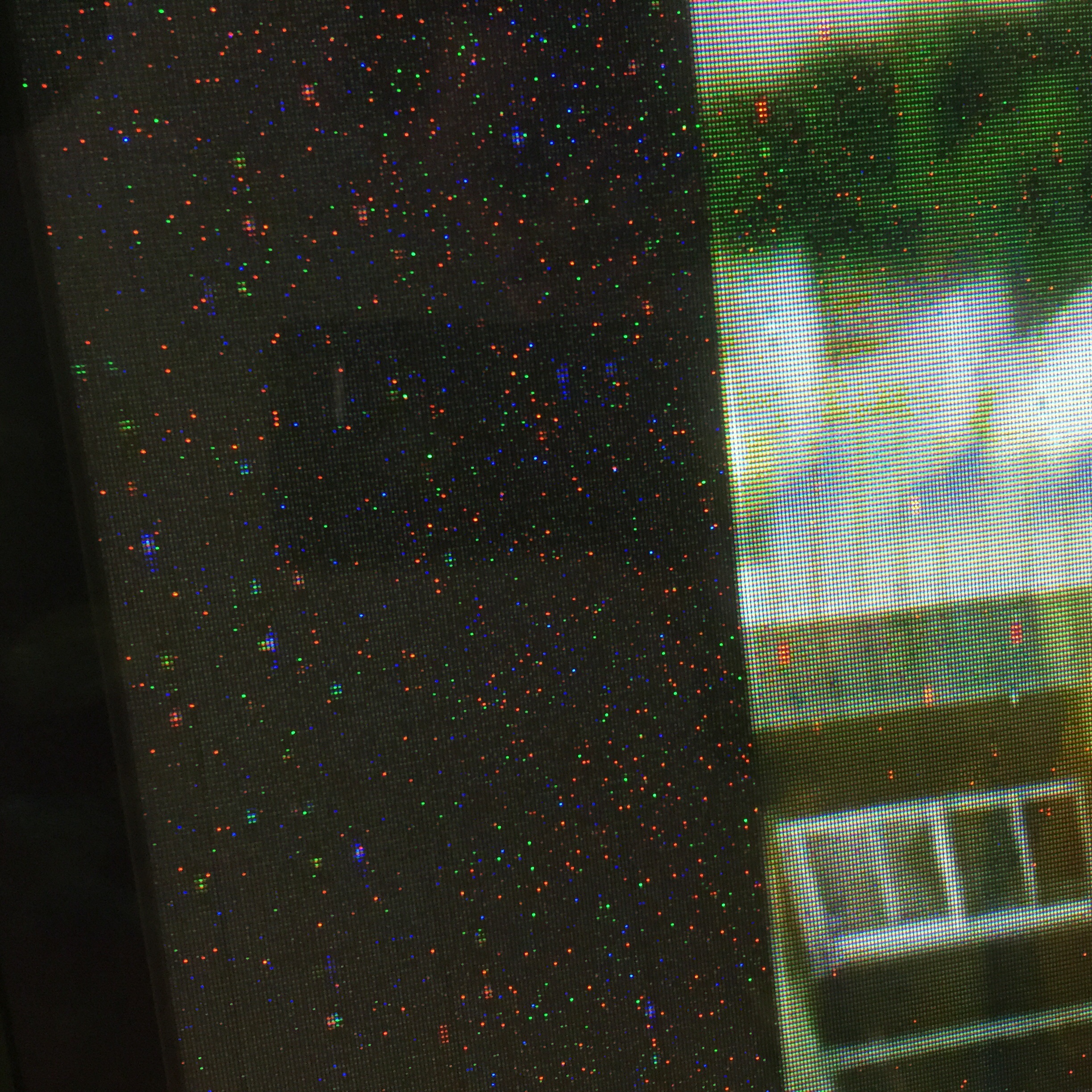

    I have a maxent tv belongs to a friend it has a lot of colors spots difrent colors green red if any one has any ideas what might be causing it.here is a pic.

    Does it look like noise is causing this maybe bad Zboard
      Re: Maxent pdp42x2 lots of color spots
      This is maldischarge. It will require the software on the control board to be updated. Capkid in the USA has the equipment and software to do this, maybe worth PMing him. It is a common issue with these LG panels.
                      Will replacing the logic board fix the problem
                        No. Needs a firmware update to fix a problem with the algorithms that compensate for panel aging.

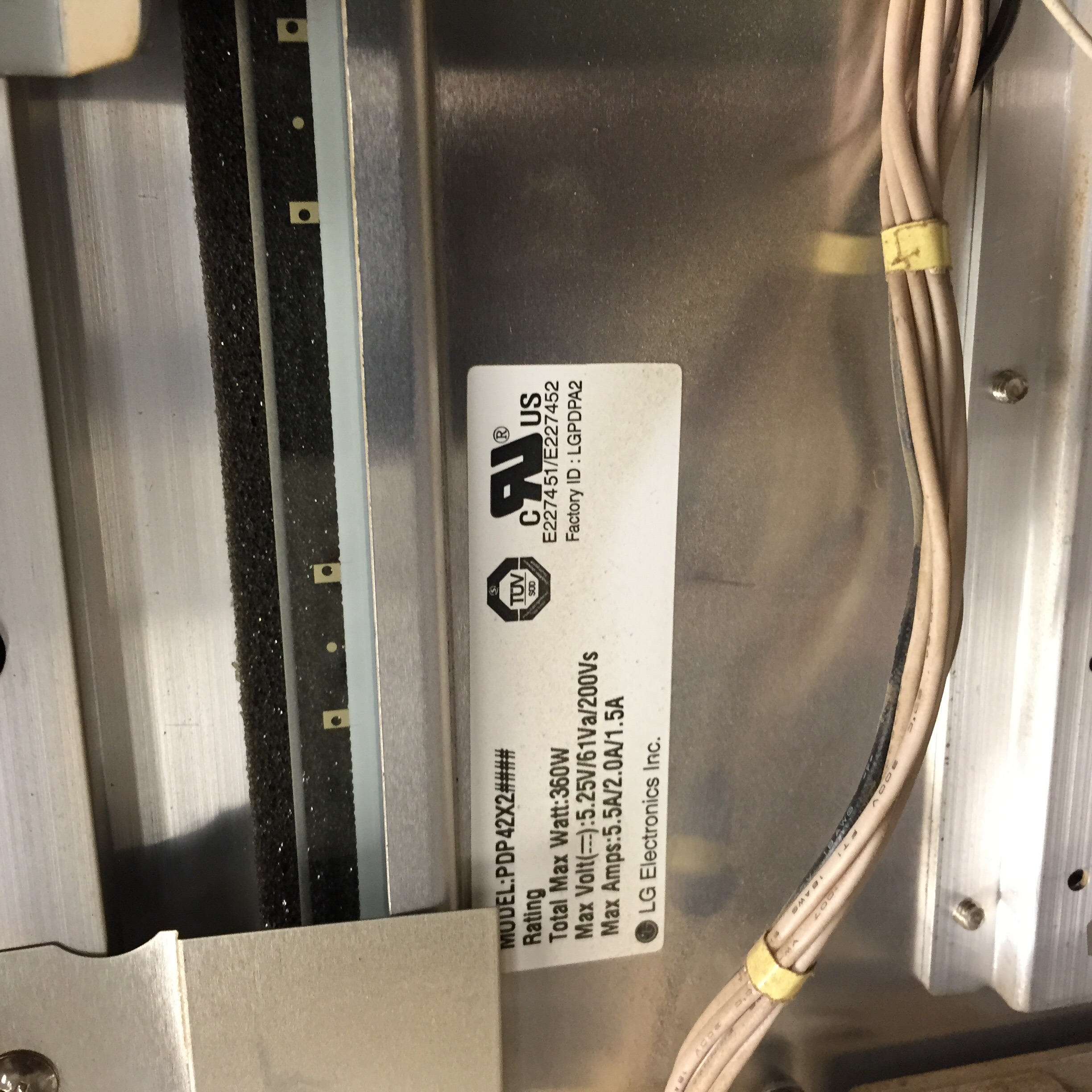

                          Here some pics

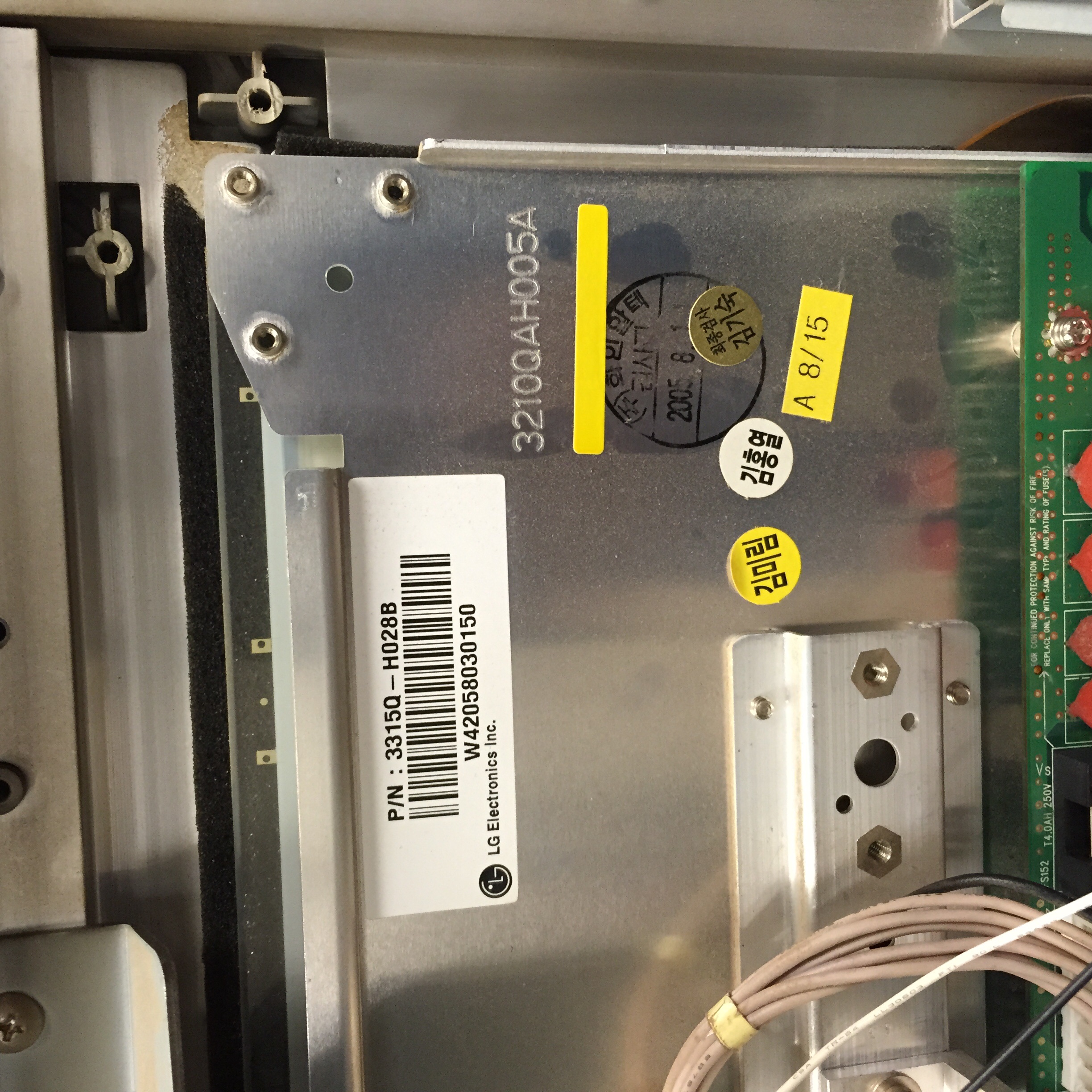

                            Here pic

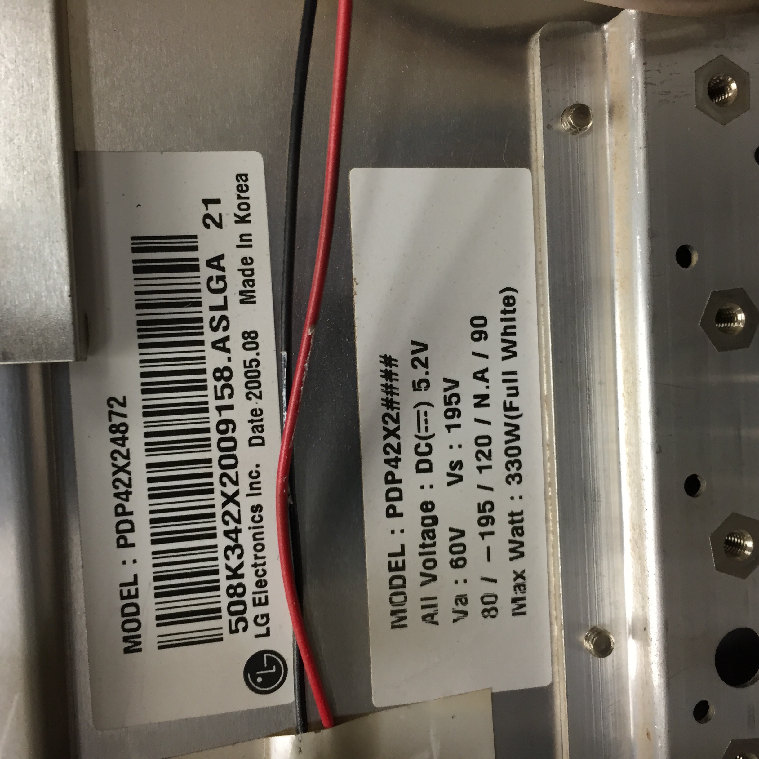

                              Here another
                                The last one
                                  These pics confirm you have a 42" X2 panel, which is well known to suffer from maldischarge issues over time.
                                    Finding the correct software to flash the control board for this TV has proven to be inconclusive, so I'm posting on the forum to see if someone might be able to shed some light.
                                    The service ROM master sheet that comes with the LG jig software mentions three panel models for the 42X2A control board and two software versions:
                                    (1) Software version 42X2ADNACS2_8D10.bin for PDP42X2002# and PDP42X202## panels
                                    (2) Software version 42X2ATDCS2_64C0.bin for PDP42X208## panel
                                    Based on the sticker on the ROM chip (42X2ATGL3A), I can only guess that "42X2ATDCSC2_64C0.bin" is the correct software version.
