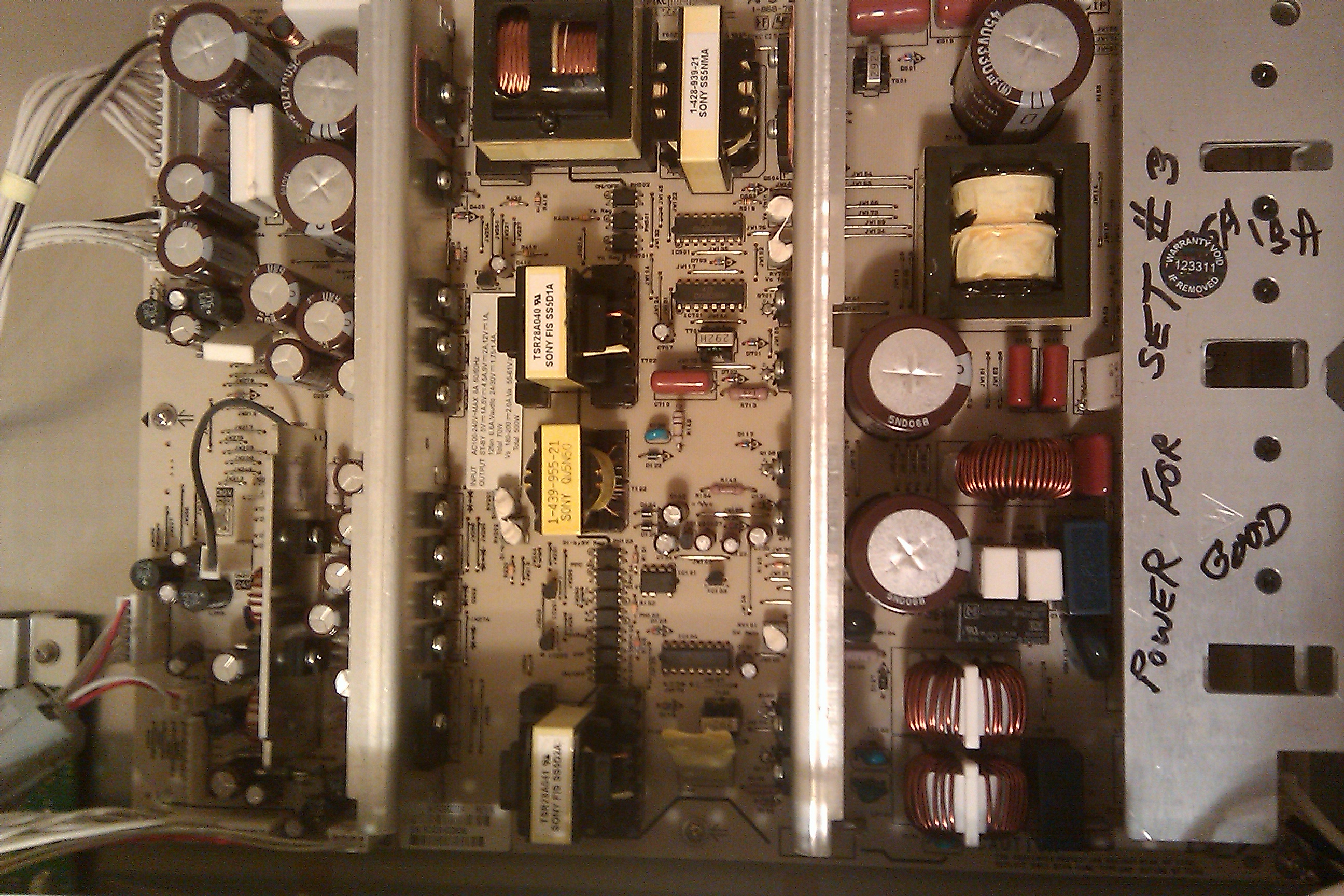

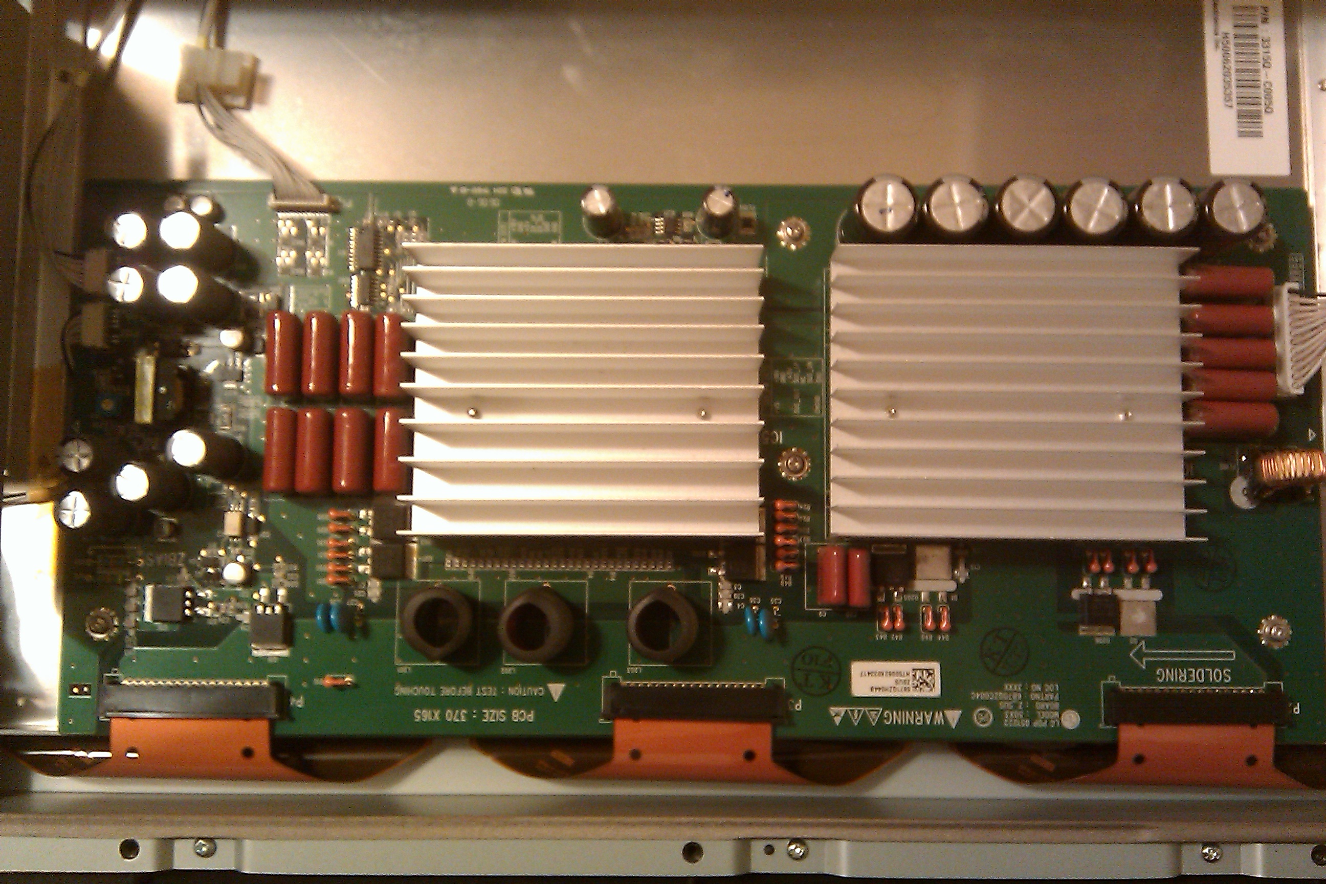

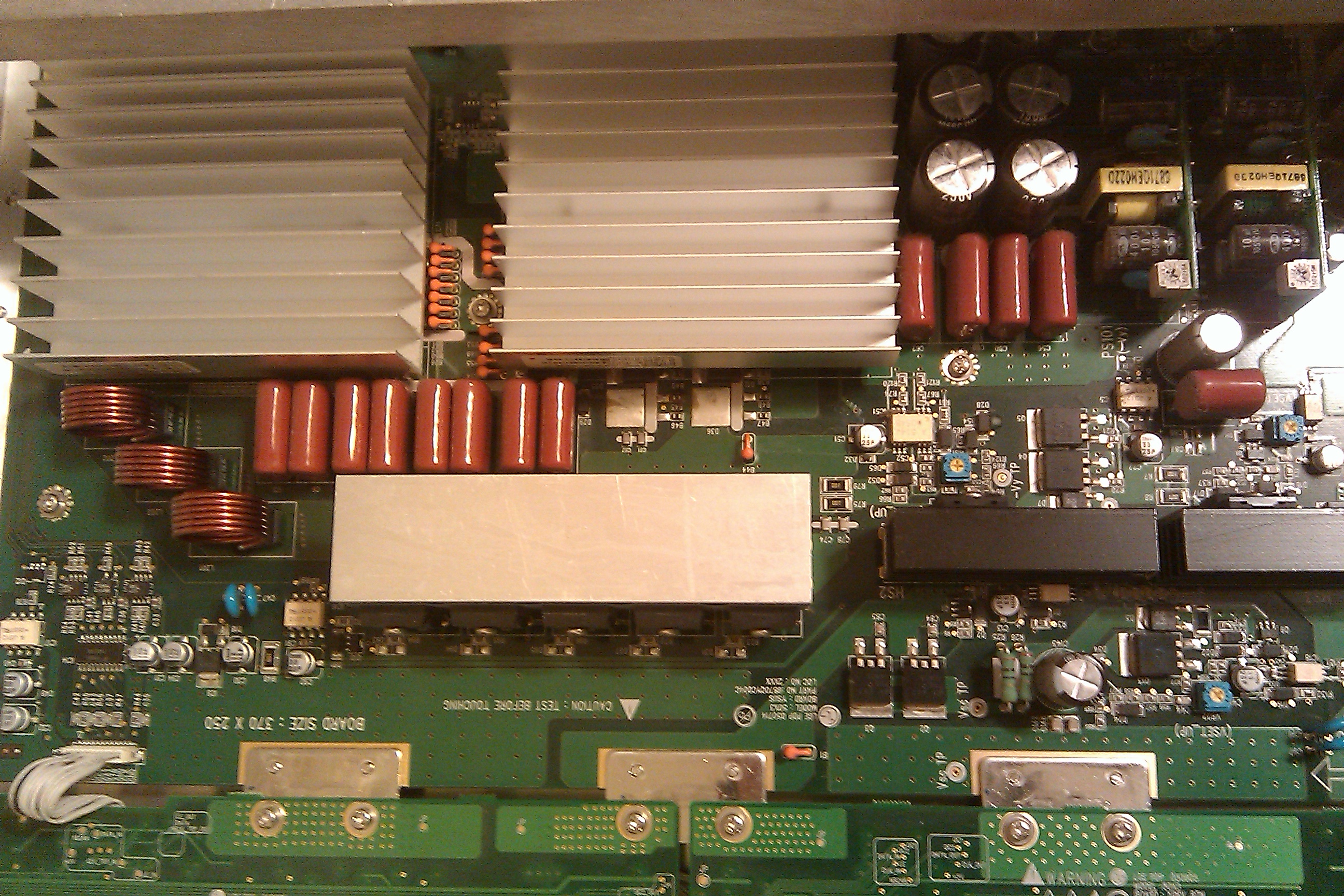

    What I have - Toshiba 50HP66
    What it does
    red LED on front glows when A/C is applied, goes dark when relay on PSU clicks (in about 3-5 seconds). LED may go green for a brief second if I press Power before the relay clicks but, once it clicks, it's dark for good.
    What I've done
    Unplugged x-sus = same thing
    Unplugged y-sus = same thing
    Tested three fuses = all good
    Tested Va, Vs - got some numbers but, because of the relay click, am not sure if I checked them right

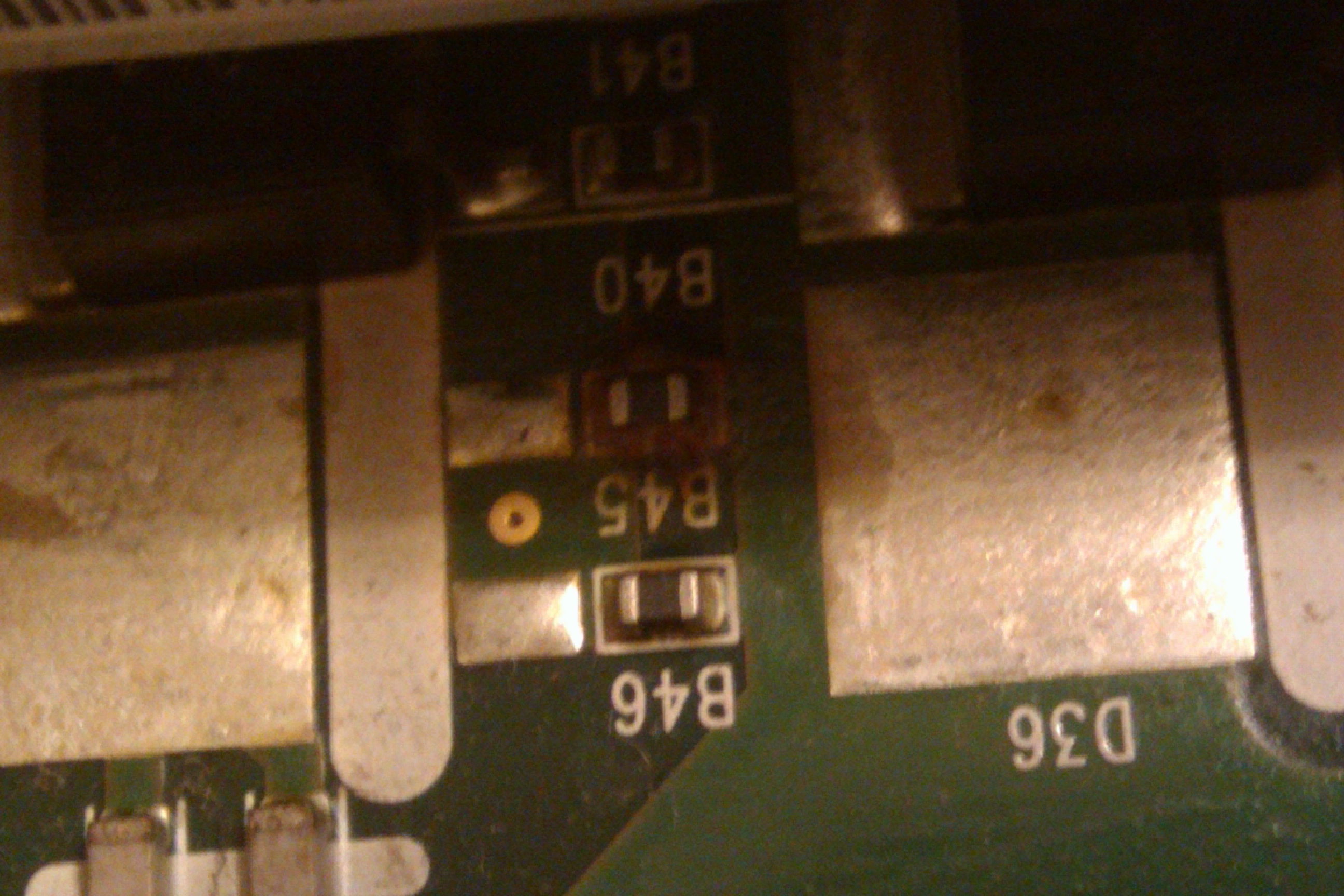

    I've attached photos of the PSU, the x-sus, the y-sus, and a closeup of B45 on the y-sus because that's the only burn mark I can see.
    Thanks.

    This set is essentially an LG 50PC1D I think. There should be lots of info on that so do a search for that model and see what you can dig up.

        I can verify that that power supply us made by sony and also it will not stay powered up if one or more sustain boards are disconnected. Check IPM modules on y and zsus. If o e is shorted and didn't blow a fuse on the ysus then it's deaf short putting the power supply in protect mode. Do a ohm check from vs to ground in both sustain boards. If one is shorted to ground there's your problem. These sets are so prone to IPM failures it's amazing. I've had hands on experience with this model in my earlier years when I was leaning about plasmas. Then I have pickled with almost every rebranded lg pc1d there is. Lol.

                    I would test all fets on ysus and zsus for shorts. They can short without popping the fuse.

                      Thanks for the suggestion. I checked everything that looked like a FET and found two on the z-sus board (D203, D204) and one on the y-sus (Q12). Although the next step is probably replacing these FETs (which I could do), it would be faster to send these boards to rehab in case there's something else to be fixed.

                        There are three fets each on the upper and lower buffer boards, make sure you check those as well. I'm about to dive back into this exact set (suspected ipm failure) so if you want to tackle any repairs just let me know if you need any measurements.
