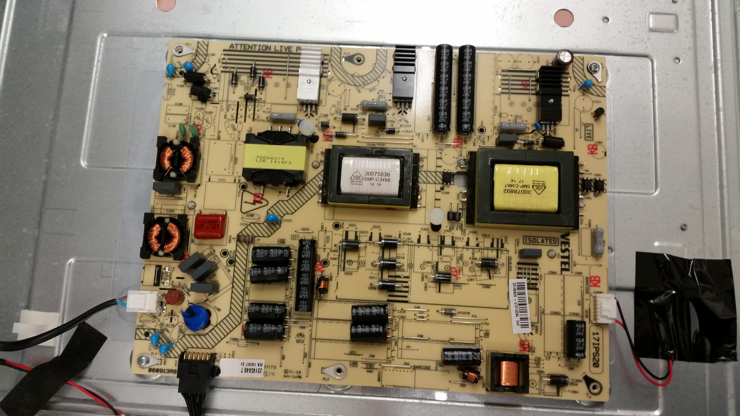

    Hi all.
    I have this one to have a look. This is Hitachi 42HXT42U with Vestel 17IPS20 PSU. It will powers up, logo shows up, than it goes to black screen standby diode blinking orange/blue. After few seconds goes off for few seconds and all will starts again. Any ideas what is wrong whit this TV?
    I can get PSU but I need to be sure that the PSU is failing.

    Worth checking voltage on PSU primary side, across 450V cap.

      Re: Hitachi 42HXT42U blue diode and restart
      Can you tell me where is this cap please?
        Top of board, two large caps marked 450V. Check across either. Careful, mains voltage, high voltage, potential for shock.
          392V on both.
            Ok, check the voltage to the LED string (single pair red/black), and the lower voltage rails, 12V/24V/etc.
              165V to LED
              There is no marks on PCB with voltage value. Is there any diagram available for this mode?
                If the LED backlight comes on, the LEDs are probably ok. You should check if the voltage remains steady though, or if it drops/increases, as the backlight flashes.
                I don't have a schematic for this but there are usually ones available for Vestel sets.

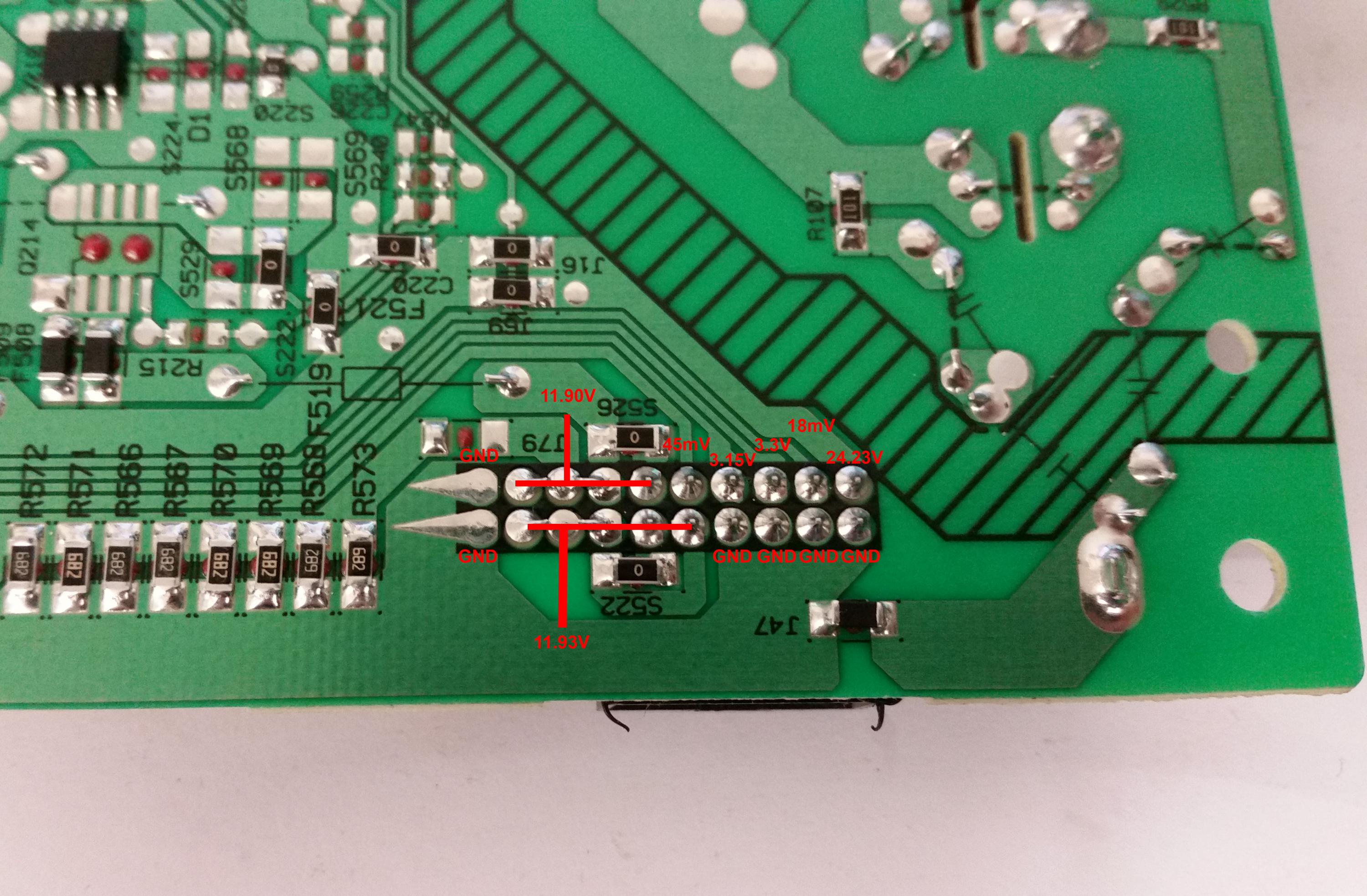

                  Just checked voltage with backlight on.
