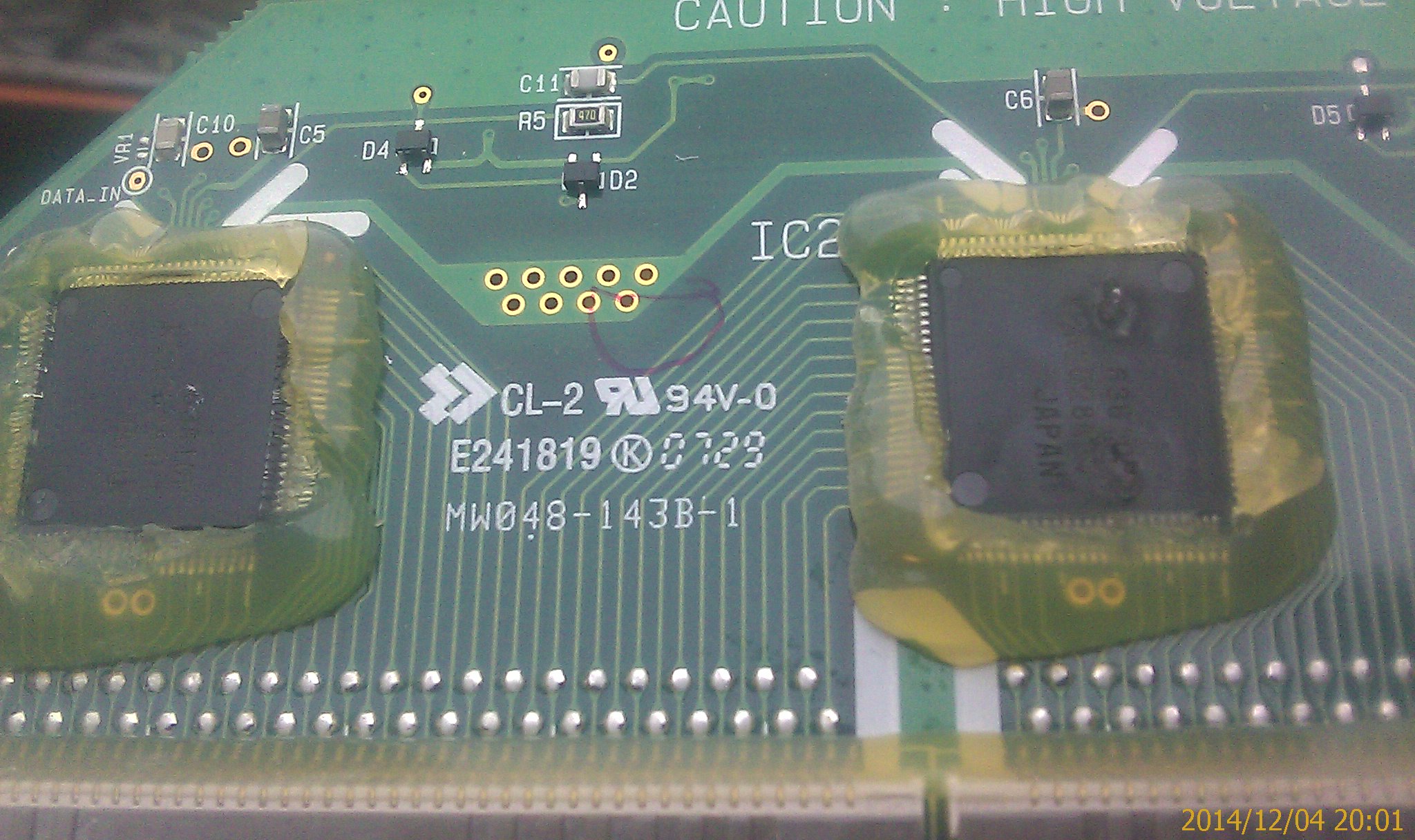

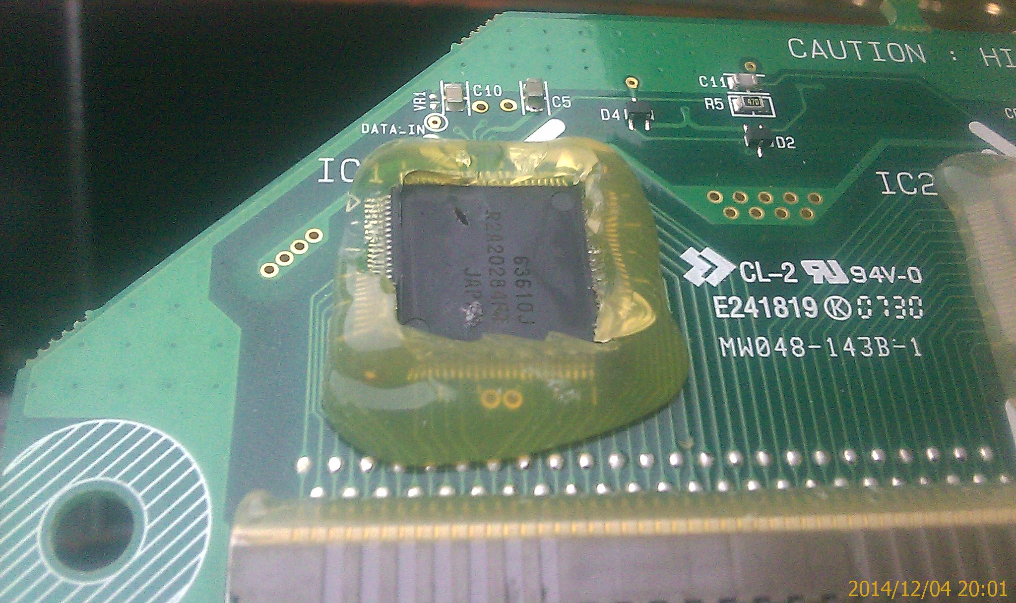

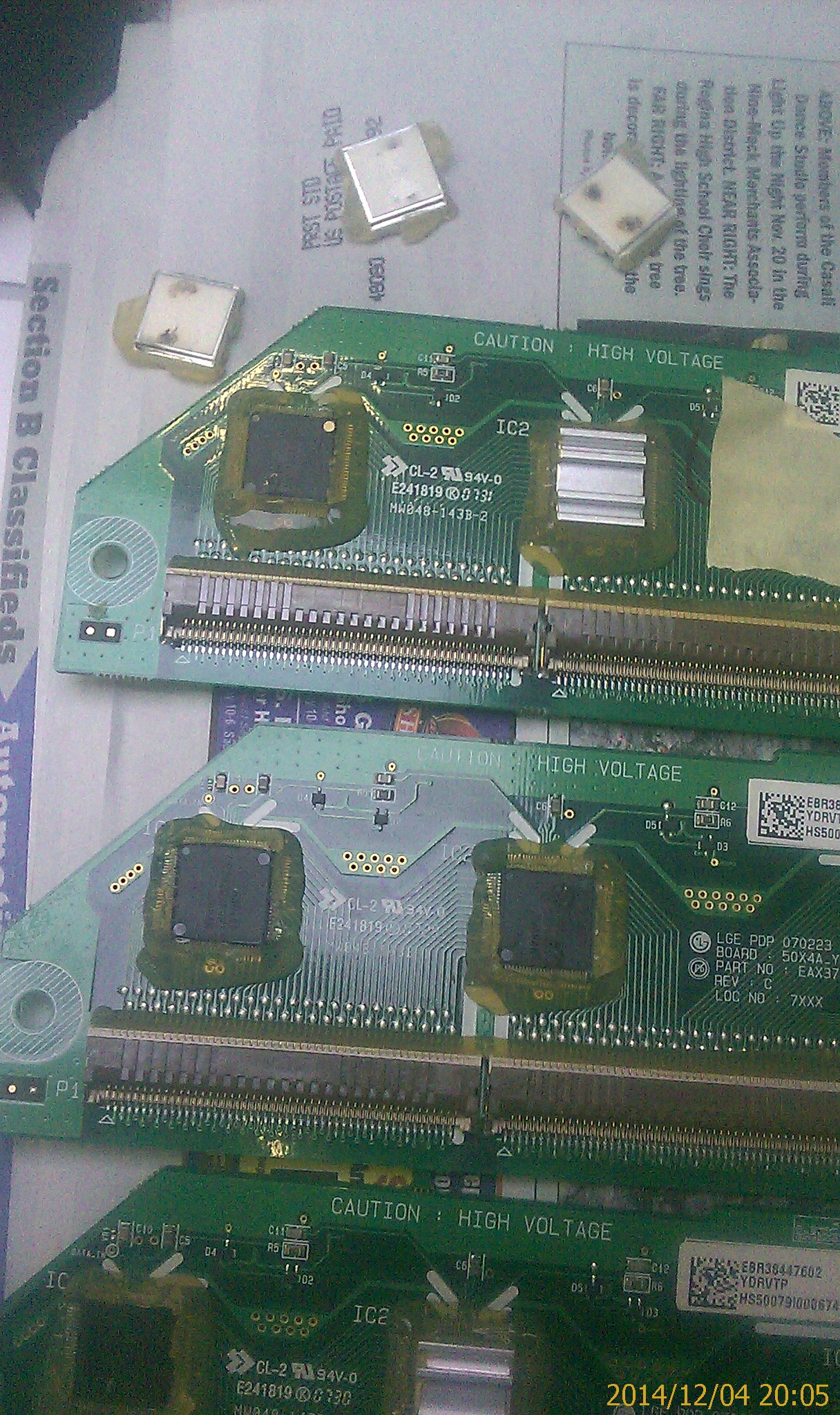

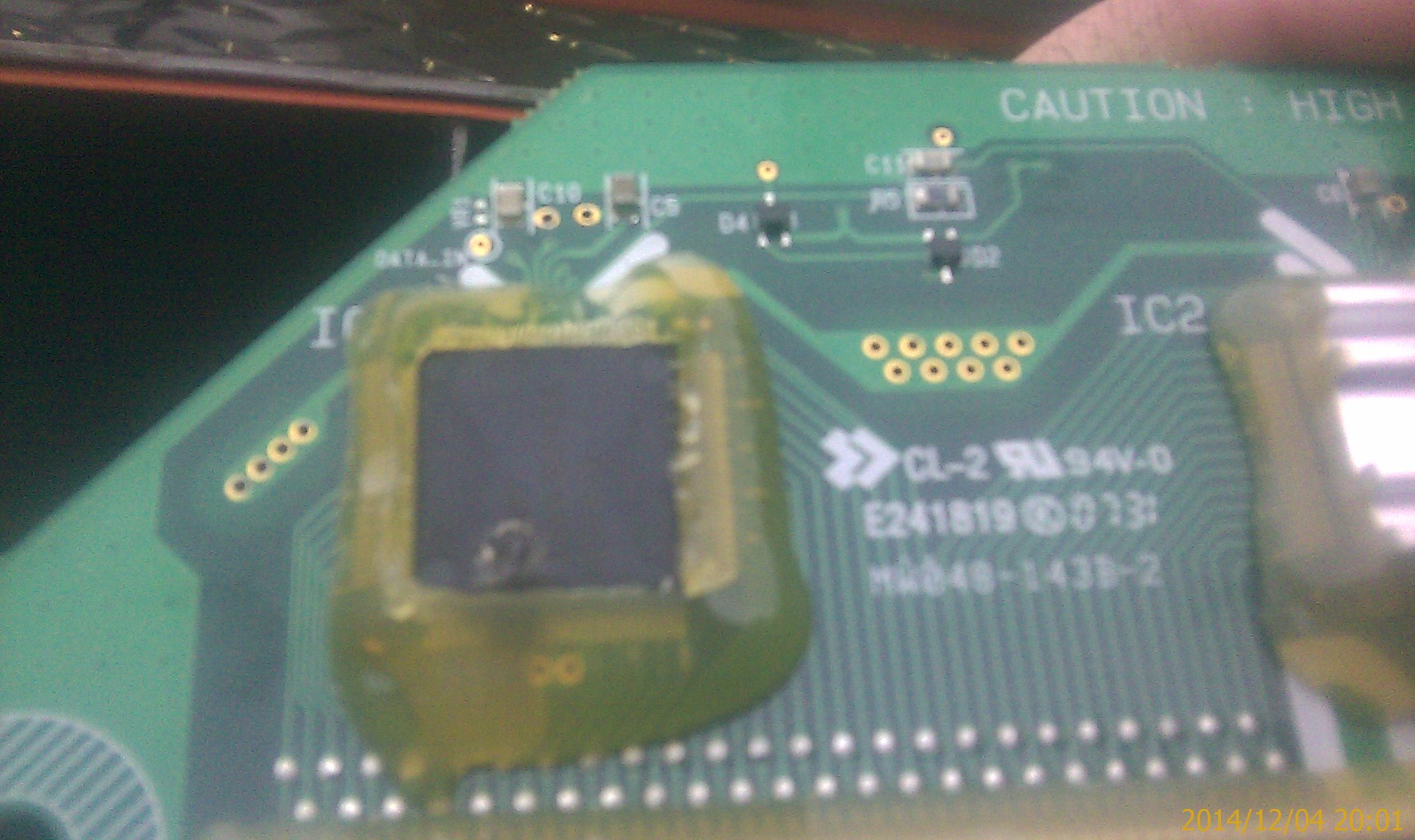

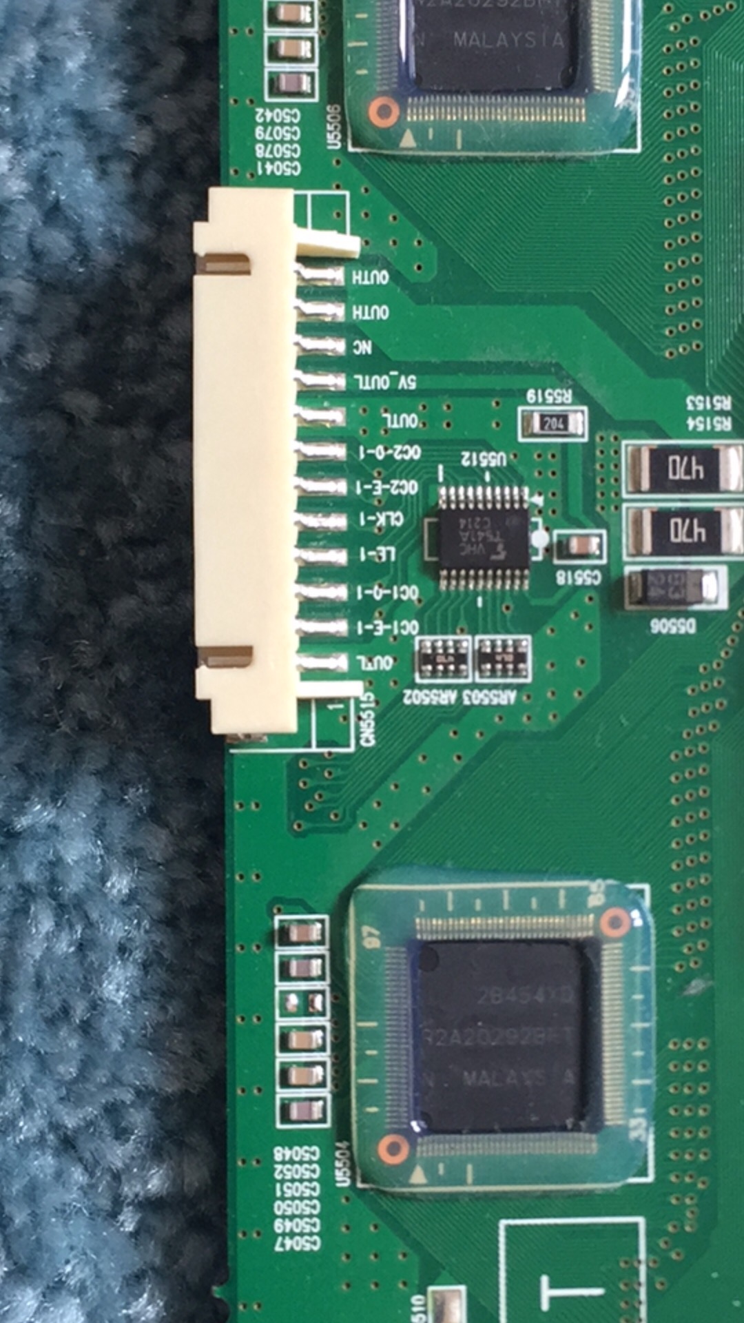

              i want to thank everyone who helped me on this issue
              using the various testing methods i have proven that in fact all my upper y boards bought on ebay and shop jimmy are are shorted 100%
              after doing the tests i marked the chips that tested shorted and since the boards are no good in my mind i decided to take it one step further...i took the heat sinks off to see what the chips looks like and see my photos.....everyone that tested shorted were broken or burnt or holes.....see brown spots under heat sinks....
              so this thread is officially over.....
              thank you again..........the tests work.....and pictures say it all.....photos dont lie...as much as the ebay sellers want to say their board is good...its all BS...i have proven them wrong...
                Re: test y buffer for short? part# ebr38447802
                oh well cant get the chip off.........heat gun wont melt the leaded solder........
                  uh oh.....it came off but all of the pads came off with it........i figured it wouldnt work....worth a try
