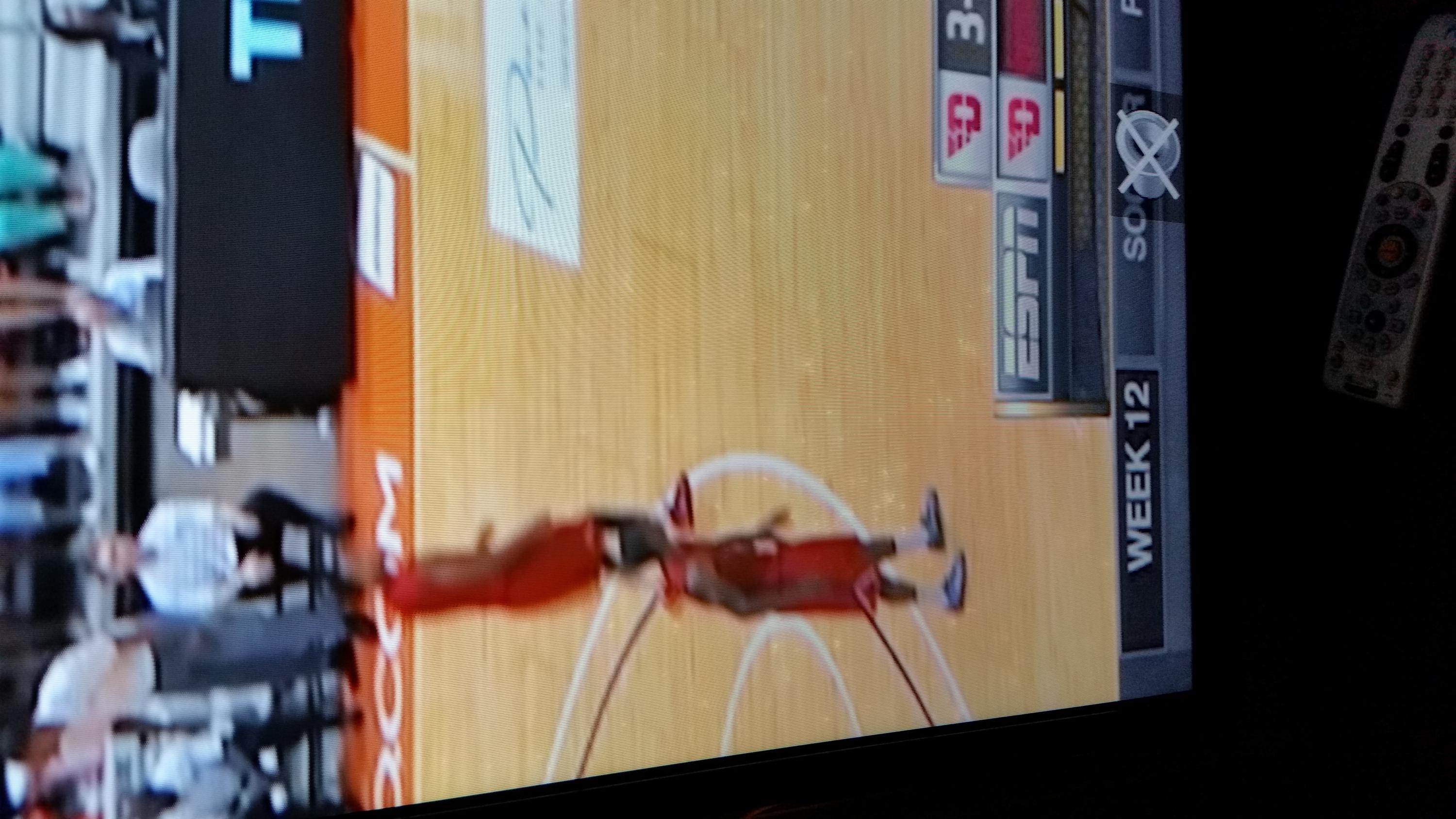

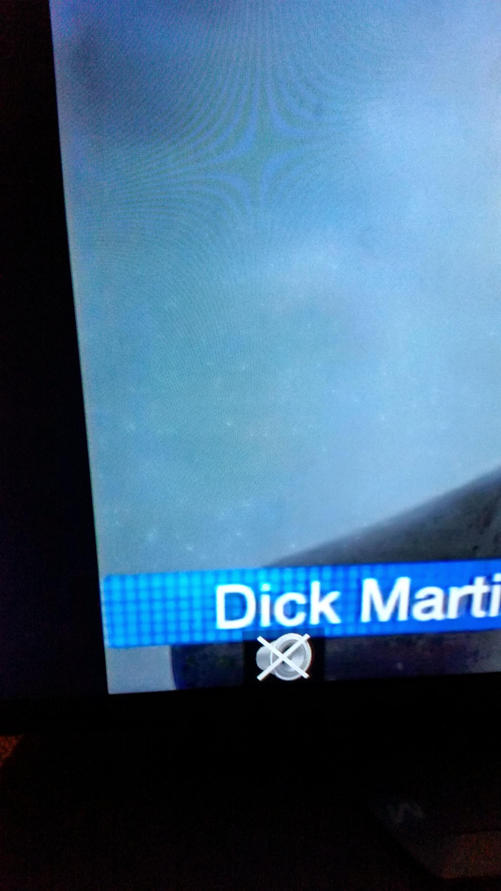

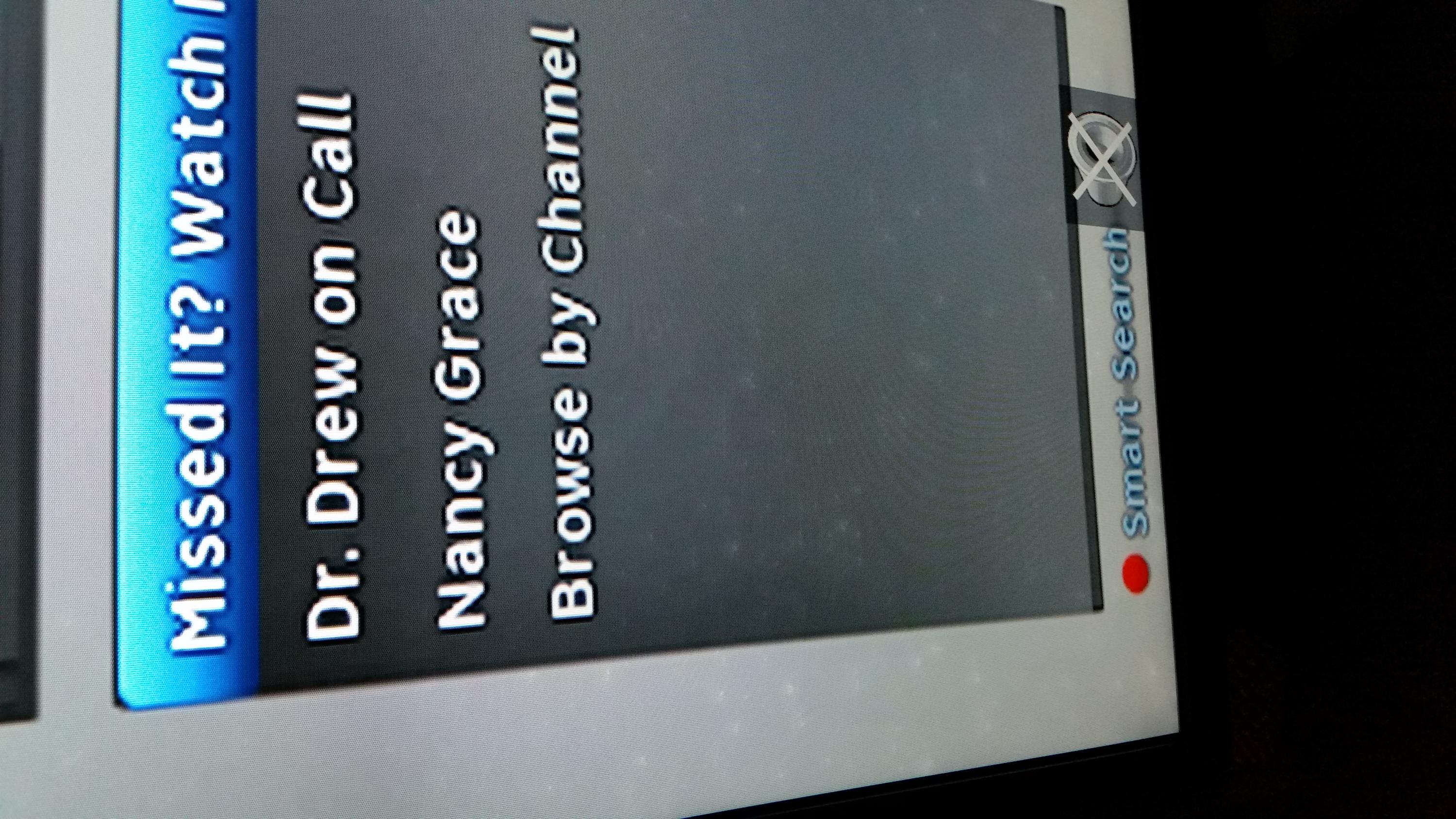

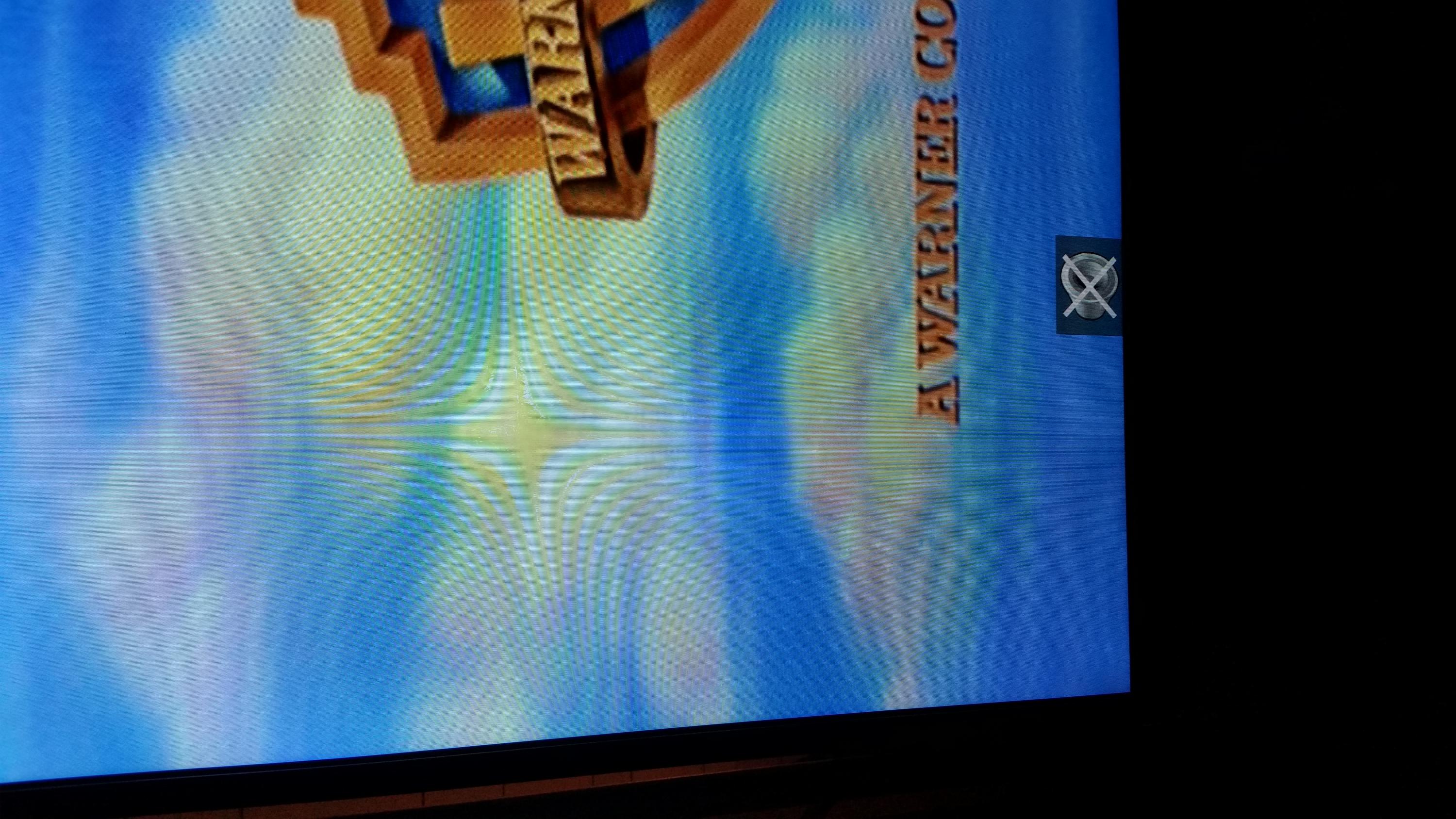

Weird display issue, looks like optical fibers, instead of pixels. Has anyone seen this? I will have to add pics from PC
Sharp Aquos LED wired display issue

Uneven backlight film layers or contamination on those layers.Please do not PM me with questions! Questions via PM will not be answered. Post on the forums instead!

No, it's not got the typical symptoms of such a fault.Please do not PM me with questions! Questions via PM will not be answered. Post on the forums instead!

Does the image change if you apply pressure to the affected area? If so then there may be moisture between the Back-light diffusion layers, there are several which diffuse the light to obtain an even light area. (Much like taillighst on an automobile where a single bulb is used in the center and it appears that the entire light is lit)
If the image does not change then I would consider re-flowing the Main IC's on the Main Board and, also on the T-Con since, this would also cause similar symptoms
But, start with applying gentle pressure to the area and see if there is any change at all
