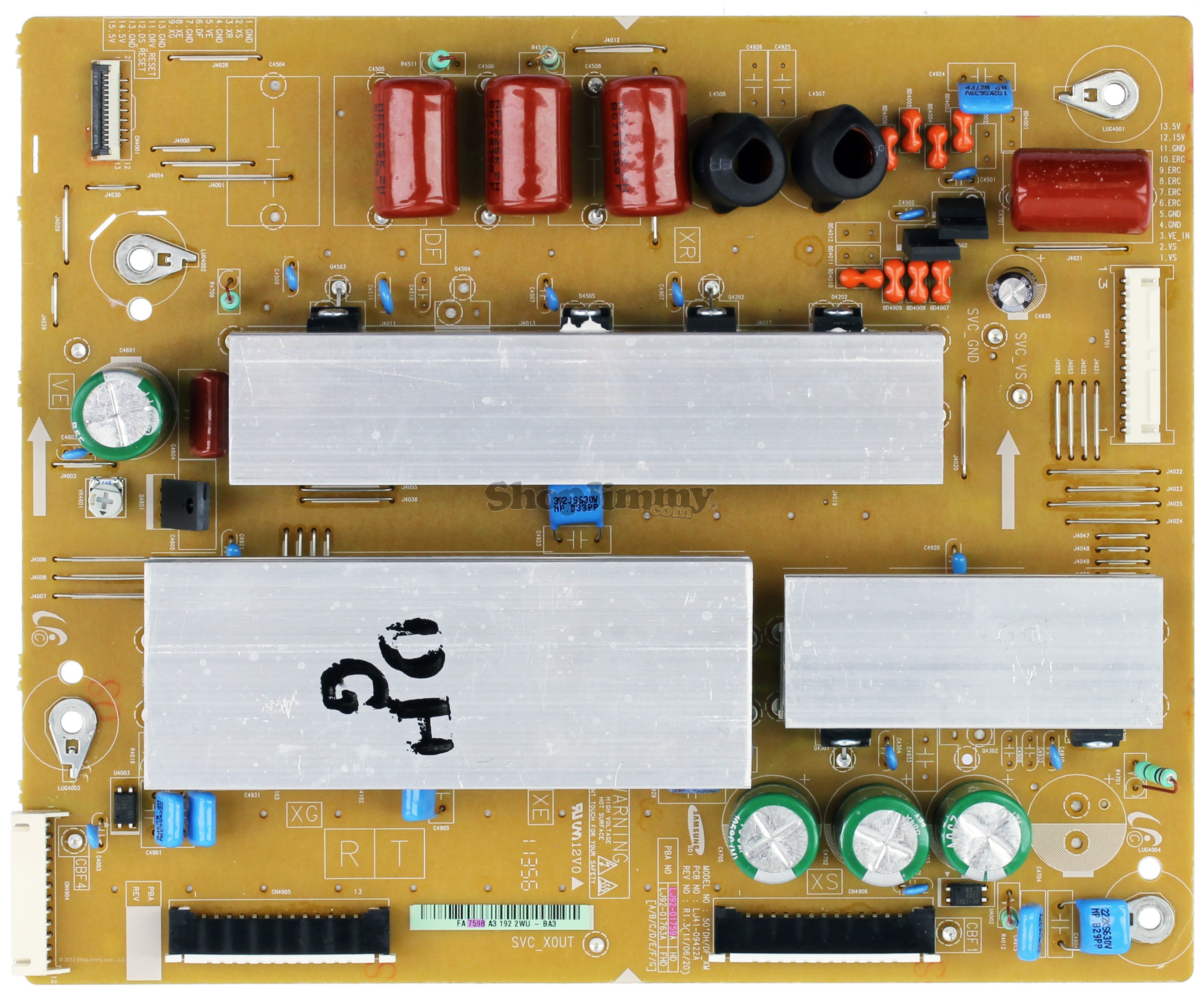

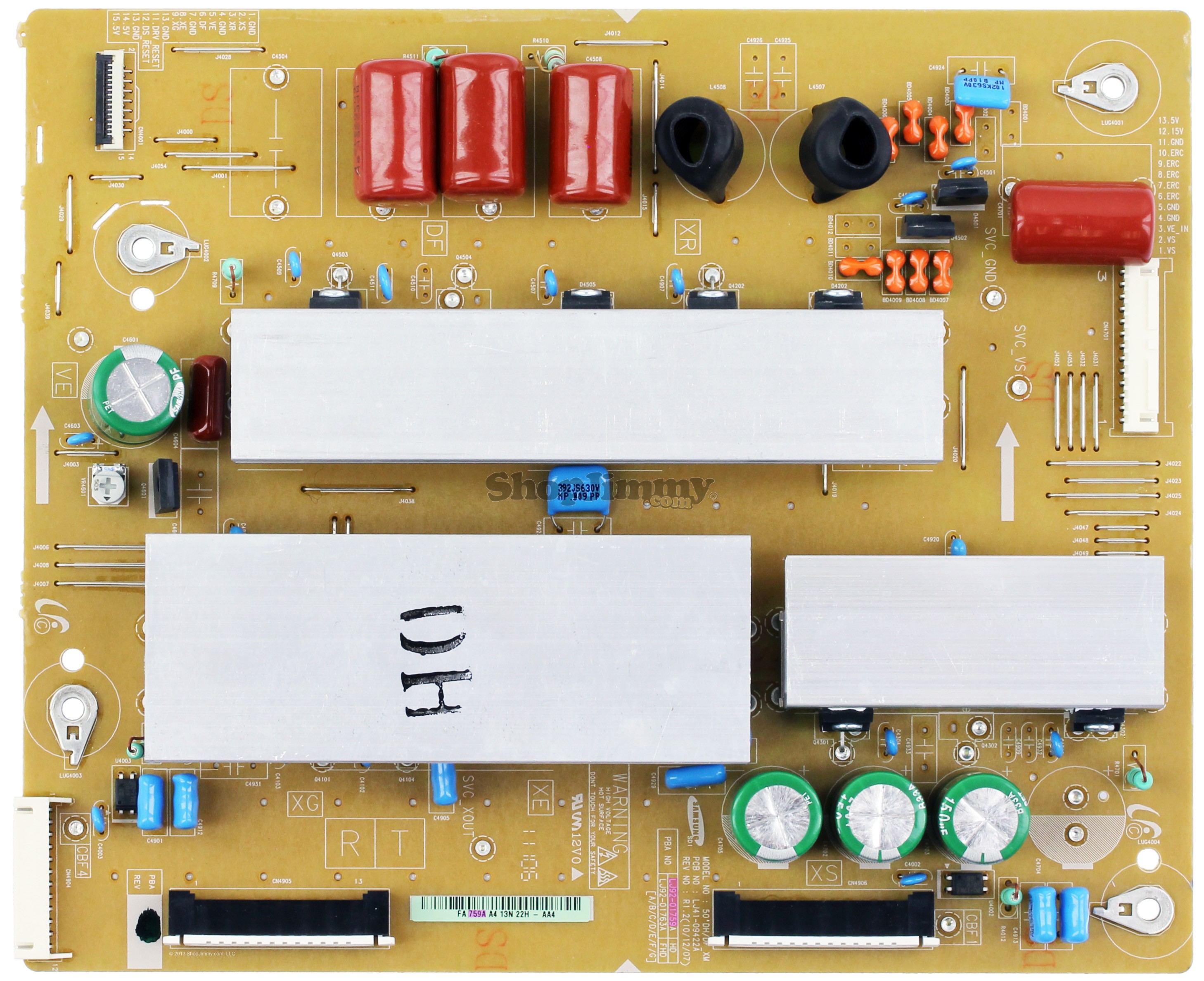

      Re: Samsung PN51D550C1F died, won't turn on, clicking
      SJ is saying
      LJ92-01763A out
      BN96-16516A is a sub, $27 and they have 600 of these
      LJ92-01759B is a sub, 449 and have over 1100
      LJ92-01763C out of stock
      So which one are you chasing? look at the 4 photos and see if they all look the same on SJ

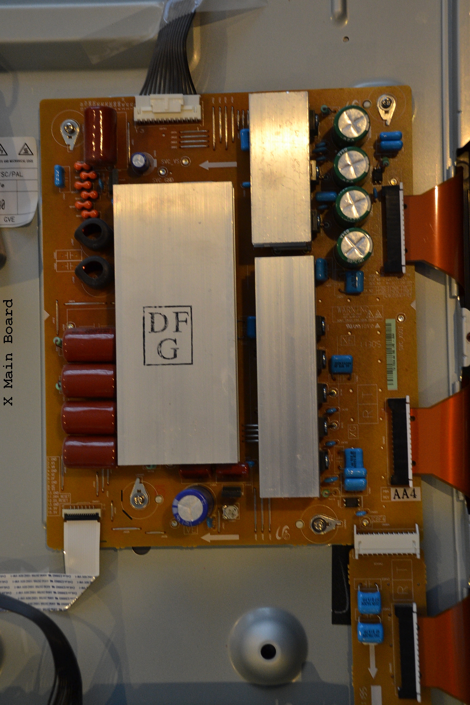

        I need an X main for my 3D Samsung PN51D550cf1xfa
        BN96-16523A PCB LJ41-09422A PBA LJ92-01763A
        763A on sticker. DFG stamped in letters on X main.
        I looked at those other ones you mentioned, tw2005, and they have a different configuration than the one I have.
        That being said, can a 2D board be used on a 3D TV?
        Your advice, and help, is solicited and greatly appreciated.
          Re: Where to get Samsung parts...none on Ebay, Jimmy, etc..
          In at least the 720p models there's no difference between 2D and 3D boards, and 2D and 3D panels. I was able to upgrade a 2D Samsung 51" to a 3D Samsung 51".
          However do note there IS a difference between the 720p and 1080p boards...
            I see where your coming from all 3 have the same PCB print.
            They are listed as fitted to Samsung panels
            (subs)
            S50HW-YD14, S50HW-YB07
            (yours)
            S50FH-YD07, S50FH-YB08
            So the panel numbers don't line up, could very be a mistake on there part.
            There are differences, impossible to see all of them and I'm only just analysing it now but obvious one is the caps.
            I was going to suggest transferring these from your board but now I just spotted less transistors, can't see under the biggest heatsink but next to it you can see 1 less.
            I reckon it would drive the panel I just don't know how it will perform and having caps and inductors missing? Would have something to do with matching to the panel. Tom may know more. If I was desparate and had no other options I'd give it a go.
                Difference between those boards is FHD(1080p) vs HD(720p) it will not work properly - it might work but would expect maldischarge on image

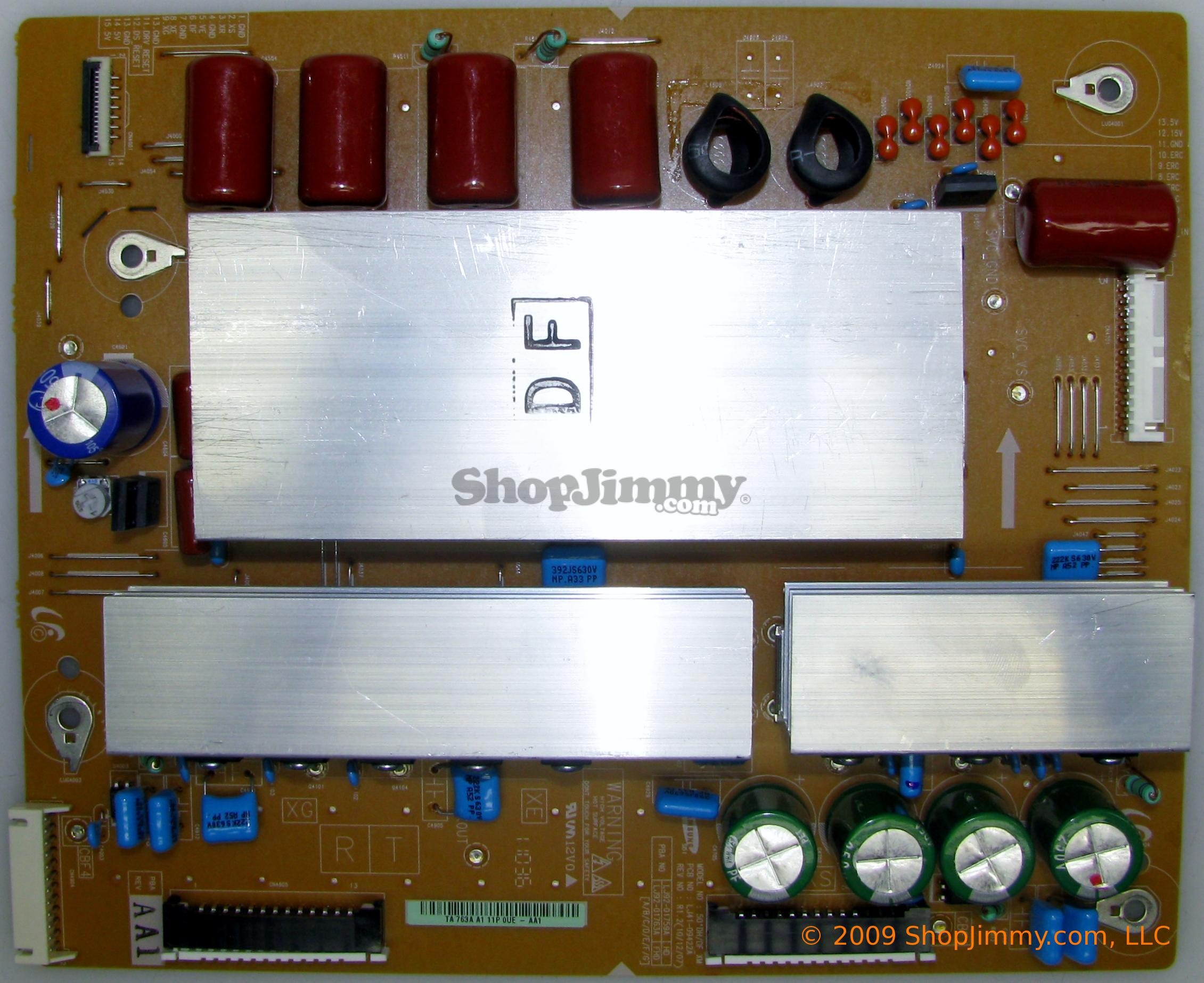

                    The one that comes closest is the ebay one you posted http://www.ebay.com/itm/Samsung-BN96...item4ace5c094a
                    It seems physically the most similar, is revision AA1 where mine is a AA4.
                    Could it be rare because it is a 3D? I see there are tons marked DHG, or DH, as they are the 2D model sold mostly into the USA. Mine seems marketed largely to Canada through a couple of major electronics chains.
