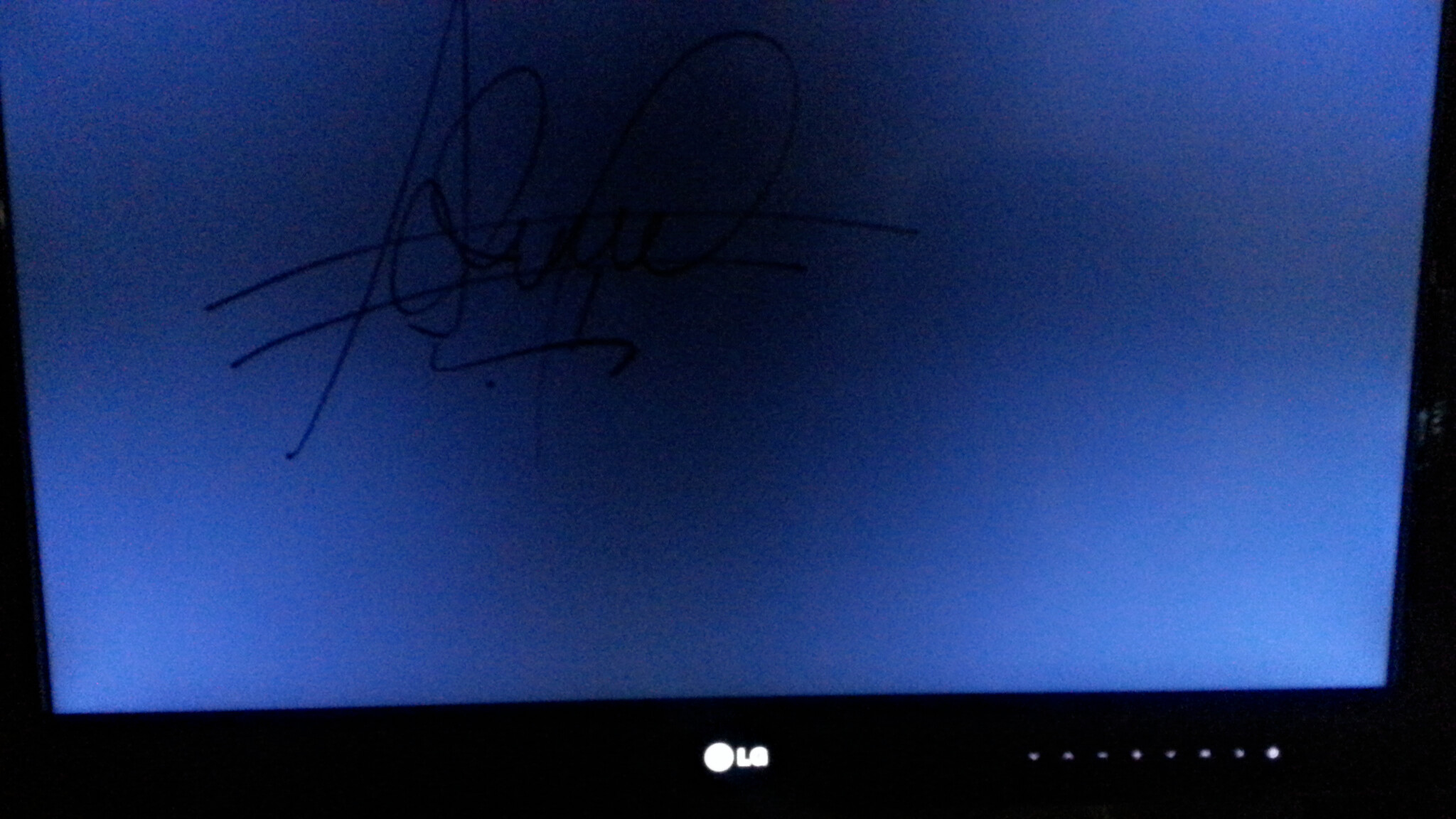

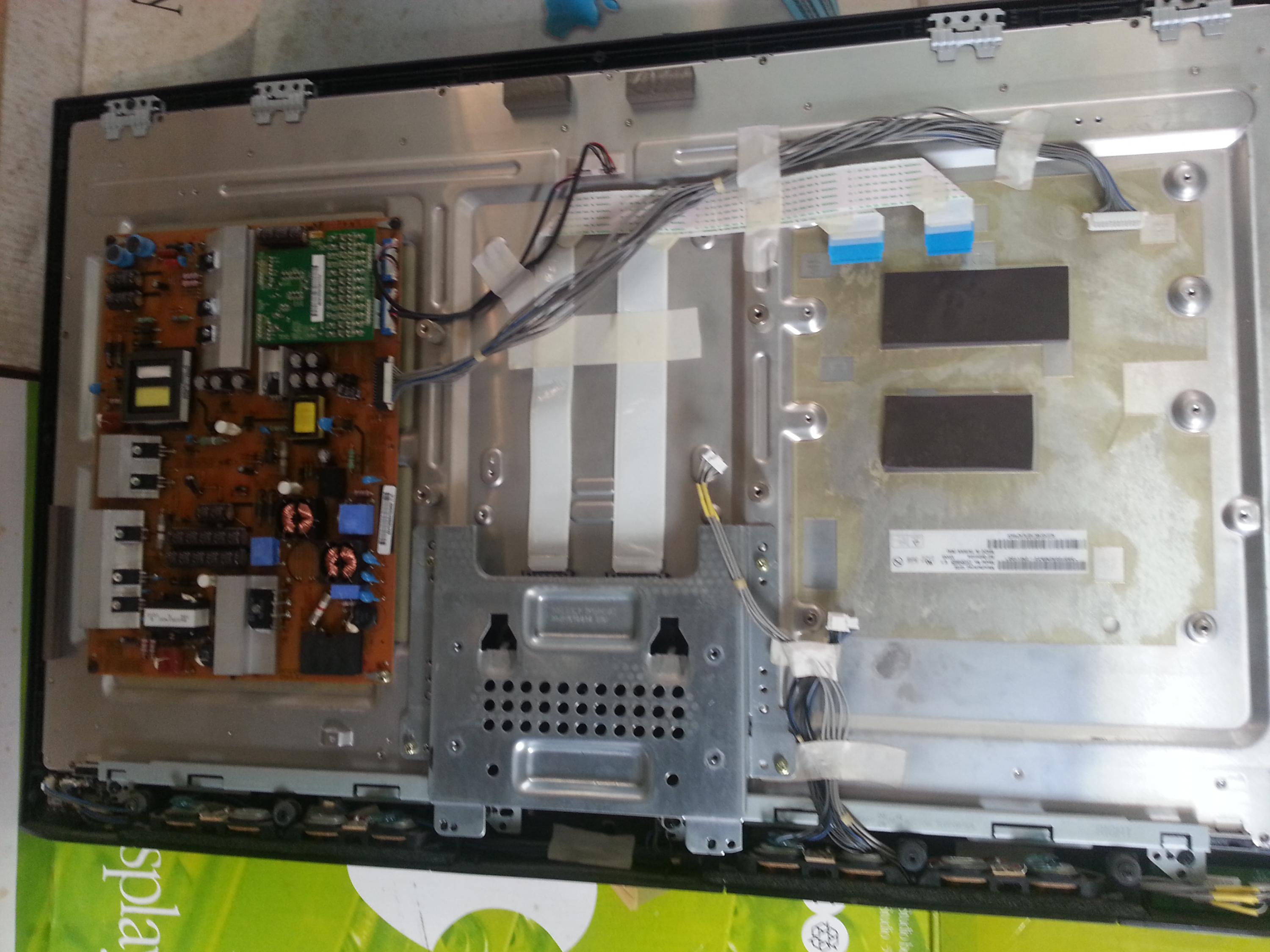

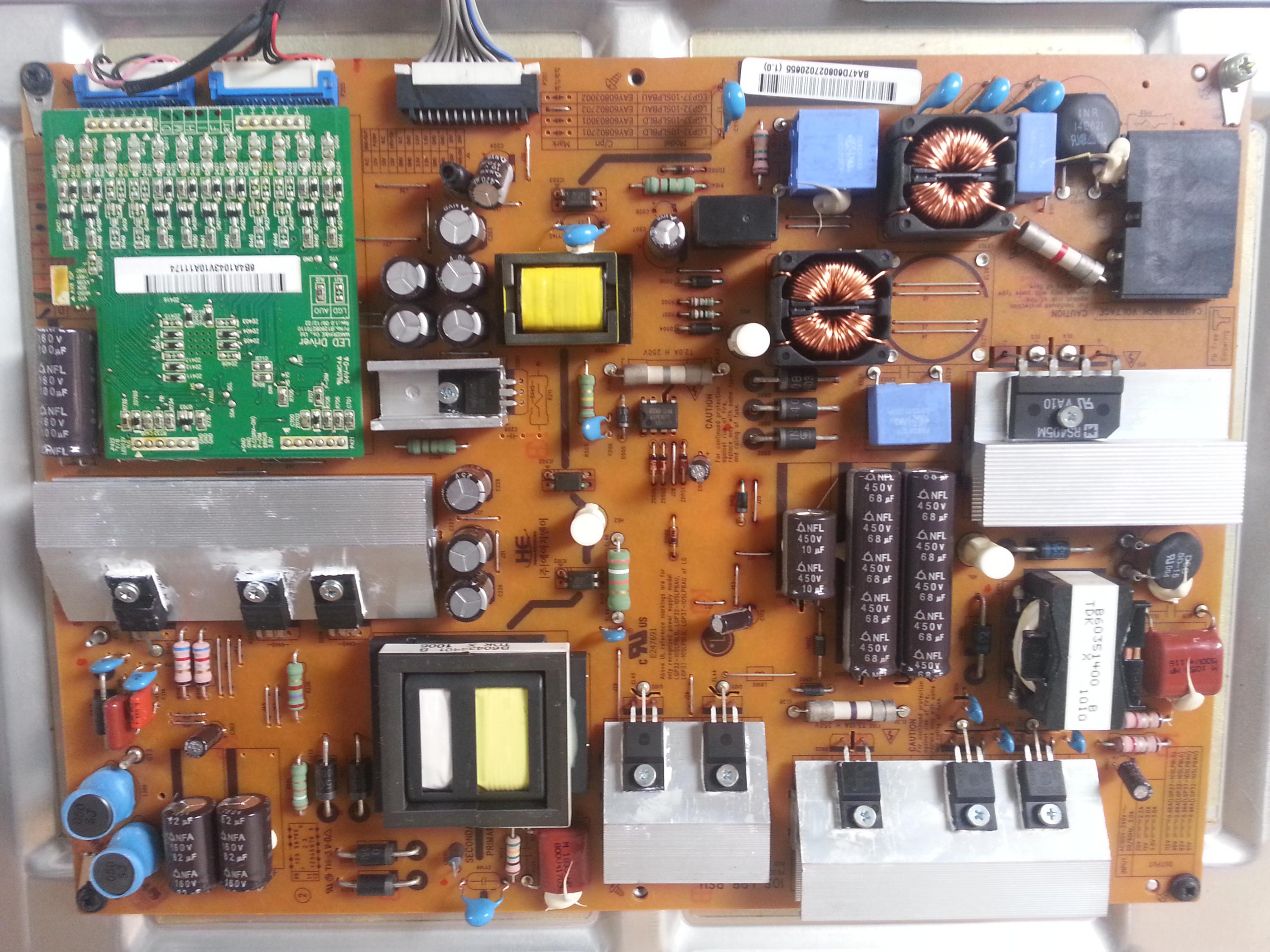

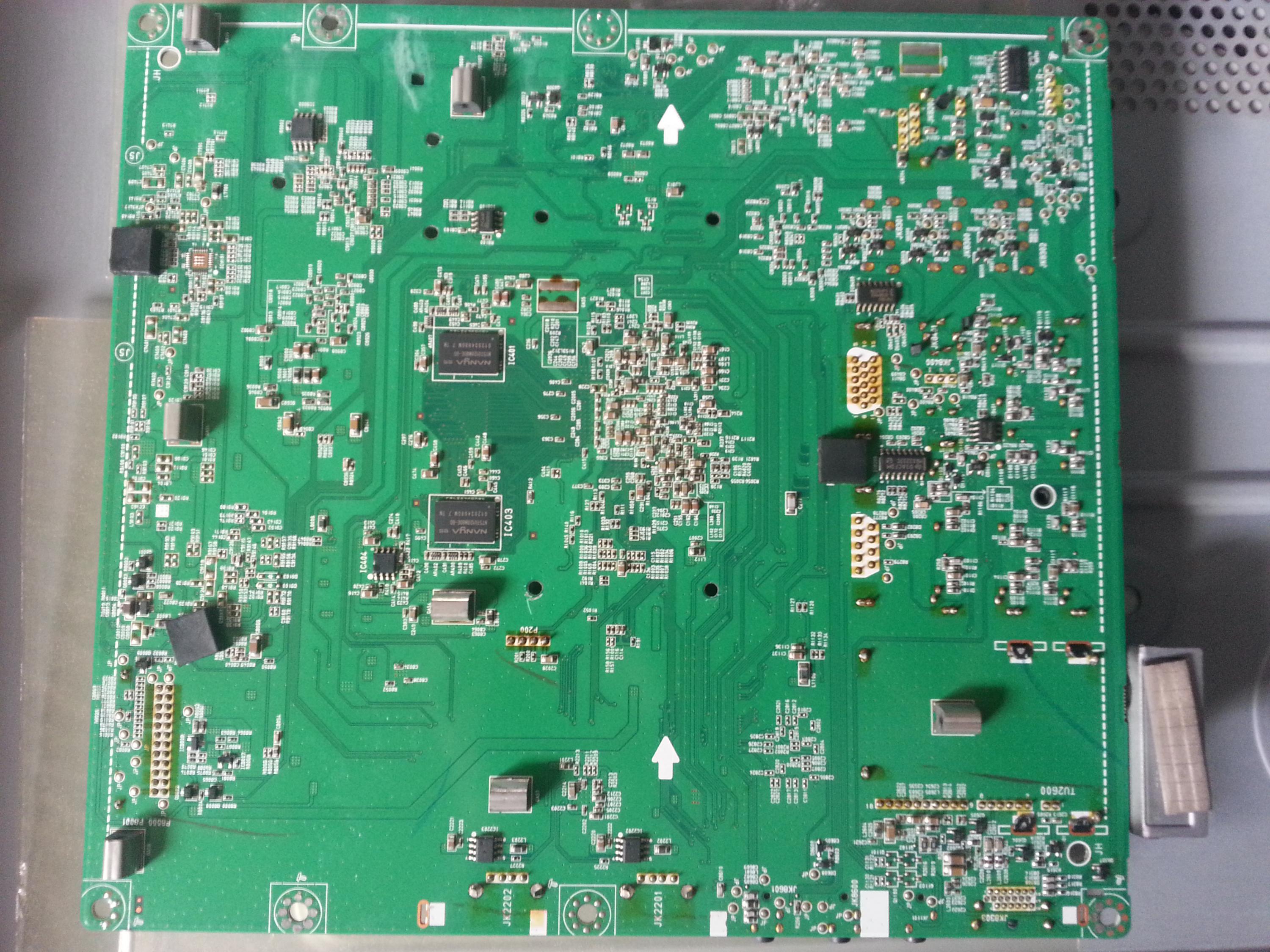

    Hi all, I need help with LG 32LE5500 TA LED TV. It only displays blue screen and nothing else works. When I touch the touch buttons they light up but nothing is seen on screen even with the remote controller its the same thing.

      There is T-CON board under that metal shield with the two FFC cables attached to, you need to get access to that board to check and see if you do have DC Voltage at both ends of the SMD fuse.
      Can you post the screen shot of the screen?

          Re: LG 32LE5500 TA LED TV displays blue screen only and nothing else works
          Thank you very much for all your replies @budm and @LGElectronics.
          @budm I attached a picture of the blue screen. I made some observations and tests before giving it back to the client. The blue screen does not change even if the tcon is plugged or unplugged. I concluded that it is the mainboard that is faulty. Most especially the scaler chip. The client does not have money for a mainboard so I gave it back to him. Sorry for the late reply. Thanks again.
