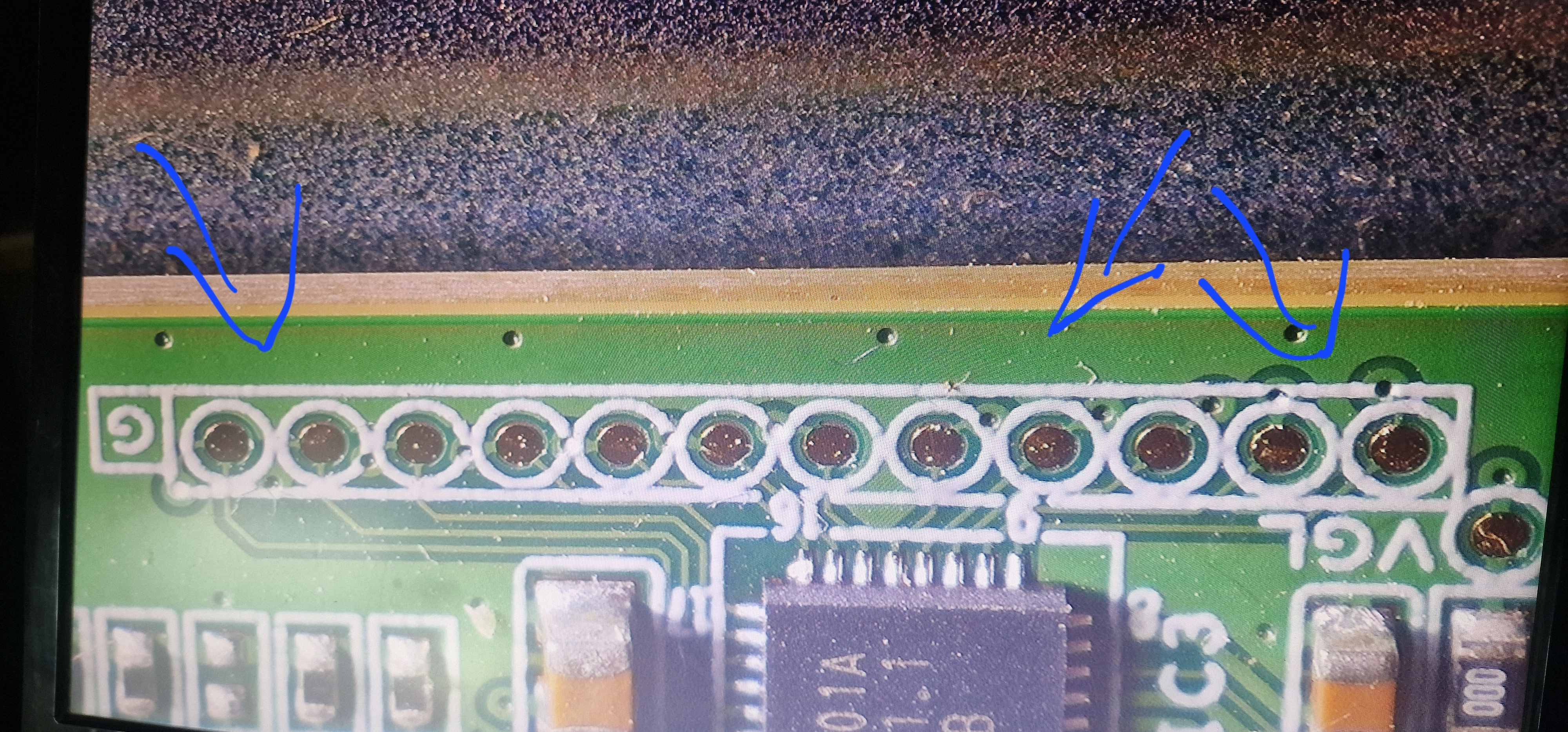

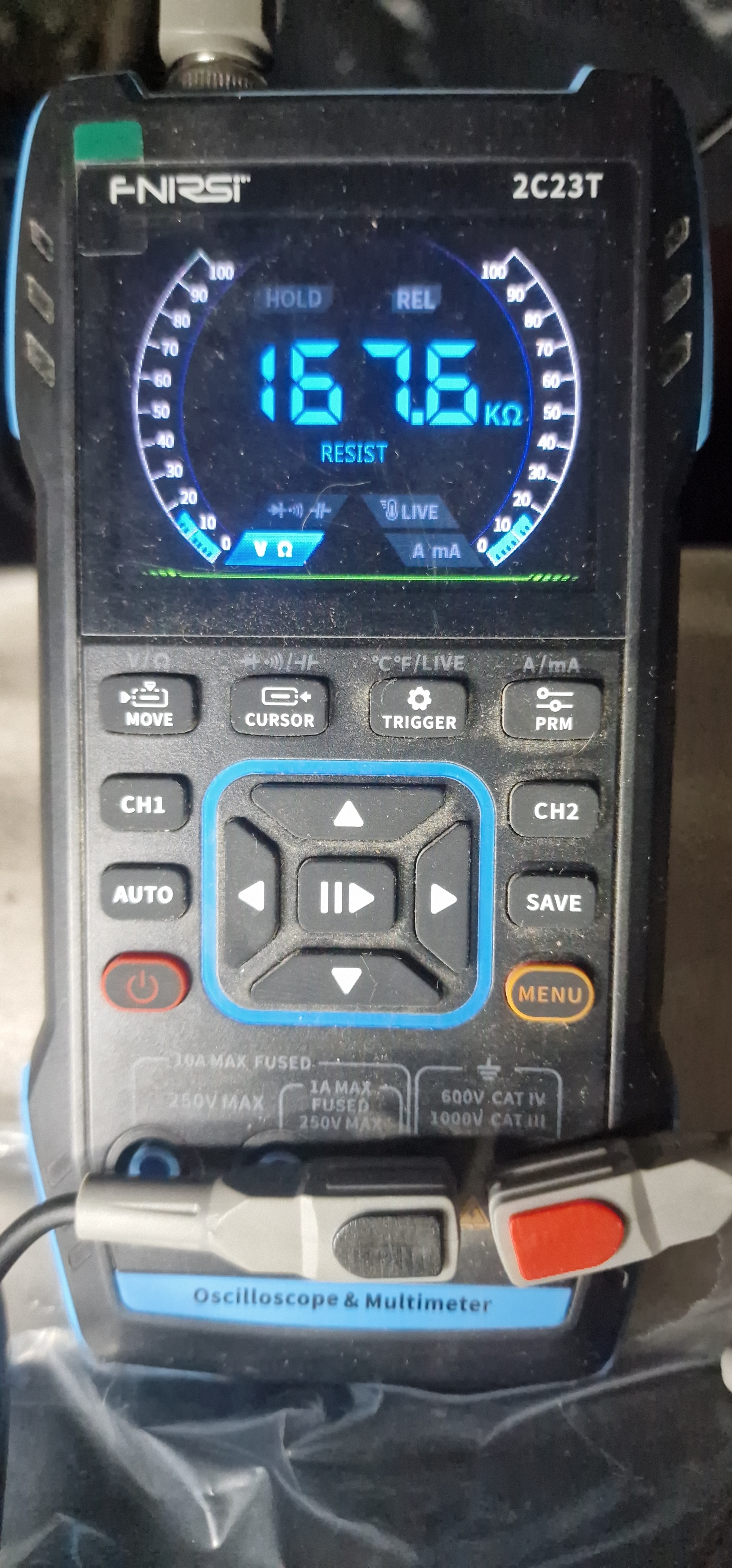

    Originally posted by lotas
    There is no difference between + and -, you are measuring resistance (There should be no low resistance or short circuit between them and ground). Yes, chassis, ground is GND.
    Ok with tv off all measured ilike this
    • labello
      • Mar 2018
      • 272
      • italia
      But when the tv is on the measurements is 0.0 in all of this. So guys if I'm not wrong seems that ic is shorted right?

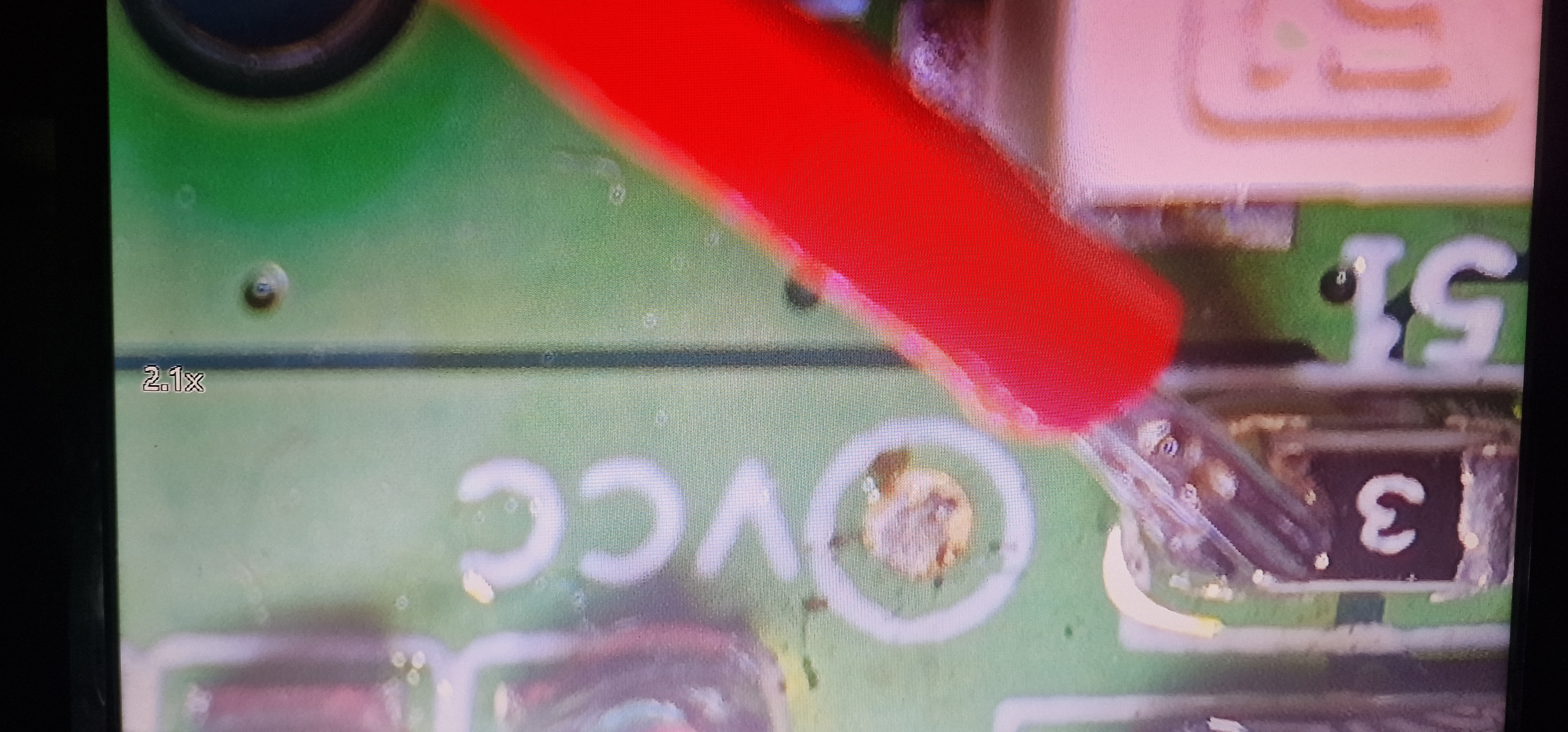

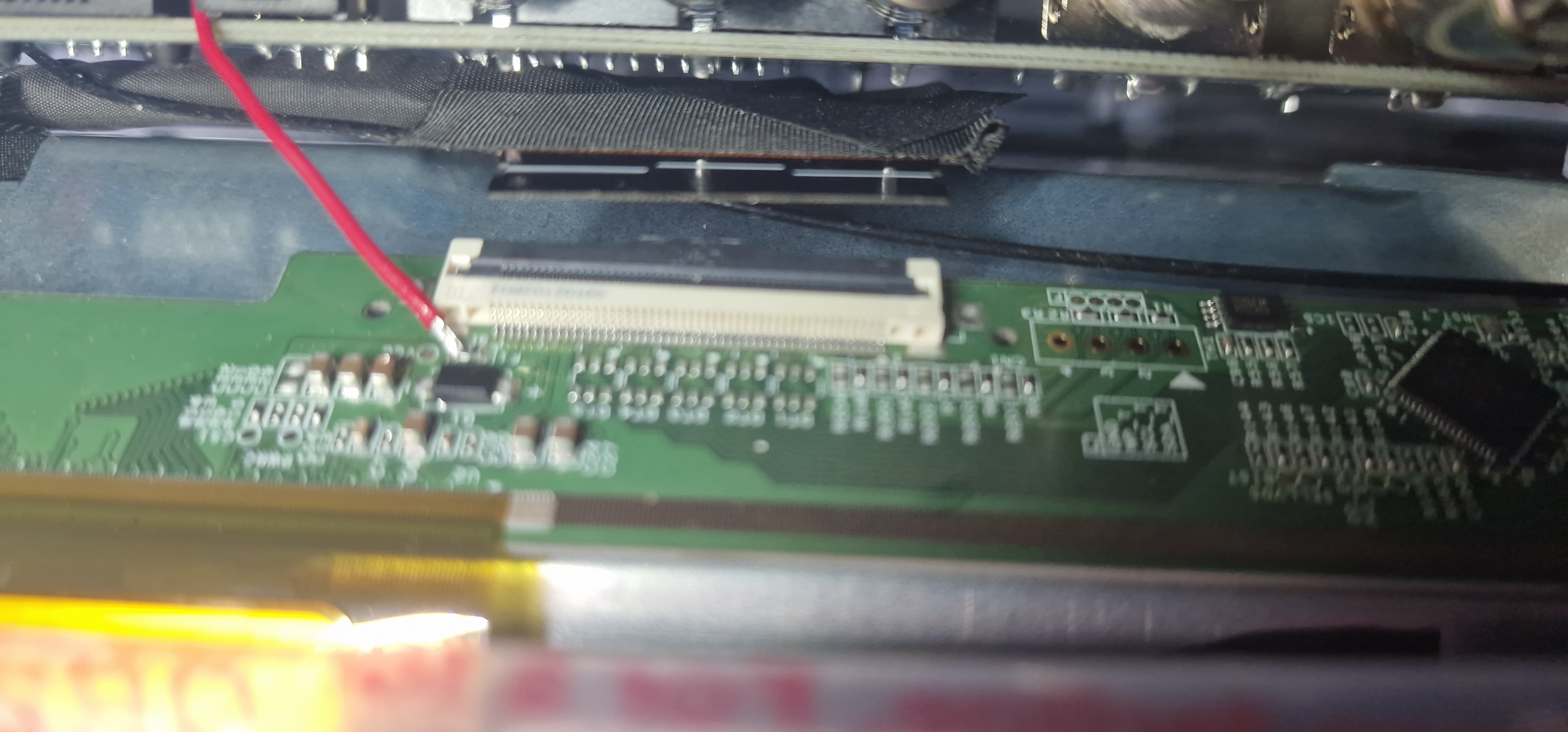

          • Diah
            • Feb 2013
            • 6556

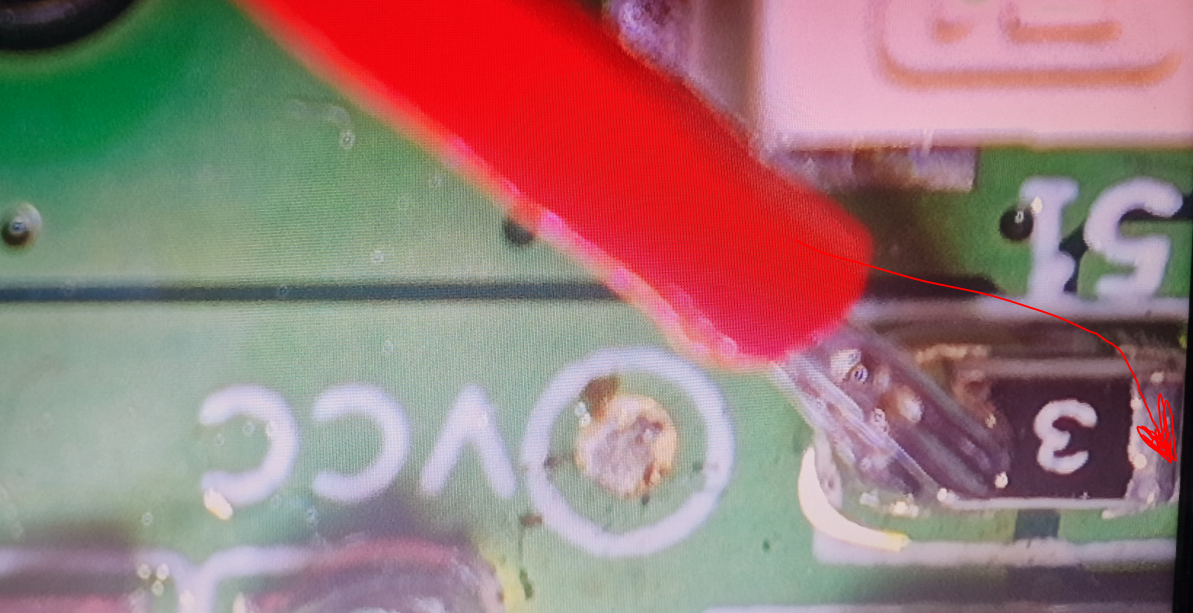

            disconnect the LVDS between MB and Panel from MB site, only feed VCC 12V from MB to VCC T-CON on panel.. check yours screen.... and measure again the points measurements you posted at POST 1

                Originally posted by labello
                Sorry man I didn't follow, if i disconnect the pannel board from the mainboard how can I expect to found voltage? There's only one cable. Thanks
                i wrote, feed the Panel VCC 12V from MB... mean you need only one wire solder between MB and Panel VCC point

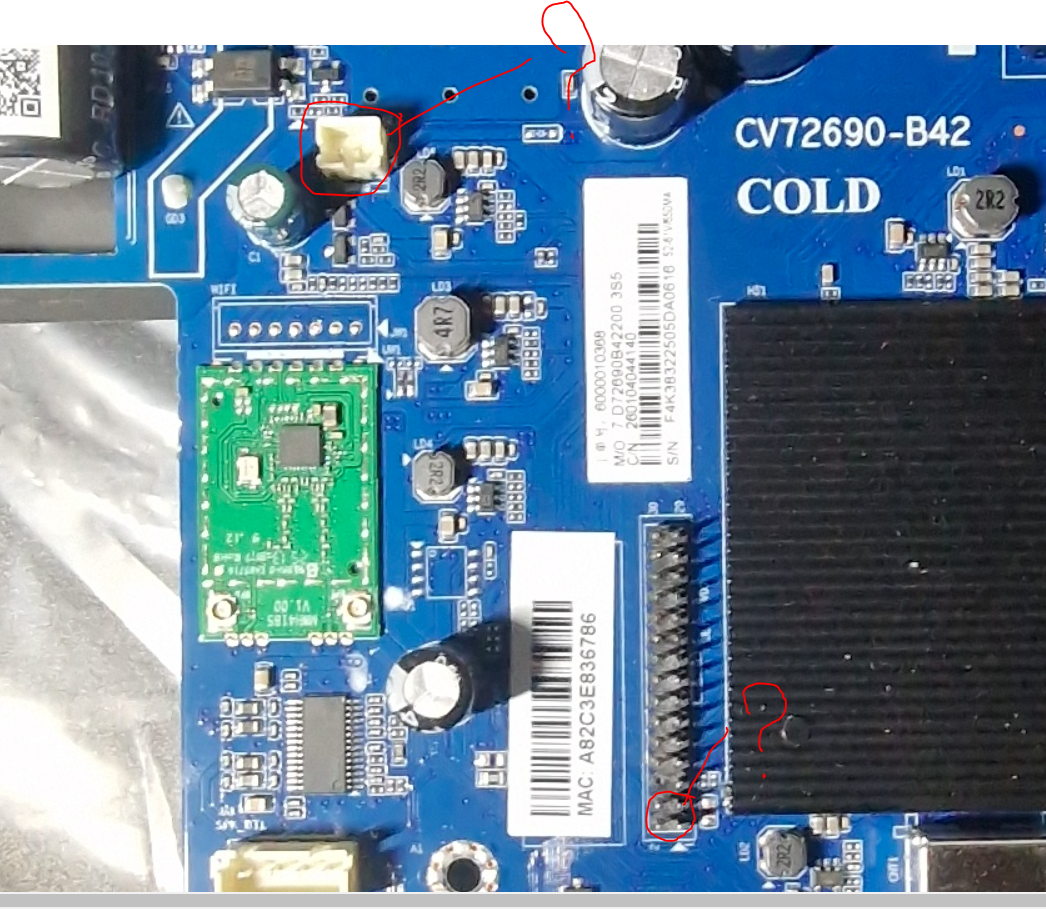

                  Ok where is should take the VCC12 from the mb THANKS

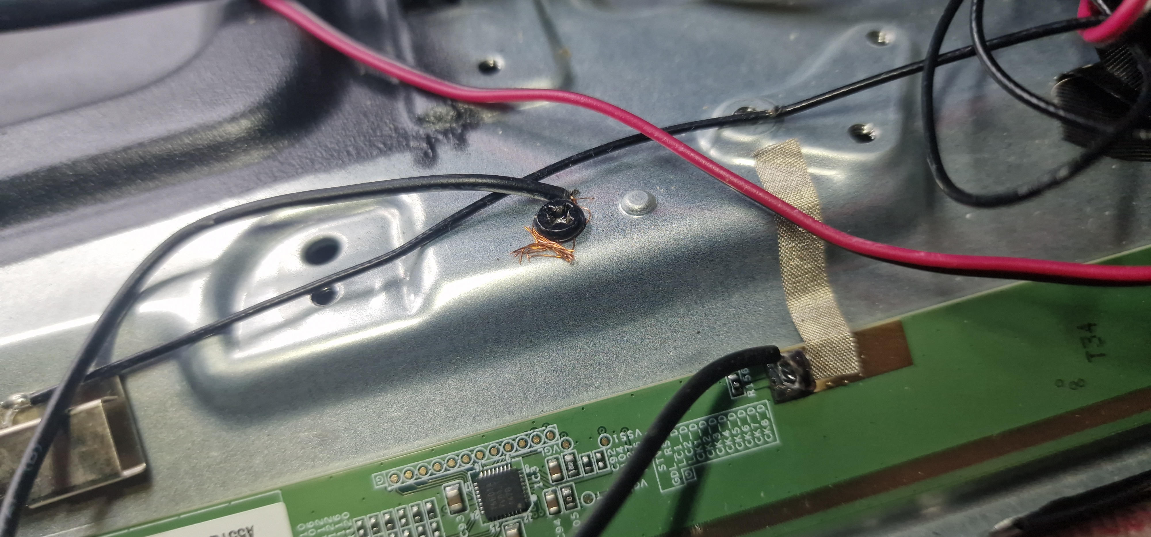

                  • lotas
                    • Jan 2016
                    • 4847
                    • Russia
                    #29
                    Not one wire, but two (minus, GND is also needed).

                      #30
                      Ok,, so still vcc 12 v
                      • lotas
                        • Jan 2016
                        • 4847
                        • Russia
                        #31
                        Using the LVDS cable, look at which contacts the 12V comes to and where it comes from from the motherboard.
                        • Diah
                          • Feb 2013
                          • 6556
                          #32
                          please dont make it complex to him... the panel buffer boards connected to GND TV Chassis with shield Tape.. only vcc 12V from the LVDS socket on MB enough to panel VCC
