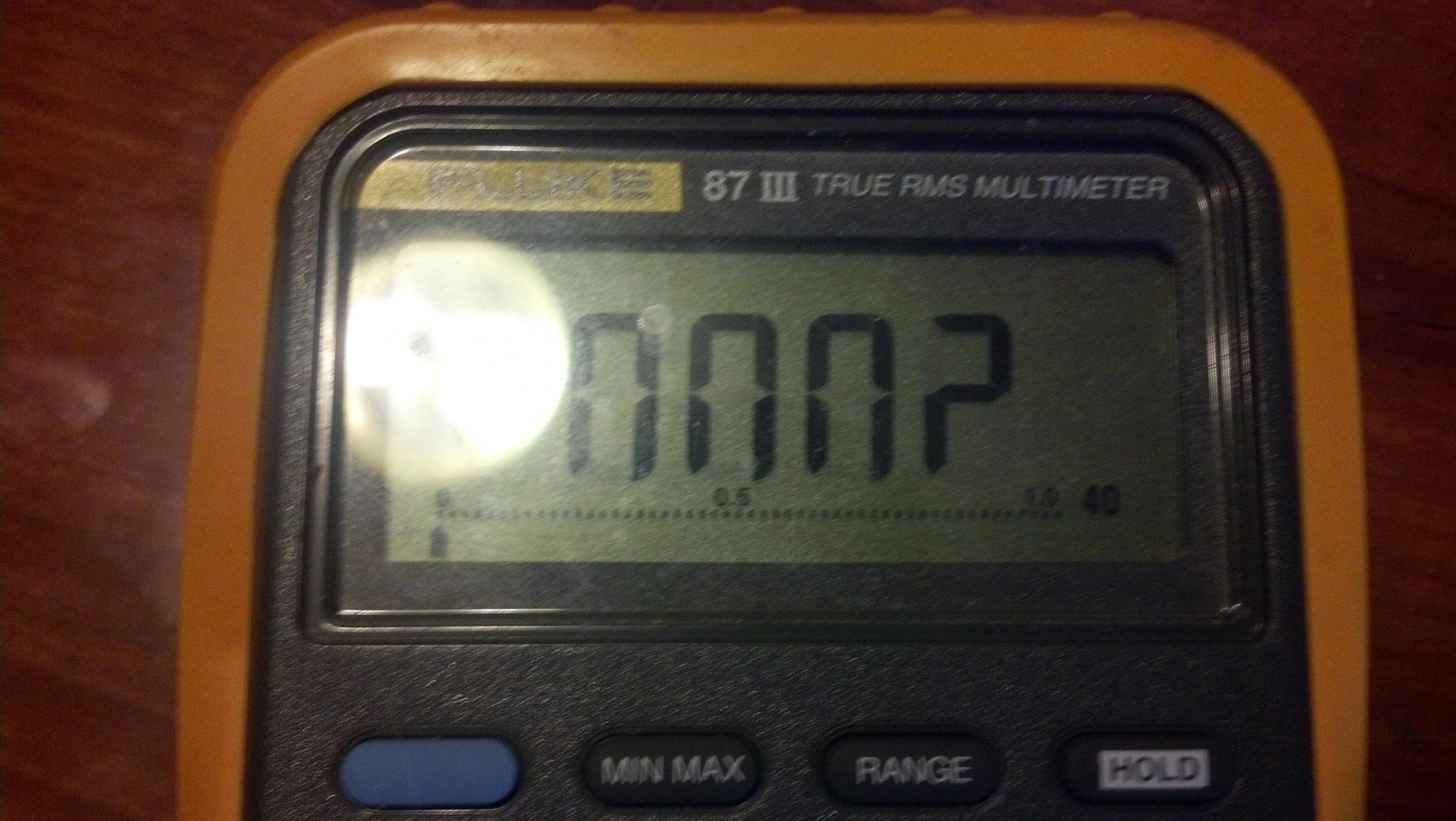

LCD display shows partial numbers and the bottom pixels never function leaving me guessing with some numbers and the decimal. I have replaced the elastomeric connectors after cleaning the contacts well and no difference. Has anyone experienced this and not have the connectors help? I figured i'd post before i purchase a new LCD panel to see if it works.

I used the OEM Fluke grey replacements and have cleaned all surfaces as instructed. even twice. Not sure what the problem is but i'd like to be able to use my fluke again!You Can't Succeed Until You're Willing to FailComment

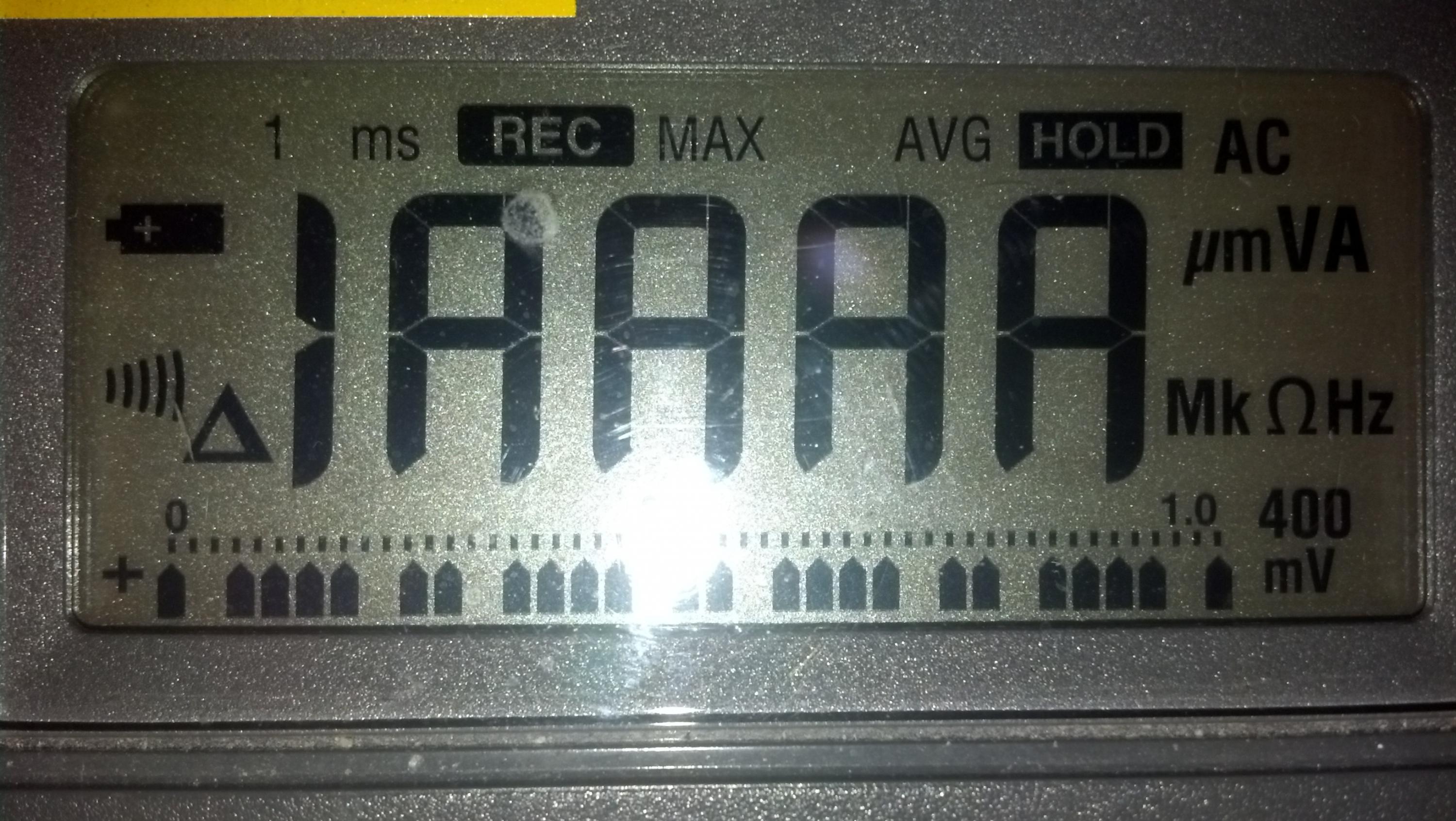

Can you take a picture of the lcd when doing a display test? Turn meter off. Hold down (and keep holding it down) and button and all lcd segments should be on. Take clear focused picture and upload.--- begin sig file ---

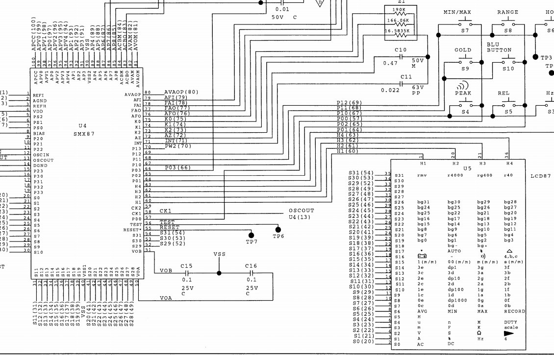

There is no service manual for the 80 series III with schematics, but seeing how a 80 III LCD will work in a series I, I think I can assume that the series I service manual can provide some clues.
Since the bottom segments are not lit properly, I *think* in the seven segment world, that is referred to as 0d, 1d, 2d and 3d? That is "D" as per
http://en.wikipedia.org/wiki/Seven-segment_display
Thus on page 98 of the service manual, that would imply H2 or pin 61 is responsible for driving those segments. If I remember correctly, the DCV that you should get is around 3.3V on pins H1, H2, H3 and H4. It might be possible that there is some dirt/debris on H2 that is lowering the voltage?
You can try measuring the voltage on all 4 pins and see if there is a significant difference? If you have an oscilliscope, you can also look at the waveform.

Re: Fluke 87 III display issue
I agree with retiredcaps, something's wrong with the H2 line. In the all-segments-on test, everything on that backplane is missing, but all others are on with good contrast. So probably not a matter of lowered voltage or bad connection, it looks more like no connection at all. Which means either: bad driver in the chip, bad LCD, or a broken connection in-between.
Try to eliminate the LCD by seeing if you can get some of the missing segments/annunciators to come on with the LCD out of the meter. For example, a 3 to 5Vp-p 50Hz square wave between H2 and S0 should get the "DC" annunciator on. Take care not to damage the conductive traces on the glass with metal bits.
It doesn't take much signal to operate an LCD, in fact if you ground the backplane or common line (in this case, H2) and then touch the segment lines with your finger, there's often enough mains noise on your body to turn on the segments.Comment

i've checked the traces on the PCB and they are reading fine. can you further explain testing the panel out of the meter? I just don't want to damage the traces on the panel.You Can't Succeed Until You're Willing to FailComment
LCDs segments are like little capacitors, and are driven with a high-impedance low-frequency AC signal. Usually there's enough of a AC mains-induced signal between the end of your finger and earth ground to activate an LCD segment. I've used this as a quick test of LCDs before.
If you hold the LCD glass in the light just so, you can see the conductive traces around the edge. Find the H1 connection and touch it lightly with a probe that is connected to earth ground. (Don't use a sharp probe, obviously.) Then run your finger over the other connections and look for some segments to come on, if they do, the test is working. Then try the H2 connection and see if any of the missing segments/annunciators come on. If they do, then the problem must (unfortunately) be the main chip. If they don't, then the LCD must be damaged/defective.Comment
