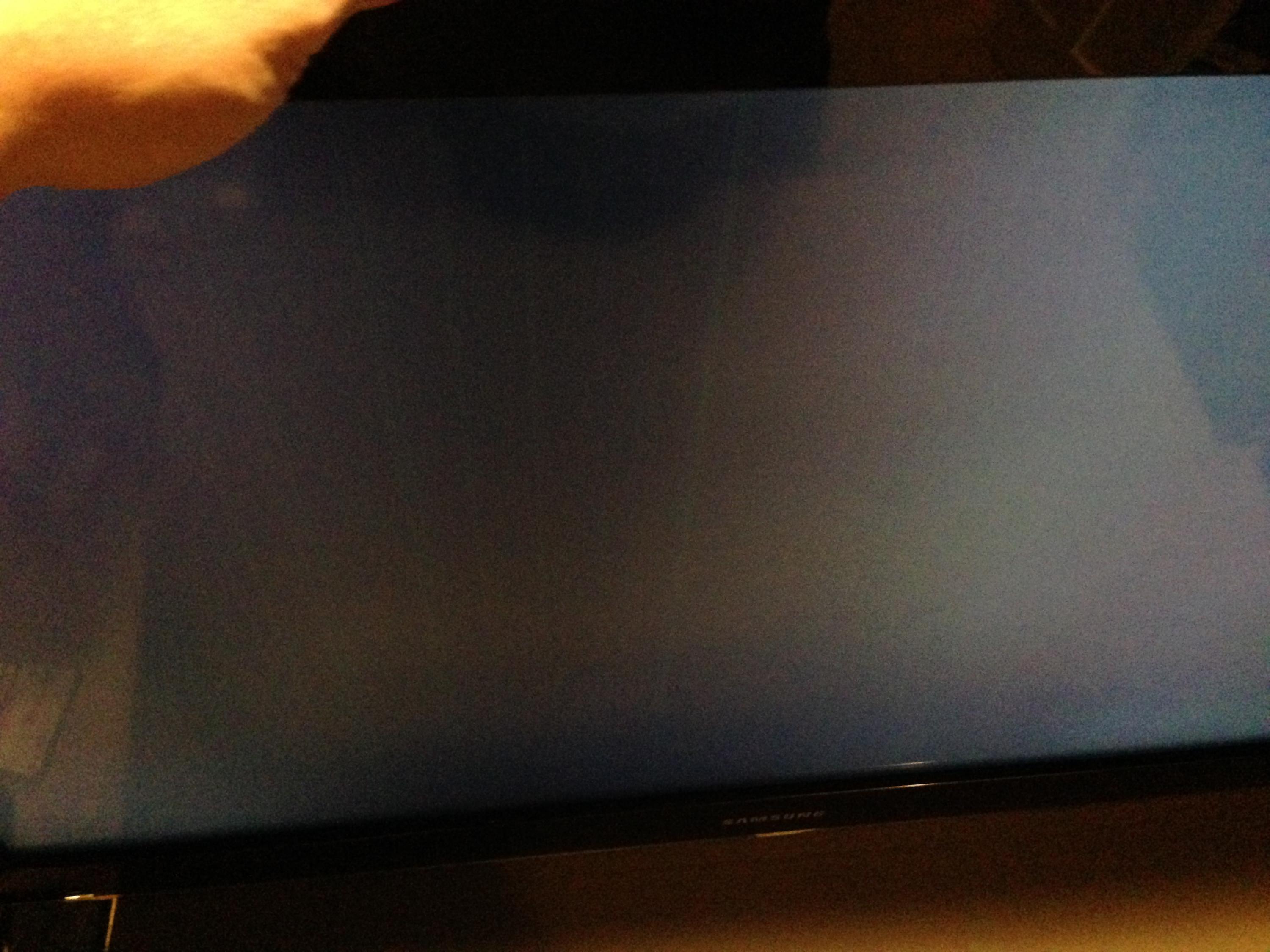

    Symptoms:
    Panel turns on, CCFLS are super dim with no input, no ODS or display at all.
    Once the panel gets an active signal, the screen brightens up, audio can be heard, Still no OSD or display.

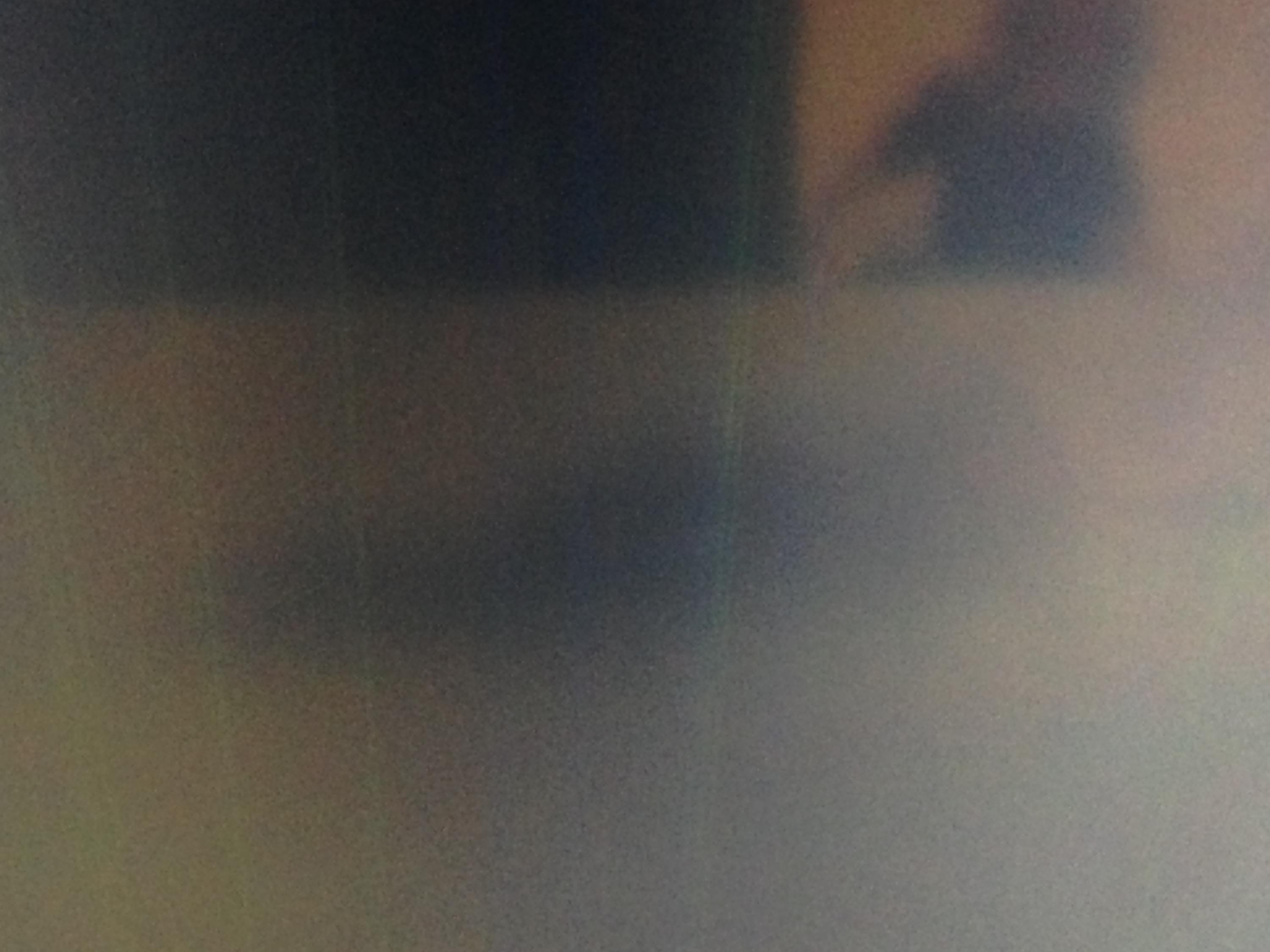

    If left on for more then 10 min, faint vertical lines can be seen.

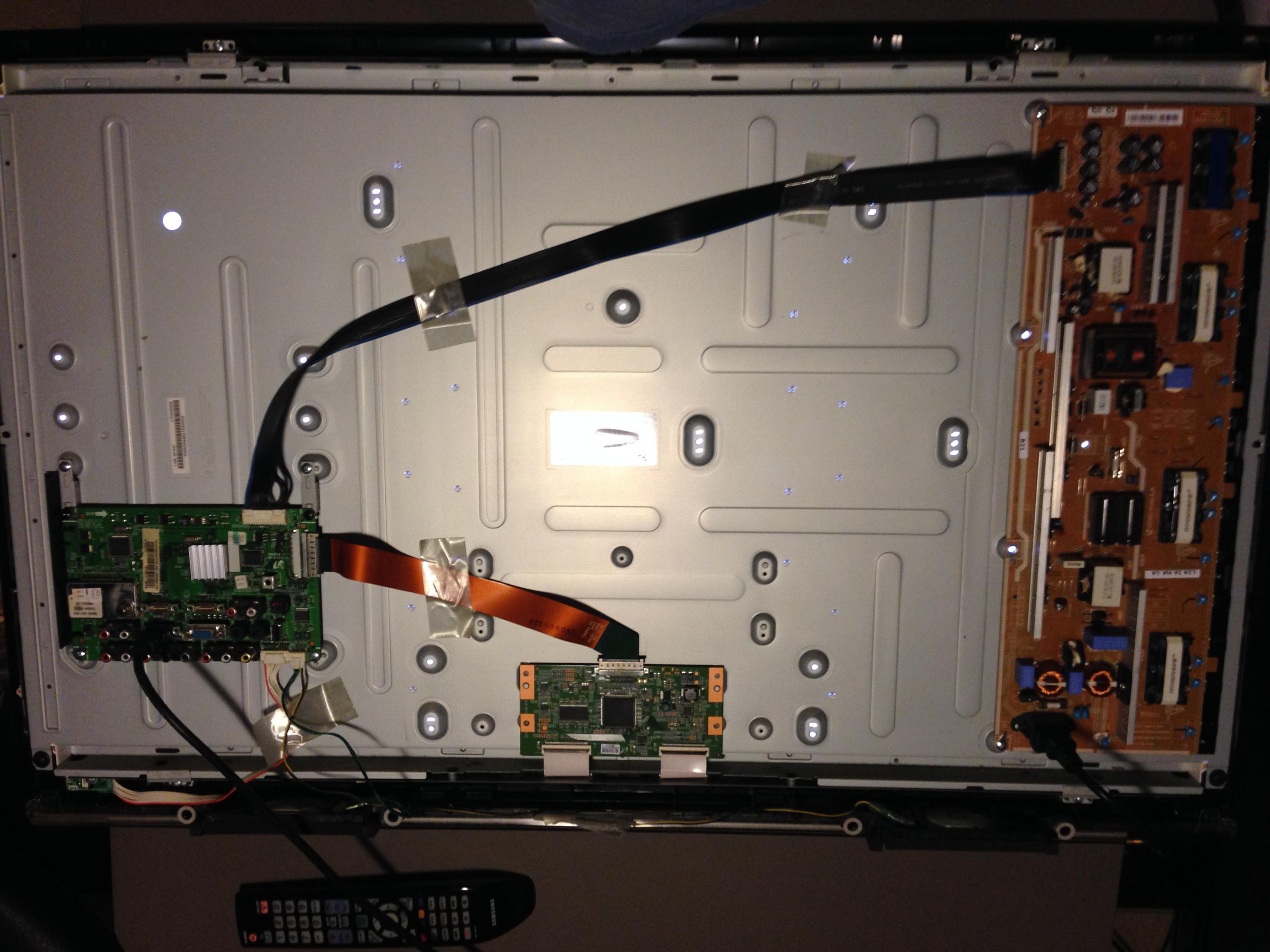

    Troubleshooting:

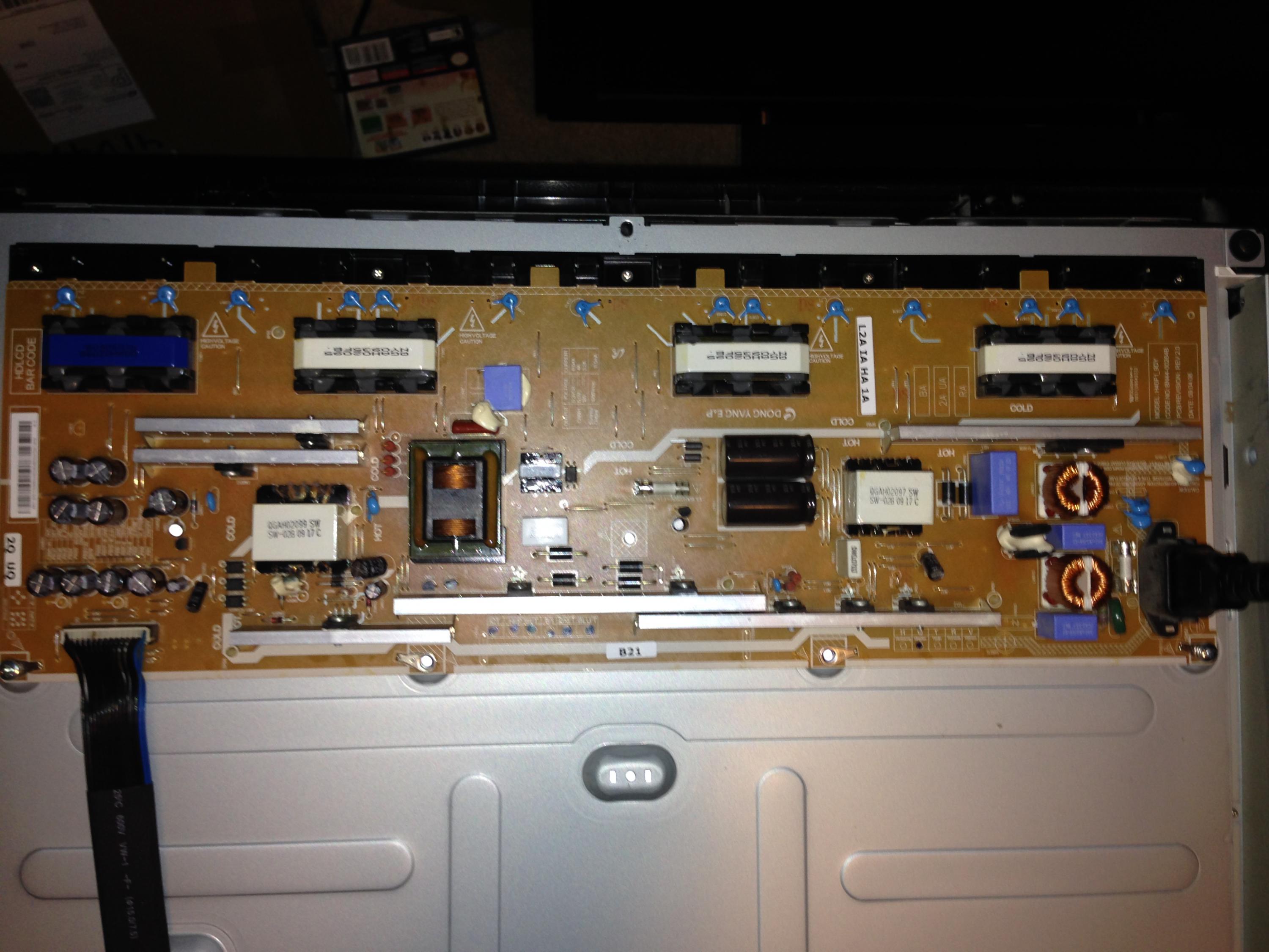

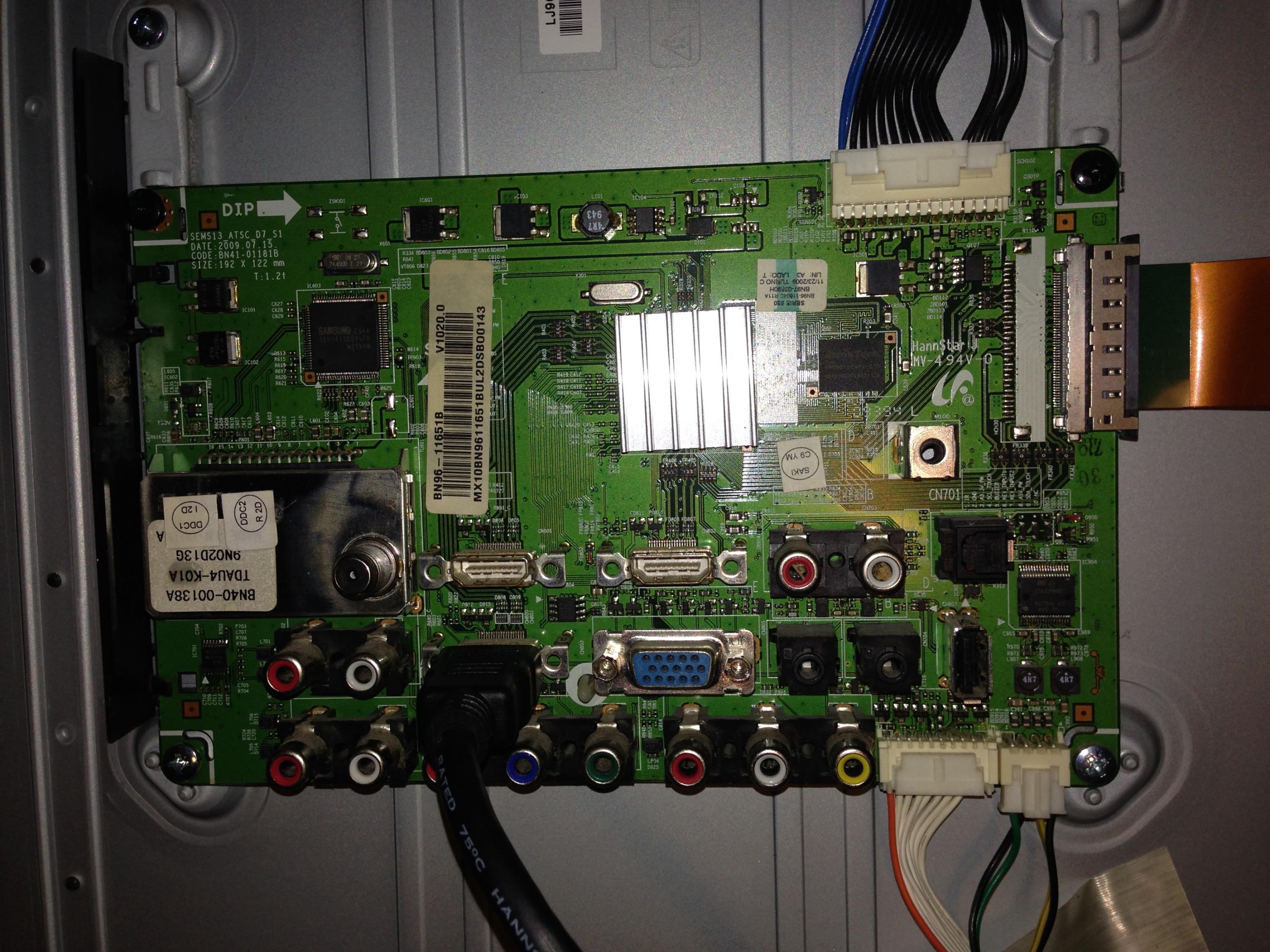

    Disconnected the Main from the PS, CCFLS came on bright as could be.

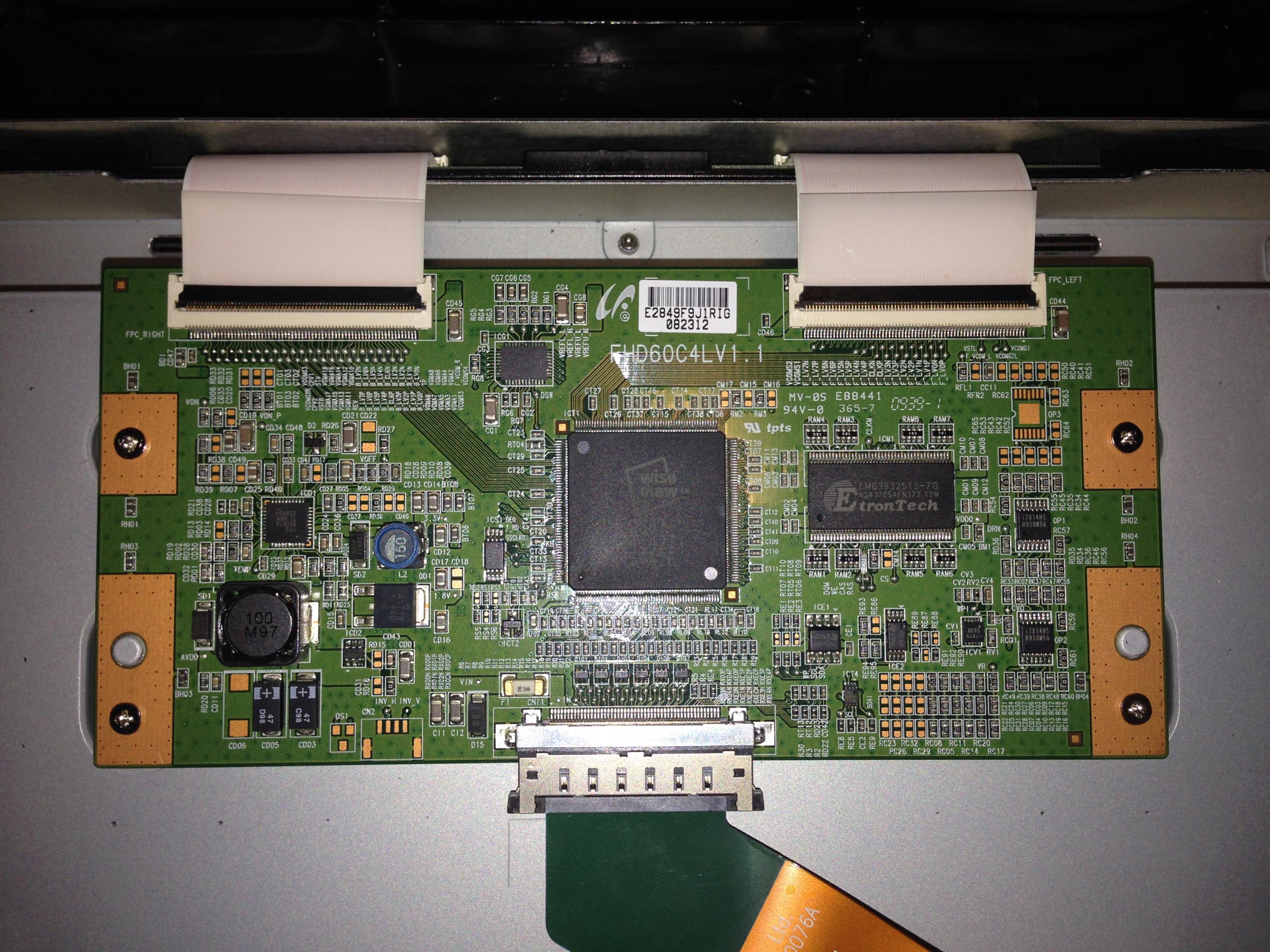

    Disconnected the LVDS from the T-con to the Main, no change.
    Disconnected the TFT buffers from the T-con both left and right and one at a time, no change.
    checked T-con fuse, was 12.5v both sides.

    I am leaning towards bad T-con as the voltages were really low on the pins I checked. But could this be a bad panel too?

    Found a T-con for super cheap, going to try this part. I will update when it arrives and I get it put in.

        Well good news with a not so great ending.
        T-con was the issue, after I got the replacement put in the display fired right up and a picture was showing.
        As soon as I put a signal to the panel and got a color backdrop the infamous tab bond issue showed it's ugly head, 2 pixel wide lines and 3" strip behind those 2 lines lightly discolored.
        Booooo, not even sure I am going to try to fix it, the cool part is that all the boards function so I can make money on it if I part out!
