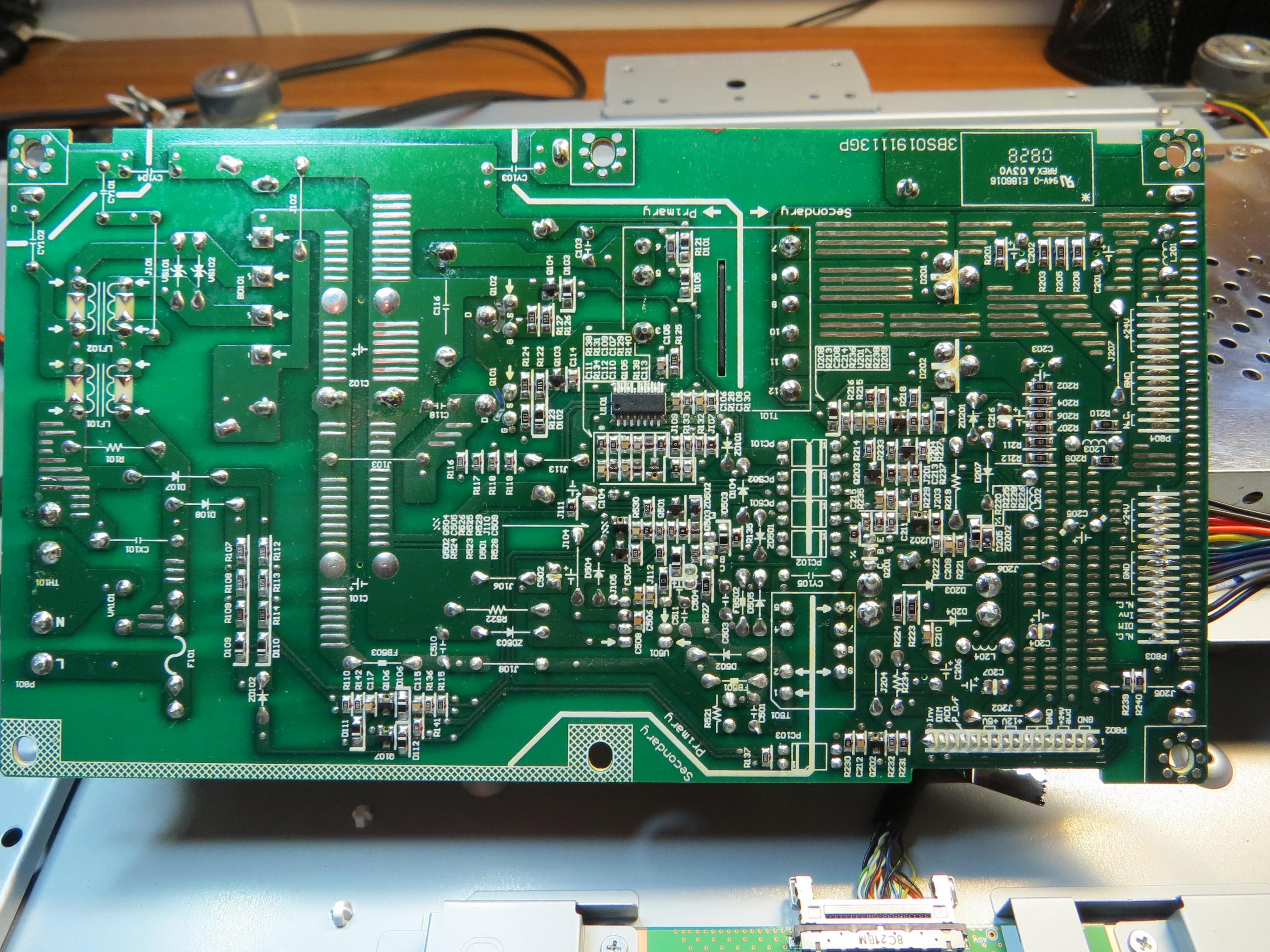

    Ive got a Toshiba 32av502u TV that is dead, no power, no blinking led. Boss gave it to me, he was going to through it our but I figured it could be an easy fix.
    Cracked her open and the fuse is intact, no power at it though. Im kind of new to large electronic repair (normally I repair cellphones, laptops and the like), I understand the basics but not much beyond that. Would someone care to point me into the right direction?
    If I had to take a stab I would assume it is the varistor just right of the power and left of the fuse (top left, from the top view; bottom left from the bottom view)

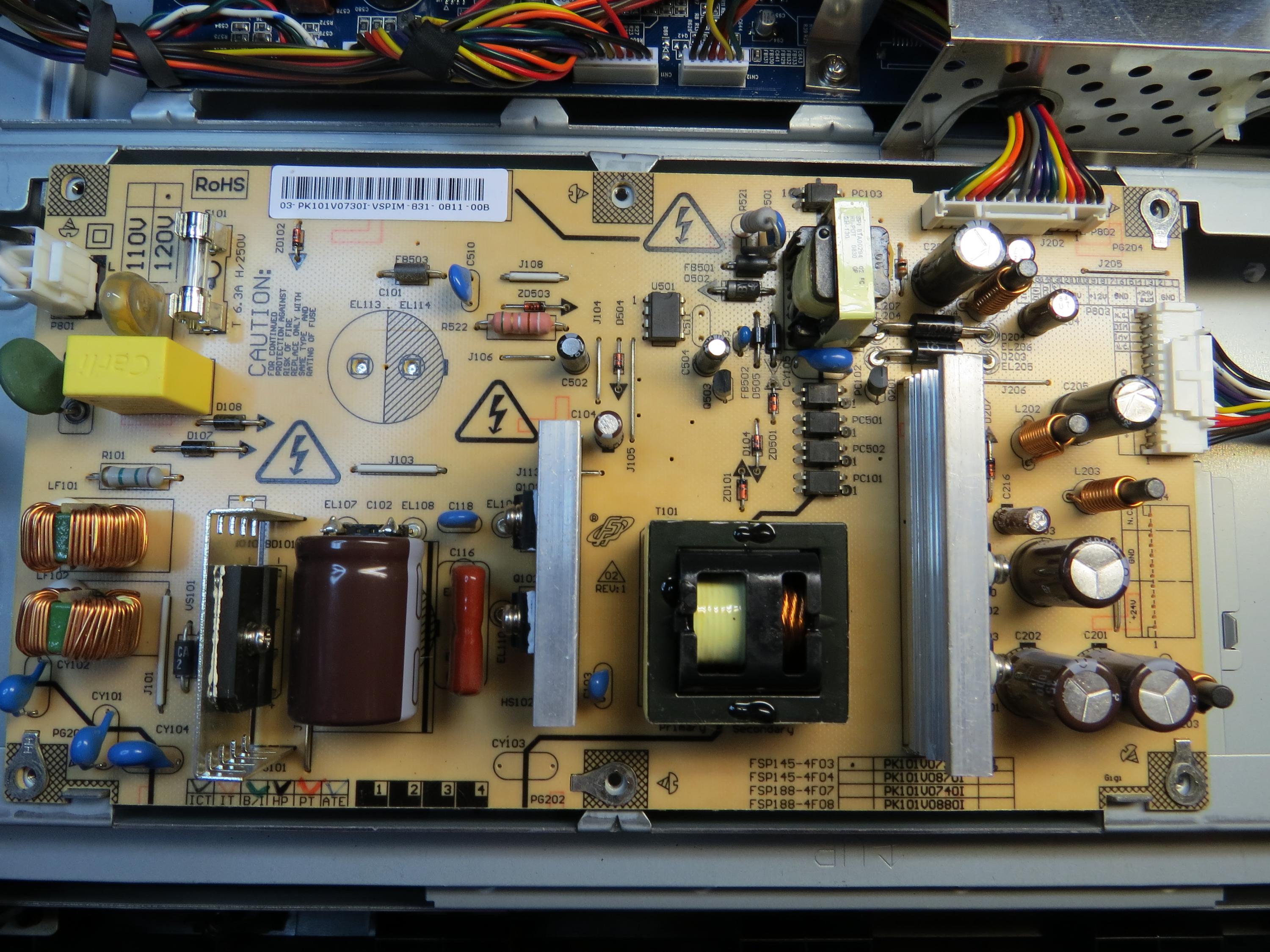

          Scratch that, there IS power going to the fuse, IDK what the hell i was testing earlier. Been a long day.
          Here is a better picture of the top, with proper lighting.

            170vdc on the dot.
              Re: Toshiba 32av502u
              Check the voltages as labeled by those two white connectors, and report the readings if you do have 170V on the main cap as in my post 4. More likely you do not have the stby5V right now.

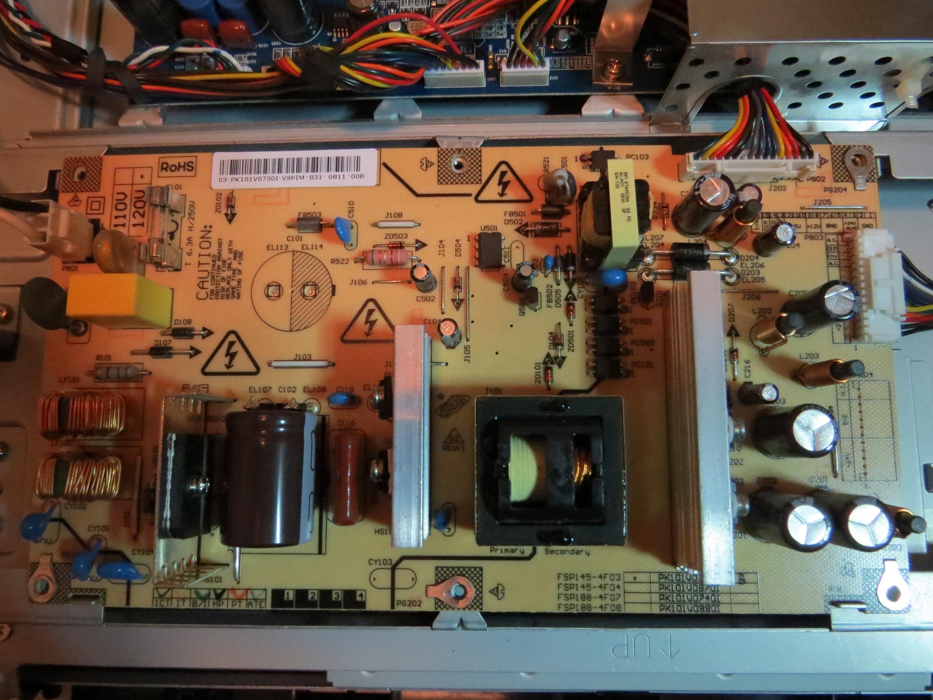

                No power at either connector.
                (assuming you mean what i labeled in attached pic, just wanna double check instead of me assuming)
                Edit: Is there a surefire way I can verify its the powerboard? If I can I might just go buy a new one ($30 on ebay)
