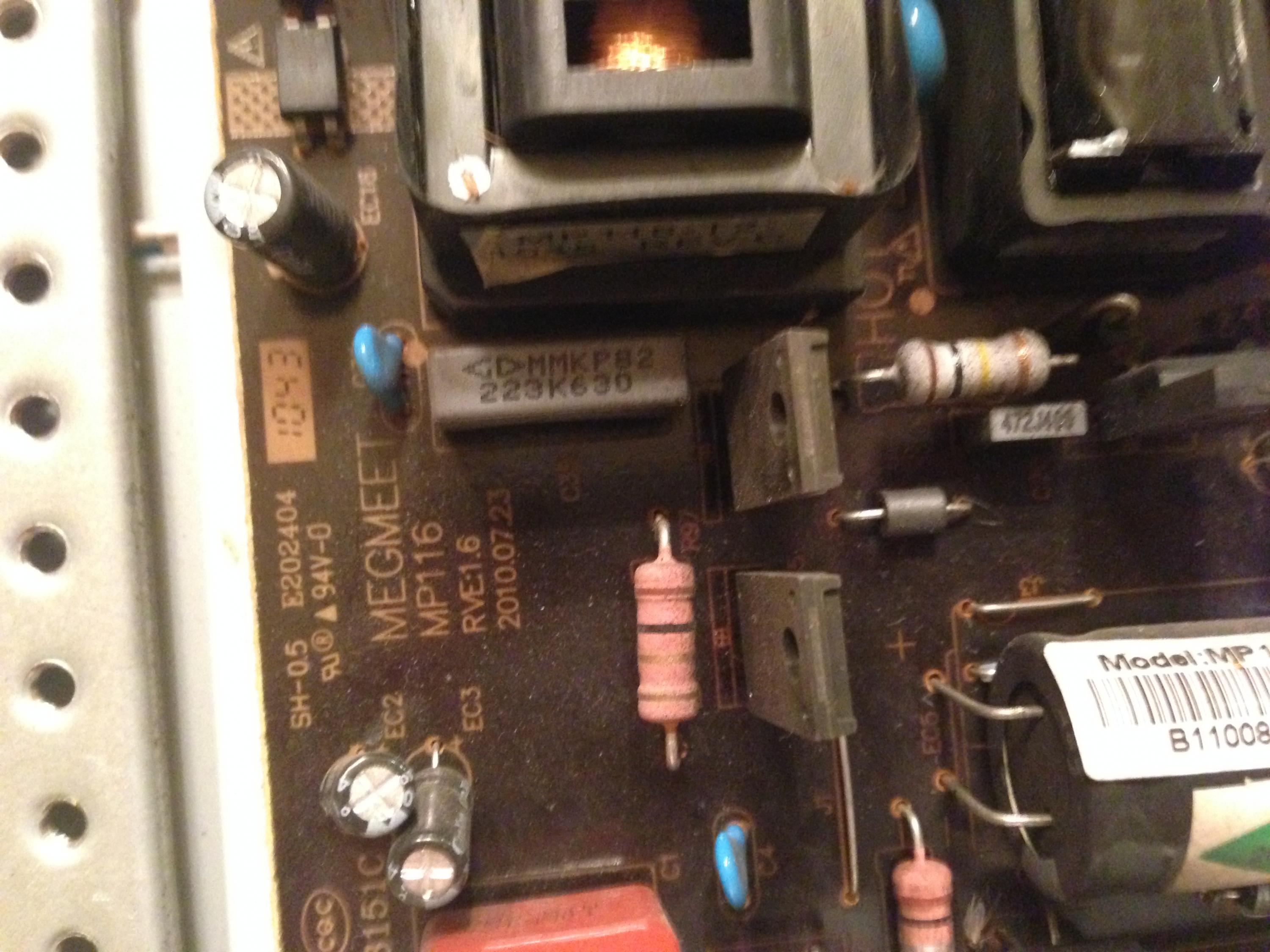

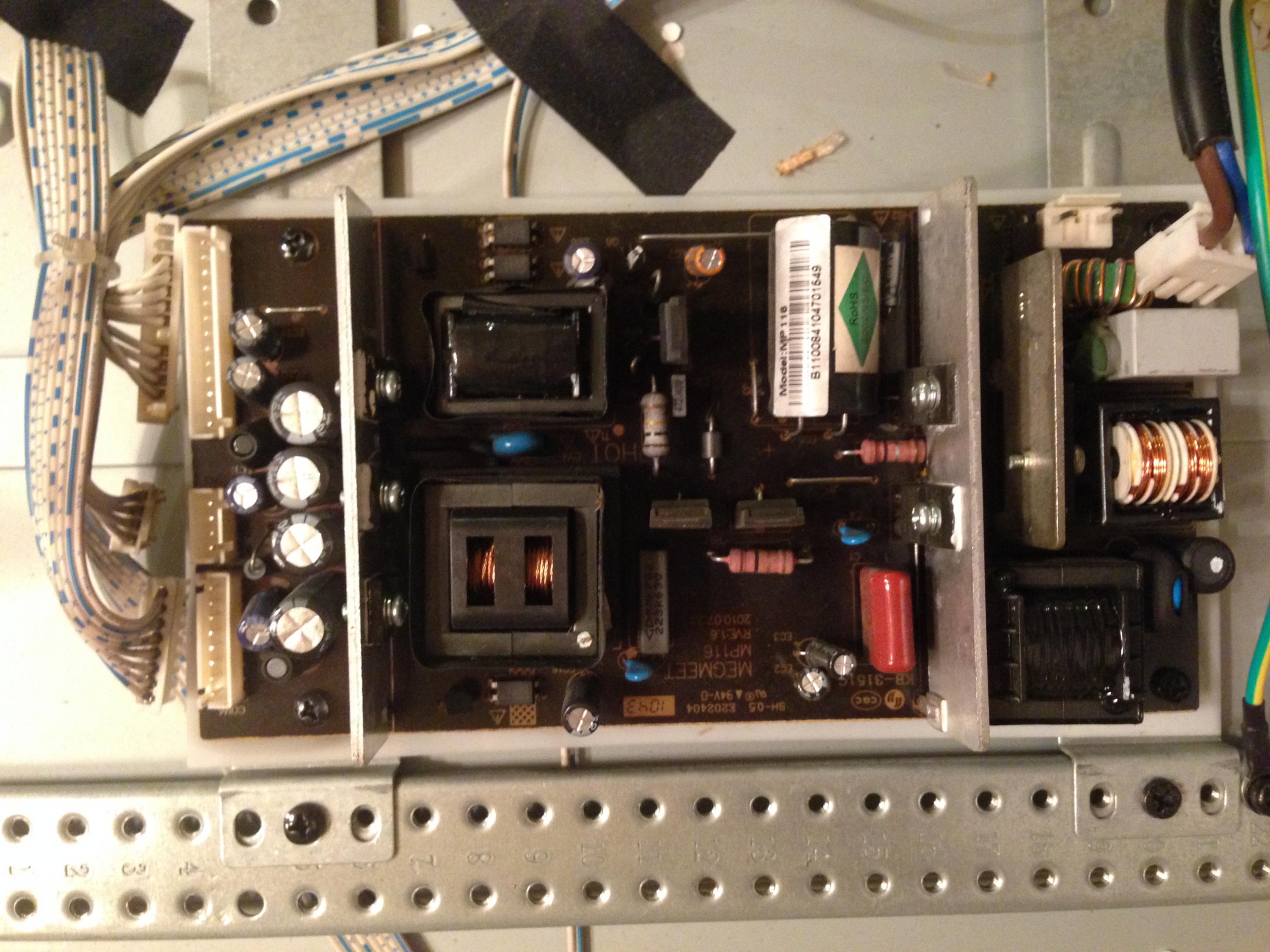

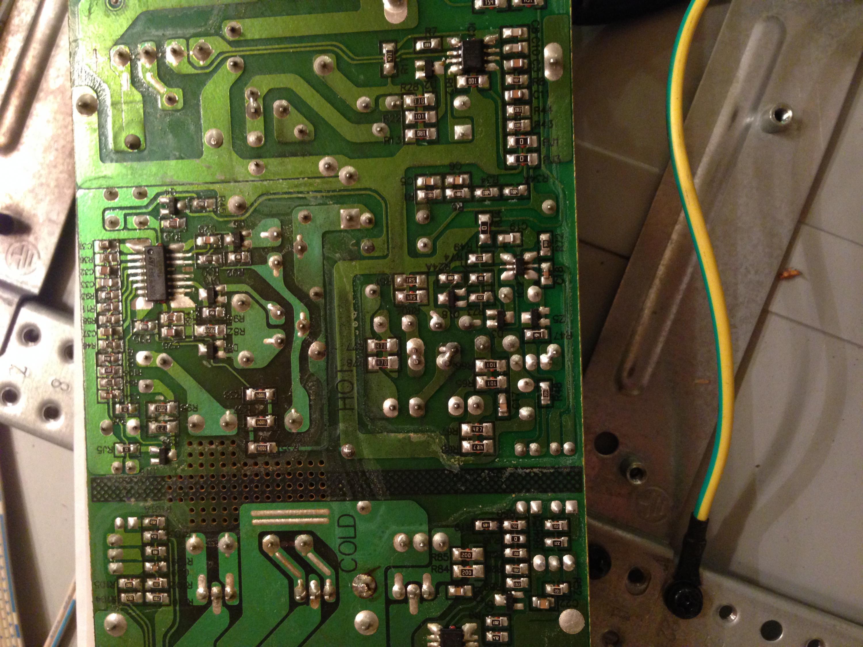

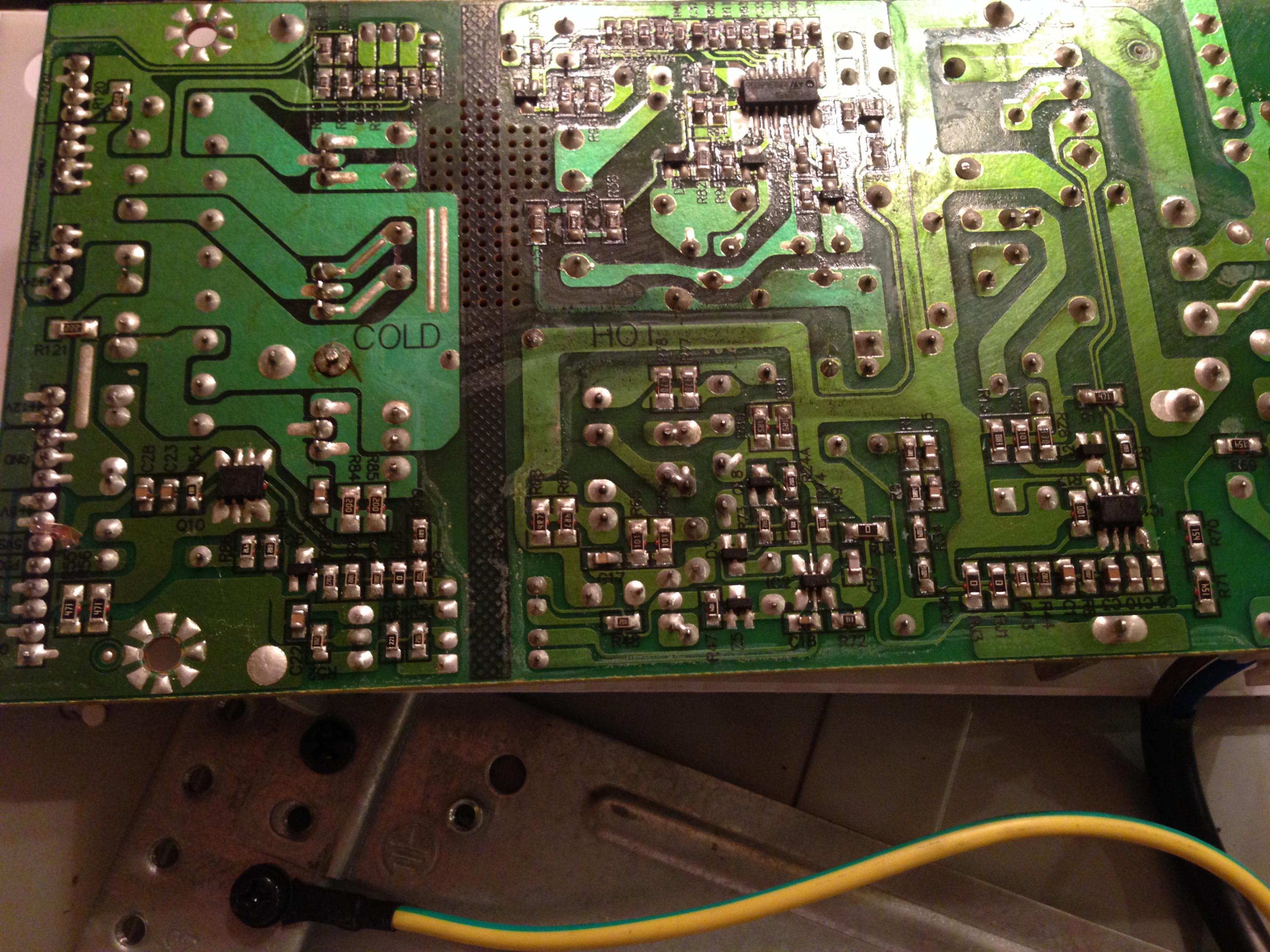

          Here are some pictures, I tried to get decent pictures which was difficult with the glare. If you need anything close up, a particular part of the board; I'll be more than happy to try again.
          I tested the +5 and got nothing out of it.
          Also I just noticed there seems to be a patina around the hot side of the underside of the board, like it was burnt.
          Thanks again!

                      If you are not getting your hot B+ at least 160 volts -- at the big cap--there is an input problem on the PS.
                      Perhaps a shorted FET on the supply, or if this one uses a boost converter--a shorted boost transistor?
                      You DID check the fuse--right? if open--you then need to OHM that same big cap and see is there is a low resistance short there. It should read 1K or higher. It is reads a few ohms--a short exists on the hot side of the supply--likely a FET.
                      • RCA2000
                        • Sep 2014
                        • 111
                        Re: Sceptre 32 inch , PSU problem?
                        I looked at the picture closely. this one DOES does have a boost converter. I have worked a LOT on this SMPS_-for the "kids" to then put in a set.
                        It often had a shorted boost diode and FET on the boost converter. Sometimes a shorted FET on the standby (small transformer) or one or both of the ones on the run supply (large transformer). I also saw some shorted diodes on the "cold side" on the 5 and 12 volt lines--and that will totally hold down the voltages. But you would still have full voltage on that input cap on the hot side if that was the case.

                                    When the MOSFET goes bad, you need to verify that the IC that drives the Gate of the MOSFET is not damaged or bad, otherwise your new MOSFET will be damaged. I usually replace the drive IC at the same time.
                                    • khaosduke
                                      • May 2014
                                      • 13
                                      The IC that goes is on the underside of the board which has a resistor (the one above the one of the SMD's I blew out) is marked 1606B it's a PWM/Power factor controller. I have no way to really tell if it actually works.
                                      In addition to the 0.1ohm surge resistor that blew , one of the tiny 1 ohm SMD's around the leg of the bad MOSFET is also blown. Provided that I replace the IC, the MOSFET, the 2 resistors and the fuse, at that point what else would I have to test?
                                        If you trace the Gate pin, there should be some resistor/diode network between the Gate pin and the Out put pin of the IC, if those are blown, then the IC is more likely to be gone. I would not take a chance of blowing new MOSFET and cause more damages. You will have to get the P/N of the IC.
