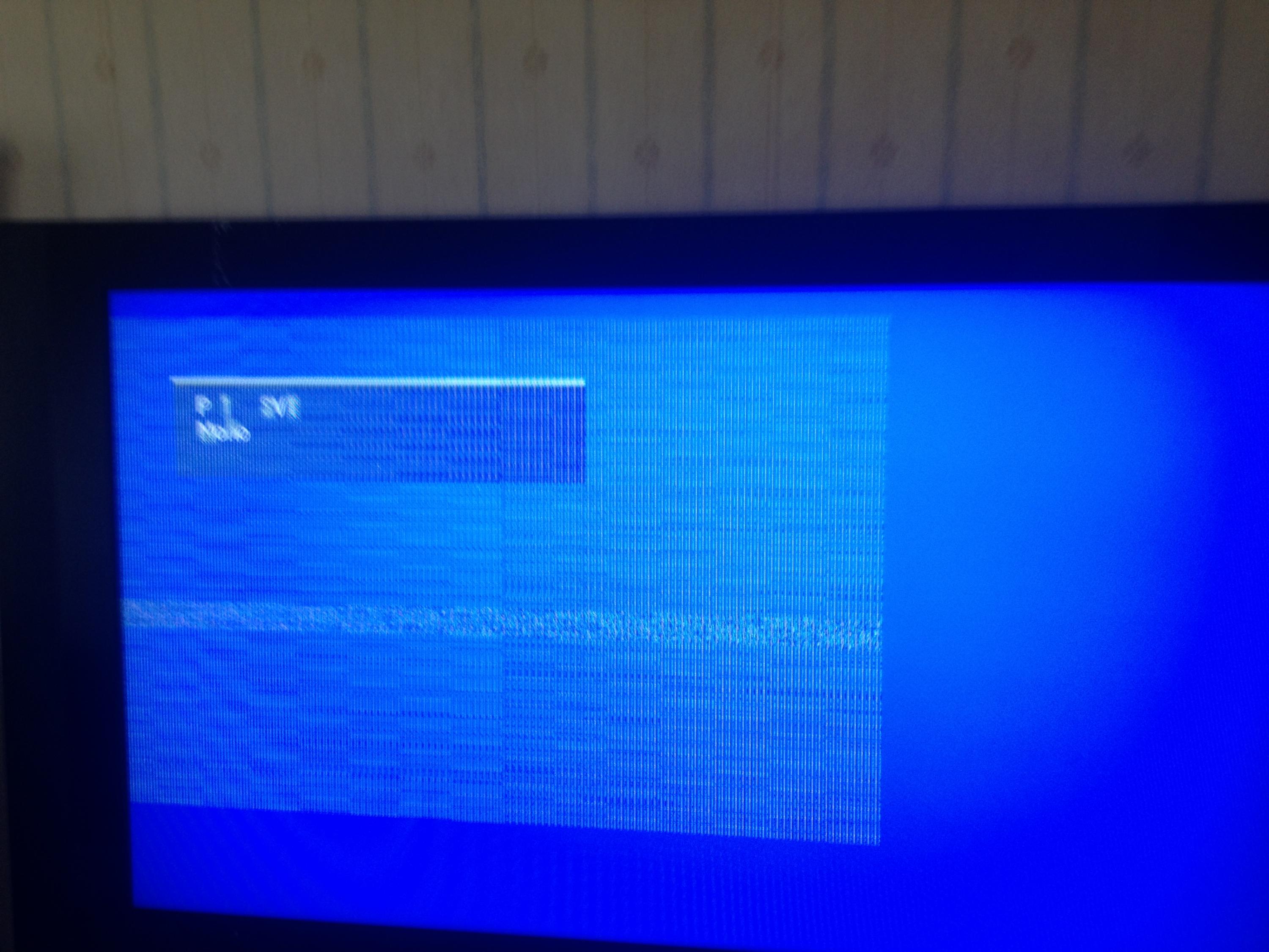

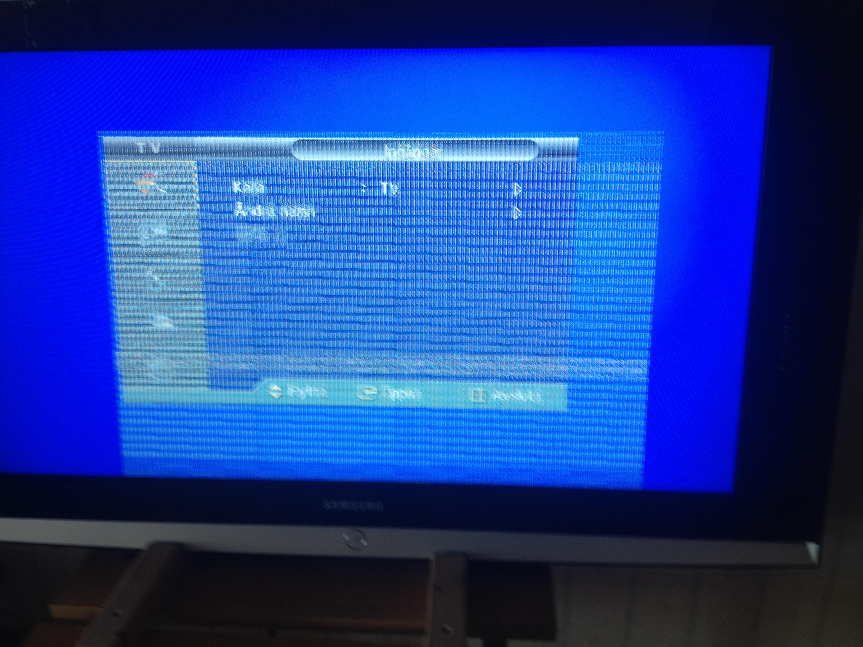

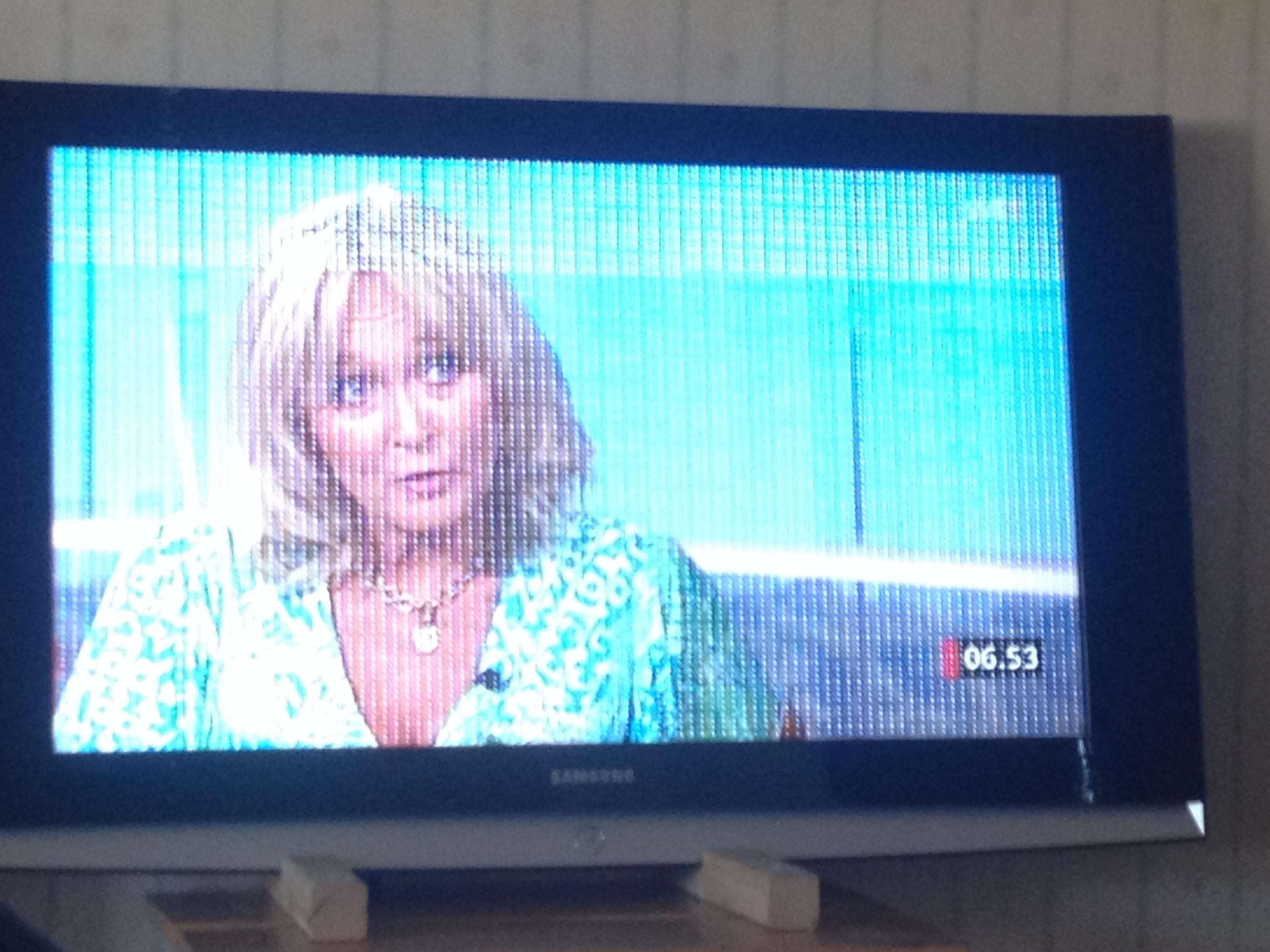

    hey this time it is a samsung LE40S71B everything seems to work except that it flickers across the screen if anyone can say how can one deal with this error thank you
    Re: Samsung LE40S71B
    Bad main A/V board. Some people have had luck reflowing the solder joints under the processor (in a manner similar to Xbox 360 & PS3 repairs.)

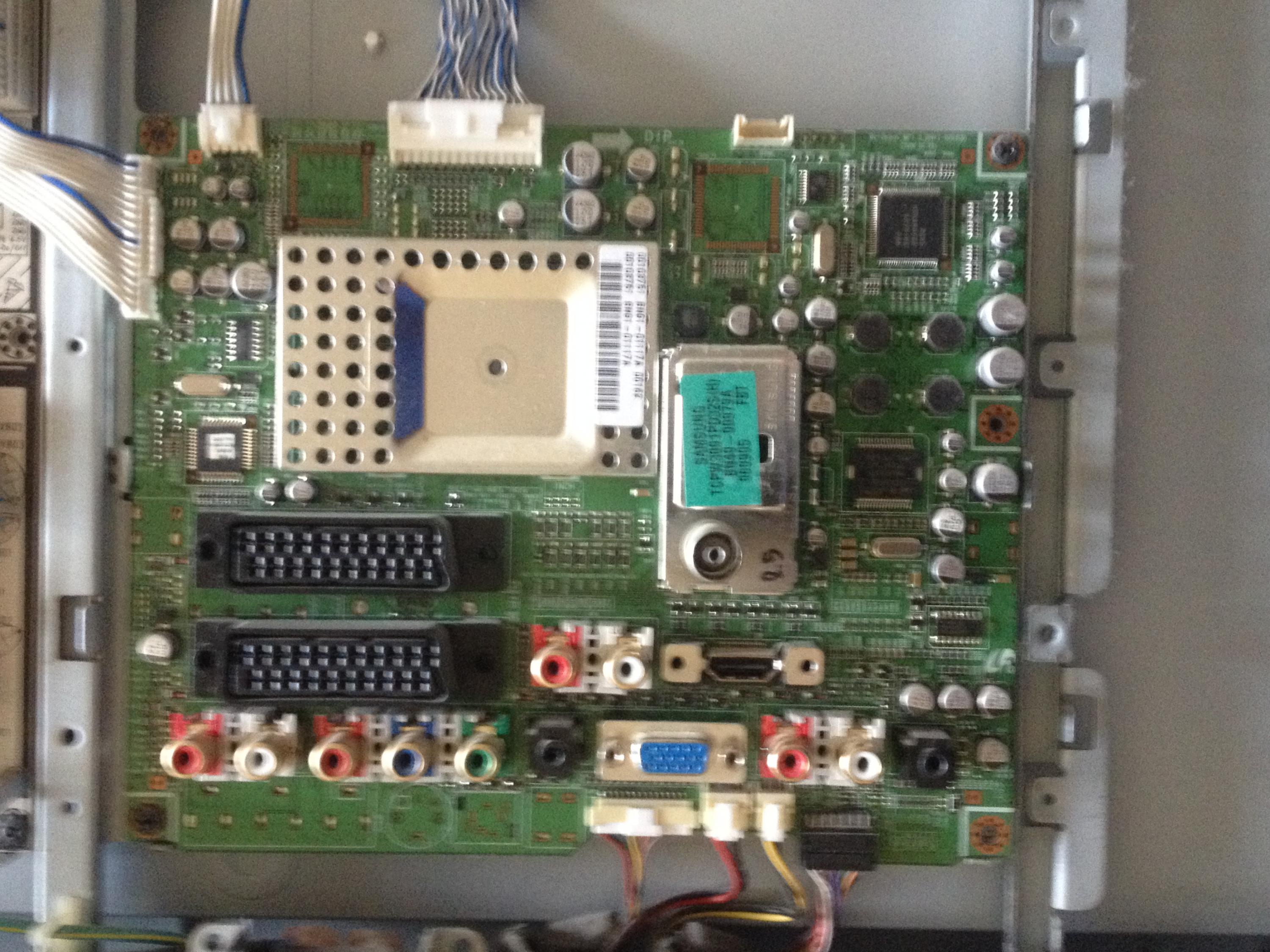

            please wat do you mean with main A/V board?
                The one in your first picture under the heatsink.
                  thank you selldoor and tom66 i do not have the tools to fix it so i have to find a new main board if it is the only problem
